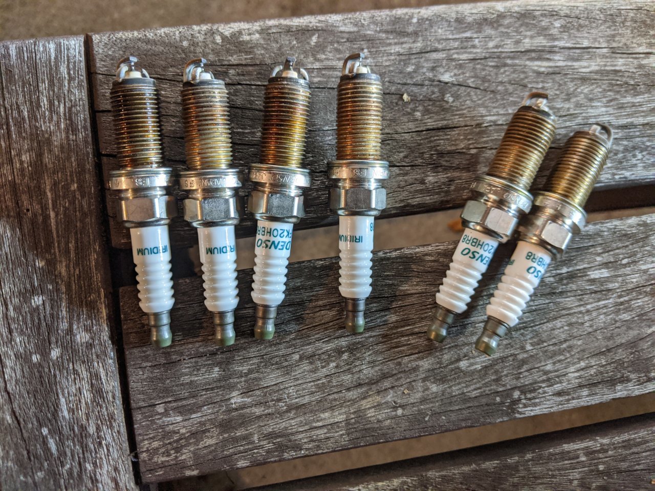

    Swapped spark plugs.
    Bought my 2016 used from the dealer with 67k miles. The manual calls for spark plugs at 60k.
    I'm now at 90k miles... One of those things I should have done sooner! And the dealer should have taken care if it before I bought the vehicle.
    The Denso plugs are expensive... I went with the AutoLite replacements

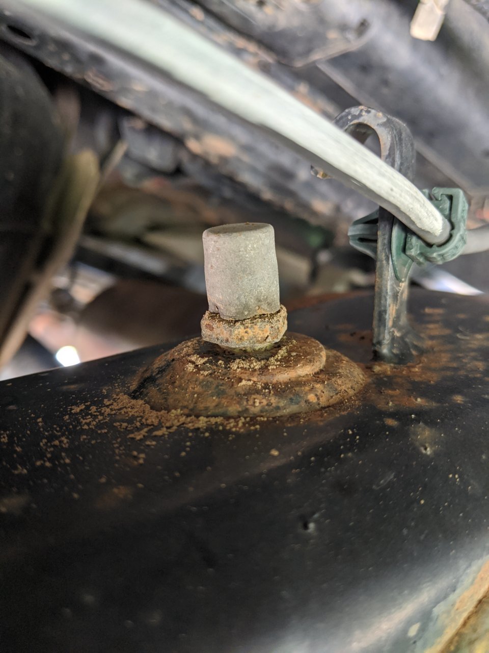

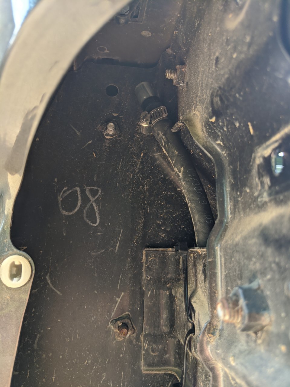

    Sorry, I'm going to double post. I also did the diff breather this weekend
    The OEM breather was full of dirt and mud
    I ran the new breather up behind the tail light

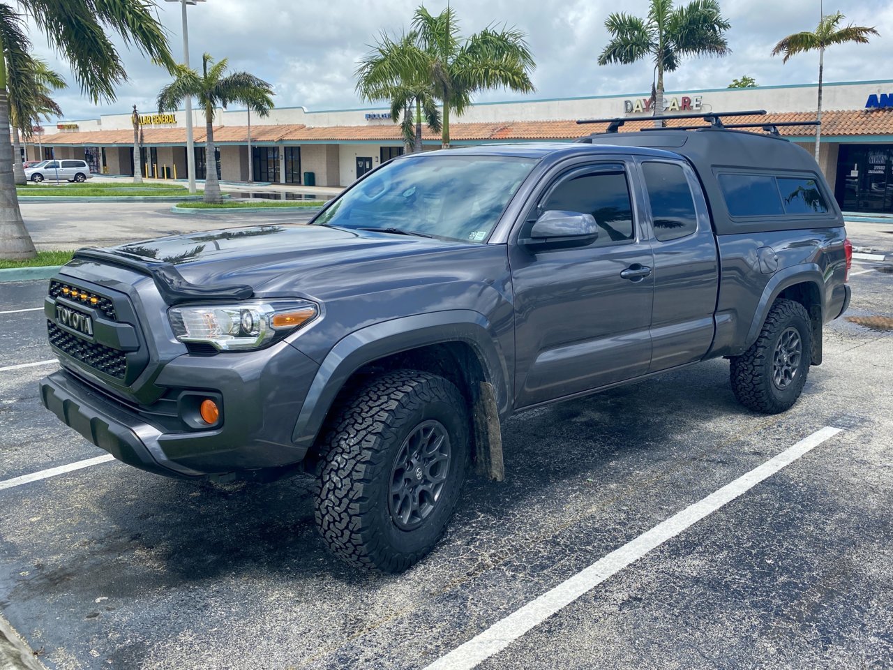

    Really happy with the new tires. 265/75/16 BFG KO2s. Does a lot for the look of the truck.

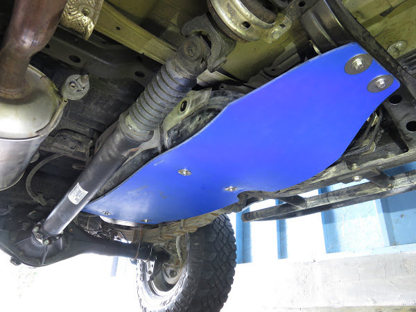

    Installed. Choosing fastener mounting over strap mounting was more PITA than I expected, as the hole locations change slightly once the skid is bent to conform to the fuel tank contours. Had to open the rear holes from 1/2" to 3/4" (2 sec each with a unibit), but got 'er done:

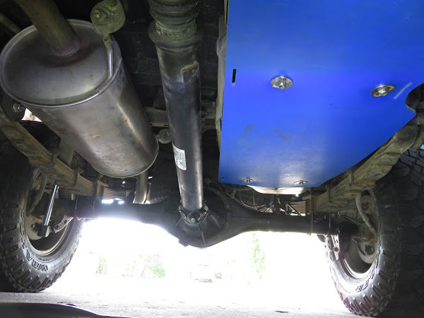

    Will have to monitor driveshaft U-joint clearance when fully stuffed:
