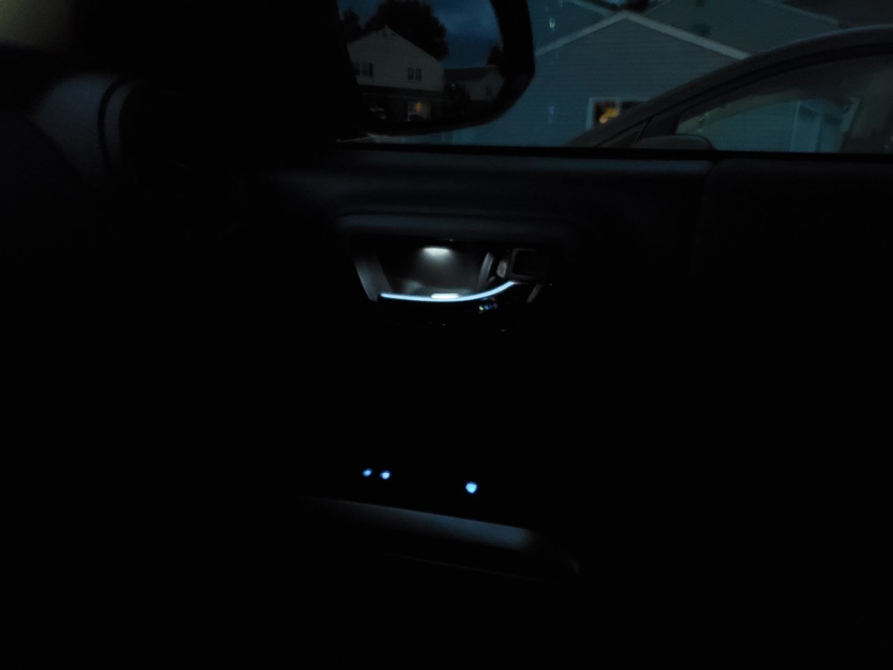

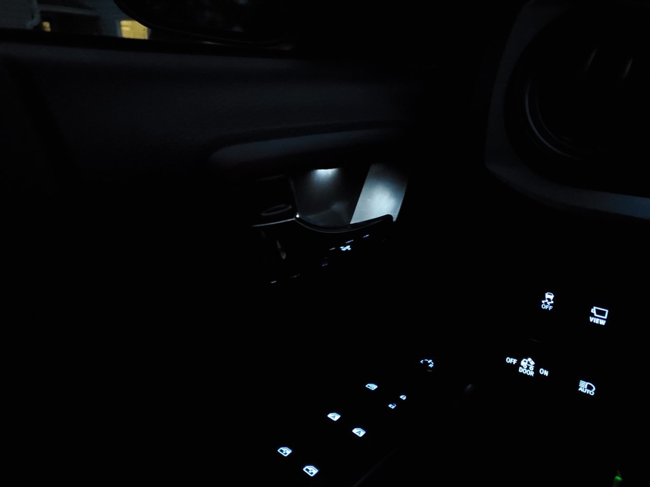

    Installed the ktjo4x4 White bowl light kit. Unfortunately one of them had a broken clip so I sent it back for a new one. Overall happy with it. Not too bright and not too dim.

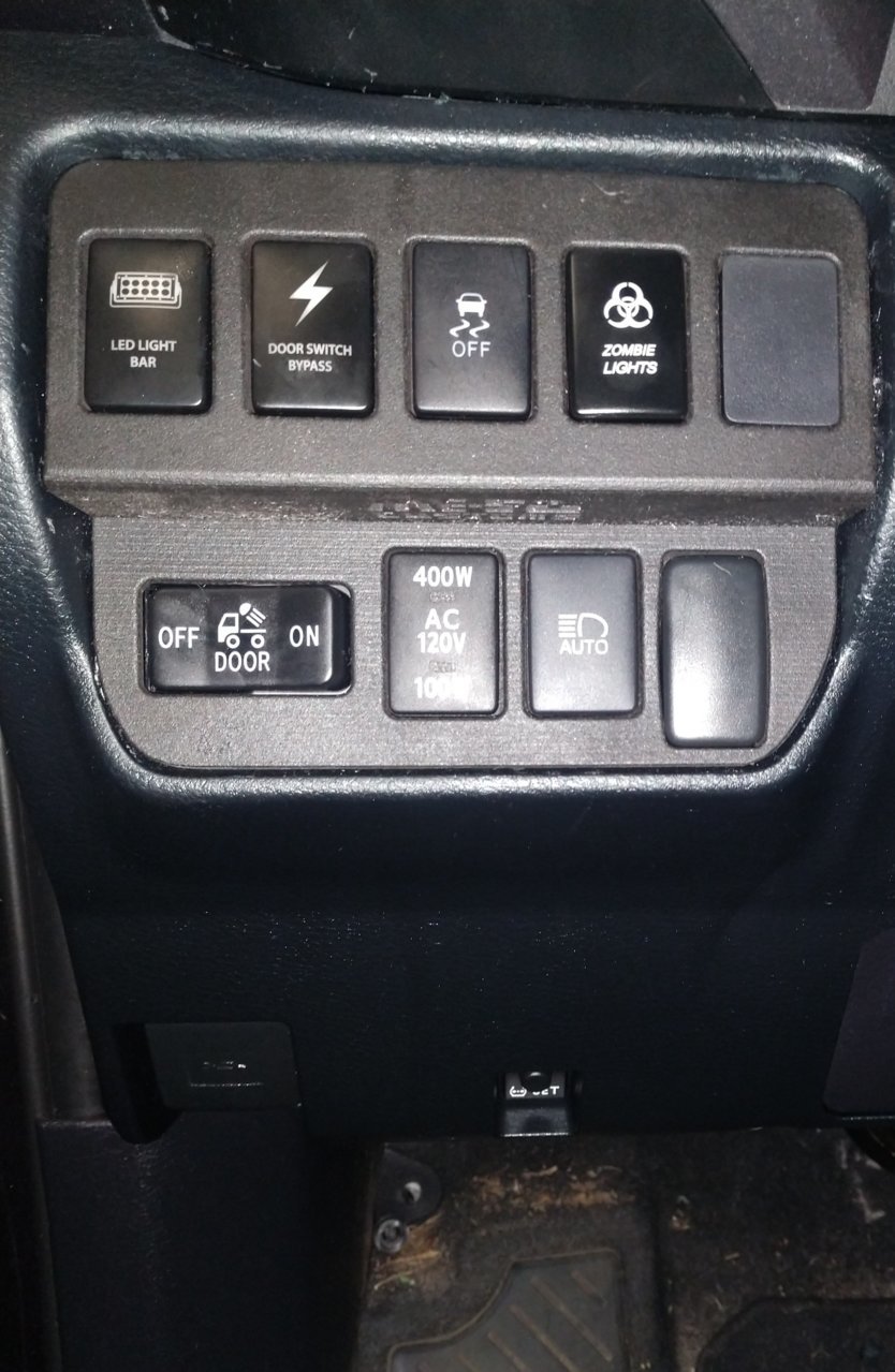

    Installed my MESO Customs Switch Panel, and CH4X4 Custom Door Switch Bypass switch. Because I got the 5 switches across the top, the two outer switches bump into pieces of plastic located behind the panel, and the panel will not snap back in place. I don't have a picture of that, because of how angry I was at the time, but long story short, the plastic pieces seem like remnants of where the cubby used to screw into. Mine is a 2020 model, so it never had a cubby, but the provisions for it seem to still be there.
    I used a Dremel tool to remove the offending pieces of plastic, and the switch panel now fits fine. The original post I made about the door switch bypass can be found here. Nothing fancy, just a nanny feature that bugged me enough to fix it.

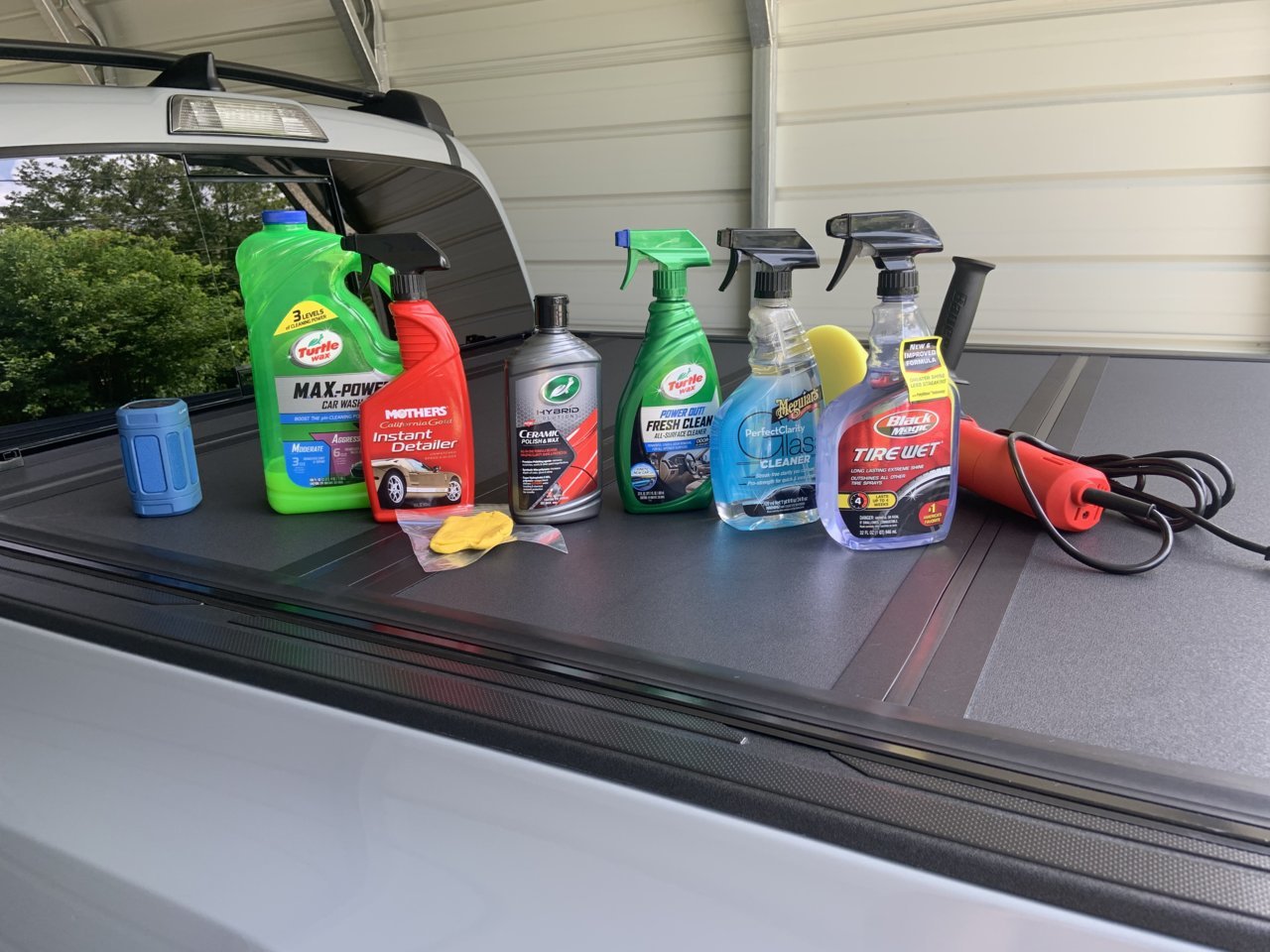

    Went hard on an exterior detail:
    pressure wash
    Hand wash
    Clay bar
    Hand wash
    Towel dry
    Turtle Wax Hybrid ceramic polish & wax with orbital buffer

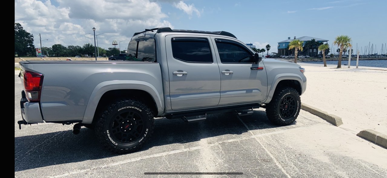

    Great looking hey is that a 2020 Tacoma I was looking at swapping mine but not sure about the sensors under the emblem do you have to place it somewhere else?

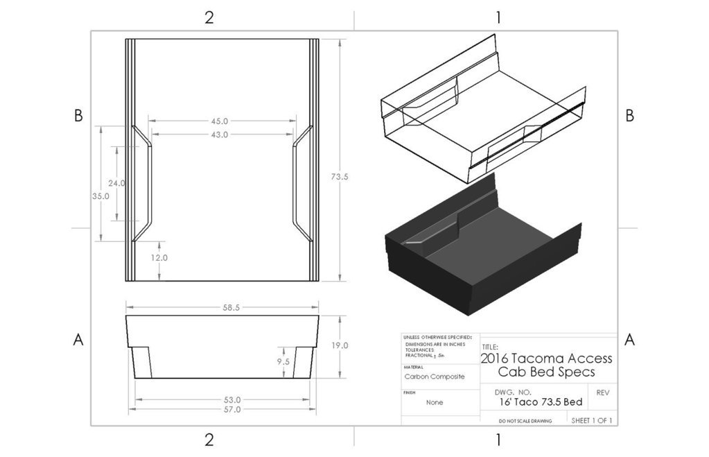

    Ya I thought about trying to set up something so you could fold it flat. The trick is getting the flaps to lock out ridgedly. The bed lip has a slope and will push the flaps in with pressure on the divider. I think there is probably a hinge out there or a combination hinge and lockout bar or something that would do it.
    I had extra wood from another project that I needed to use up. So this was cheap, 4 screws, reviewed this photo, and some test fitting. Tapered the flaps so they fit snugly.
    P.S.: Photo isn’t mine. I gratuitously stole it from some thread and can’t find / too lazy to really look that hard 33FD07F3-EE81-402E-A4F8-128625E071C3.jpg

    Is that white? Looks good.

    Me too, but I used Meguiar’s ultimate polish and ultimate wax.

    Looks good! I like that color :thumbsup:

    Yes white! Super easy install too.
