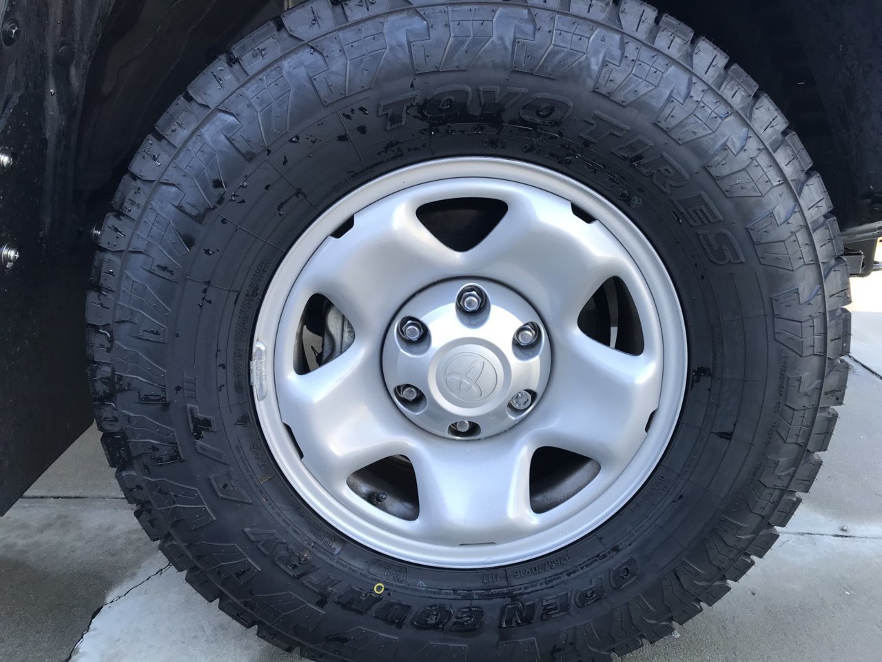

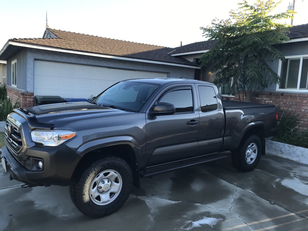

    Went bigger from 245/65r16 to 265/70r16 toyo open country at3 and gave it a good wash.92069928-6DEE-4FDD-B168-AD7516EC8BF6.jpg552DE07B-A8A1-43CF-B809-C6A3B84B140A.jpg

    How does the Toyo Open Country AT3? Is it quiet?

    It drives ok, no change in accelerating or braking. I do notice a little hum as I drive 60+ mph but I knew it was going to happen. I got the less aggressive tread tire. I’m just happy my tires don’t look like car tires anymore.

    They make the truck just glow!

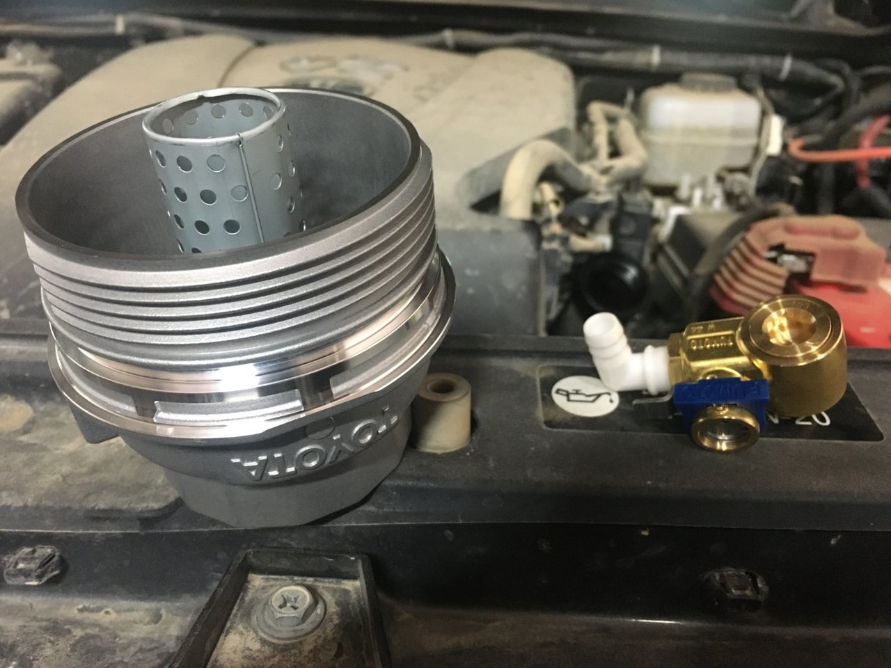

    Oil Change day, along with the diff oil after the 4.88 break in. :thumbsup:
    Added a lil' something to make future changes easier :bananadance:

    Well damn, I was just in HF yesterday looking at them. Great to know, thanks!

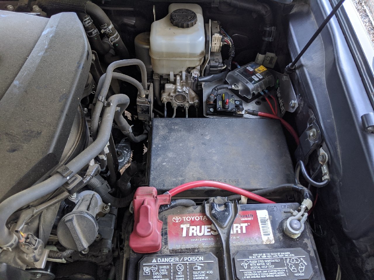

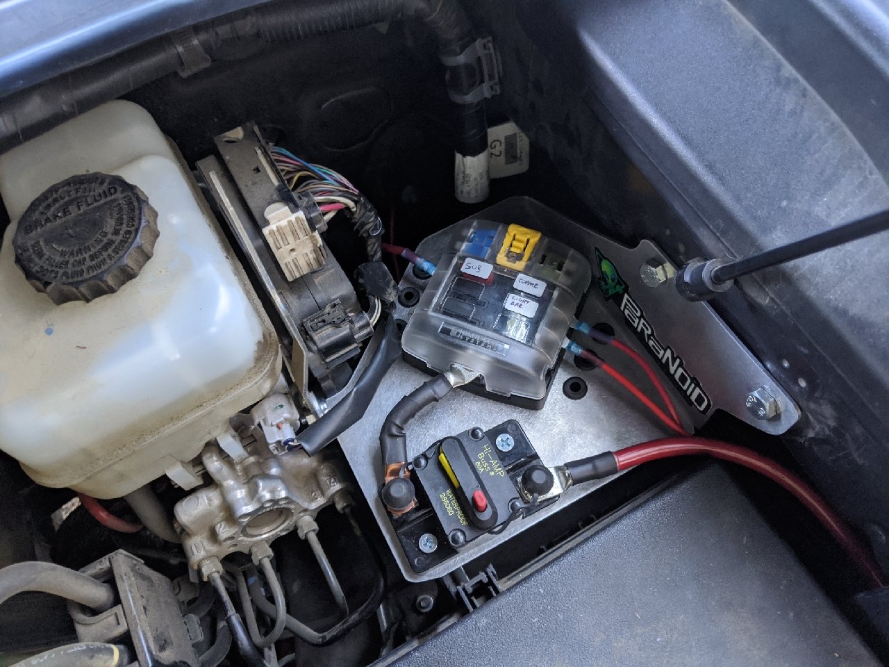

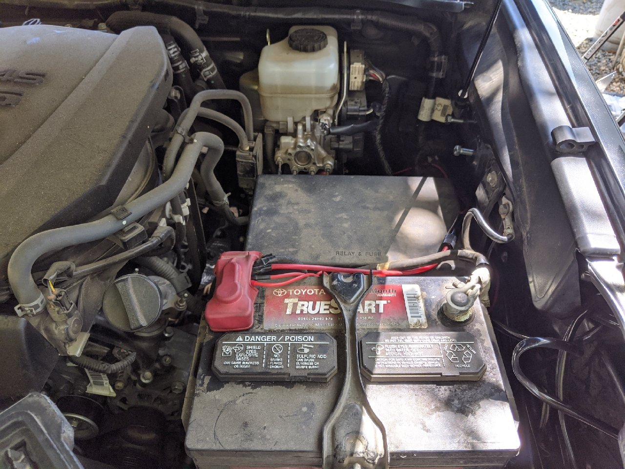

    Added a fuse block today. I've had some hurdles since I've never done anything like this before. The connectors were too big so the grommets I installed were too close for me to run the wires underneath. I also had to relocate the fog light relay box since I bought the lower mount from @paranoid56, should have gotten the higher one. But I got it all figured out!
    And no comments on my super dirty engine ;). I'm afraid to clean it myself since I made the mistake once of doing that to my Jeep and something electrical must have gotten wet and it was a huge issue. Plus I drive on dirt roads almost daily. Trust me, I hate that it’s that bad.
    Also, it looks like my battery needs some attention. That’s for another day!

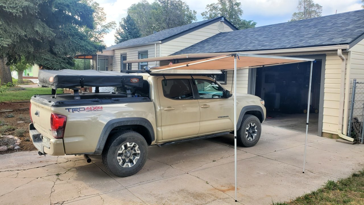

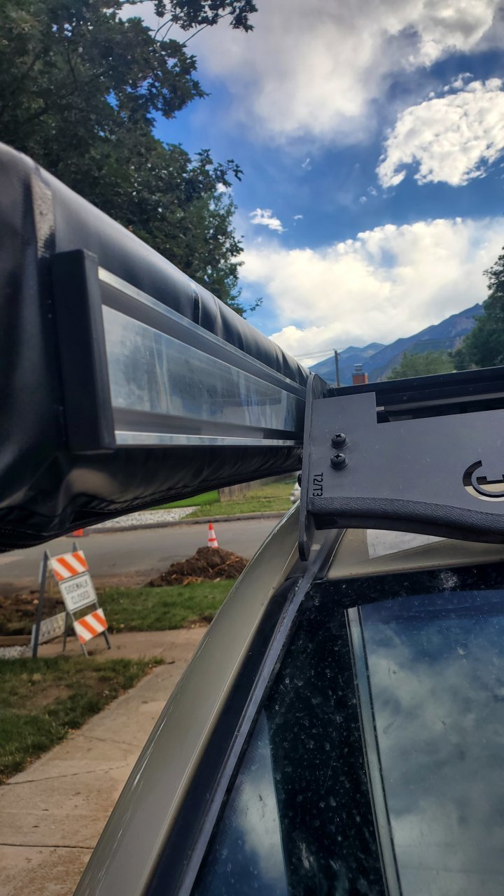

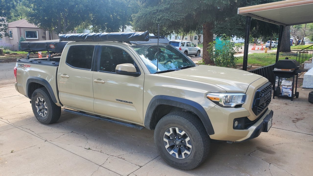

    Installed an awning today

    This is awesome, where did you get this?

    Suggestion on running the wires to the fuse block: pull the grommets out, feed the wires underneath and through the grommet, then pop the grommets back into the holes.
    Regarding washing the engine: all the important electronics should be waterproof protected on your Taco. I wash my engine bay at least 1x per month. I throw a pail of soapy water over it, brush of the road debris from the top of the engine and inside of the fenders, then spray off with a light sprinkling of the garden hose. then leave the hood open for the engine bay to air dry. I have never had an issue of washing the engine bay this way.
