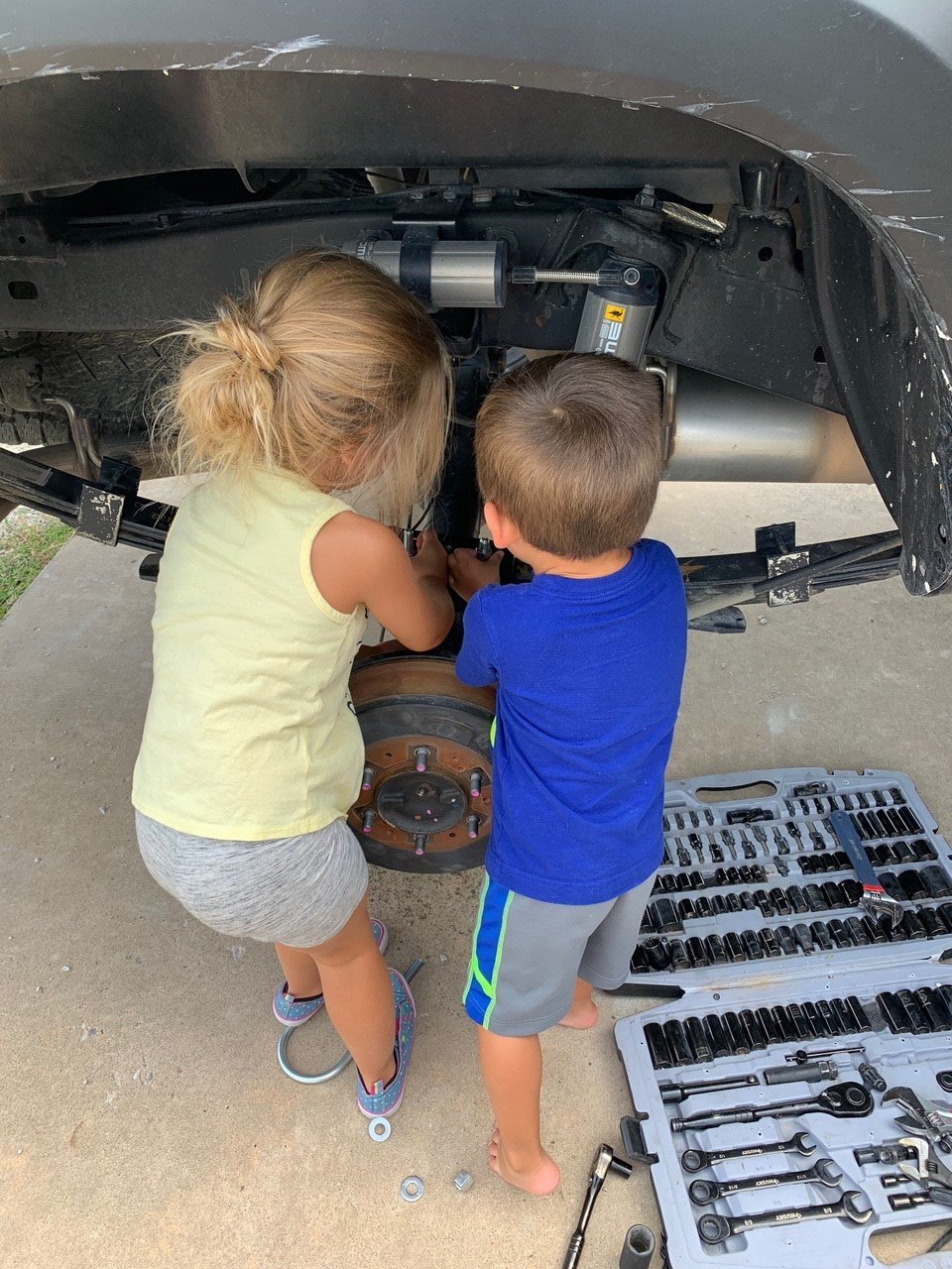

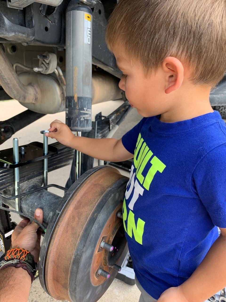

    Installed Timbren bumps in the rear with their U-bolt flip kit, with a little help from my friends (gotta start them early). Gained 1.5" more ground clearance at that location. Previous was 12", post 13.5".

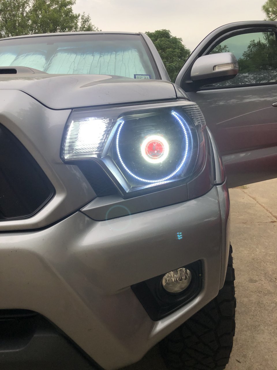

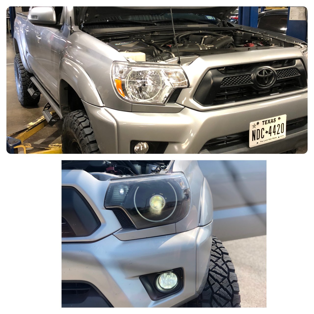

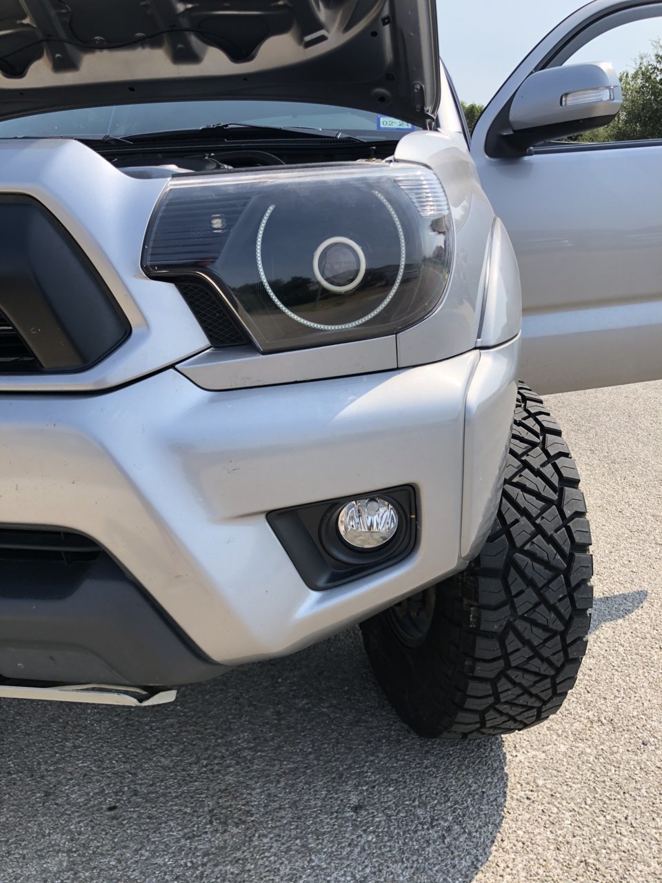

    Retrofits done in 104 degrees yesterday. Silly texans AAAC9EAA-9F83-4AB7-BB27-8FA4B5D82E74.jpgBAF01421-5614-45B2-B5AC-41BF361D130A.jpgE9DDF705-F21F-4E42-A2D7-38DDA5B2D6B0.jpg

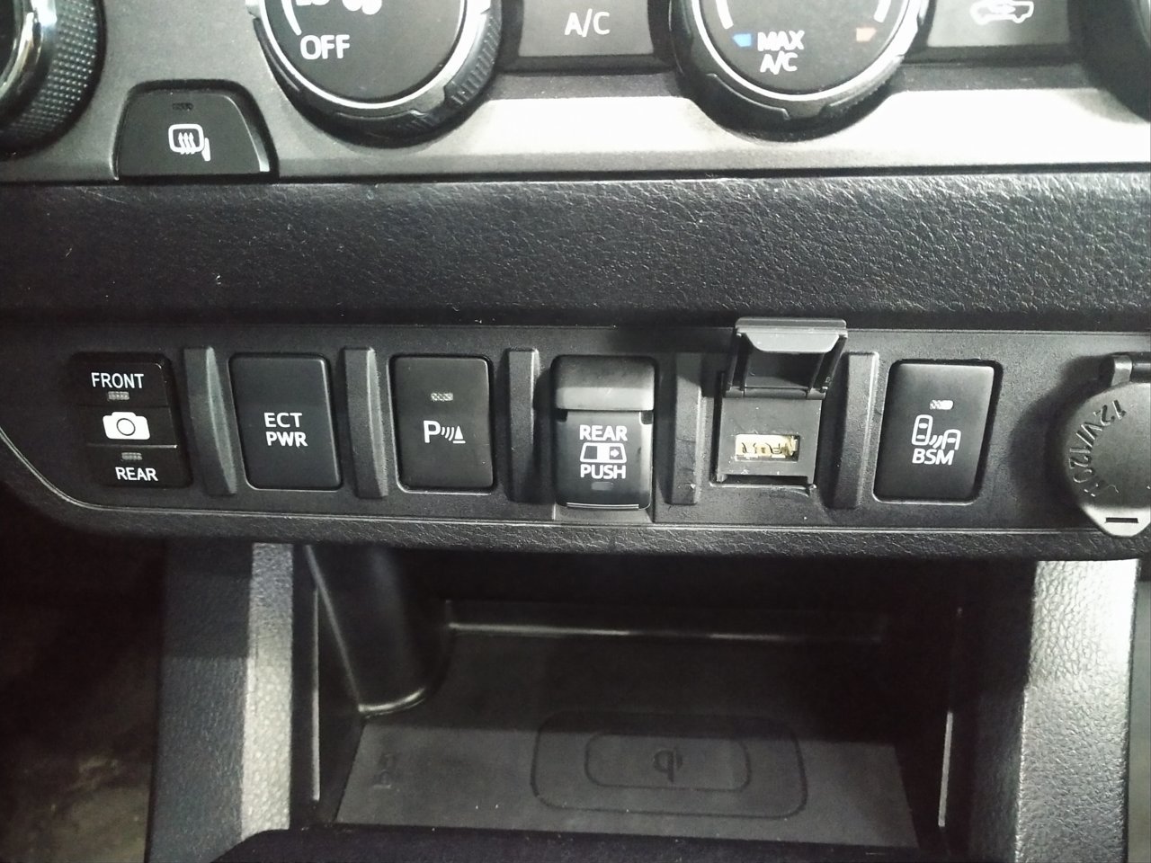

    Hey Goatfrog. I had that issue when I moved my BSM switch over in place of my Qi charging switch (never use it). So the stock OEM switches that come on the truck have little ridge on the sides, and they are in different places depending on what switch it is. The stock panels on the truck have little notches in different places that these ridges slide into, so a switch with a ridge pattern that doesn't match that channel pattern in the panel won't go in. When companies like MESO make their aftermarket custom panels, they just max out all those notches so any switch will fit into them.
    When I moved my BSM switch over, I discovered the patterns didn't match, so I had to take a dremel tool, and very carefully open up a notch on the panel, so the switch would slide it. It's a pretty easy job, once you realize why the switch isn't going in, and what plastic you need to remove, and the part you're cutting out is covered by the switch when it's installed.
    So, if you ever run into that problem adding, or moving switches around, there it is.
