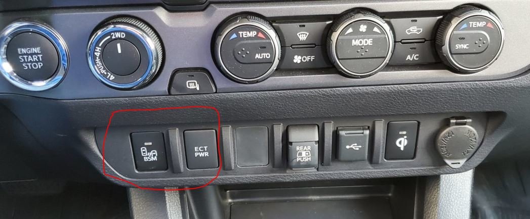

    I don't understand the thinking with regards to the location of these switches? They should be to the left of the driver freeing up valuable space in the centre.

    There should be 3 categories of switches.
    Lights
    Drivability
    Comfort
    Lights on the left side
    Drivability overhead
    Comfort in the center
    Auto high beams, cargo light, 120v inverter on the left
    ECT, diff lock, traction control overhead with the crawl control settings (OR and pro only)
    BSM should be on the steering wheel really
    QI charger, rear window, USB should be in center.
    When adding more switches, people tend to do more lights, and more interior comfort things like heated seats, more usb ports and the such.
    These changes would greatly help those of us who like to add more switches and get custom switch panels.
    But this is just my thoughts

    ...and it's a good one shared with many I think.

    I would love to find replacement male and female plugs for all the switches so I could make extensions to put them to where I think they should go. But I think it would end up as just a rats nest of wiring.

    Yes, a PnP harness extension would be ideal. Otherwise cutting in the middle and extending in the only other option.
    I've considered moving the ECT button to the centre console beside the emergency brake to free up one spot. My OR doesn't have as many switch locations as the Sport or Pro version does.

    I agree with your classification of switches. I do not agree with the placement.
    Drivability switches should not be on the overhead. Much like blinkers, hand brake,cruise controls, lights, and fogs they should be placed in such a way that it is "natural" for a driver find and use the switch. It would require taking eyes of road or training and practice for most drivers to find the appropriate switch for the task at hand. I have had the truck sine 2017 and still have to look to find the moon roof controls everytime I feel the need to use them.
    Admittedly some driving controls are ideal in the overhead, low speed selections and or less commonly used items. Things like crawl control are good up there as one is not going to be doing 80 on the highway with the need to switch crawl modes. Frankly I think 2-4 wheel mode selection would be better on a stalk as they used to be, however where they are sucks the overhead would again be a better location. how many times does one switch driving modes at speed?
    Qi I almost never (I think 2x since the 1st week of ownership) use. I have not used the stock radio input/usb even once. BSM, Park sensors stay on unless towing or tailgate is open while driving. I know before moving if those conditions apply. I added a high speed dual USB charge port when I relocated the ECT. 2017 did not have auto lights but that switch could live down there as well since it would likely rarely be used.
    I like and want my ECT on the left where I can reach it during the drive as I not infrequently switch it on or off as conditions change. As such that is where I have moved mine directly in front of armrest, I need only extend a finger and punch forward to use it eyes can stay on the road.
    We all have our own preferences.
    @5nahalf has the right take, if we could easily by the M&F plugs for each of the switches it would be child's play for most of us to relocate the switches to our preferred locations.

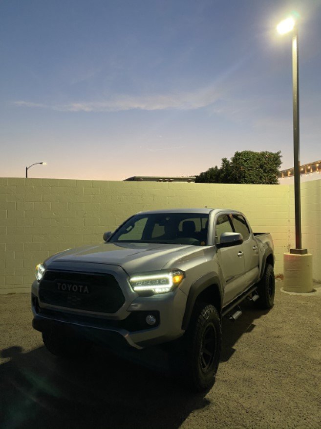

    Is it safe to pop the A pillar cover off to run some wires behind without disturbing the air bag? TIA.GOPR3873.jpg

    Yes. You remove that circle that says "SRS Airbag" and there's a bolt behind there. Remove the bolt, and the pillar cover comes off.
    You can see someone do it here: https://www.youtube.com/watch?v=J13mRWO162k
    fast forward to the 34 minute mark.

    Yes and Disconnecting the battery first is highly recommended.

    Nice truck! If you decide to place inserts in your tailgate letters, I can recommend gold. Barcelona Red isn't exactly right, but as close as you can get to Scarlet Red & Gold. SF
    Mine is a '17 AC, 4x4. Couldn't be happier.
