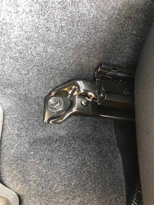

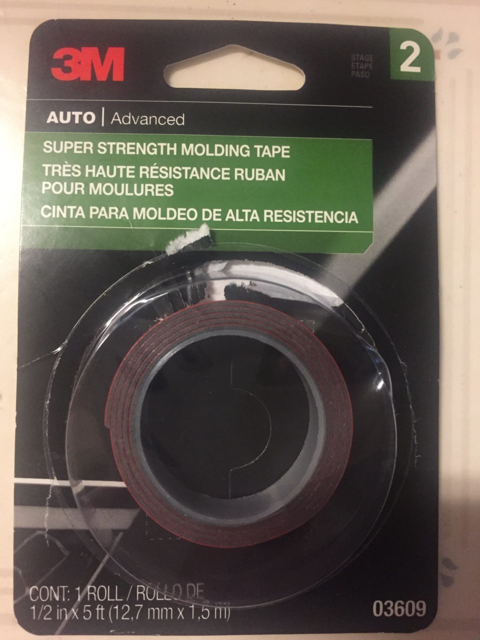

    Honestly I read the same thing, so I peeled the cheap stuff off and used this 3m narrow tape instead. Mine are attached very well. Also, alcohol the metal seat tracks off first.402D94B6-5E10-4709-8EC3-1DFCC6DBD8EB.jpg

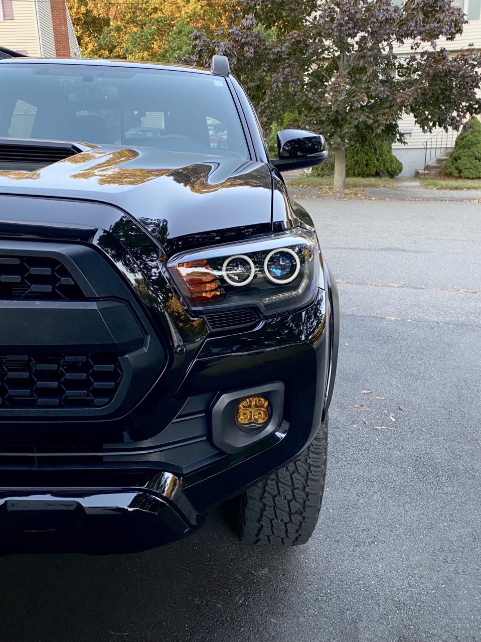

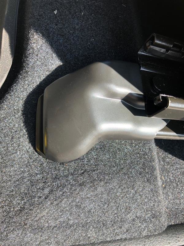

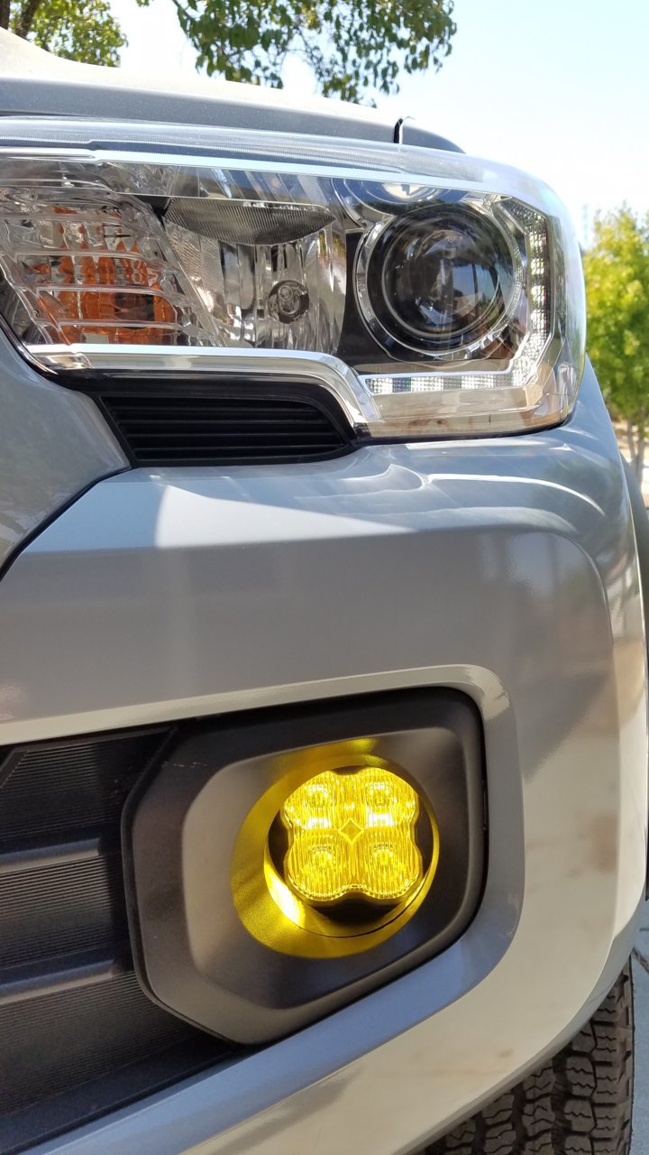

    20200920_130306.jpg 20200920_131757.jpg Installed Diode Dynamics SS3 Sport Fogs and some black cover things.

    Cool- you did a great job.

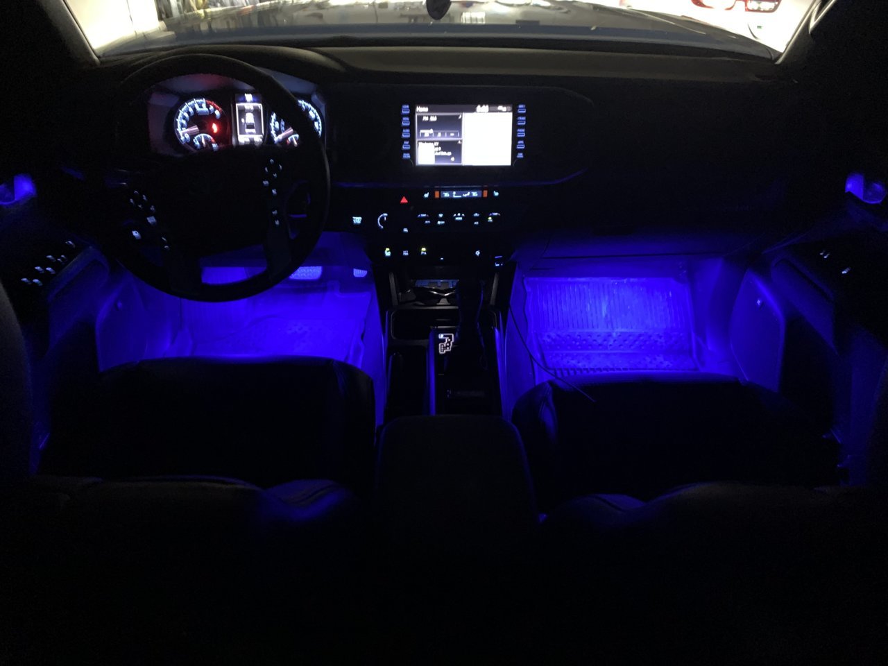

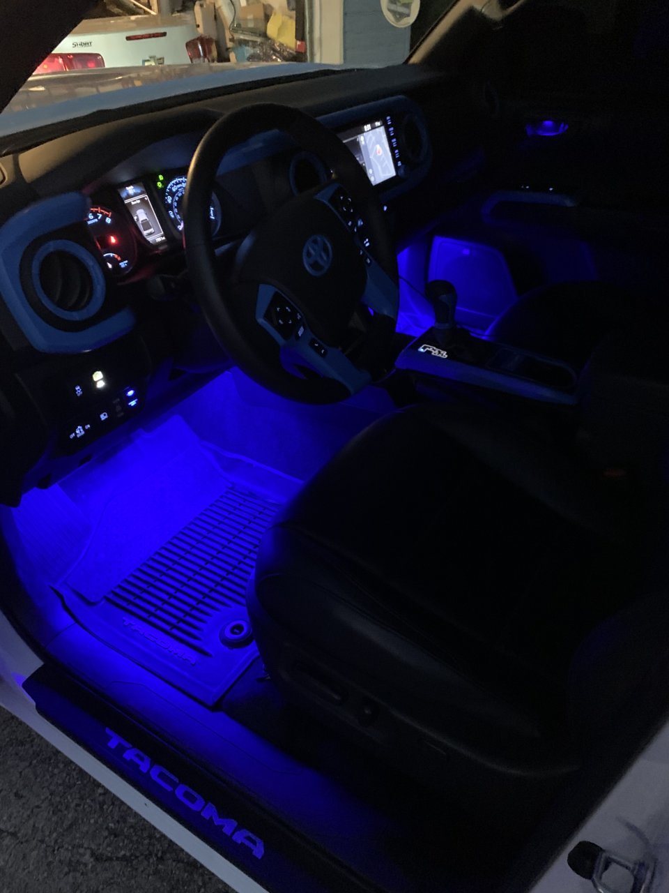

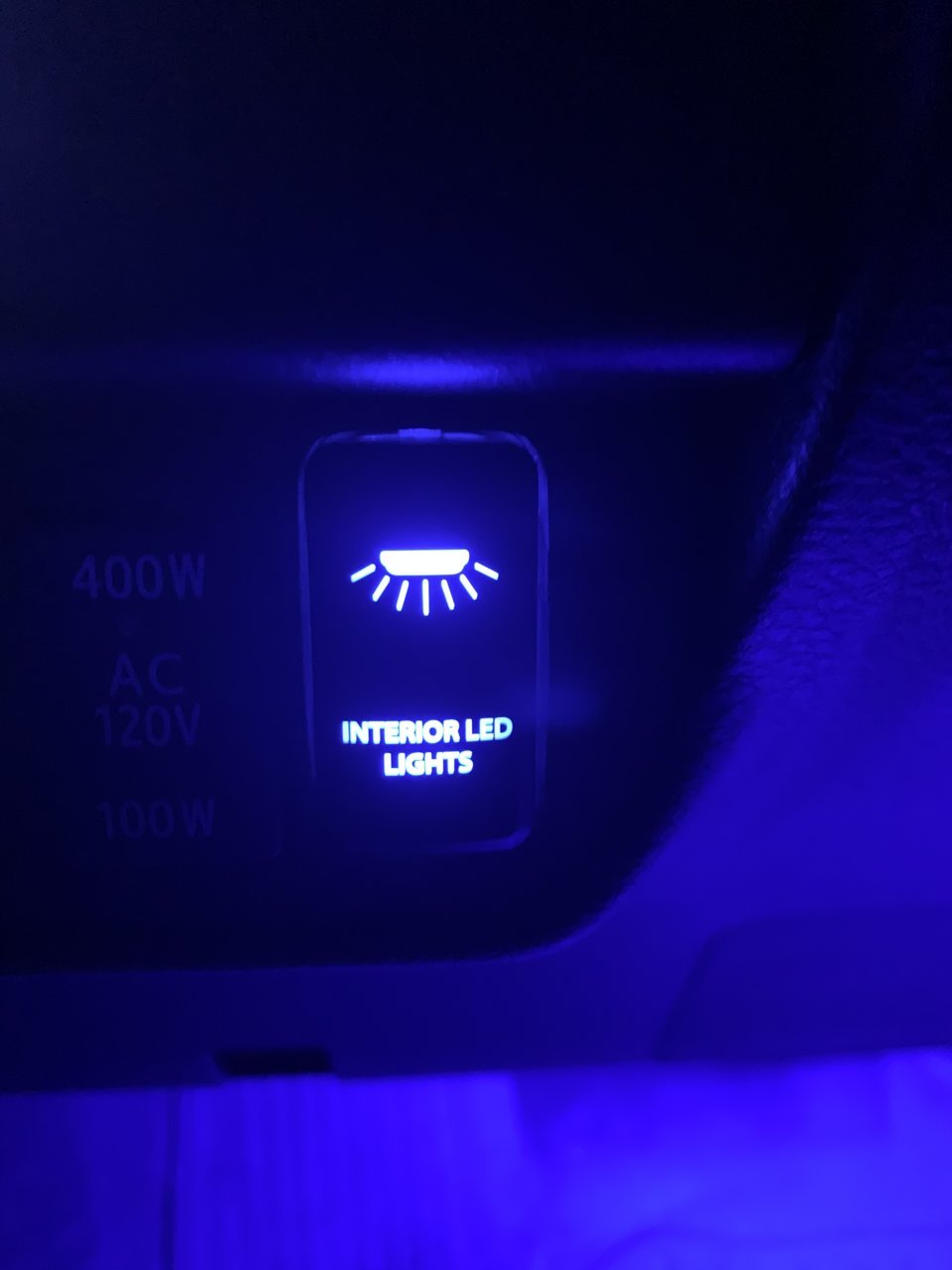

    Some nighttime shots of my accent lighting I installed today.

    Thanks for the info, I will do the same thing.

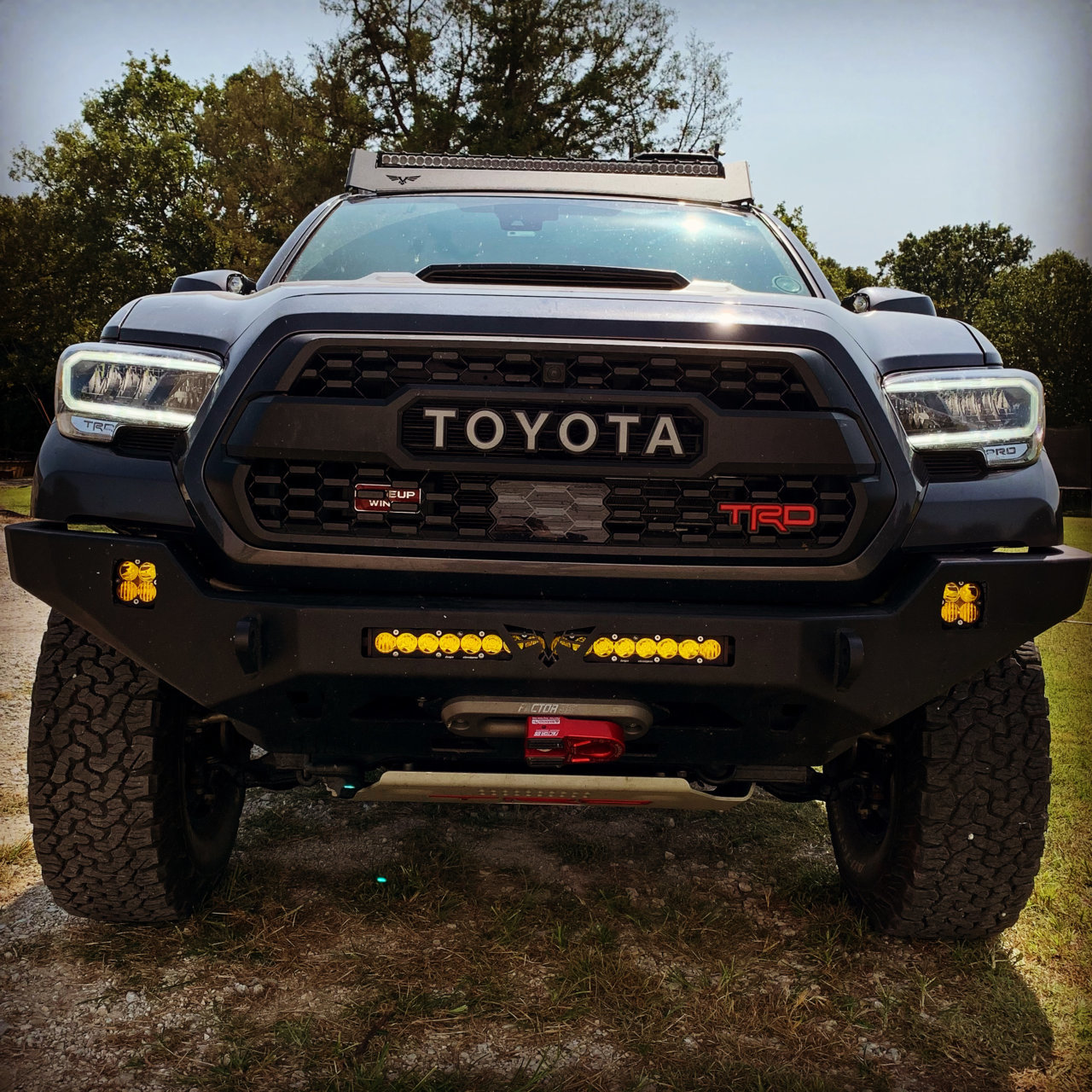

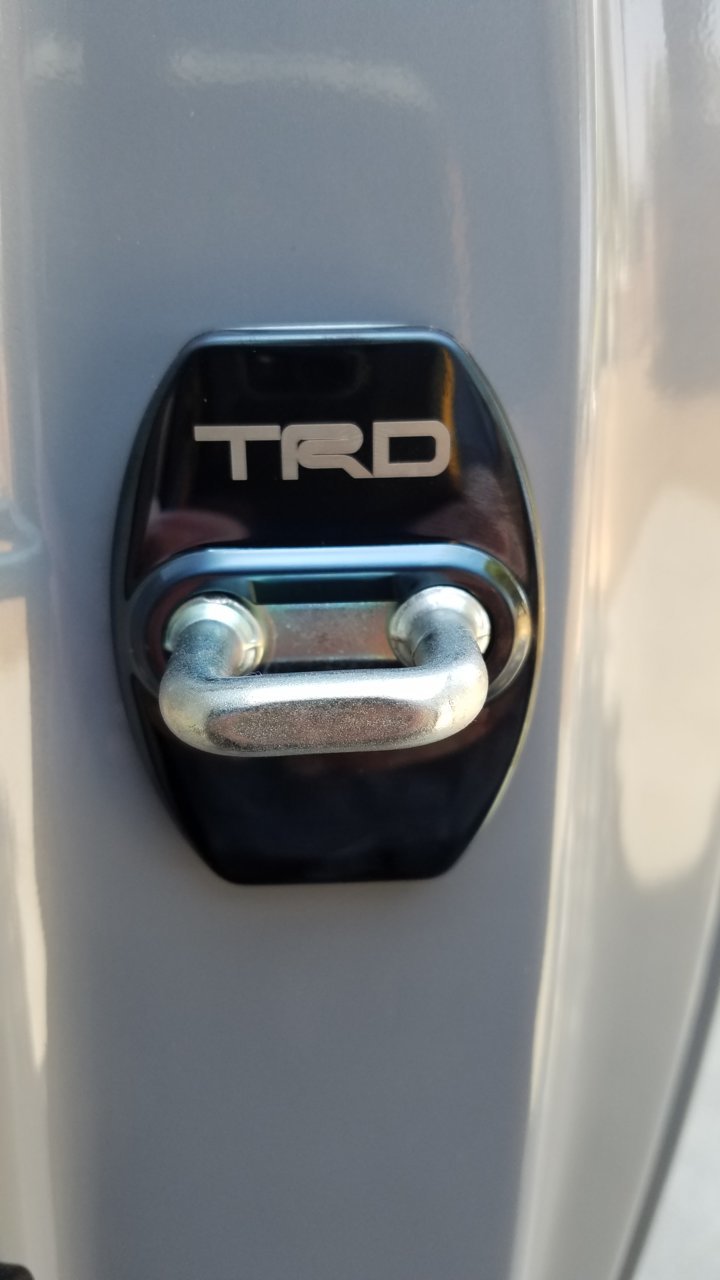

    Swapped lenses on my bumper lights. Went from clear spots on the 20” bar to Amber’s. And clear driving combos to amber driving combos on the squadrons. The 20” spot was basically useless after getting the 40” heretic bar up top. Added the TRD badge and not seen, added durabumps to the front to go with the Timbrens in the rear.

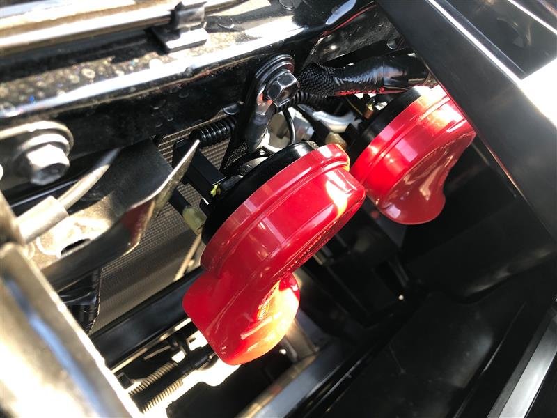

    Does it sound louder or just different?

    Did going to the amber lenses change anything? I can't imagine they would be more performant, they would just look good right?

    Just tested them out this evening. My. 20” was a spot and was completely washed out by the 40” combo in the roof rack. Couldn’t even tell the 20” was on. So, amber is supposed to be better for dust, rain, fog and snow. To be determined. I tried them out tonight and they are definitely easier on the eyes (in front of the truck and behind the wheel) while still lighting up a good area. I ran just those 3 amber lights and was able to navigate my 100 acres I have here at my house without issue. Will be good for going into camp sites late and deer leases early and late for my immediate needs. We’ll see how they do in dust, rain, fog and snow as it happens.
    **edit: wanted to add that I prefer the look of the clear lenses but am a form follows function type of guy.

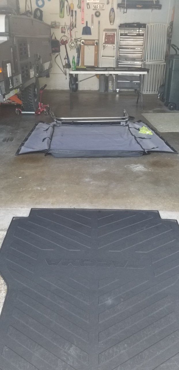

    The bed mat was a game changer for me. Such an easy + cheap + functional mod. Stuff stays put now

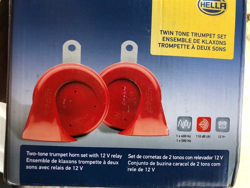

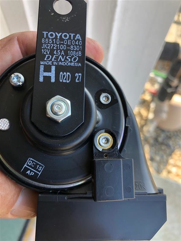

    It sounds different. The Delco horns are loud (108db) but its two of them. The Hella Trumpet horns are a bit louder (110db) dual tone (400-500 hz) so it's distinctive and grabs your attention.

    Higher pitch or lower or just different?
    Did you consider disk vs trumpet or just trumpet?
    I’m considering as well but really want a low cost low pitch not much louder option.

    I'd say its a higher sound than the low sound Delco's but its pretty close - maybe an octave higher but not much.
    I've got the disc ones on my Prius and those are much higher - which is why I went with the Trumpet ones.
    The Delco's are both high and low horns so you get a dual tone affect - but its lower for sure. I wanted a bit higher tone - so bought these.
    86520-0E020 Low
    86510-0E040 High
    I can't seem to find anyplace with the hz rating for the Delco horns though.
