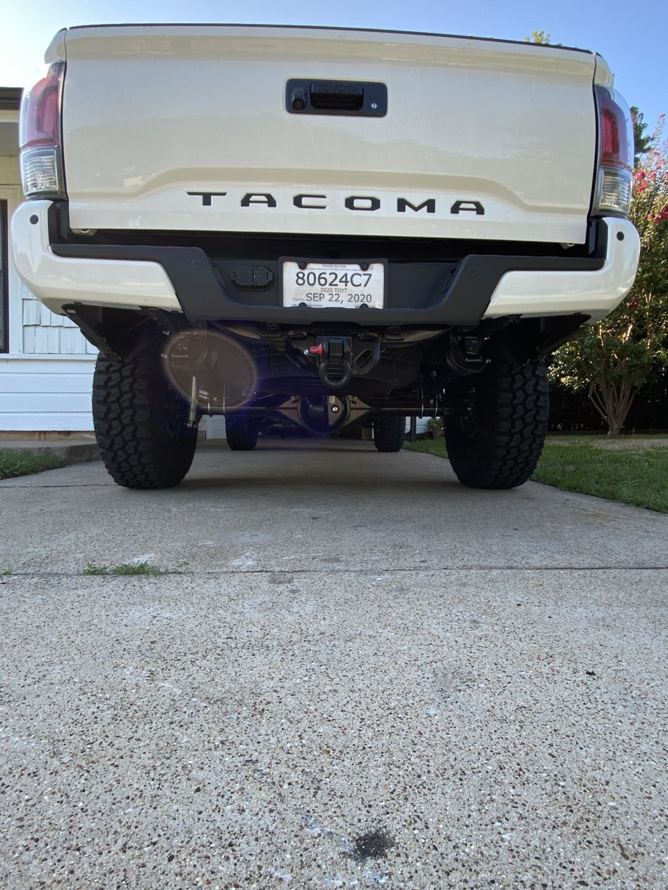

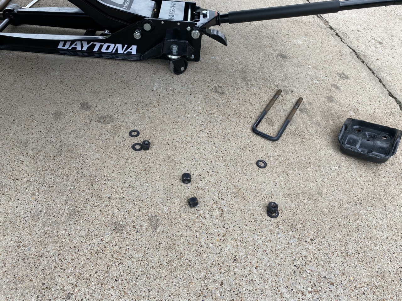

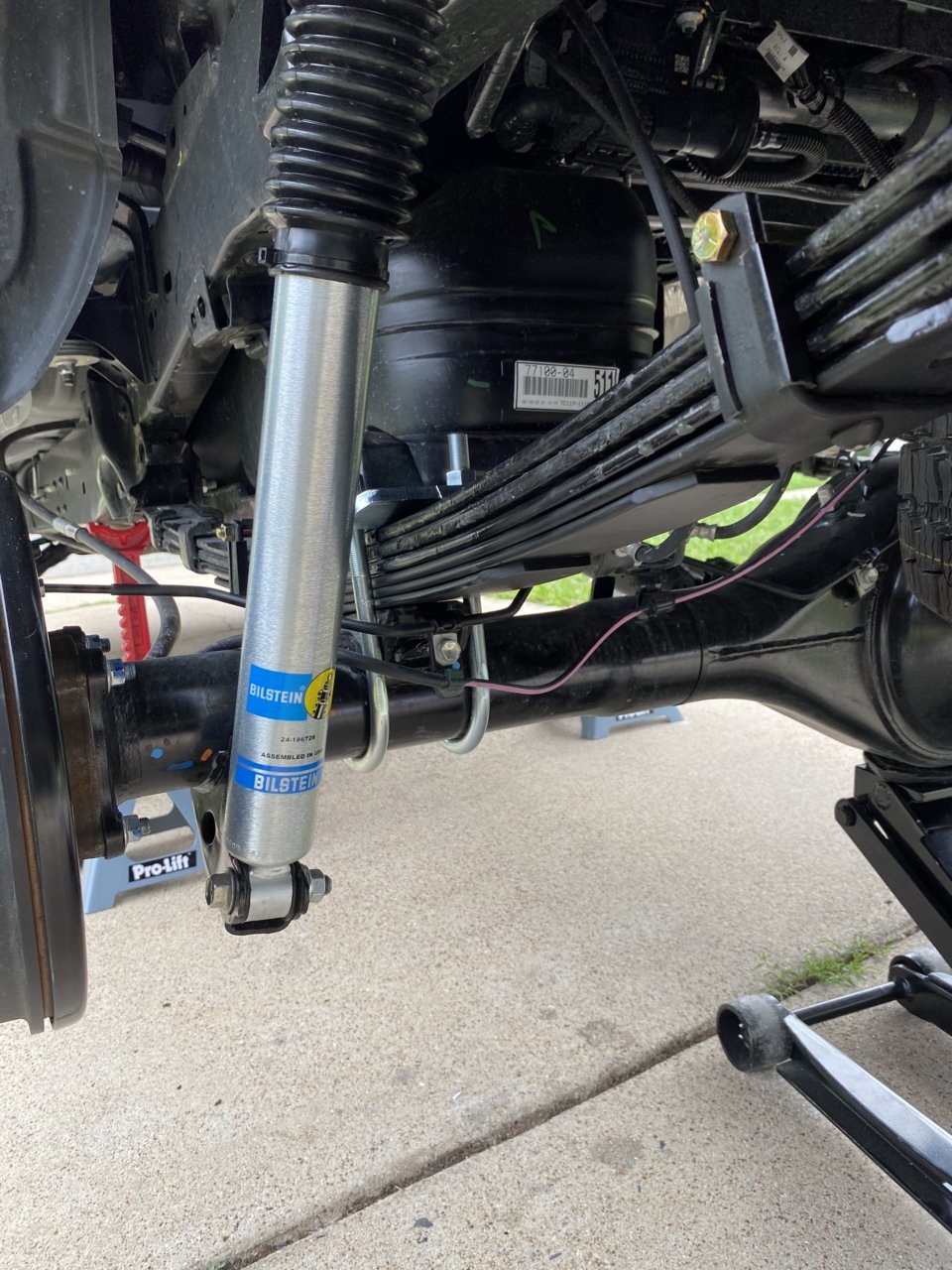

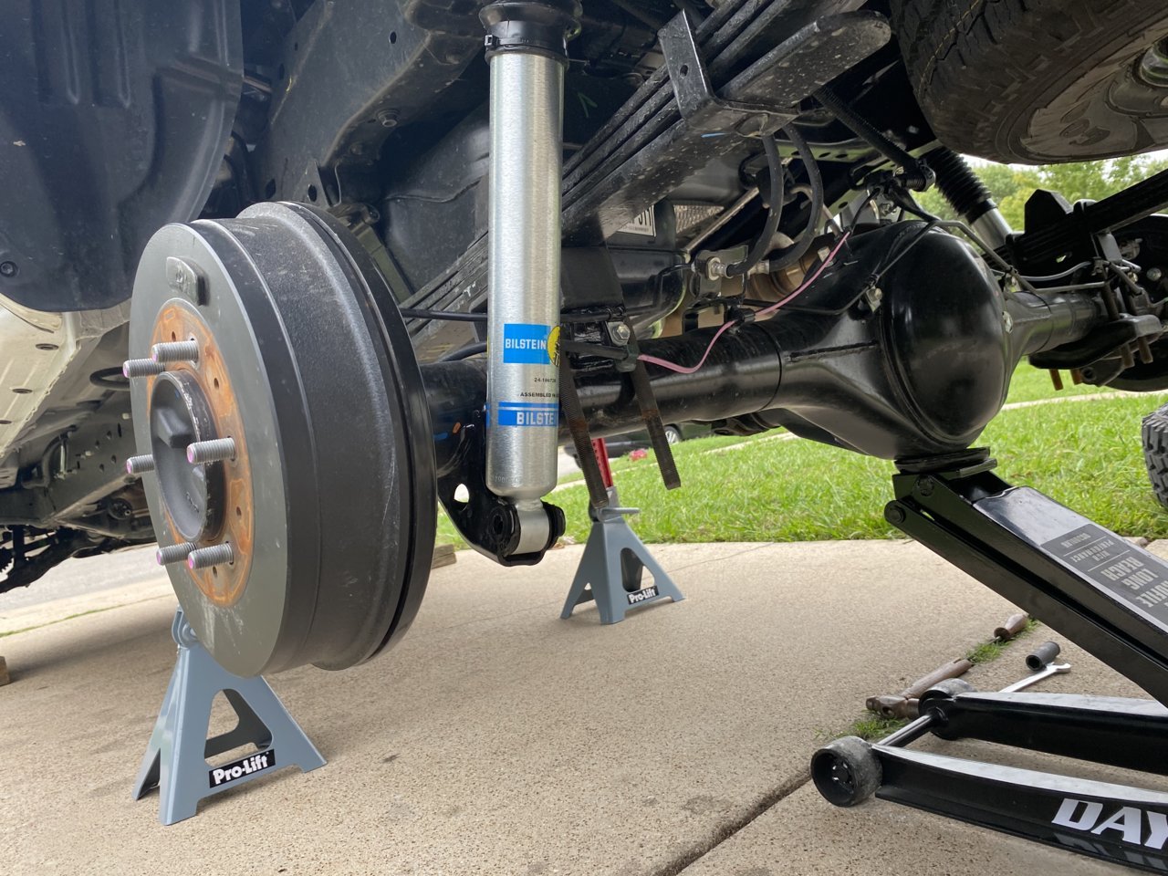

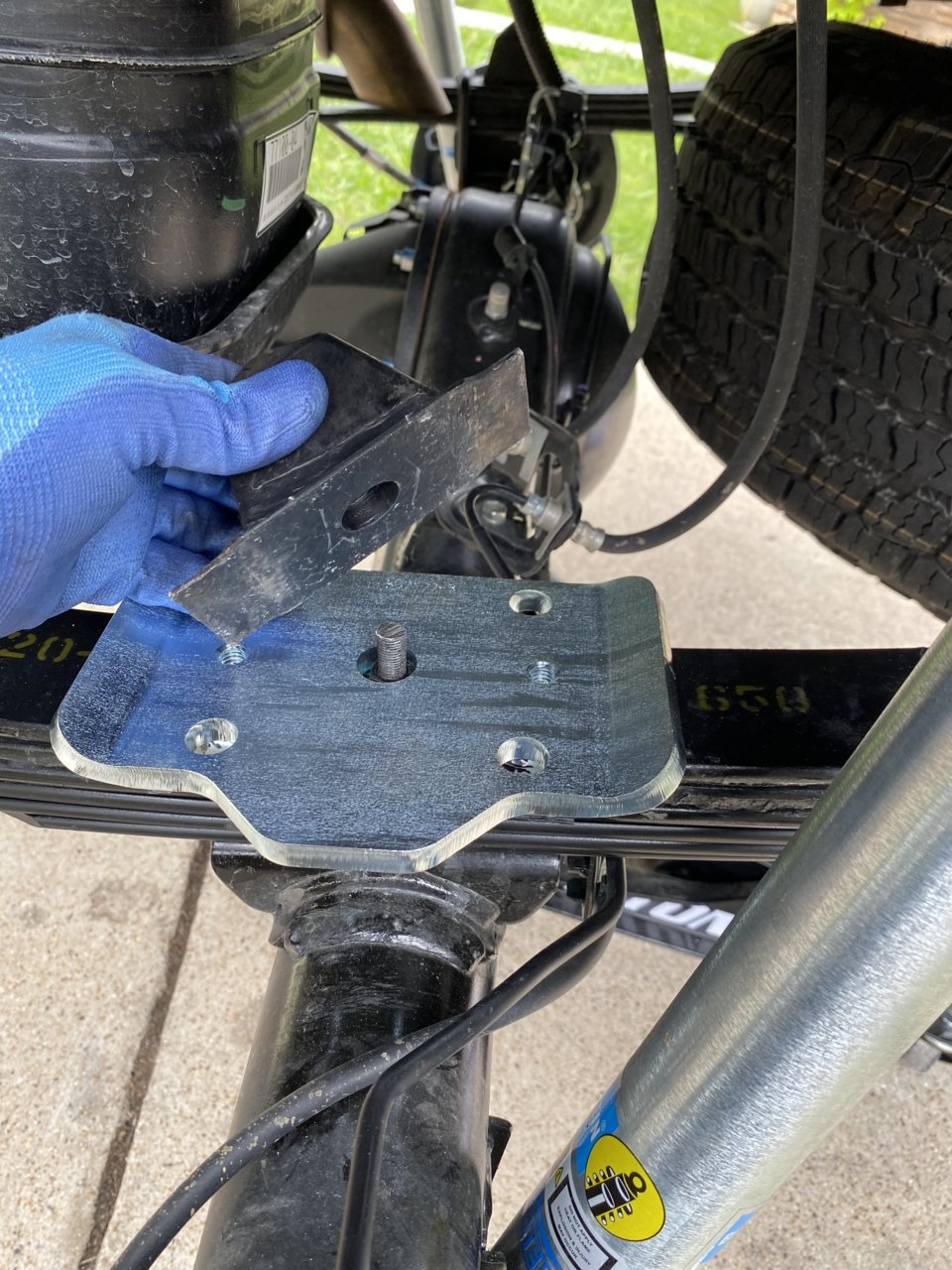

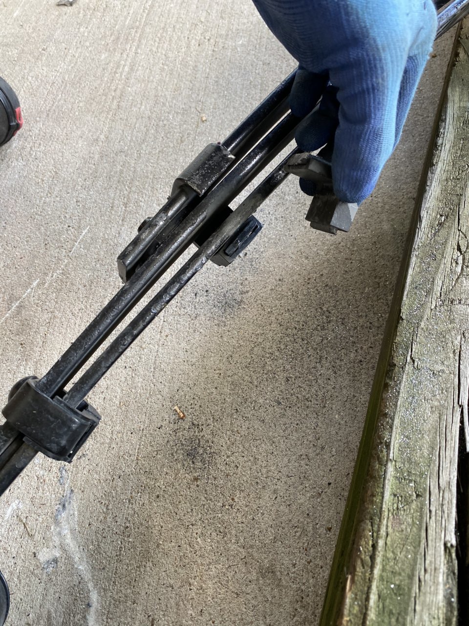

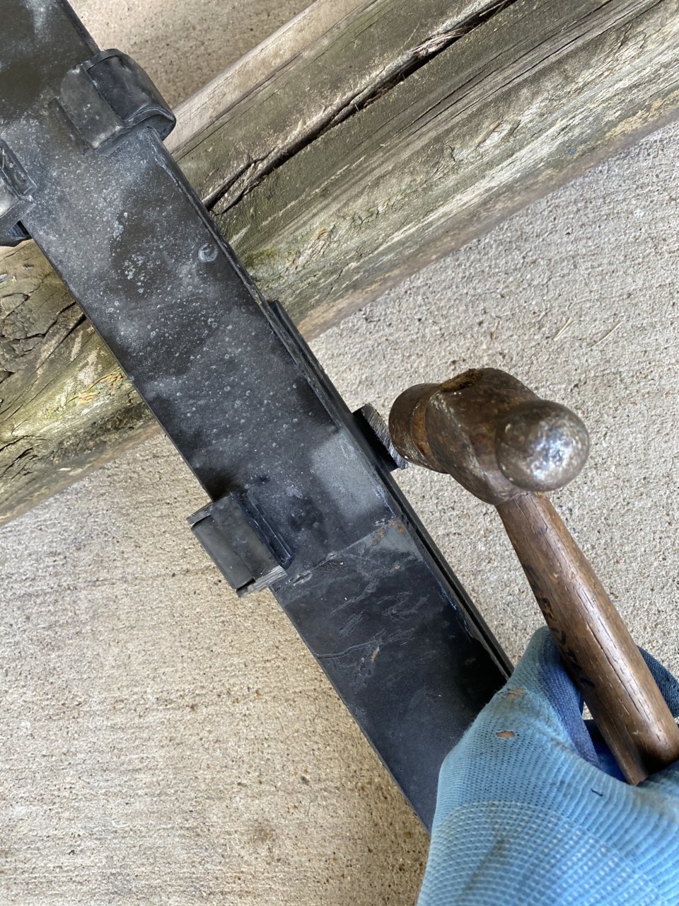

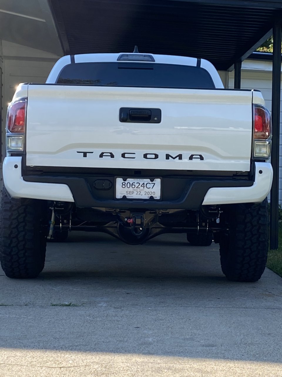

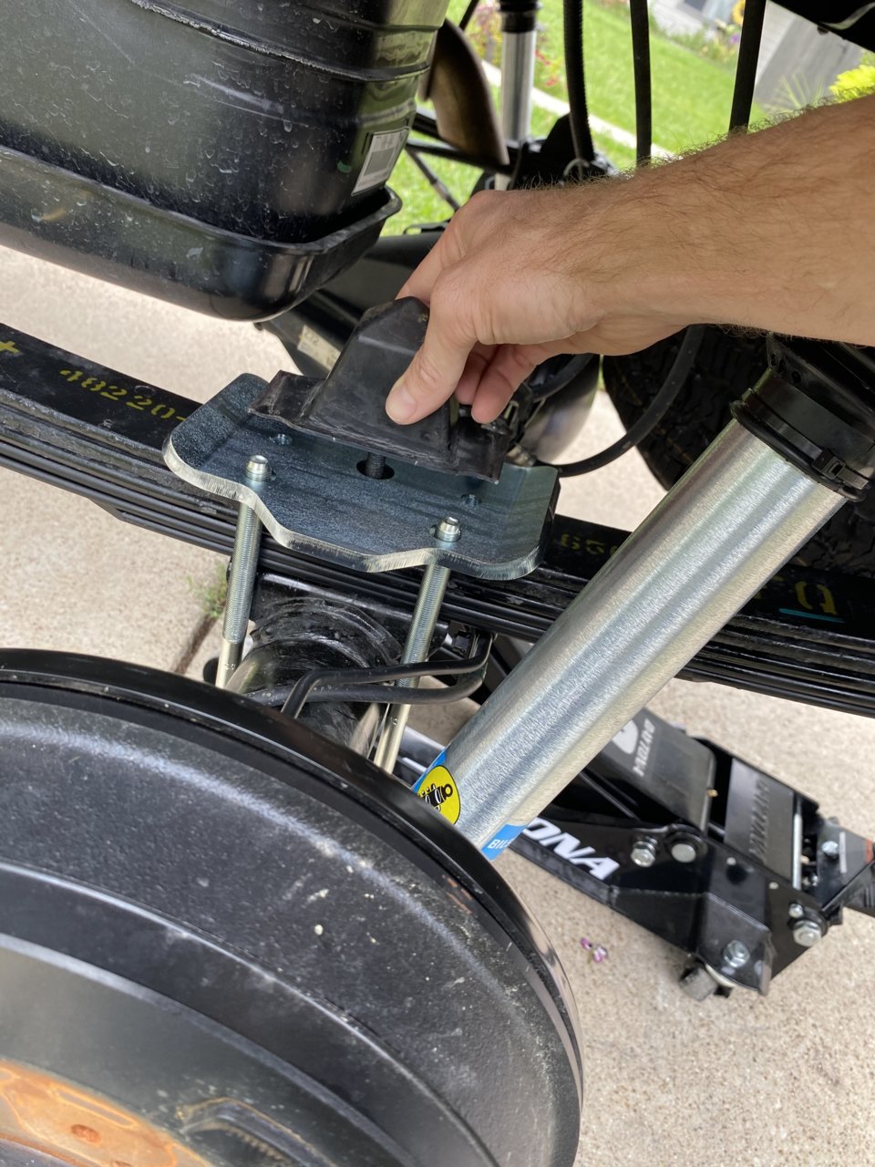

    Lots--

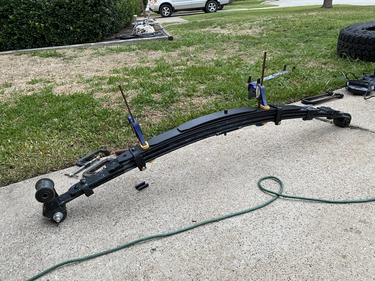

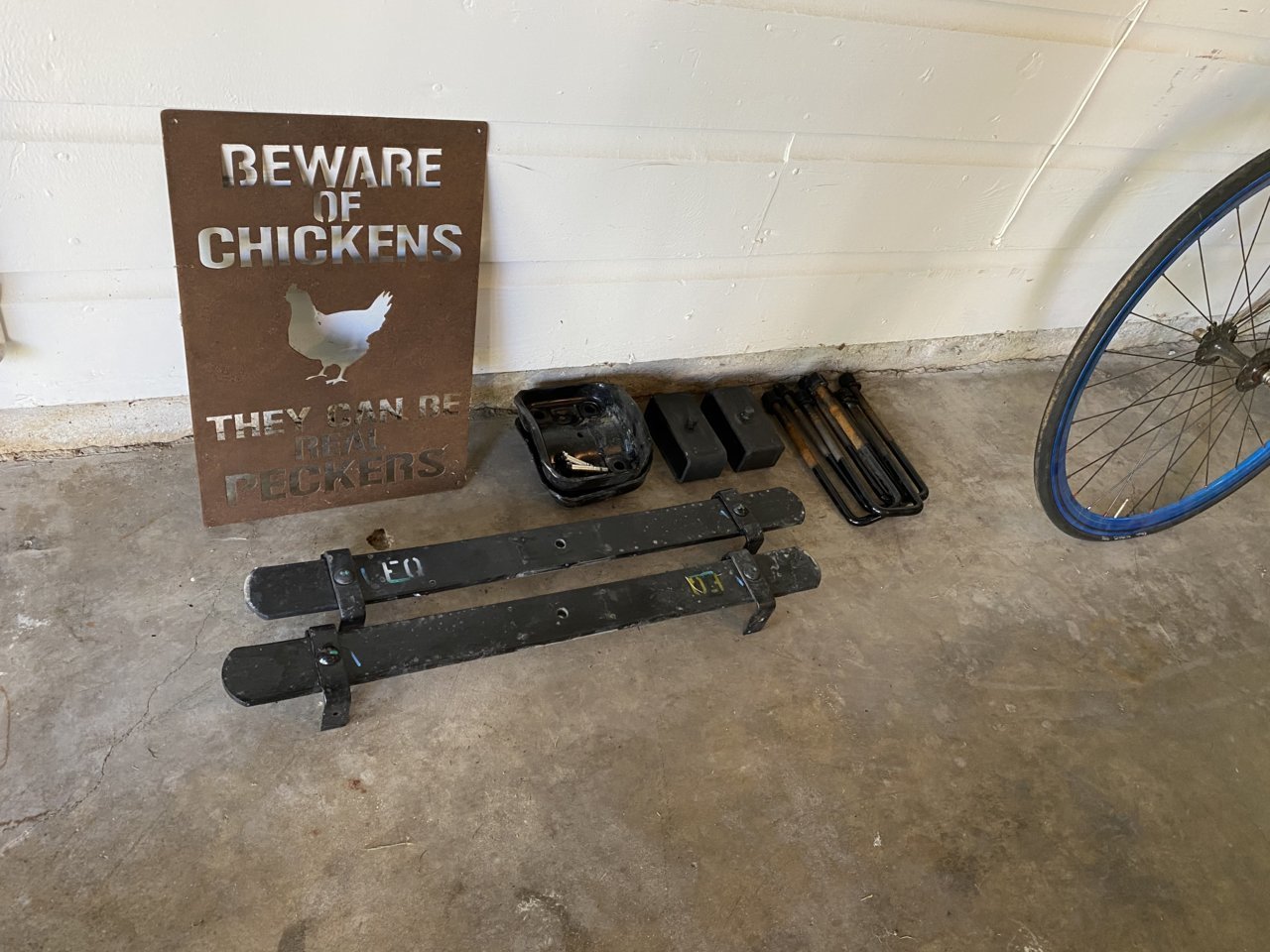

    Swapped 2” blocks for 1.5 icon AAL paired with 5100s and a wheelers u bolt flip

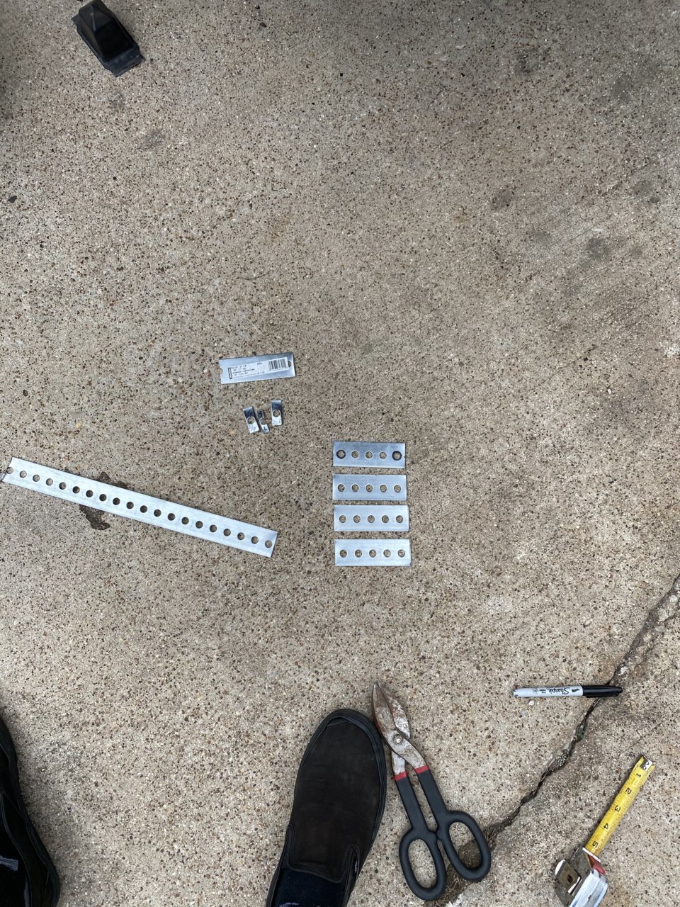

    I actually repurposed the stock bump stops. Used a piece of steel and put 2 strips holding it down after I cut the lipped edge off the bump stops. See pics. I got my last package from Headstrong. .5” spacers for the front coilovers. Still a bit lower than I’d like. Also will help with Rub hopefully. The stock rims with these tires only rubber the UCAs prior to switching to these -12 offset scs br6s

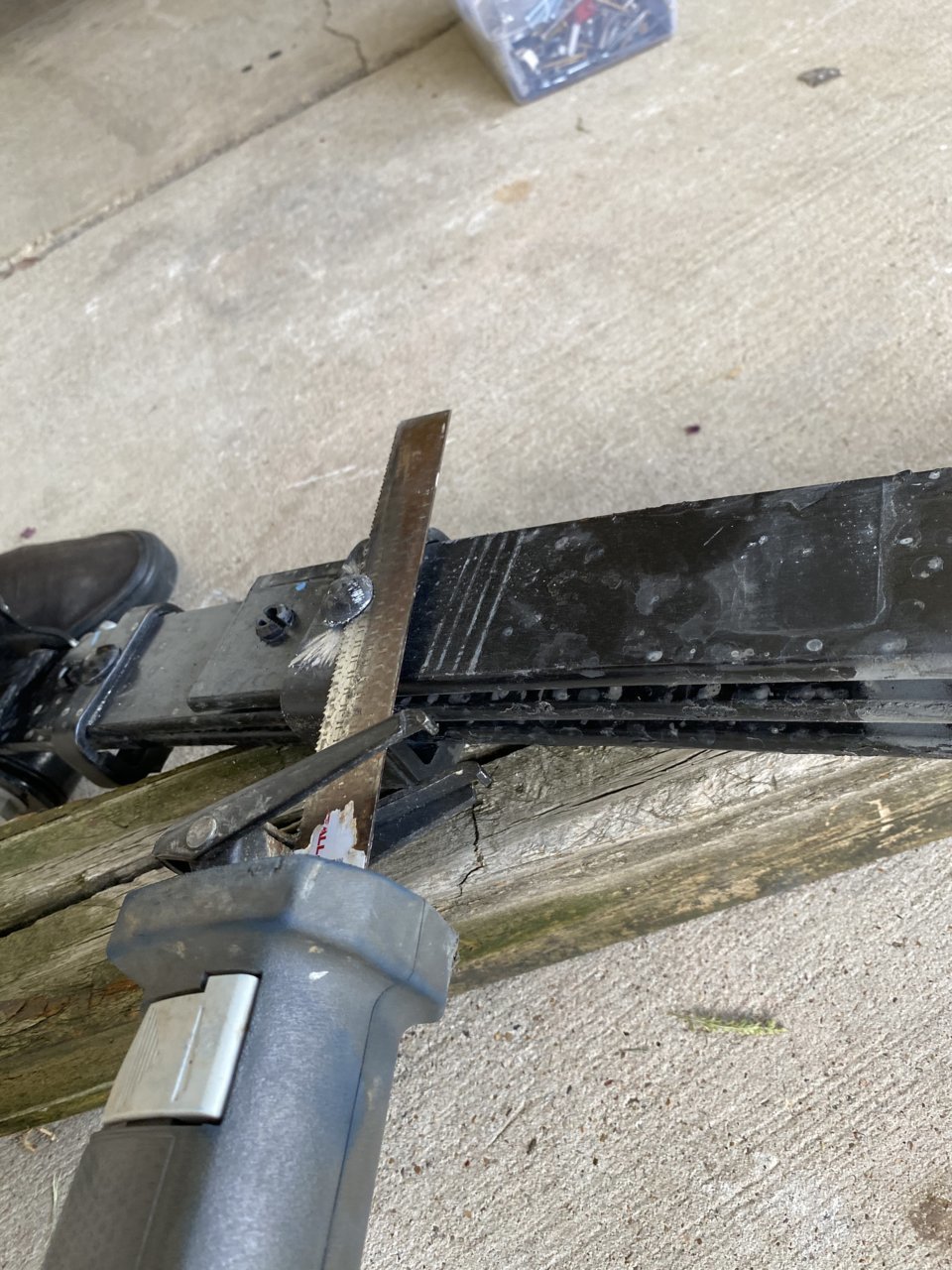

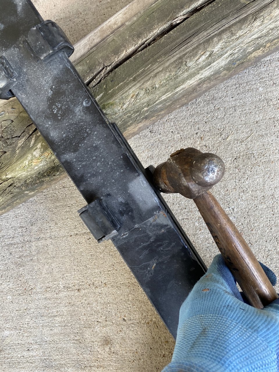

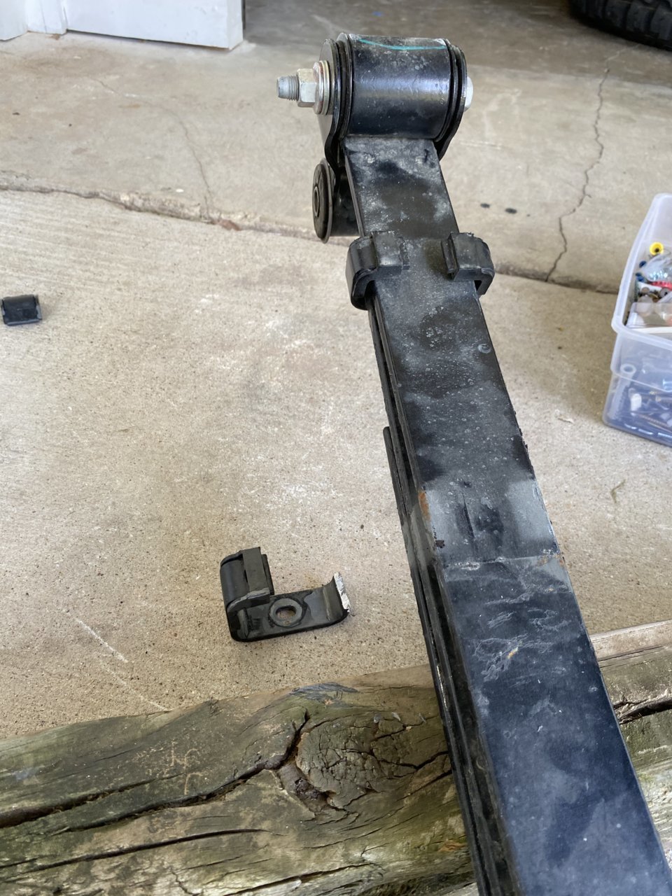

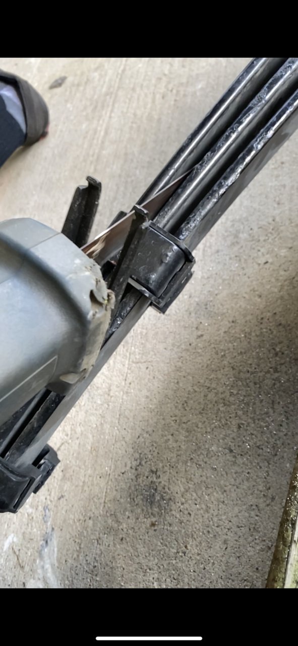

    Malala I couldn’t find much detail on how to remove the clip. So I’ll Include step by step pictures of how I went about it. You have to remove the clip that holds the stock leaf springs just behind the axle. I used a sawzaw.... a bunch.
    Also I learned how heavy those suckers are and that removing them all together and then adding the AAL separate is MUCH easier!
    checkout the pictures. I’ll try and do them in order here: (build thread coming soon I promise lol)
