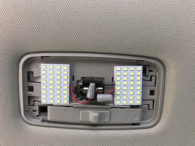

    Thanks for the info. You have my vote for doing an install post when you get a chance. This type of content is one of the things that makes TW so cool.
    EDIT: just looked at the product on Amazon. The product photo explains why it looked light there was still a LED bulb in the socket in the pic you posted; it's the spring-loaded connector for the panel. Neat.

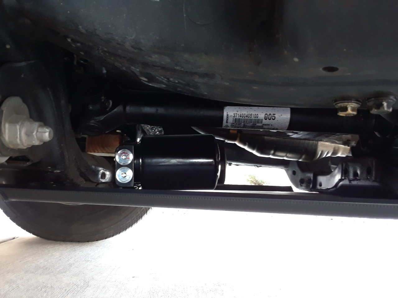

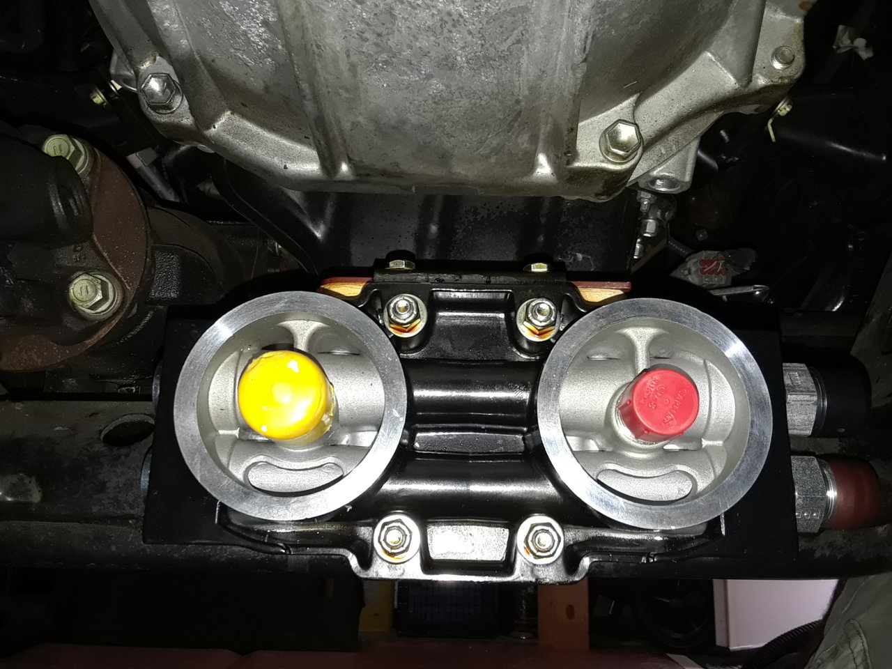

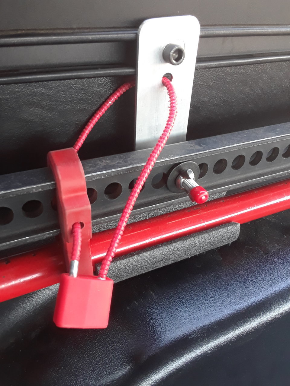

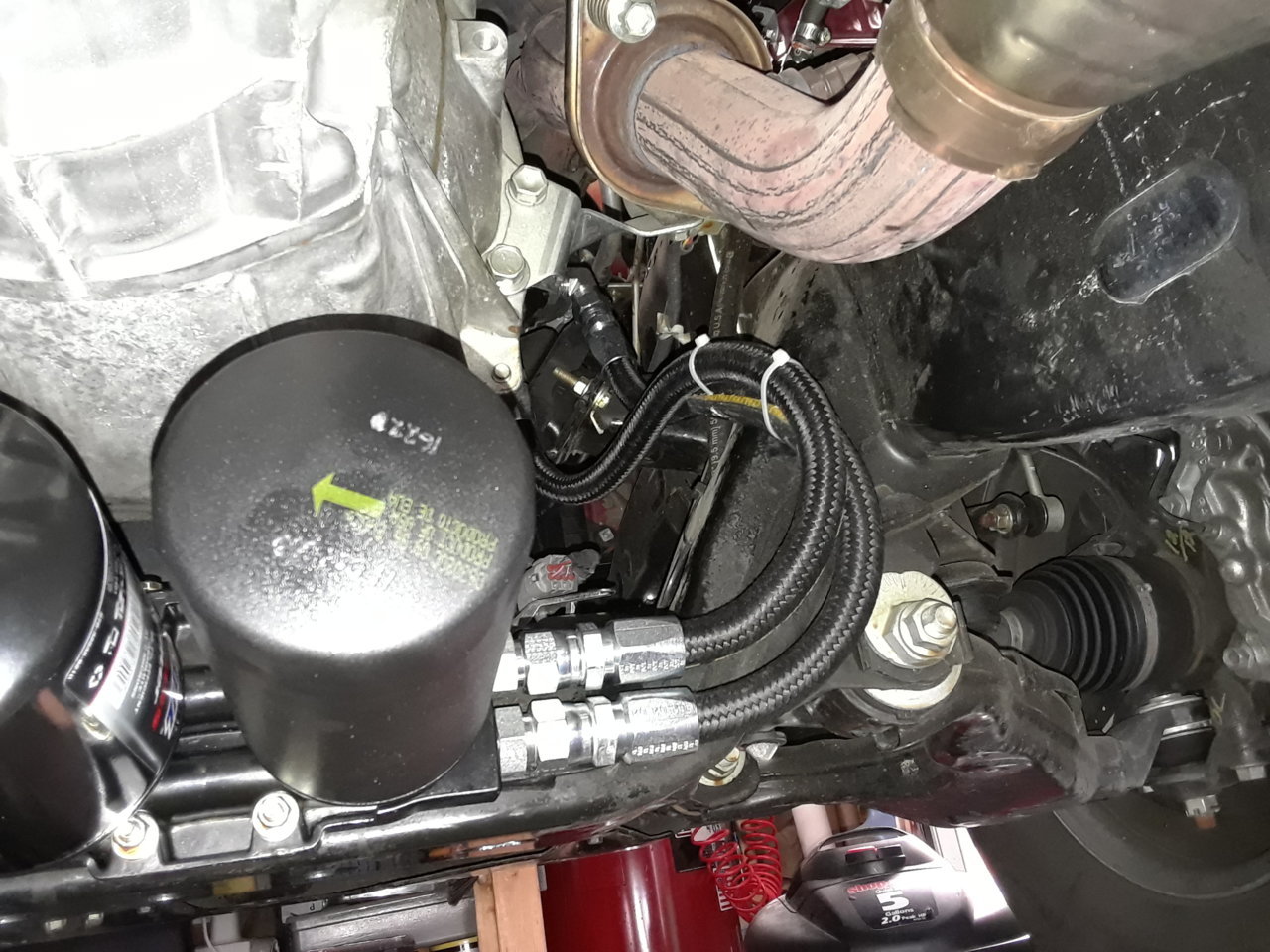

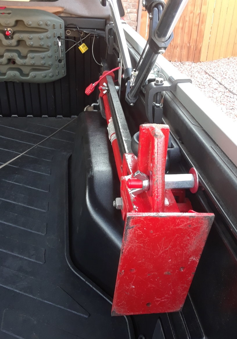

    I talked about these at the first of the month, now finally have photos.
    Mounted a few items straight out of the rail with carriage bolts:
    Jack & Trax both.
    Used weapon cable locks for tool locks (deterrent only, I know).
    Mounted the full Amsoil oil bypass kit.

    Any particular reason for the oil bypass kit, or just trying to extend the life of the motor as much as possible?

    That's 90% of it. Normal filter will remove down to 15-20 micron size grit, this one will remove down to 2 micron.
    Other 10% is saving the environment with less used oil / oil containers.
