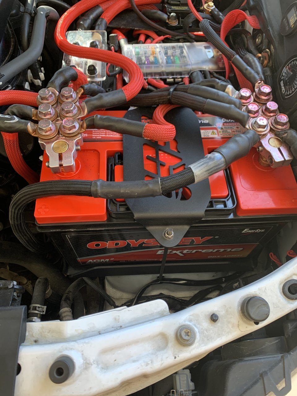

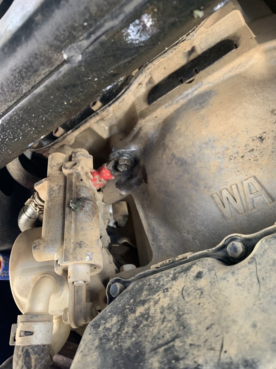

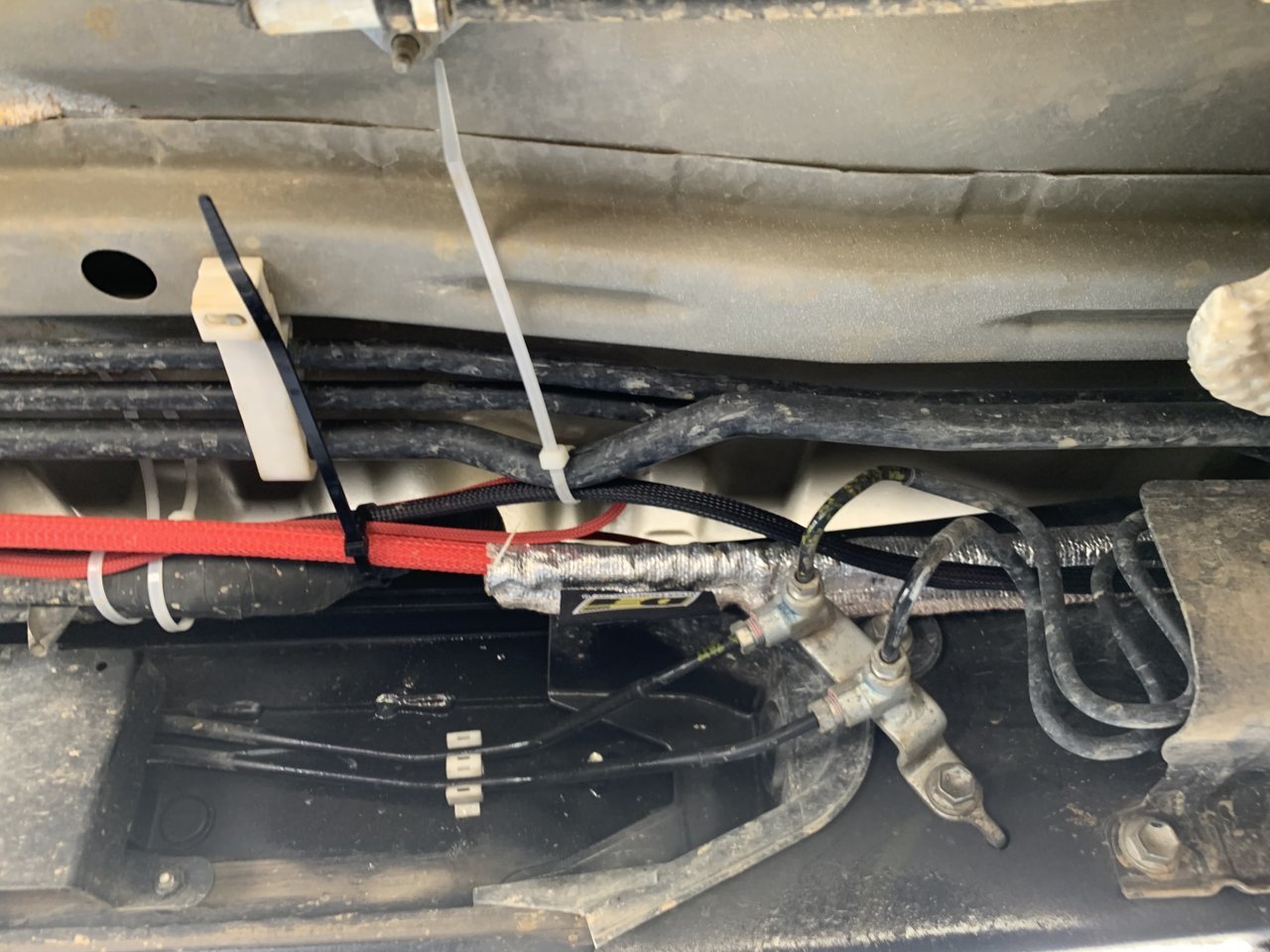

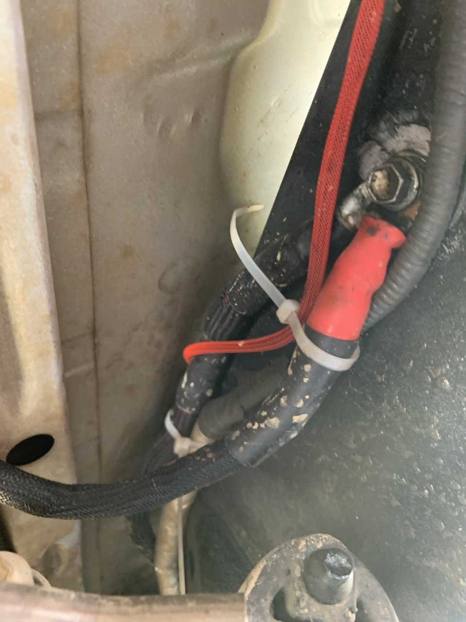

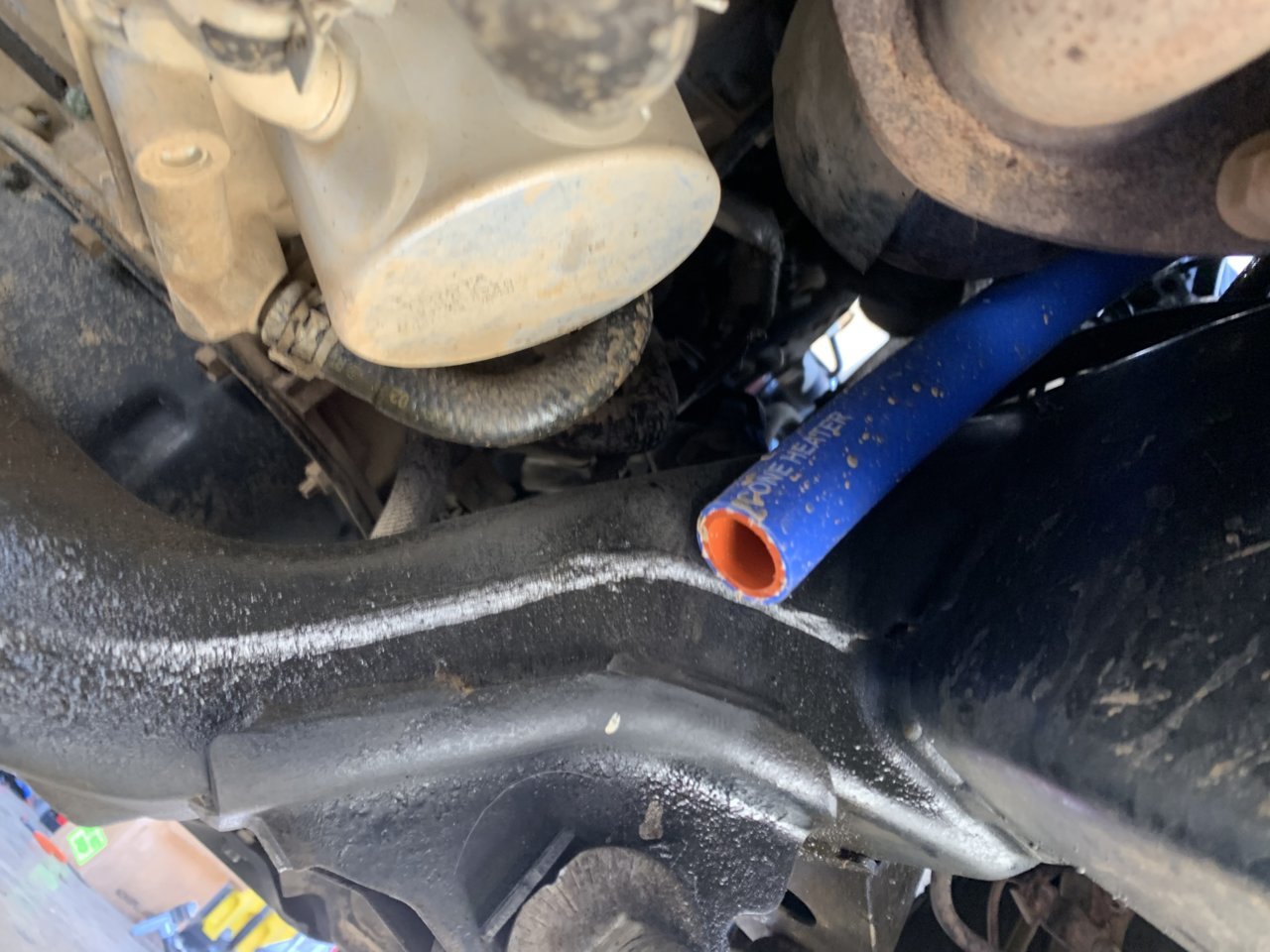

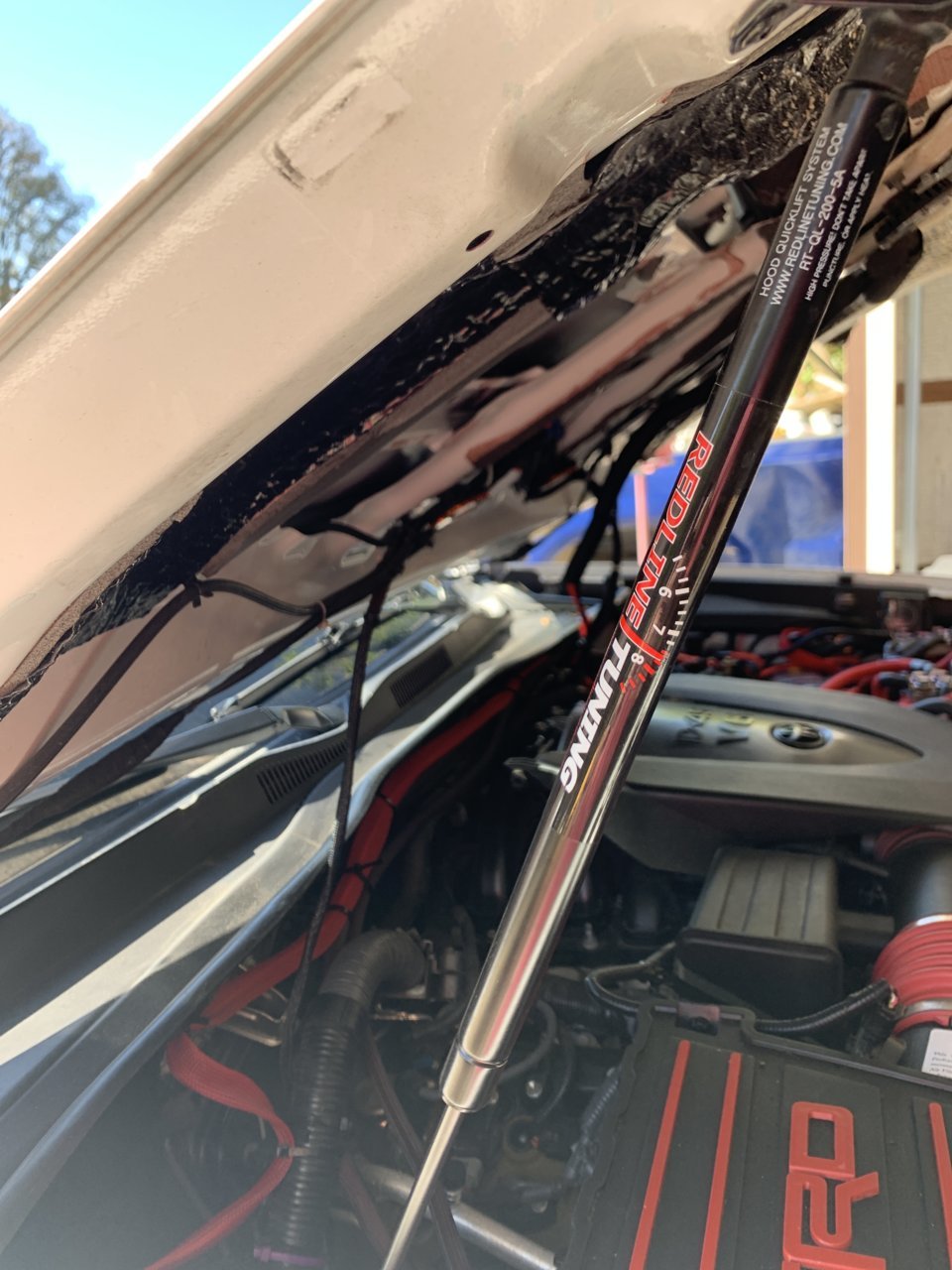

    Ran grounds throughout the bottom of the truck every 3-4 ft and to the transmission and starter plus added the ac drain extension during my extreme boredom of quarantining back this summer. Also added another small blue sea fuse block in the middle of the truck underneath to make runs easier for bed and back of the truck led lighting or other small low wattage add ons. I’ve probably spent as much on hood wiring tech flex and Tessa tape for the wiring as I have on my JL audio amps lol 7E0C16A1-953B-4202-B854-FD01C72DCD35.jpg 8945BBBD-EFC5-4BAF-9E06-2DEE9B9FA55E.jpg D18E326E-B0DC-4E18-81ED-390BA2ECB988.jpg DD8311B4-0331-43E6-9256-45079637C068.jpg BFFF04CA-A958-4B50-8A4B-2AAD3E61D5DA.jpg FCEA4AE6-A1D7-46A8-8975-EE1DE96C337C.jpg FCEA4AE6-A1D7-46A8-8975-EE1DE96C337C.jpg 31414116-5C8A-41FE-8194-A991626CEB7F.jpg

    I wouldn't stress not covering the positive battery terminal. Proper fusing, tight connections, wire routing, and good grounds are way higher on my list and I worked on auto electrical for 20 years.... That battery set up is my favorite that I have seen on this forum to date.

    Kinda reminds me of spaghetti junction in Atl. :D
    Looks good. :thumbsup:

    I can’t quite figure out why all this would be beneficial. Do you have some upgrades planned that will need some additional ground points?

    Ive got many lights in the back and bed of the truck I’m getting ready to post. Maybe not necessary but grounds will never hurt anything when you’re running 1500 watts from an audio system and run a 1500w power inverter from time to time tailgating. The grounds help voltage drop

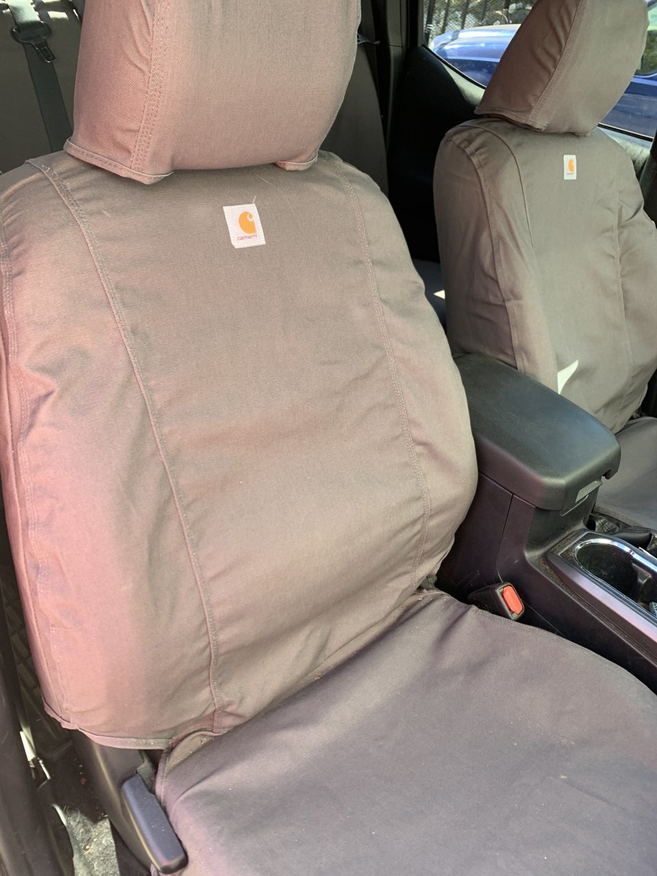

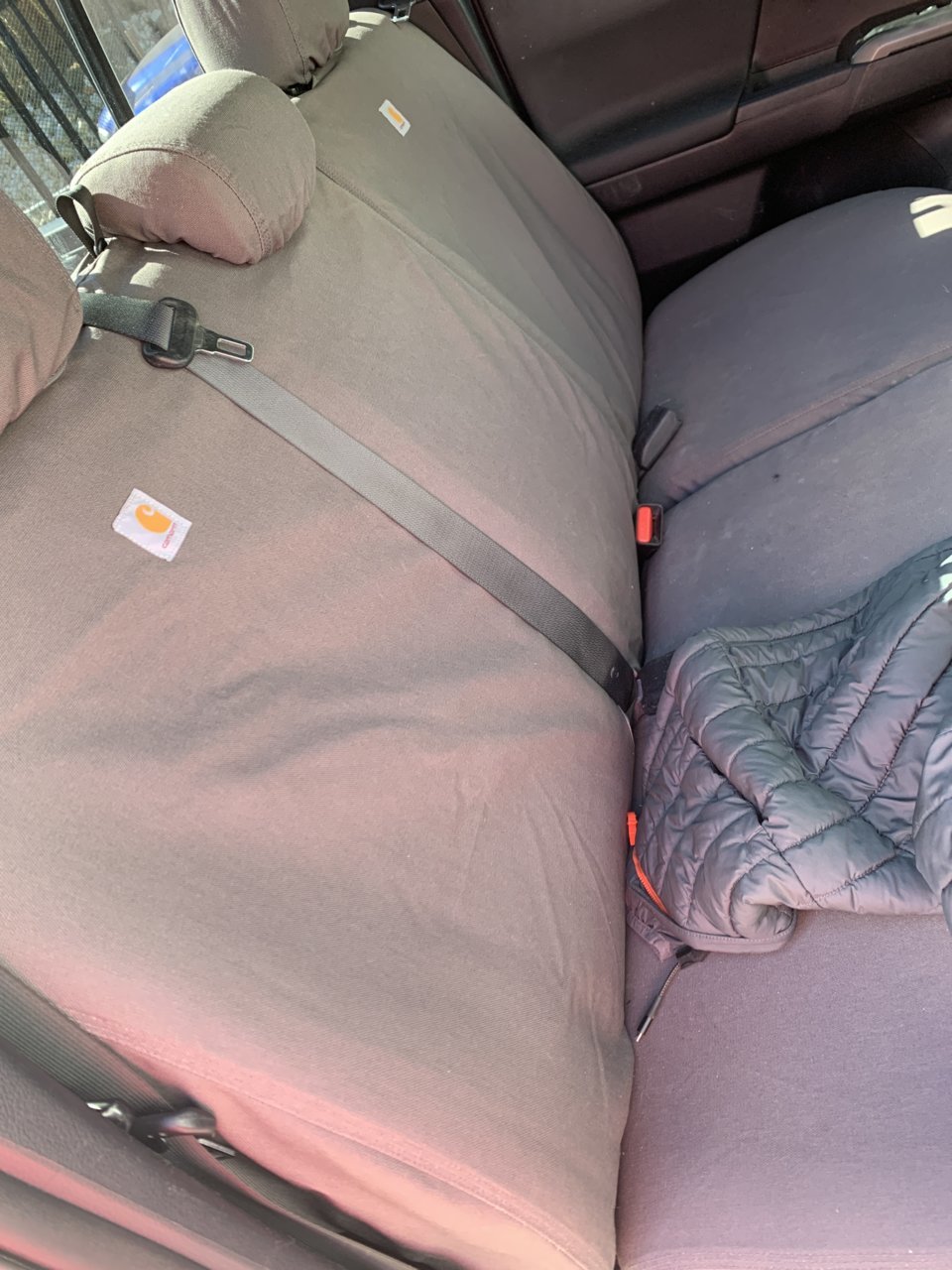

    image.jpg image.jpg Finally added some decent seat covers also! Love these things! Fit was tight but precise
