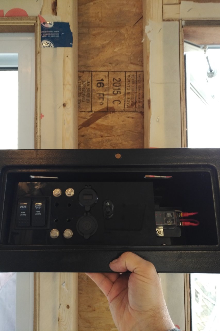

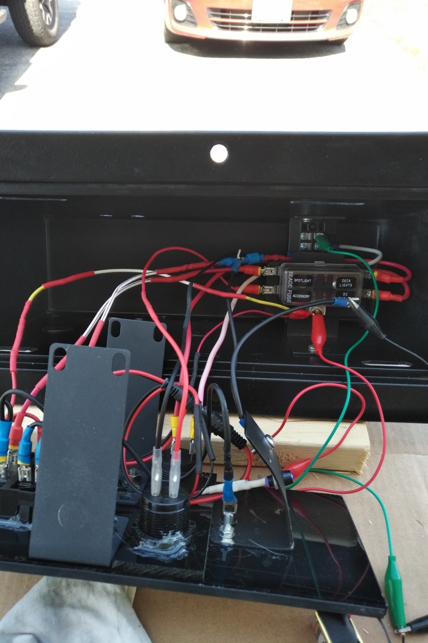

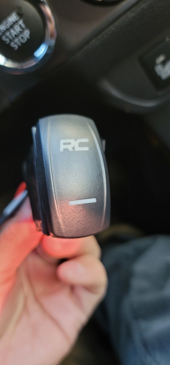

    Each circuit is fused with a 4x fuse block just to the right of the panel. I ran a 14gauge line back from a fuse panel with a 15A fuse connected directly to battery power. The plexiglass panel is mounted with 2x "L" brackets using 4 SS bolts and then 2 SS bolts fastened to the bottom of the cubby. I have a small blue LED that illuminates the fuse block in behind the panel at all times so if I do blow a fuse I will be able to identify quickly. The pin switch turns on the backlit LED in the switches so when I open the door they come on.

    Beauty, thanks! Glad I haven't cut any holes in the cubby cover yet lol

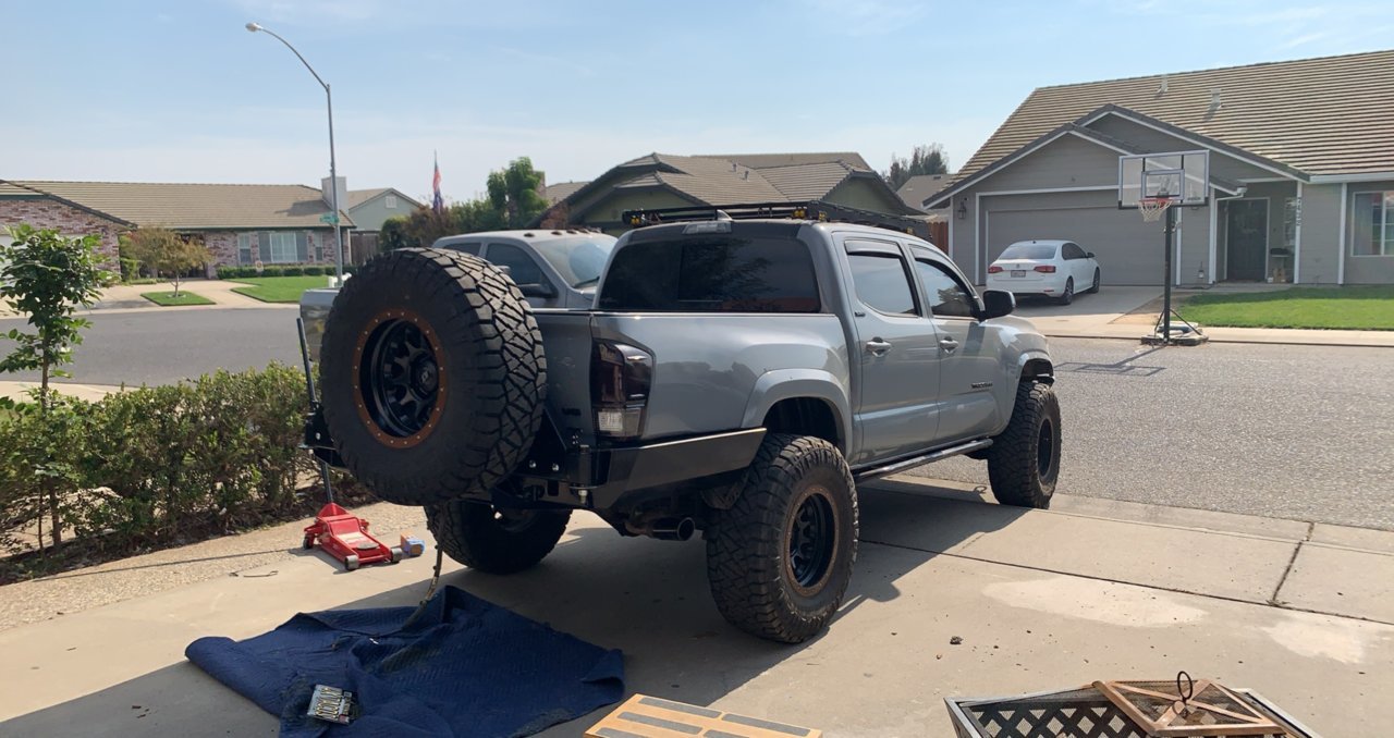

    Bumper looks great. How long ago did you order it?

    BAMF bumper installed

    Wish they made something similar in a non high clearance bumper.

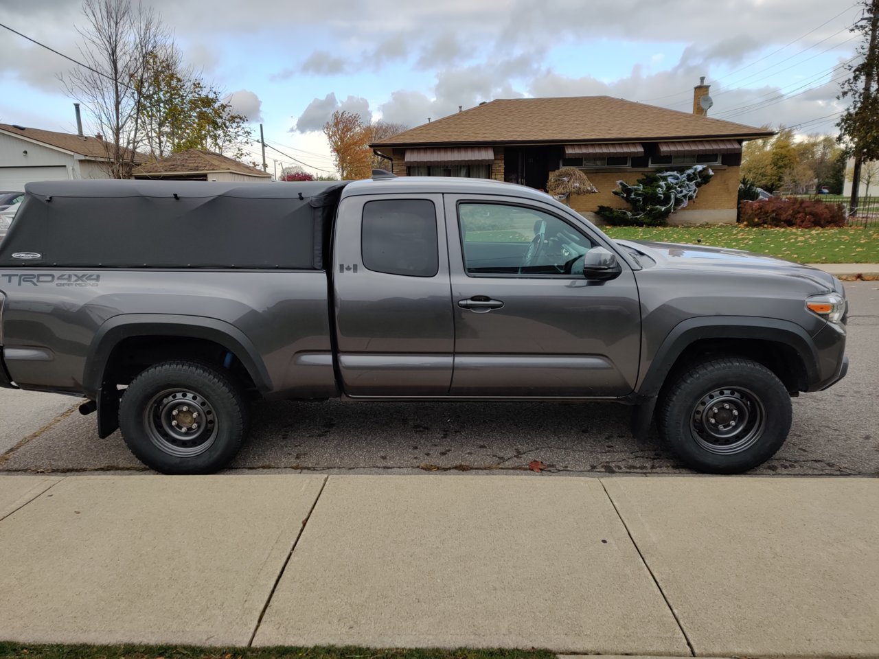

    Dammit! Now i want a black soft topper

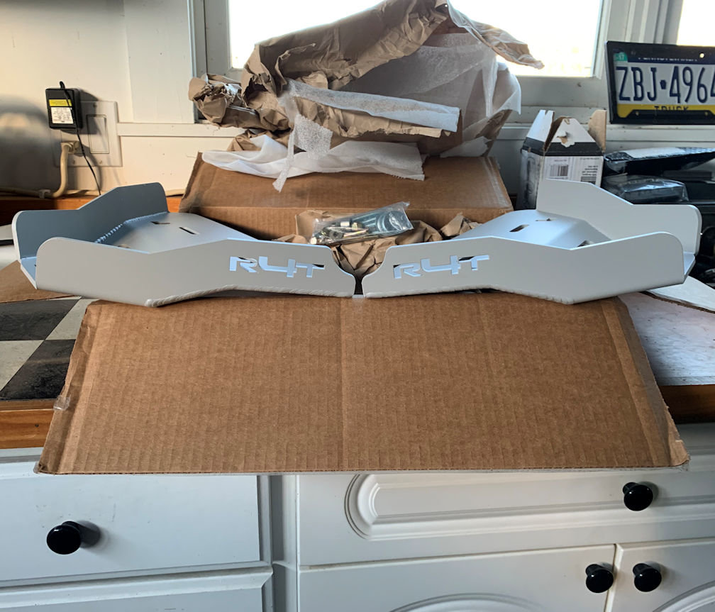

    This picture should be next to the definition in the dictionary of the word "Sexy"...it's looks so good sitting uninstalled that I wouldn't even want to scratch it...but then again, it will protect you from projectiles, road debris and snowflakes...

    Not planning on getting that powder coated or dipped? Or was this just a fitment test run? Just whatever you do...please.don't.plasti-dip. :D
