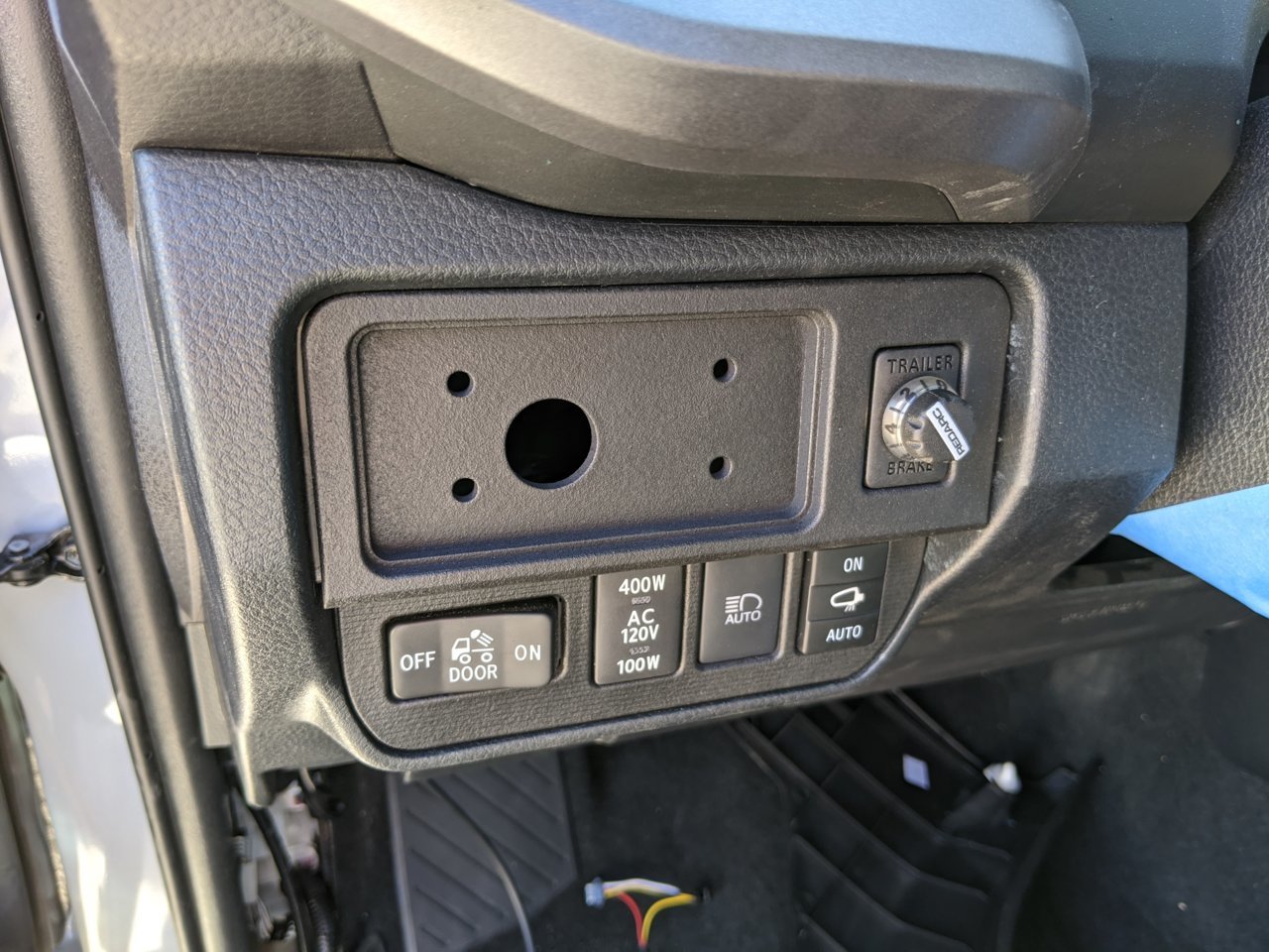

    Rushed this in, just incase the 2020 version didn't fit my 2019 and I needed to jump on meso's custom panels that went live today... It does. But I still bought custom panels for the center and roof. ;)
    The puddle pod switch is installed, but not hooked up yet since I haven't gotten around to those, found an extra stud for the ground up on the under dash reinforcing bar, would have been nice if the ground ring was a little larger to fit without forcing it (yes because I was too lazy to use all the proper tools and equipment I have to replace the ring with a larger one, plug-and-hammer-play!). Puddle pod switch tabs don't hold very well on their own. I put a piece of zip tie cut to length under each tab after installing and that shored it right up.
    Not stoked on the striped look of the bottom part of the panel, but I think I'll probably forget about it pretty soon. A small amount of trimming behind the plate to get the redarc switch in. VERY small amount of (and ultimately could have probably made it work without) trimming to get the auto-high beam switch key in.
    Redarc mounted with a single screw to one of the metal dash supports and then a ziptie as well to constrain rotation and provide additional support. I meant to get a picture, but I think it's in there pretty solid. Redarc was completely plug-and-play with the right harness and the 'B' sized switch insert. grounded the harness to the driver footwell ground screw (the ring was the right size).
    Need to pay a little more attention to the panel surfaces that might get scuffed, I taped a few of them, but removed it before I inserted the panel and that left scuffs on the right side. Not sure if there's a way to buff them out or not.

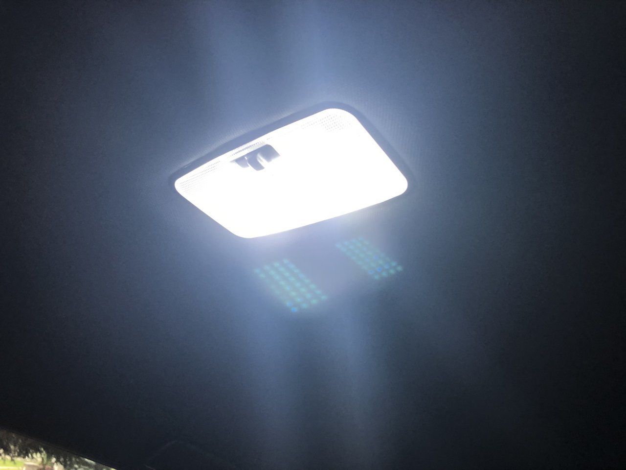

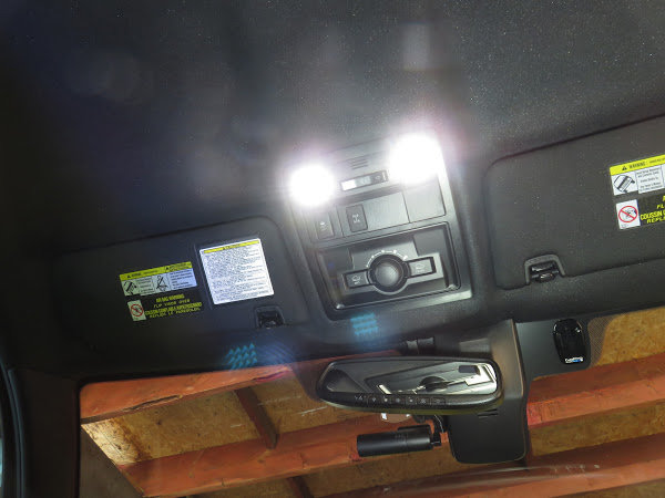

    I am very happy with my MESO setup of white dome and red map lights. When both are on the white overpowers the red map lights, but just the red map lights on alone saves my night vision.

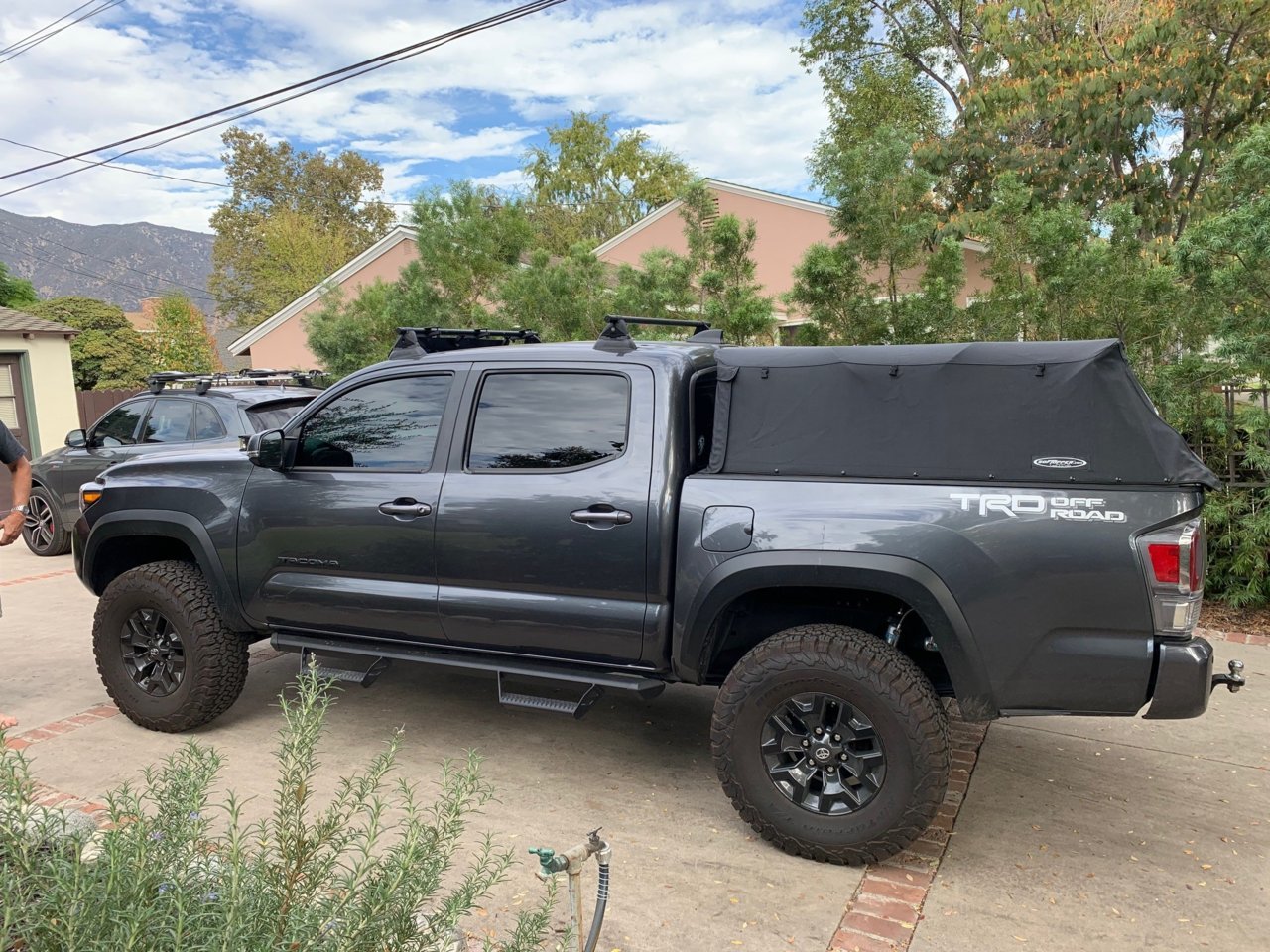

    Wheel and tire day... 16” Analog HDs and 265/75/16 Duratracs...

    Looks good!
