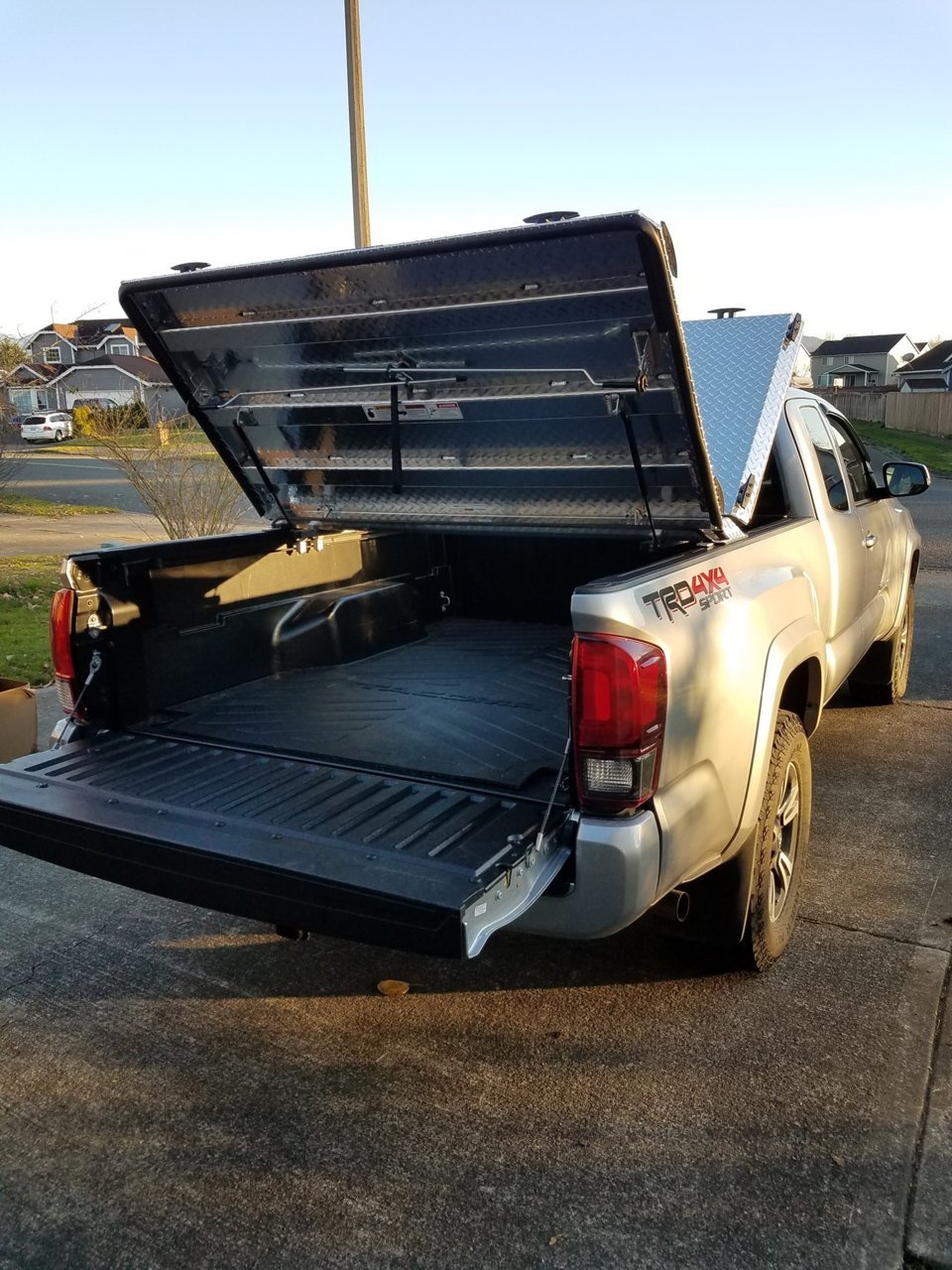

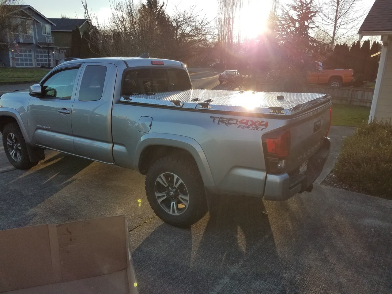

    Took a day off to install my new Diamondback HD tonneau and it's beautiful! Did it by myself, took my time, about 3 hours.

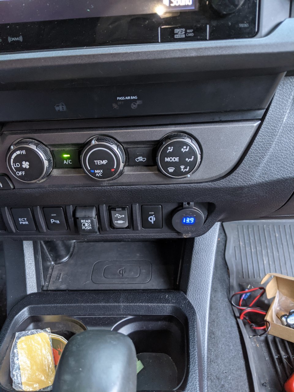

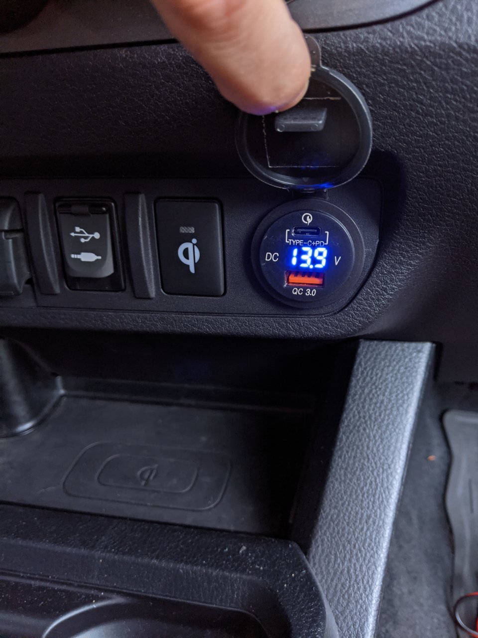

    I got rid of the useless cig socket and replaced it with a usb adapter / voltage meter. Having a USB C charging port is a game changer. Now I don't have to watch my phone's battery level drop while using maps and plugged into the stock USB port.

    Where did you acquire this thing? Was it hard to change over?

    Got it on Amazon. Install was pretty easy other than having to take a lot of the dash apart to get to the switch panel. Most of the dash is just held on with clips so the pieces pop off and then back on. The hole for the USB socket needs to be increased by about 1mm (I used a step drill bit but you could also use a dremmel). The wires for the cig socket have a plastic harness that needs to be disengaged and then the stock wiring fits right onto the USB socket posts.

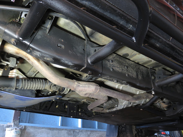

    This CRC 06026 marine HD corrosion inhibitor is nice. Sprays on almost like clearcoat paint. Once the propellant evaporates, it leaves a tacky soft film coat, giving surfaces a matte hue. Certainly easier to work with than Fluid Film, which stays "wet" and stains clothing if you accidentally brush against a coated surface. 5 cans were enough to spray the whole frame, suspension, and rear axle. The CRC spray placed tops in Project Farm's comparison testing.

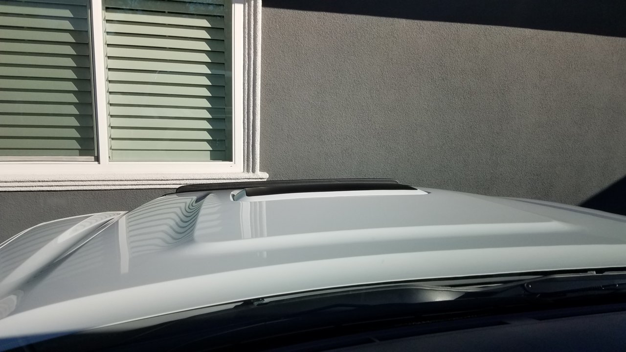

    This shot is from the highest point of my windshield, right beneath the sun visors. From the normal driving position I can barely see a very small glimpse of the left side of the Aeroskin at all. They also sell one without the raised area. Hope that helps.
