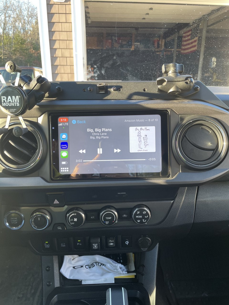

    Does the Console display still show information like speed limit

    Yes it does. I used the maestro RR as the interface. It shows Speedo and other gauges to.

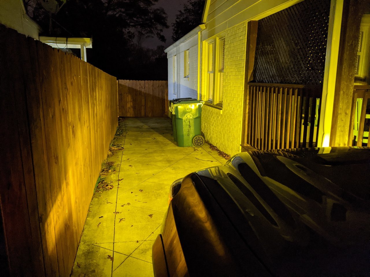

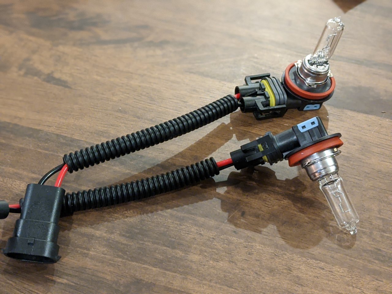

    Used harnesses to swap h11 with h9 halogen low beams.

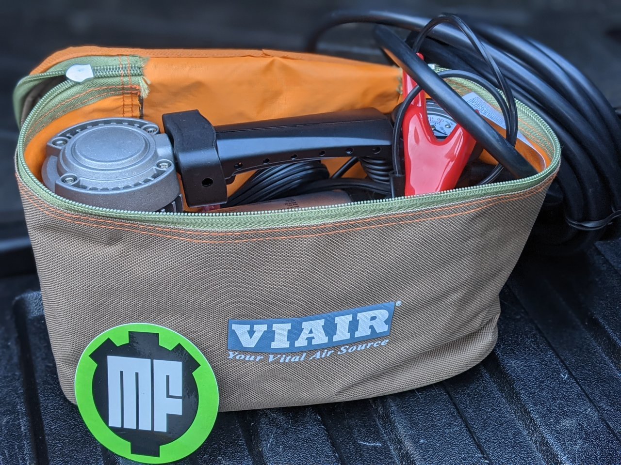

    Added a viair88p compressor to my arsenal.

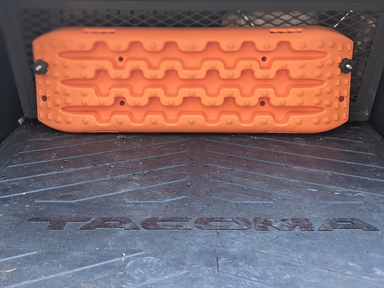

    Mounted some X-Bull traction boards to my OEM bed divider.

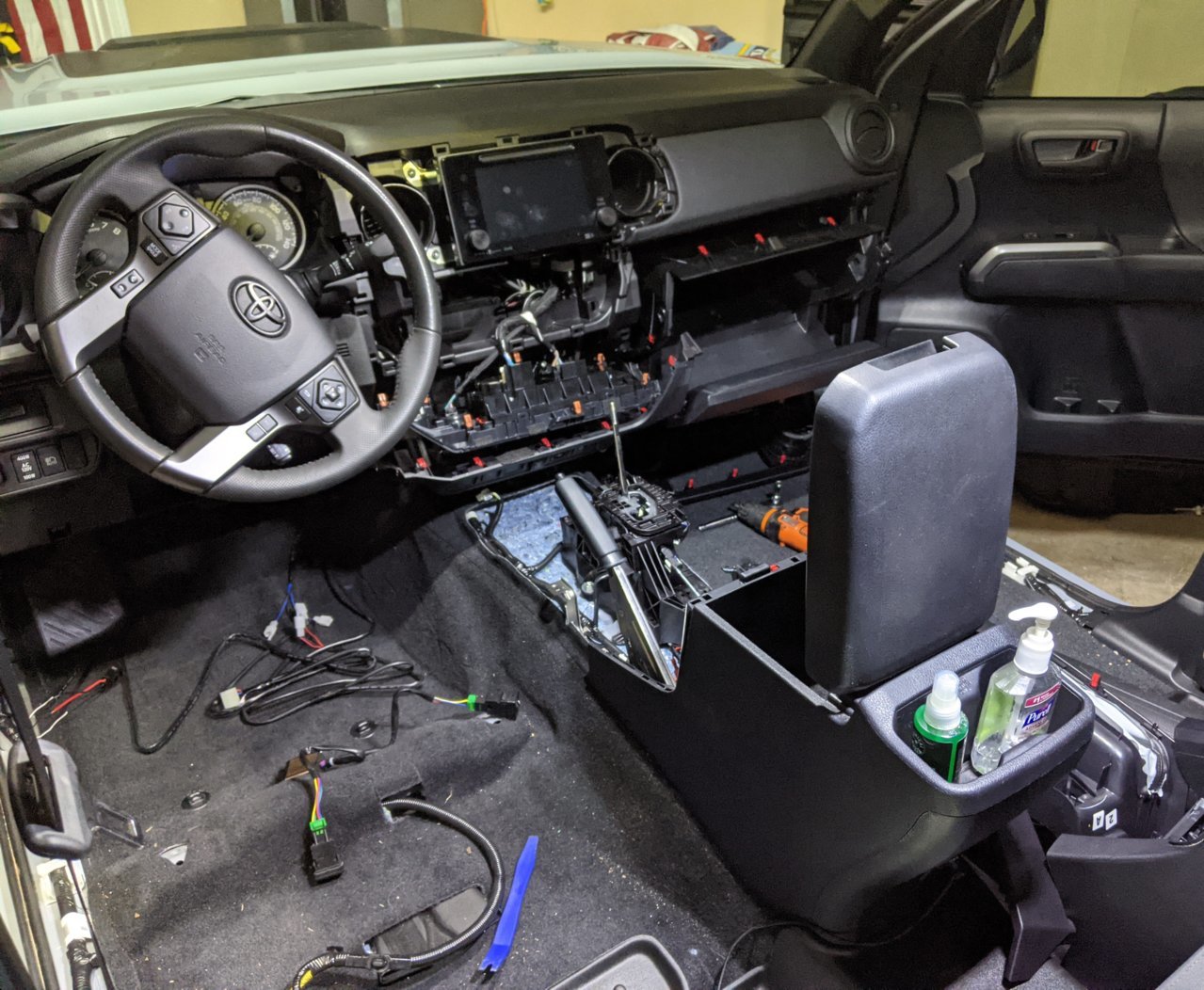

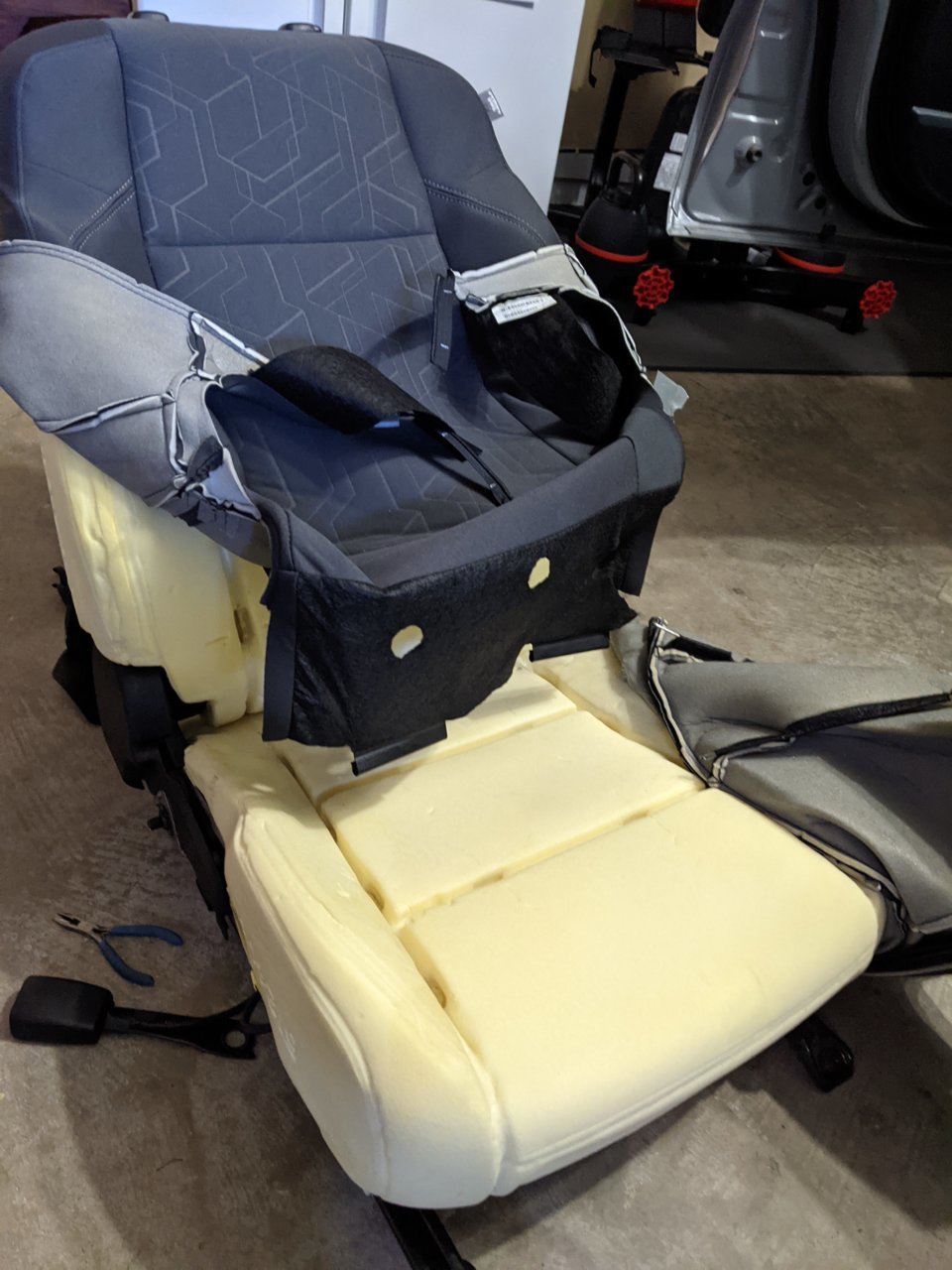

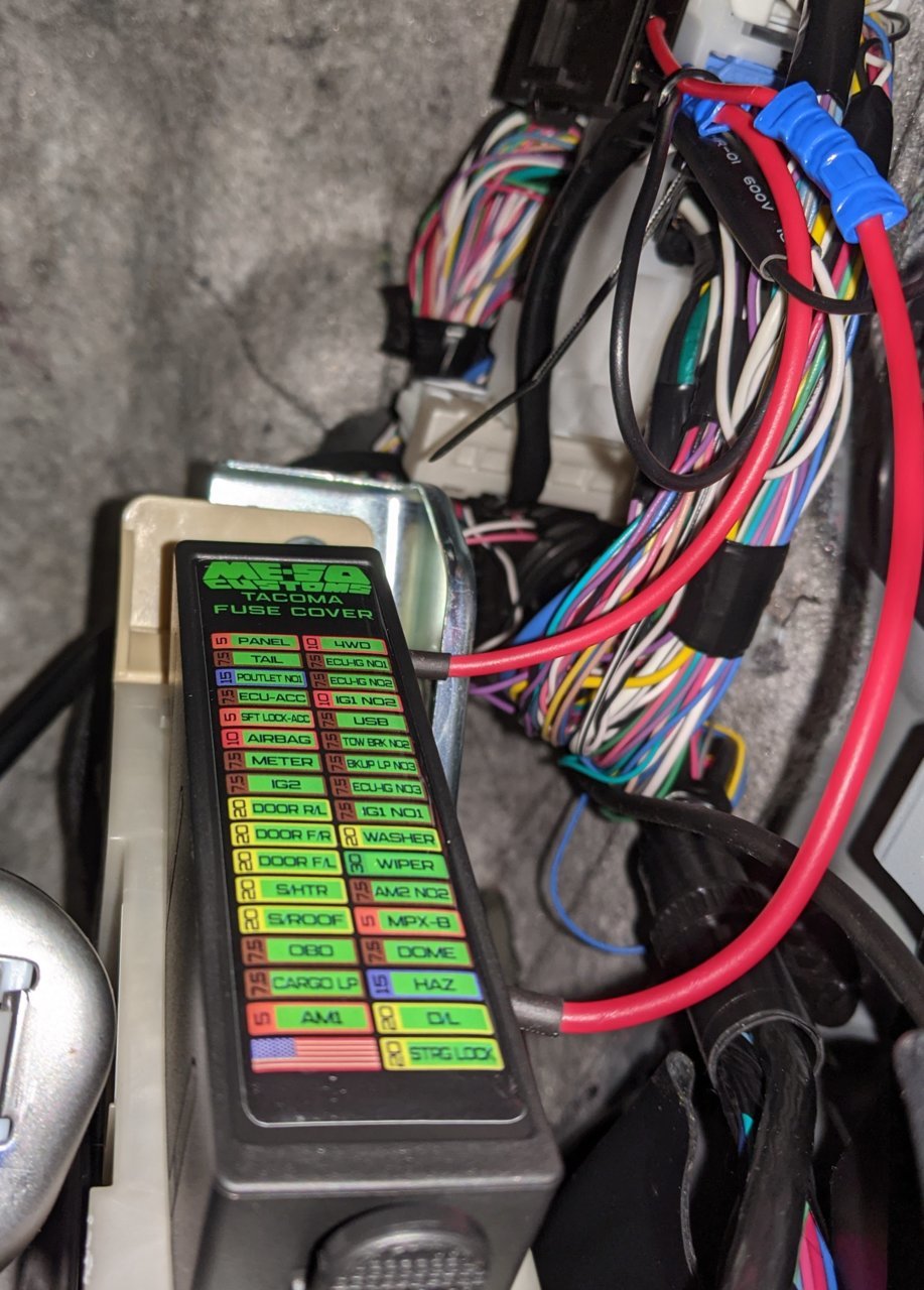

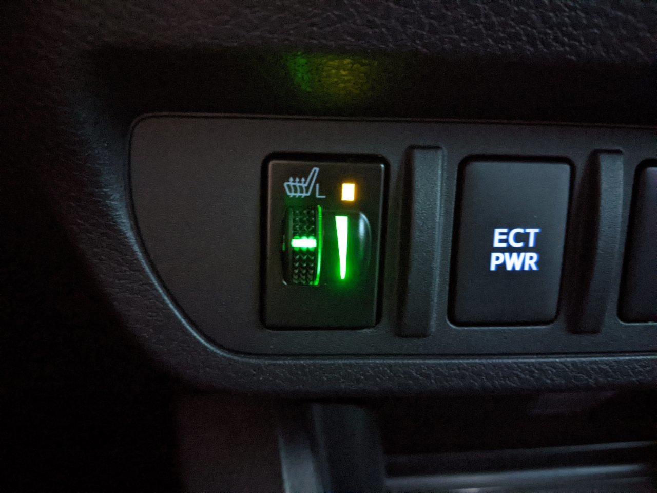

    Installed a heated seat kit, utilizing the Meso Customs extended fuse cover.

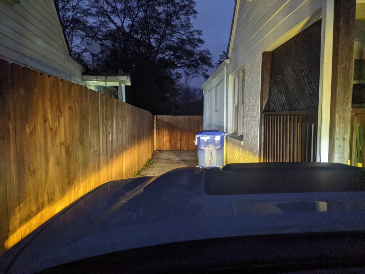

    Added some amber LEDs to my fog housings where I have yellow Lamin-x covers.

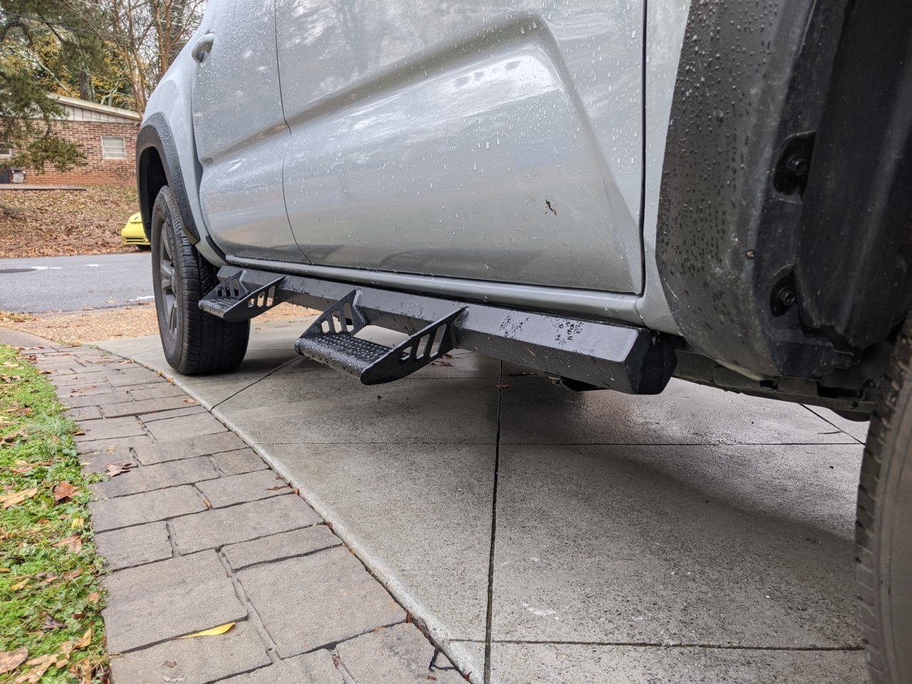

    Added some badass steps I got from a buddy

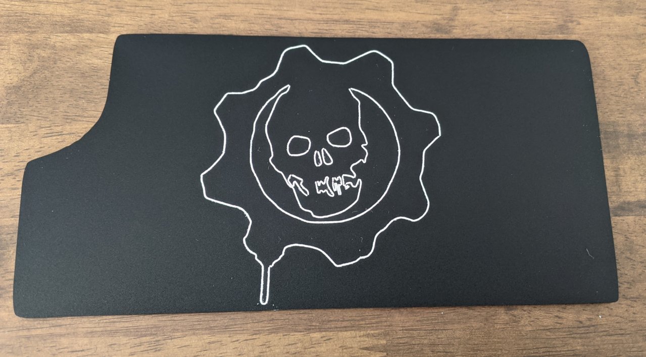

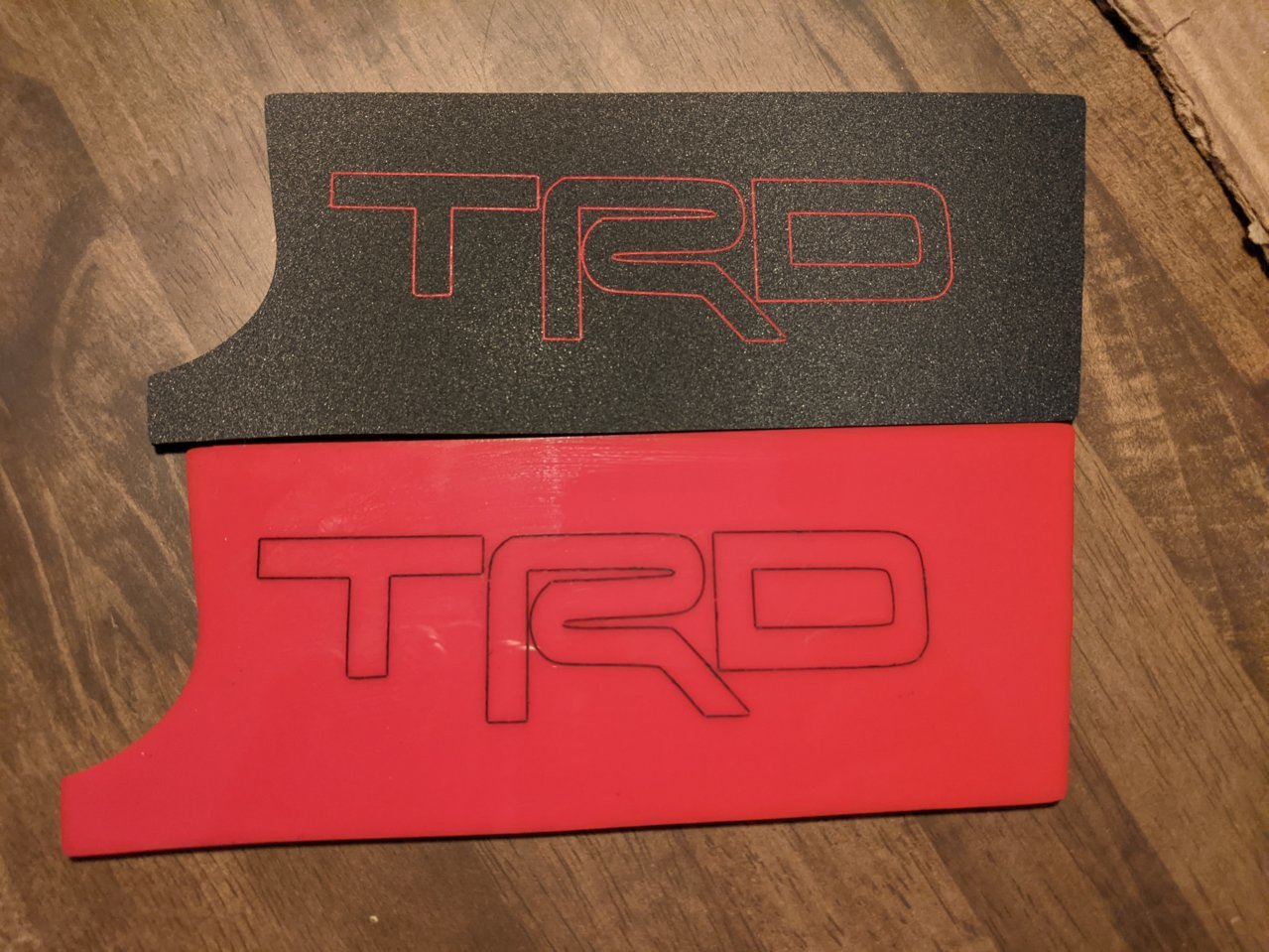

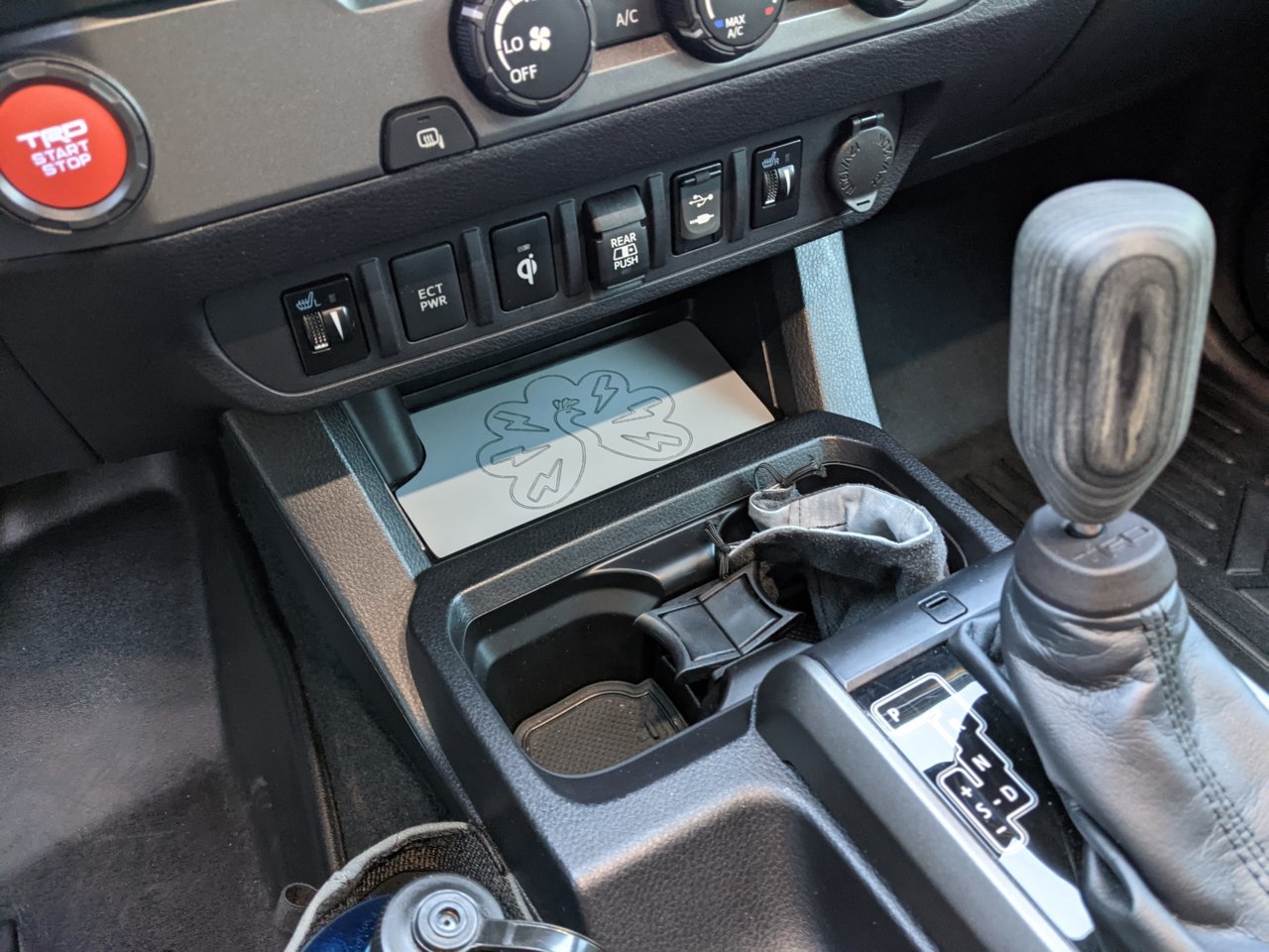

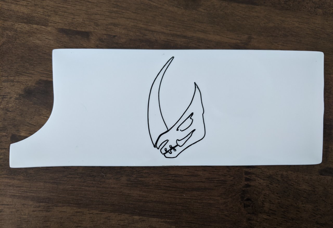

    I also made my own console/bucket plate covers and started a little business to customize these for people (hit me up or visit Stormpeacock.com if you want one!)

    I am doing this as well....after Christmas. Any details on what you used? I was thinking about using the aluminum track/frame and mounting one board per side.

    Some big washers, some long carriage bolts, locking nuts, and easy grip plastic spin thingies (see photo).
    If you are doing it to the rails, idk. I know there are people that sell molle panels for the bed sides which gives you more options.

    Thanks. It looks like the rails/frame of the divider would accept some t-nuts, maybe hang a bracket on there. Going through the mesh part is another idea, like what you did. I'd love to use some of those mounts that supralee here on TW makes for the maxtrax but I am using the same boards as you.

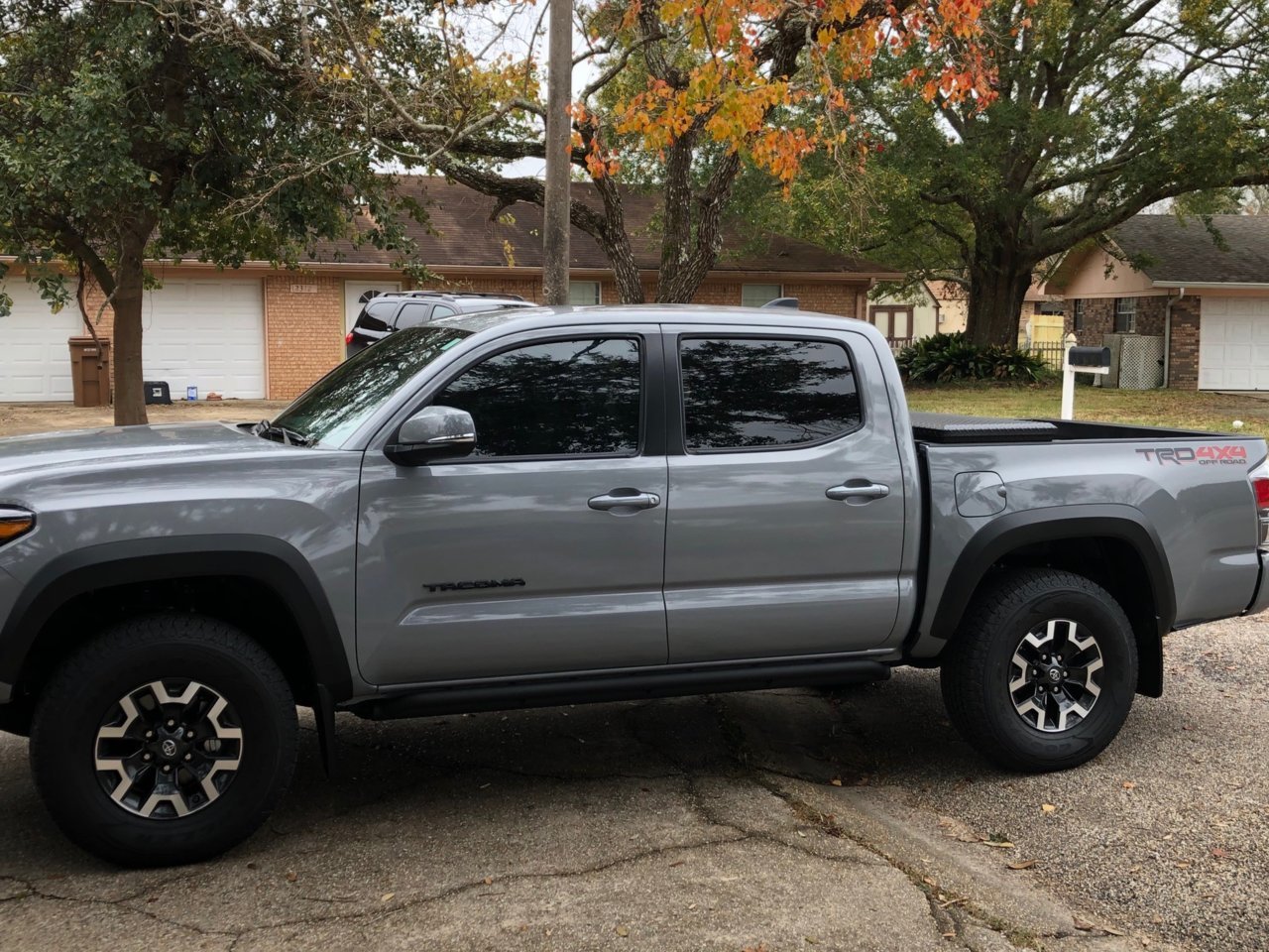

    No, but thank you anyways. I mocked up my tablet on the dash and didn't like it. Too much going on.

    Well that’s as close to new as you can get without being new

    I purposely went with the shorter model boards so that I could mount them where I did!
    The longer ones won't fit between the wells.

    Do tell more about the kit, etc. Hoping to install seat heat in mine. Thanks for the photos.

    I got it off Amazon, watercarbon was the brand. The switches fit OEM. Took me like 8 hours to install, but I could do it again by myself in 4 probably.
    The switches on this kit need to be illuminated in order for them to turn on (kind of a bummer -- the green roller switch is always on). I would have probably gotten the HI and LO switch with blue illumination when lights are on for the next time.

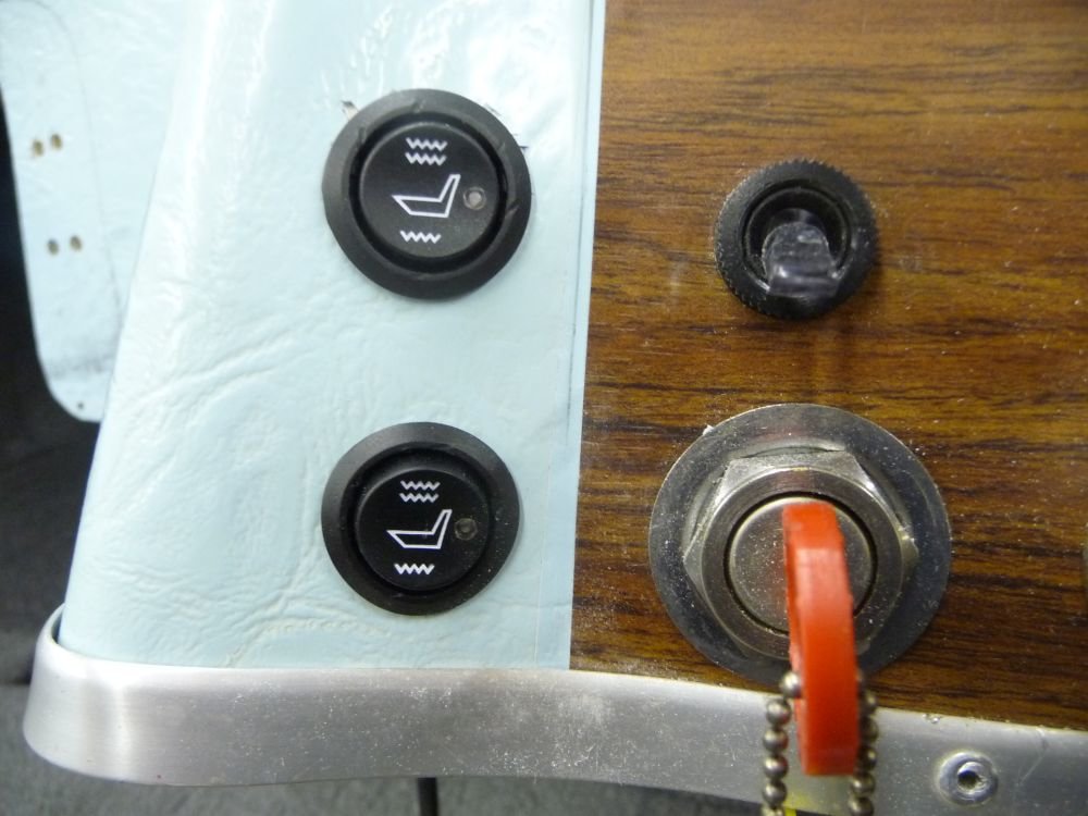

    Thank you. I use the carbon fiber kits to retro fit older boats I rebuild. Your switches are what threw me as I typically see other make of rocker switches.
