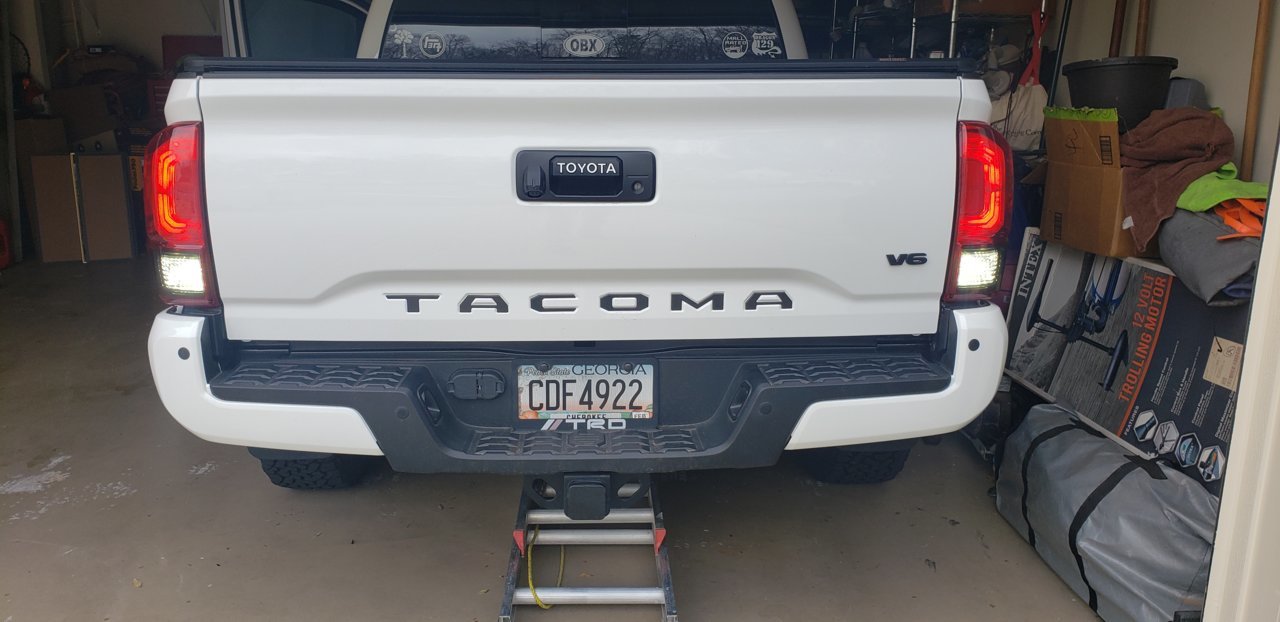

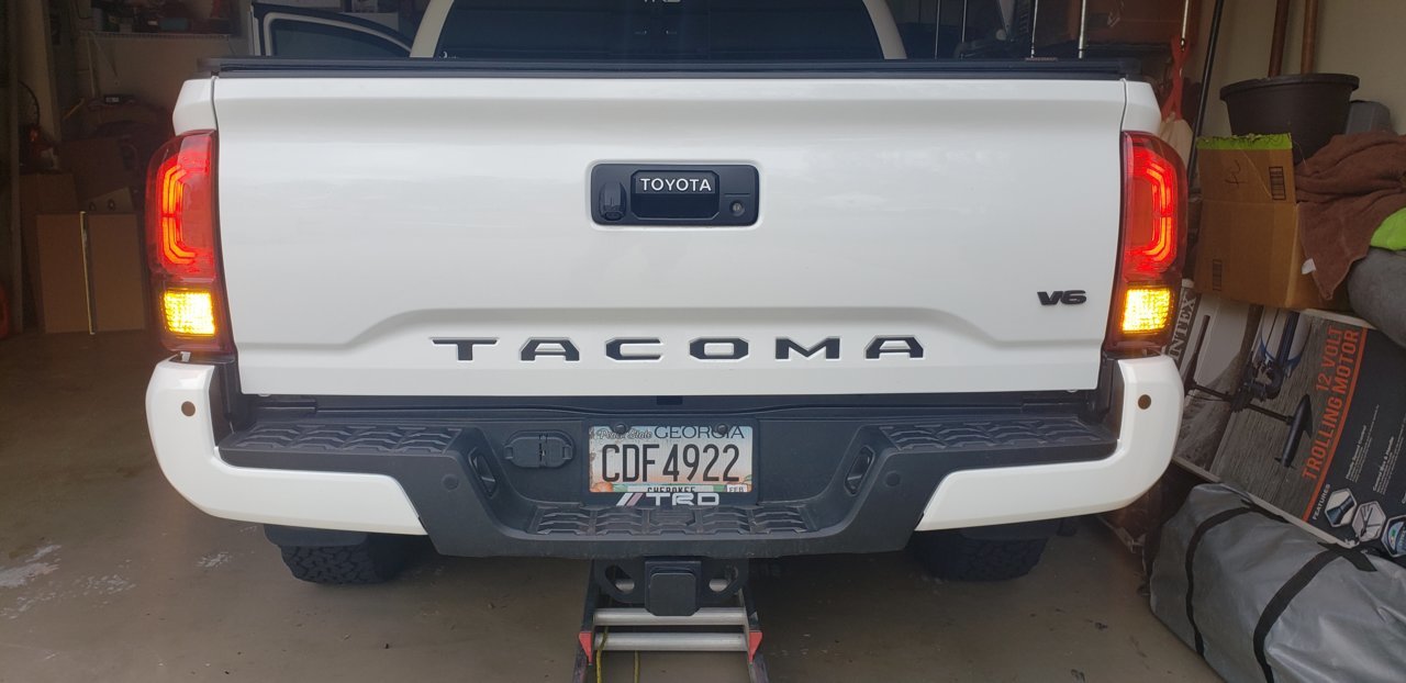

    Finally got some alone time with the Taco. Installed Meso stage one tail light kit and rear differential breather relocation. I was surprised how much air it sucked in when I took the stock breather off. I'm assuming that's normal?

    Looks good. Wish they would’ve had the army green when I got mine.....good looking taco! :thumbsup: BTW, welcome to TW! :cheers: Be prepared......:spending:

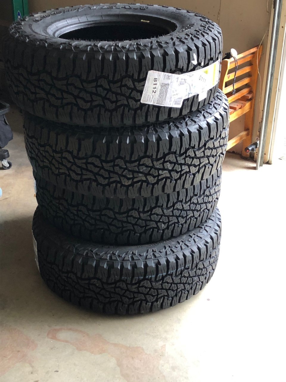

    ut's.jpgThese were delivered today. Hopefully get them mounted in the next few days. 265/70/16 SL UltraTerrains

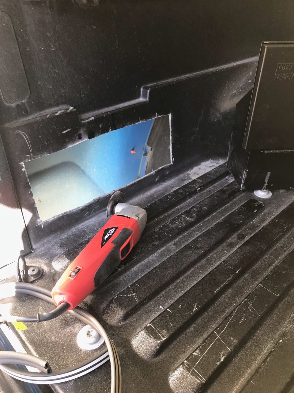

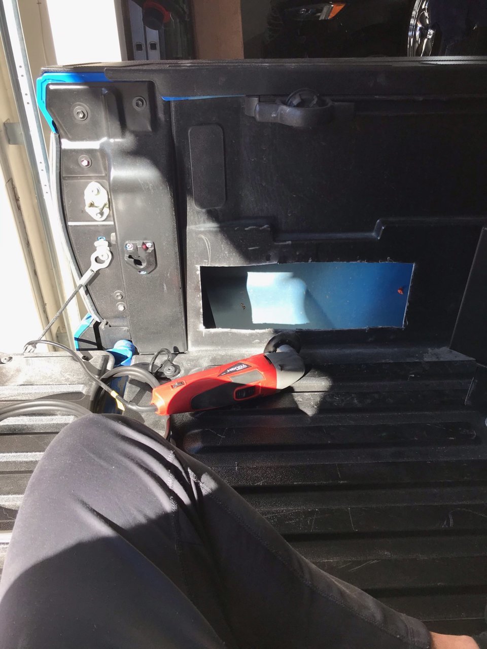

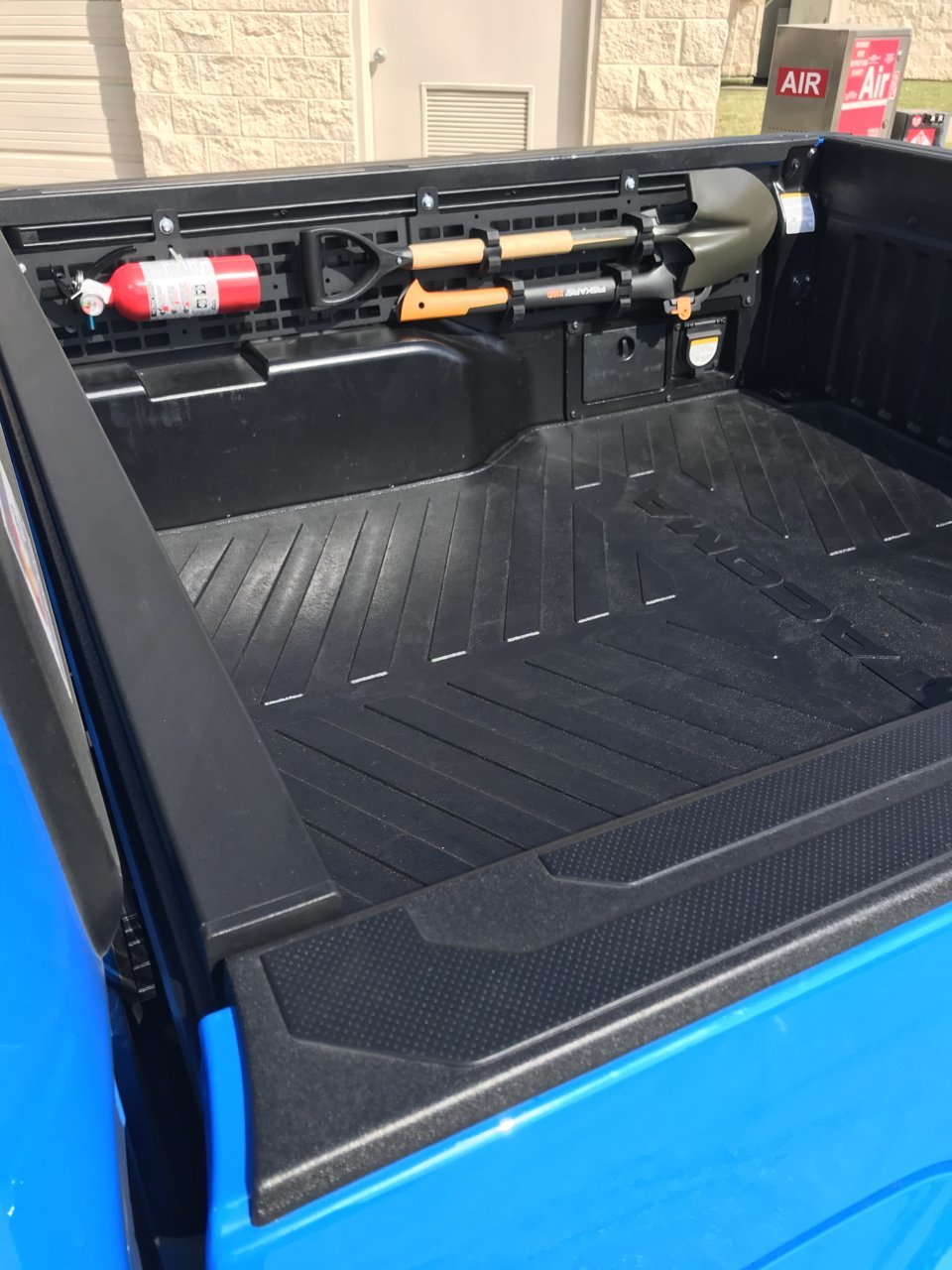

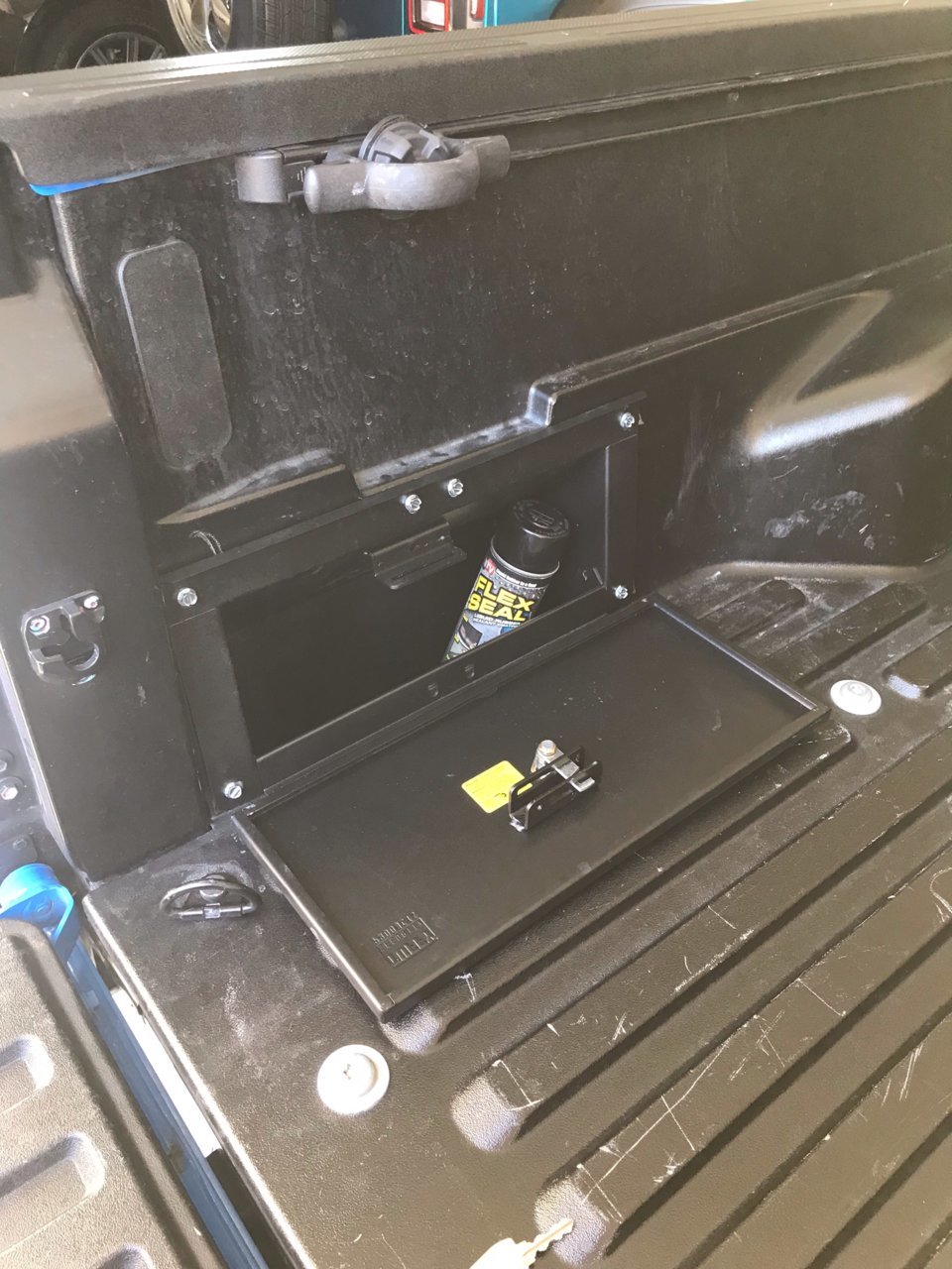

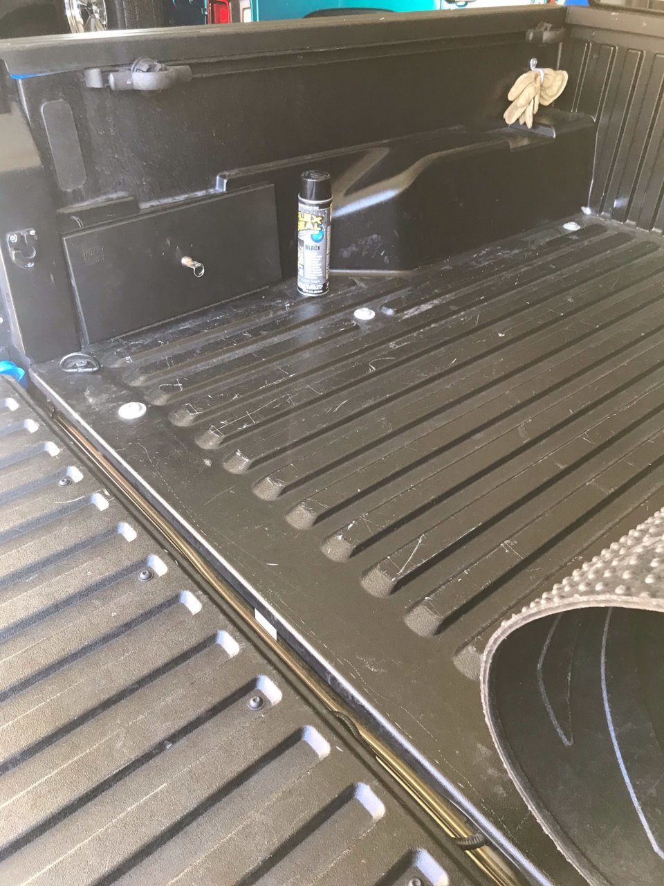

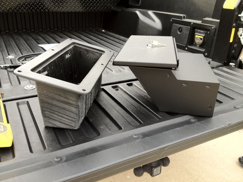

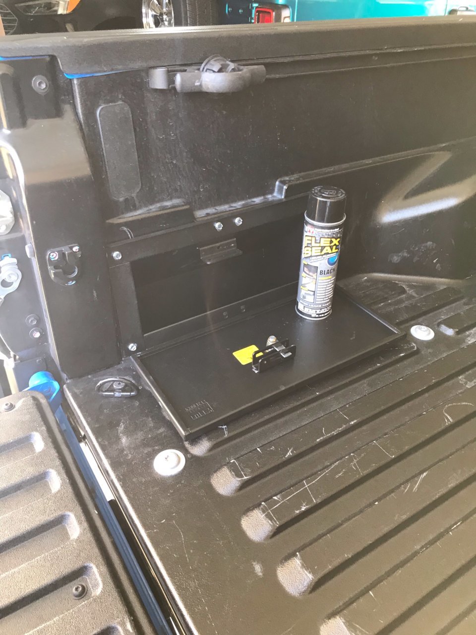

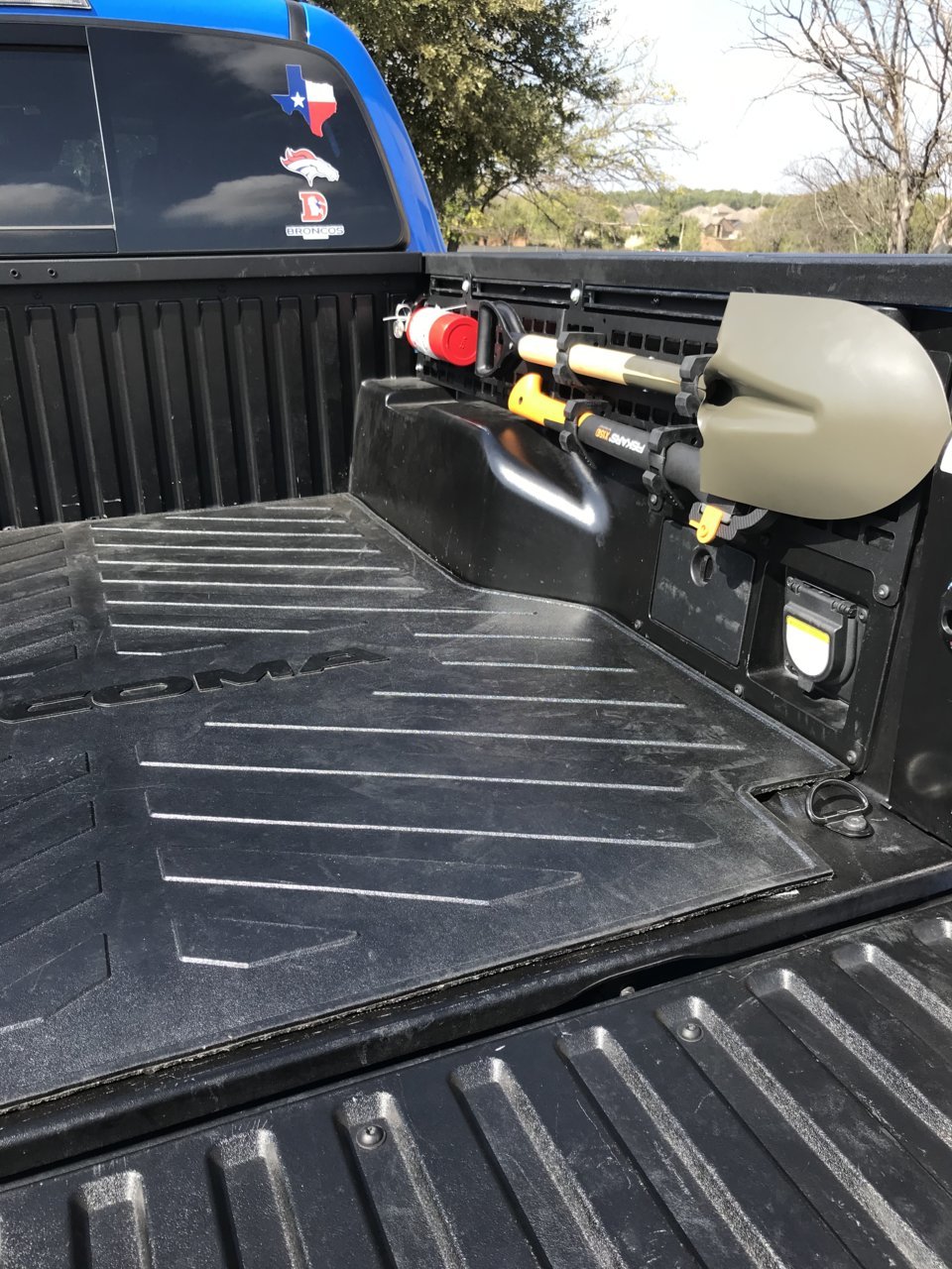

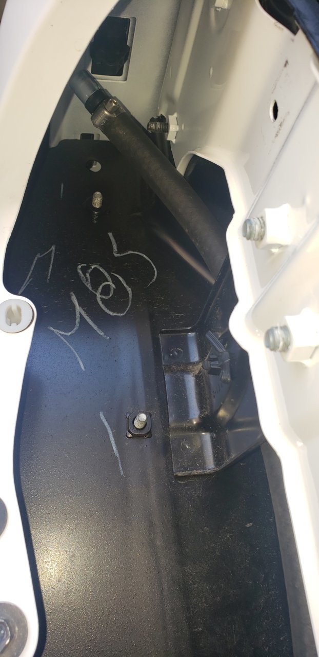

    Well it wasn't fun and it sure wasn't' pretty but I got her done with a little help from my new found friend Cody and he finished it up for me after I burned through two blades cutting through the composite bed. The storage box slid right in and secured with six self tapping screws and sprayed the crap out of it with a can of flex-seal to prevent rust. I love it........

    Sweet! :thumbsup:

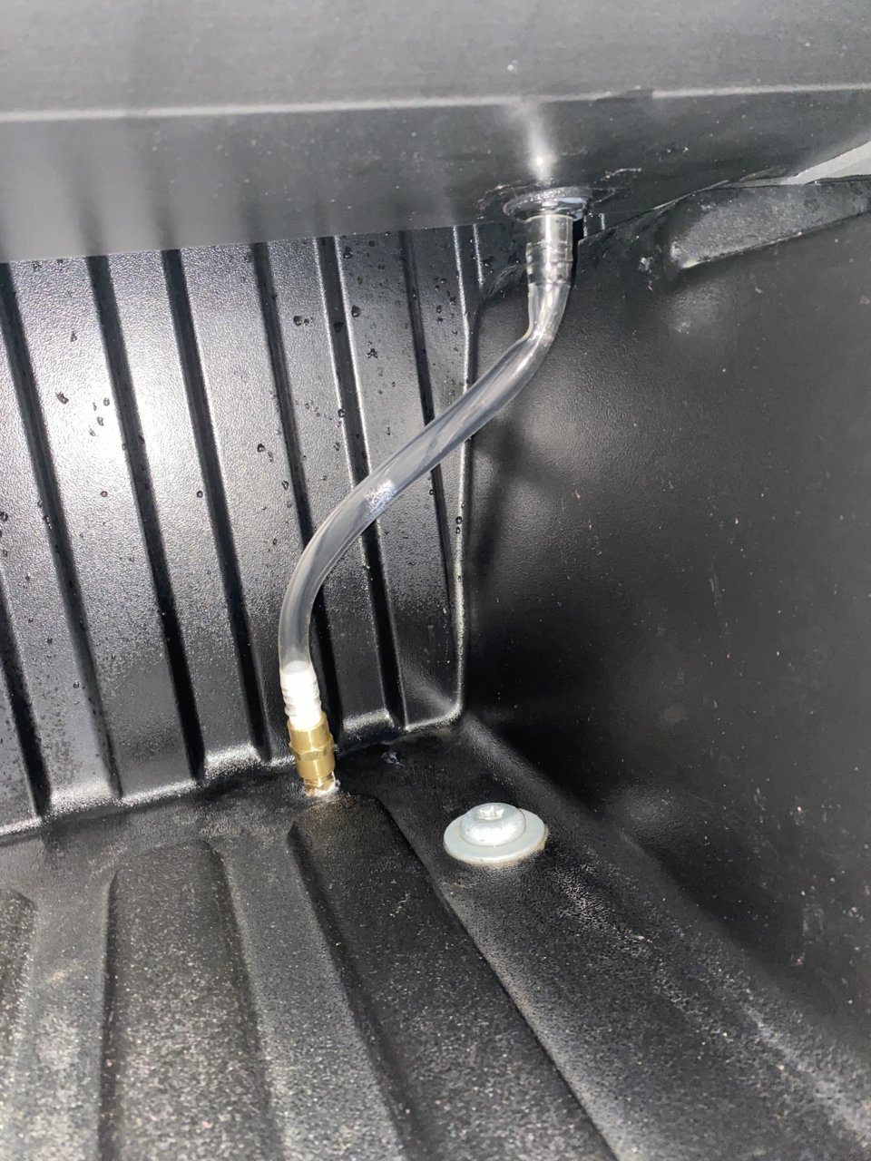

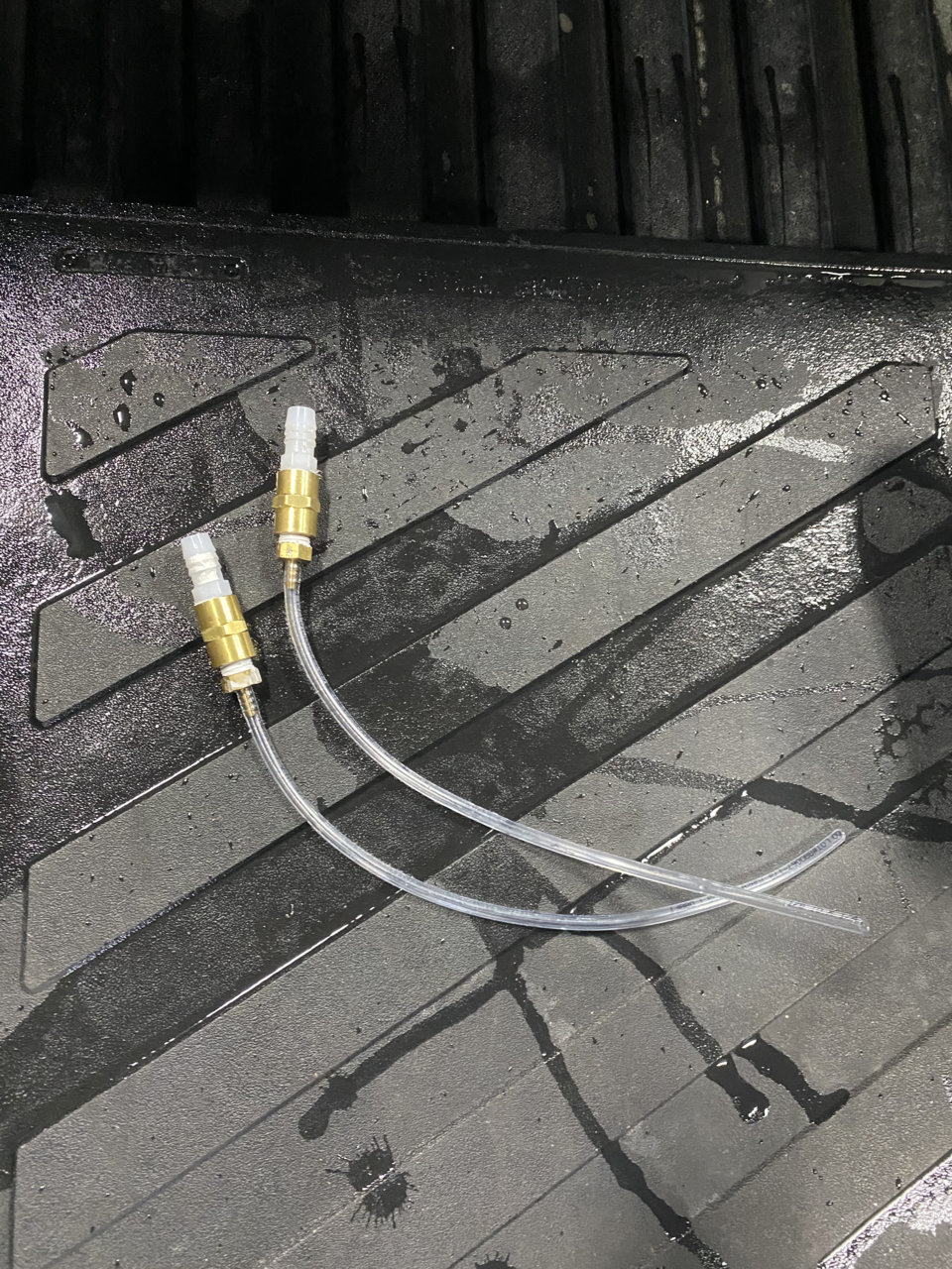

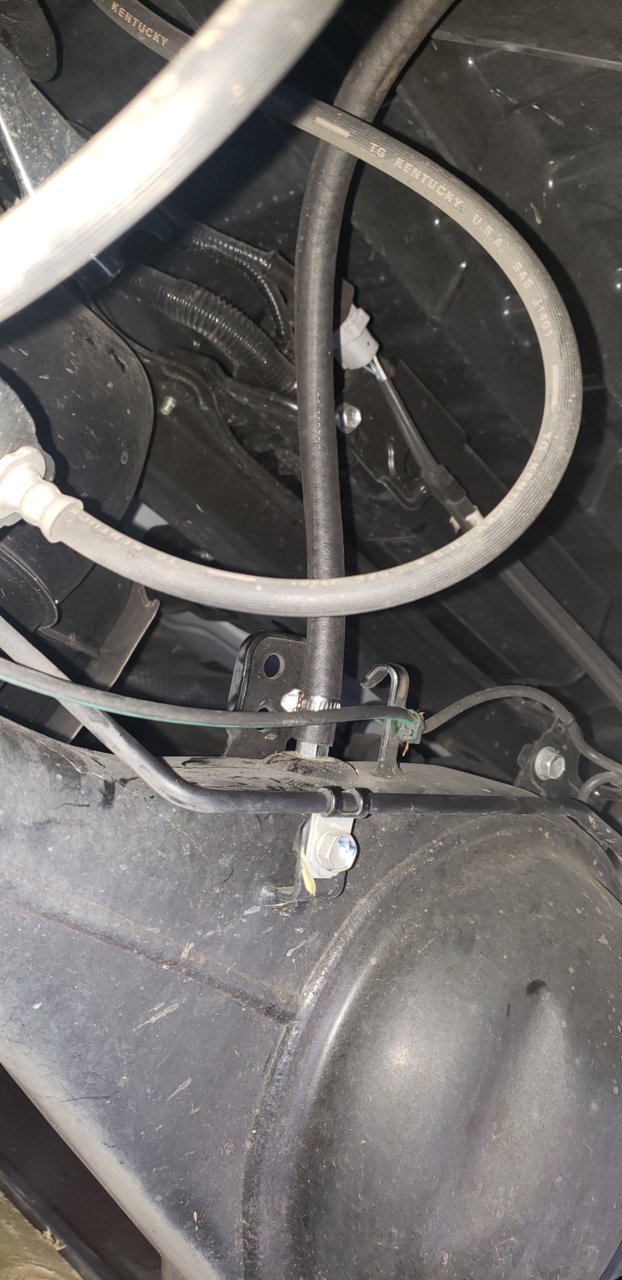

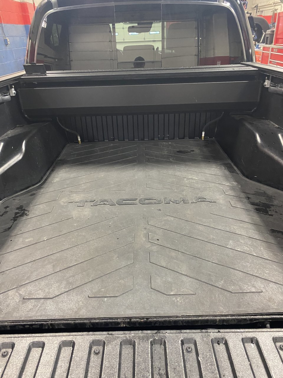

    Ran the drains for my retraxone today. Probably over kill but no way was I drilling a 1/2” hole in the bed. Had to adapt down from 1/2” to 1/8” line for it to fit in the predrilled oem holes which may cause some restriction (sarcasm) a lot of restriction but not much water is gonna get trapped in there anyway. Hoses came out right above the frame and tank on driver side and right above the muffler on the passenger side. Had to cut out notches in the bed mat for it to fit right but came out good I think.
    2245322D-A05C-41AC-AA09-112798B9EE18.jpg E5E06735-23B8-4D07-A4F5-C4682C2587F0.jpg 4327D990-5042-4A1A-ACD8-59CB54DF4C1E.jpg

    Not overkill, thorough.

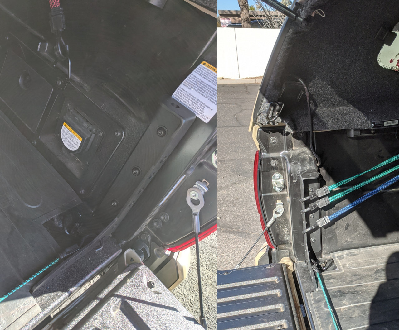

    I installed my bed stiffeners and i also customized the startup image on the touch screen.
    EDIT: I figured everyone has seen bed stiffeners installed, but I'm happy to share.

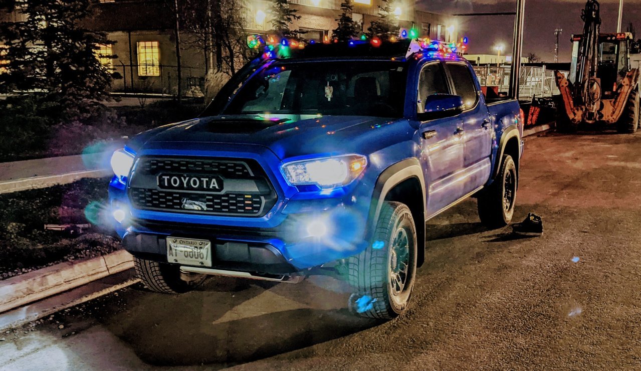

    Added some Christmas lights on the prinsu a few weeks ago, finally got a picture. Running them off the outlet in the bed.PXL_20201215_223432036.NIGHT.jpg
