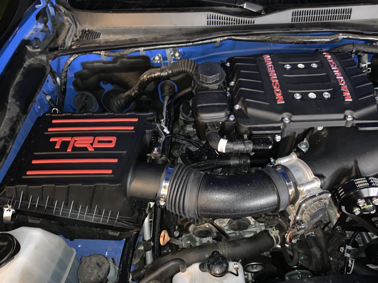

    Slapped this on too!C9B187D0-B3A8-4D7F-9AEC-770A2551B637.jpgCF2B13C2-EFBC-495E-BC38-6D7B10479296.jpg

    why not? it is the same engine.

    That’s what I thought but listings for that part always list 16-19 as compatible years.

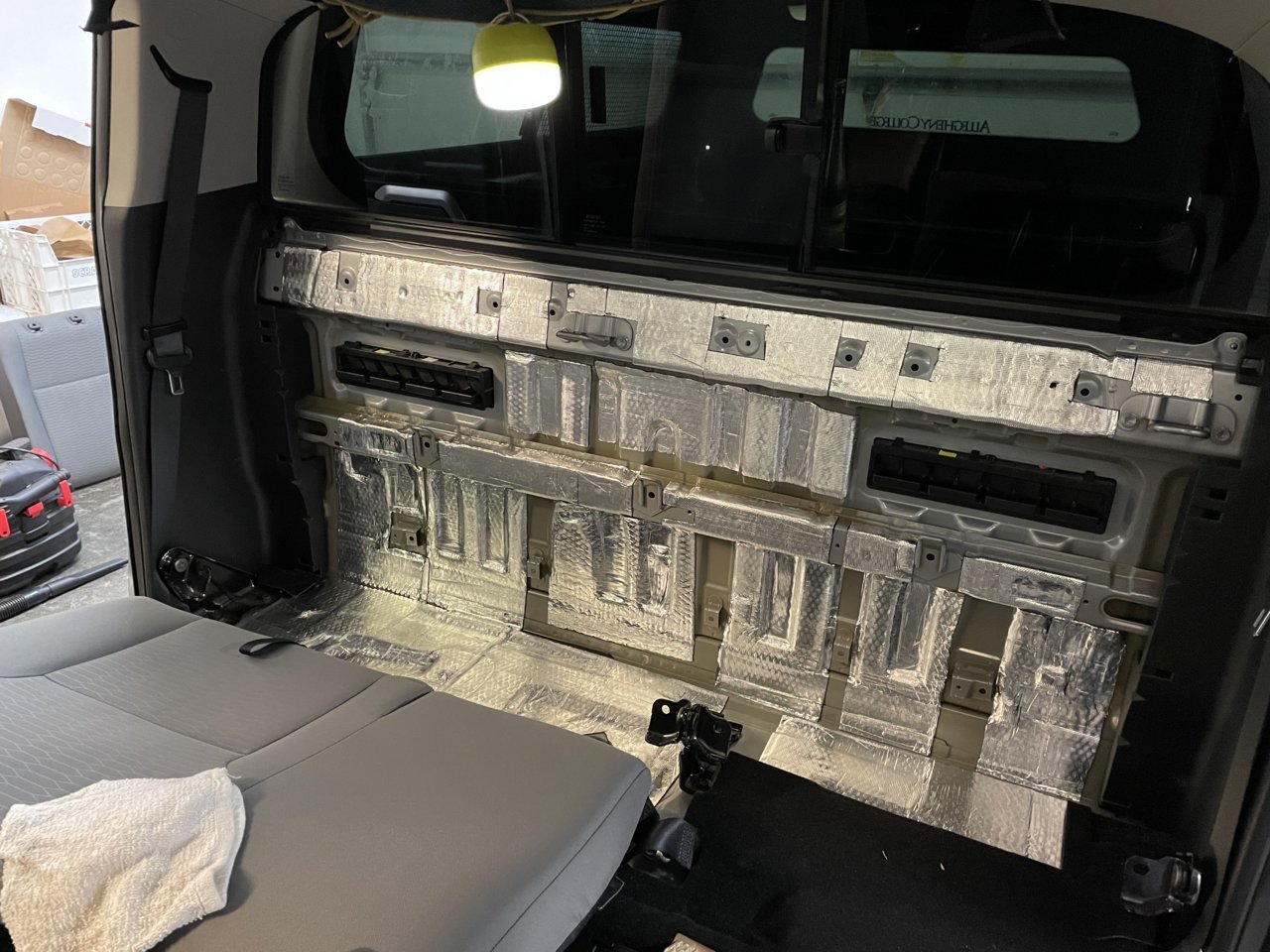

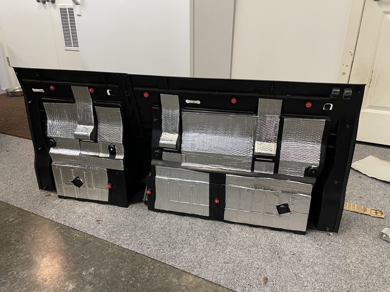

    Did something similar & added a closed cell pipe insulation baffle over the top of the vents in the rear wall. It cut the road noise even further while still allowing the vents to function.

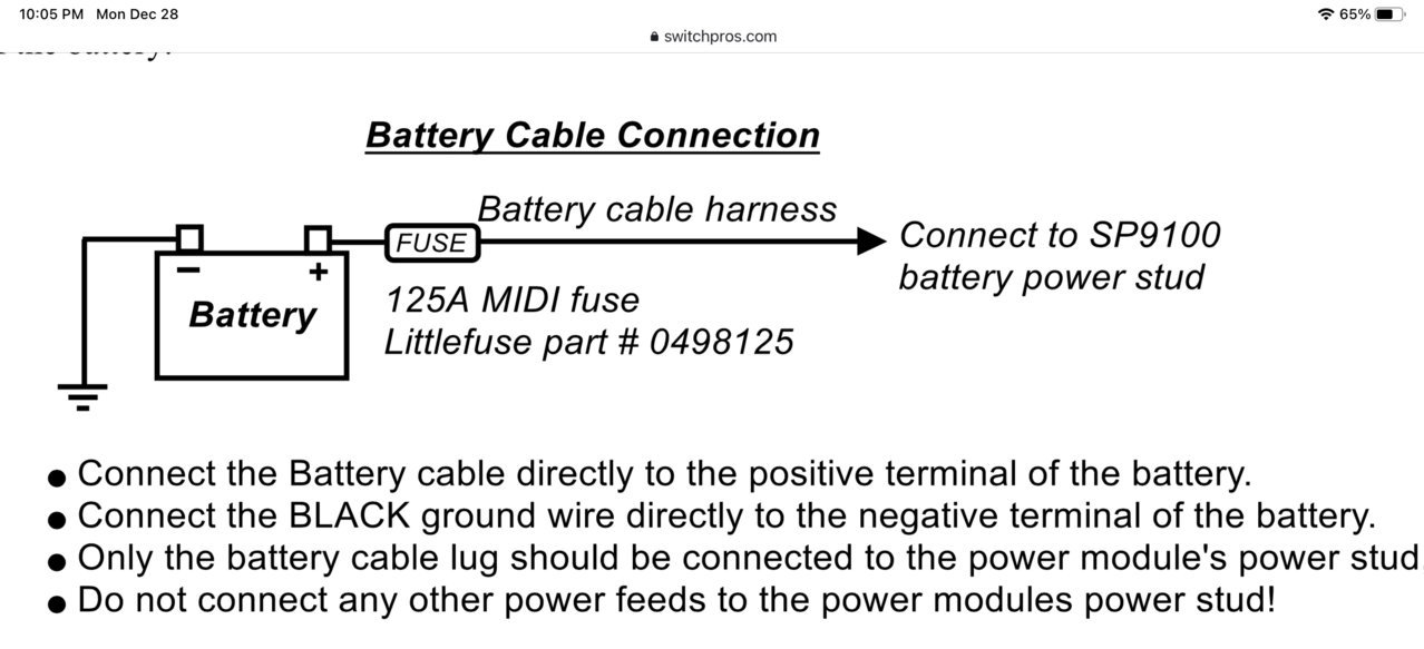

    Powertrays sells a kit with the recommended fuses.
    • 100A MRBF Fuse (for fuse block)
    • 125A MRBF Fuse (for Switch-Pros)

    Isn't the switch pros self fused?

    In that it comes with a power cable that has a 125A fuse in it. With custom length cables it makes it much more serviceable to have both the SwitchPros and BlueSea terminal fuse easily accessible.
