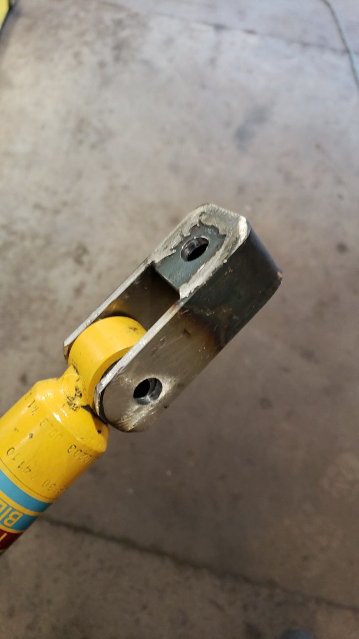

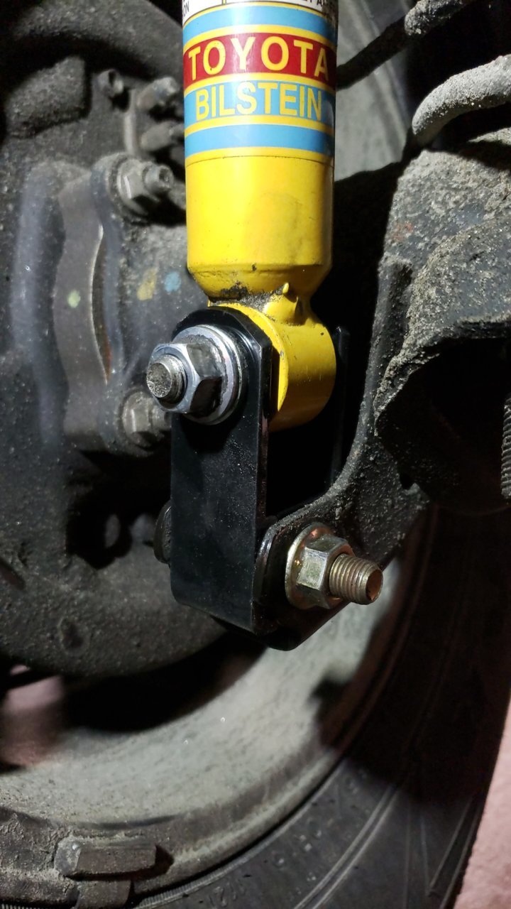

    That post didn't go as planned. I installed a 3 2 lift in the truck, and the rear shocks were extending all the way, and banging hard at times. I purchased a piece of flat bar at Home Depot, and fabbed up some 2 inch extenders. They work great!

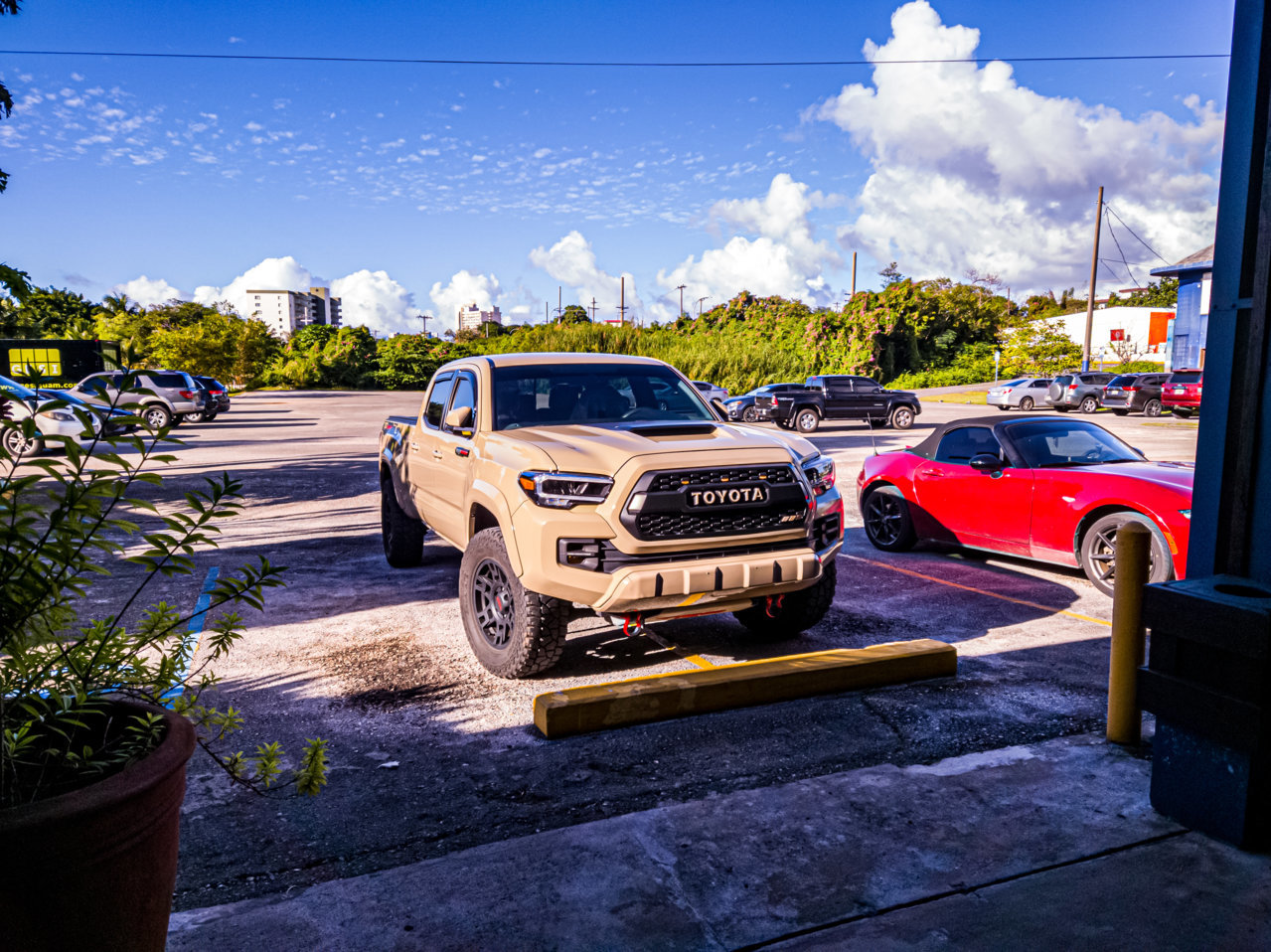

    Guam,
    the first US soil to hit the New Year.
    GMT+10
    The quietest new year though,
    Usually people are going around sounding air horns, rolling coal, revving their engines till detonation, etc.

    Did you raise the bump-stops so the shocks don't bottom out?
