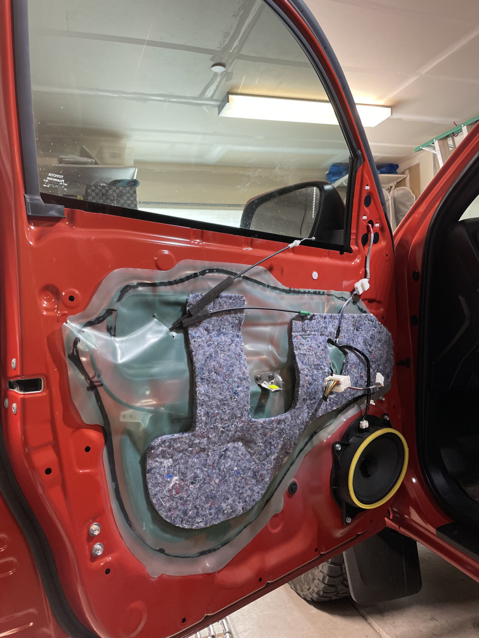

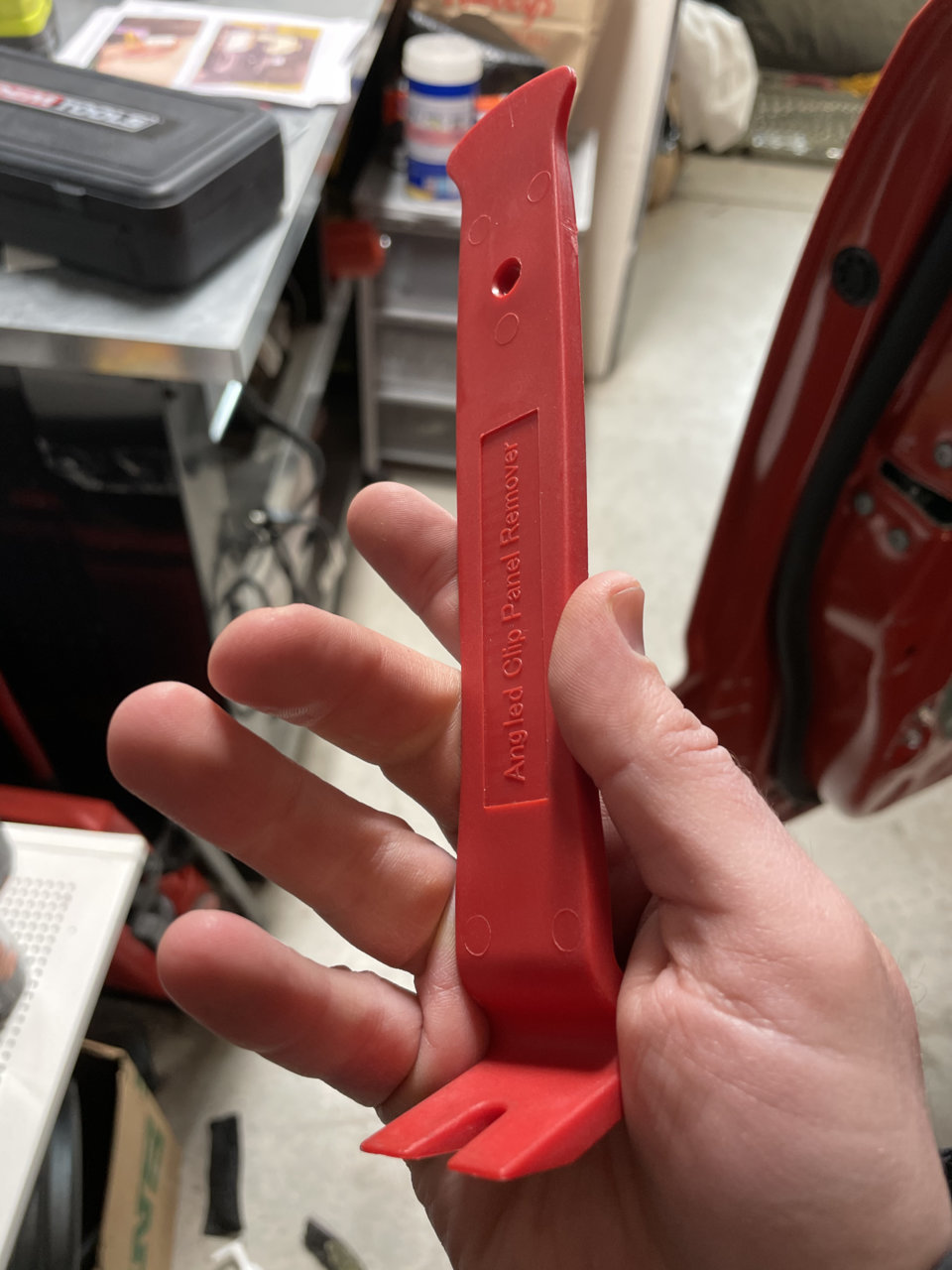

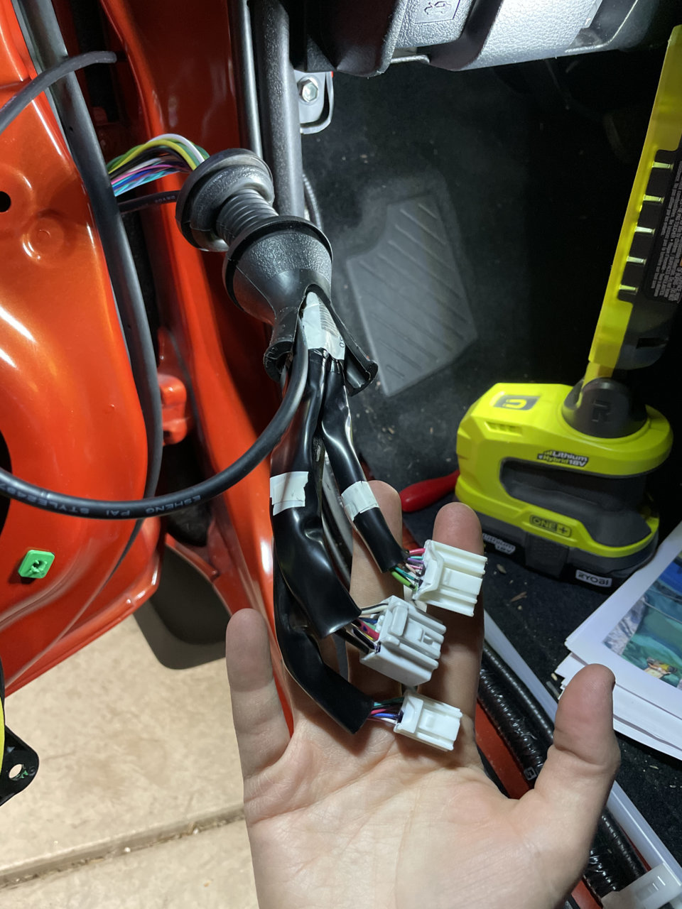

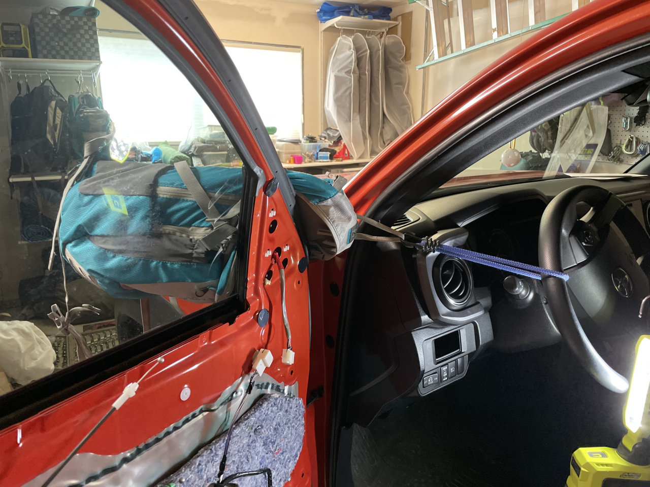

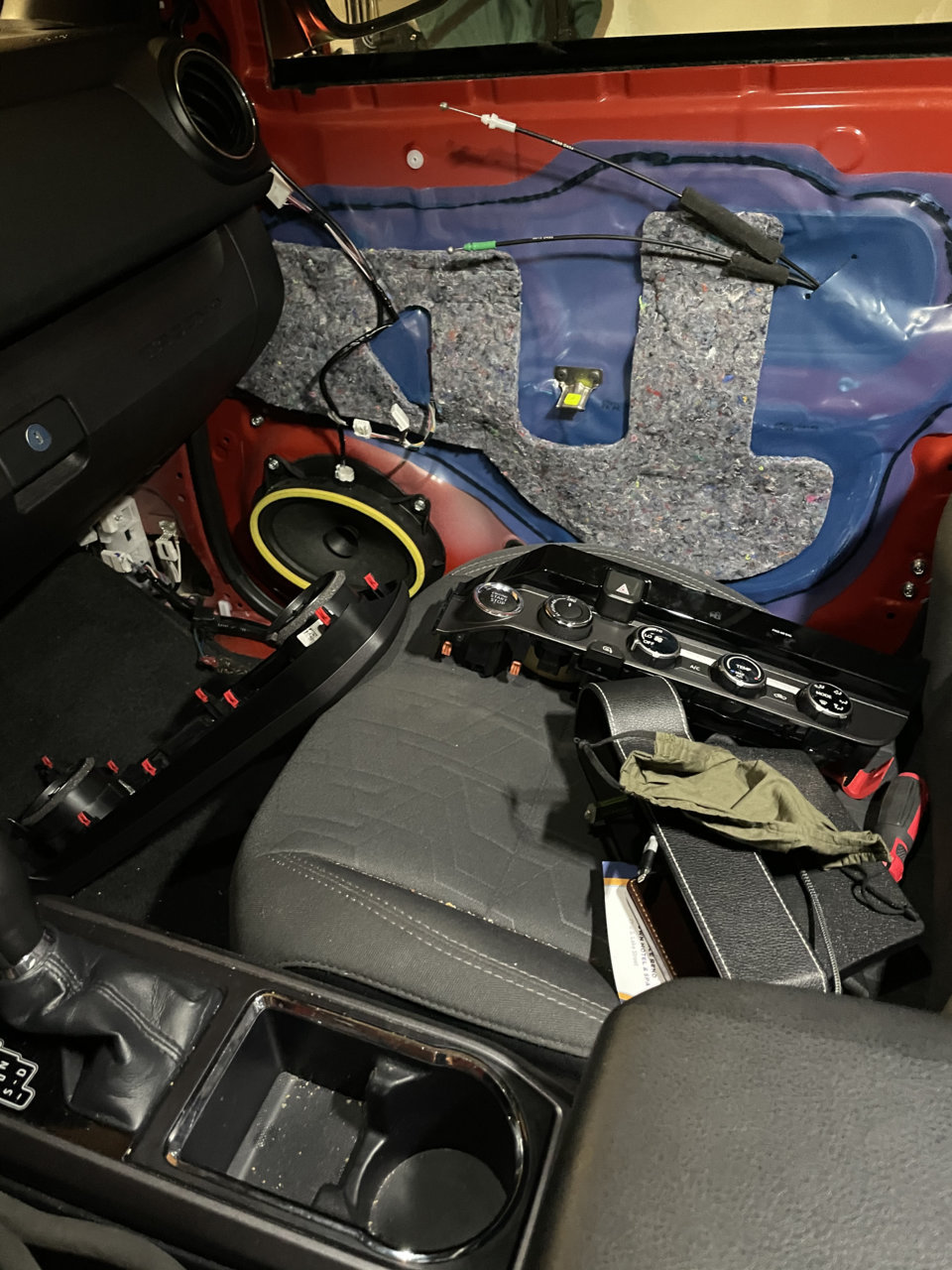

    Pull the window control portion out of the door before you remove the panel. It just pops off with your trim removal tool. Easy easier to get at that connector.
    I've found with all these little clips you want to make sure to put them on the part, rather than leaving them in the spot they click into.
    If they get stuck in the door when you remove the panel, pull them out and put them back on the panel. Then when you put the panel back, line them up and give the whole panel a good whack with your palm. Also don't do it when it's freezing cold, a little warmth makes everything a little more pliable.

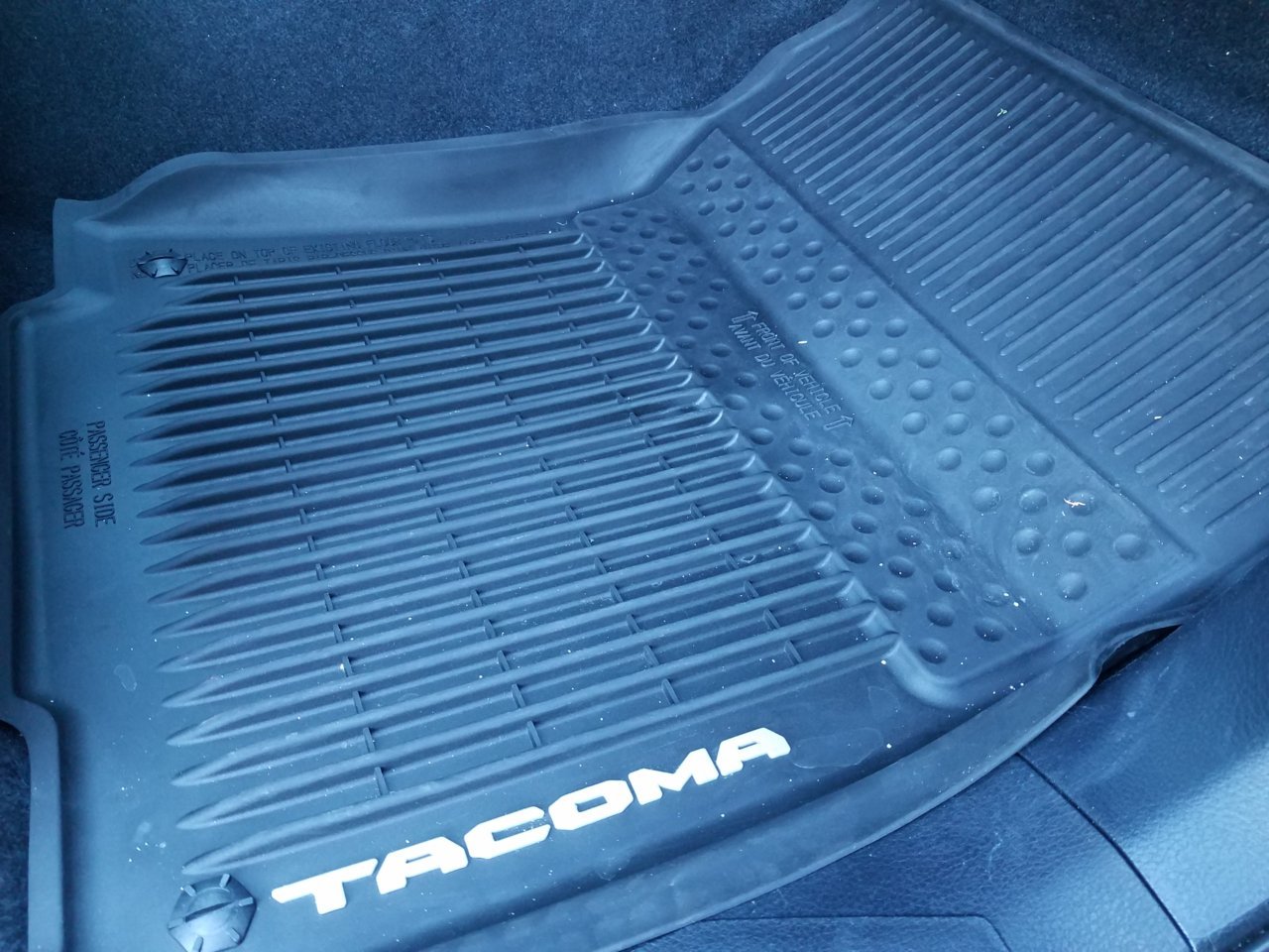

    Installed the eagle klaws on the passenger side floor mat.

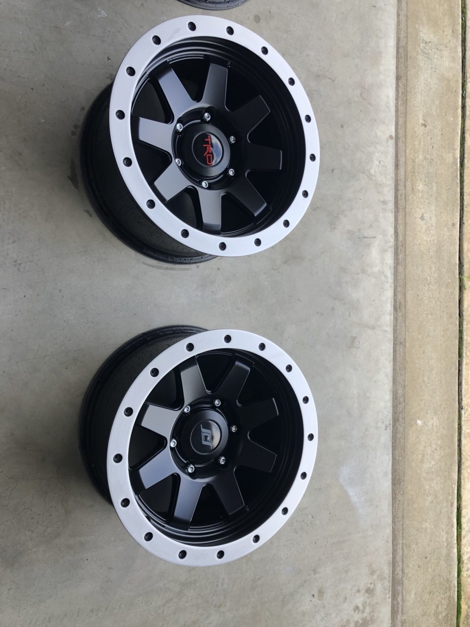

    I didn’t like the TRD red with the black truck. Nothing a little plasti dip couldn’t fix.
