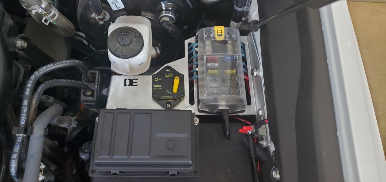

    I added an auxiliary relay box. I also feed the wires to the switches in the cab thru the grommet in the firewall below and to the right of the master cylinder/brake booster.

    Source power from the aux fuse box is supplying the relays. How did you supply power to your switches.

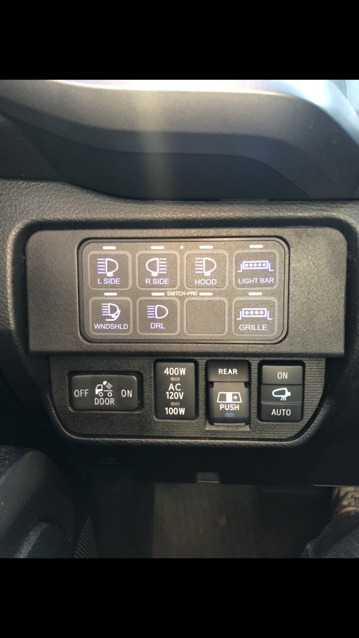

    I went with a Switch-Pros set up. Clean and easy.

    Switches are powered on pin 30 of each relay since it's hot and fused, so there is no need to power the switch from anywhere else. Just required pulling more wire thru the firewall.
