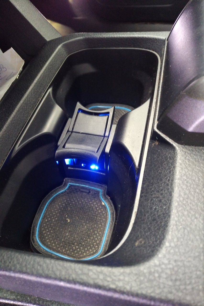

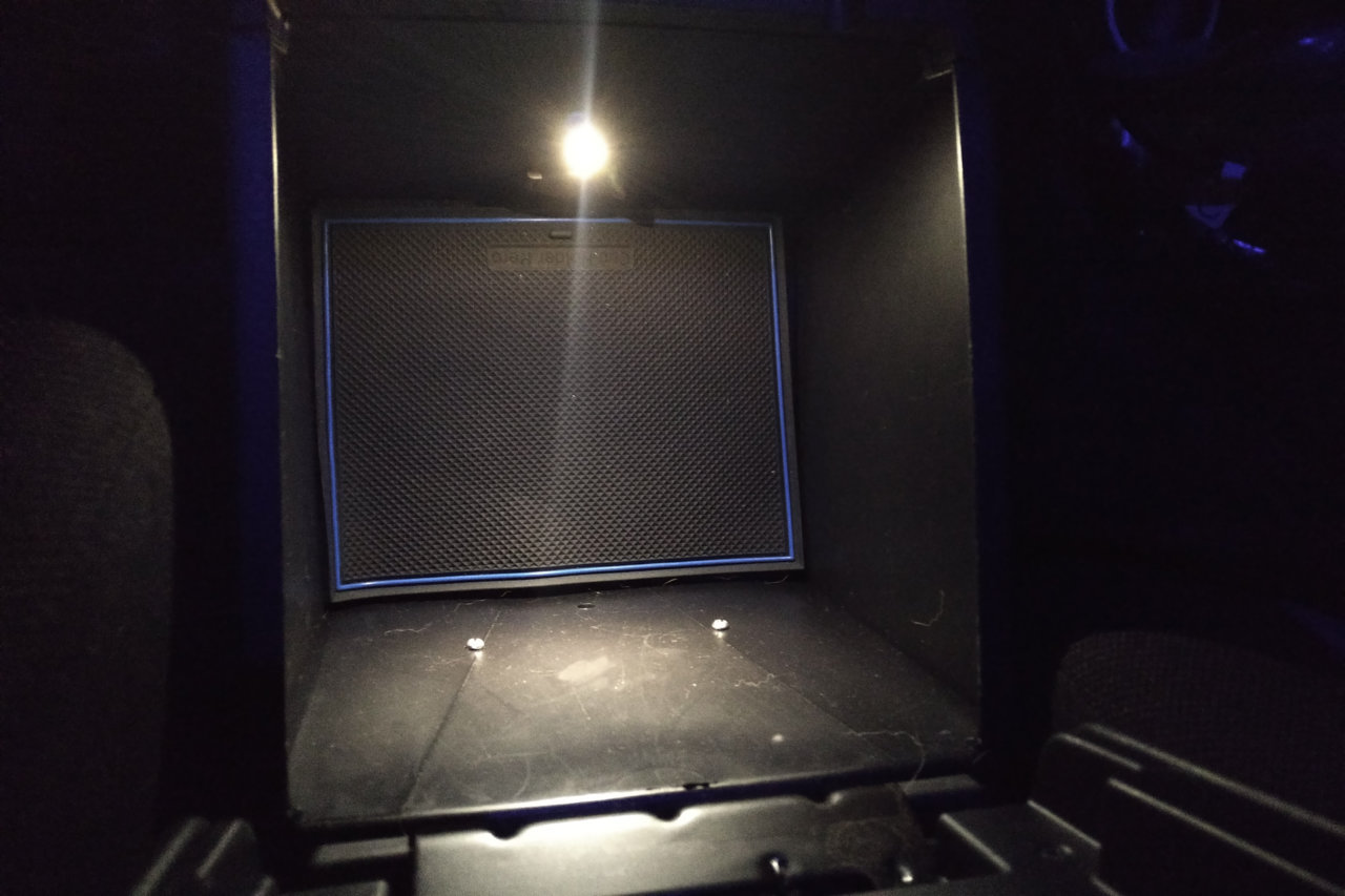

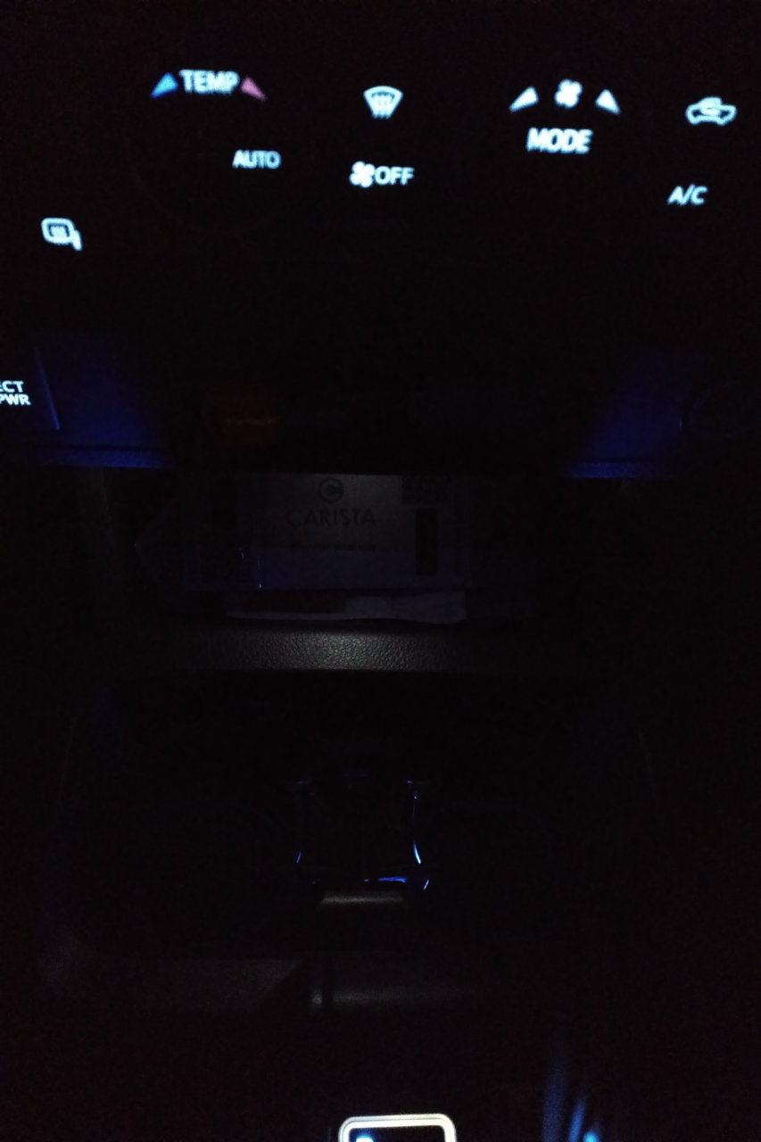

    Night view pics of adding an LED to front cup holder and centre console cubby.
    I noticed the LED illuminates the panel where the ECT switch and USB jack is.

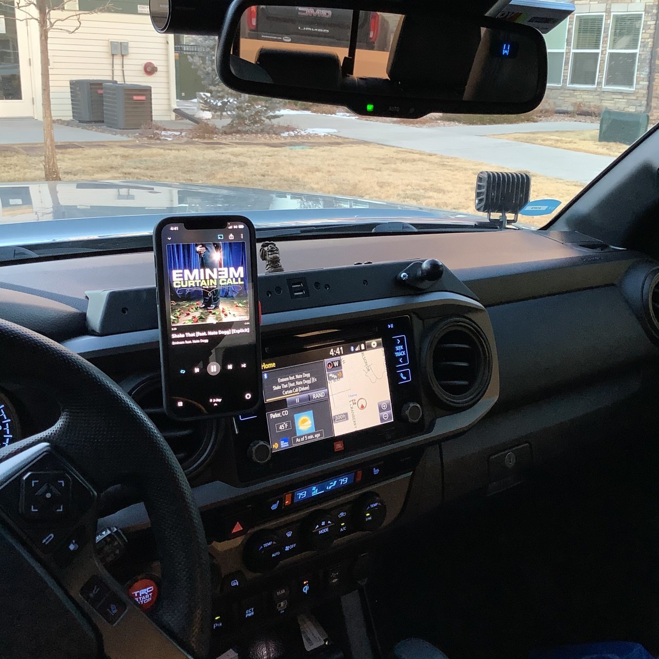

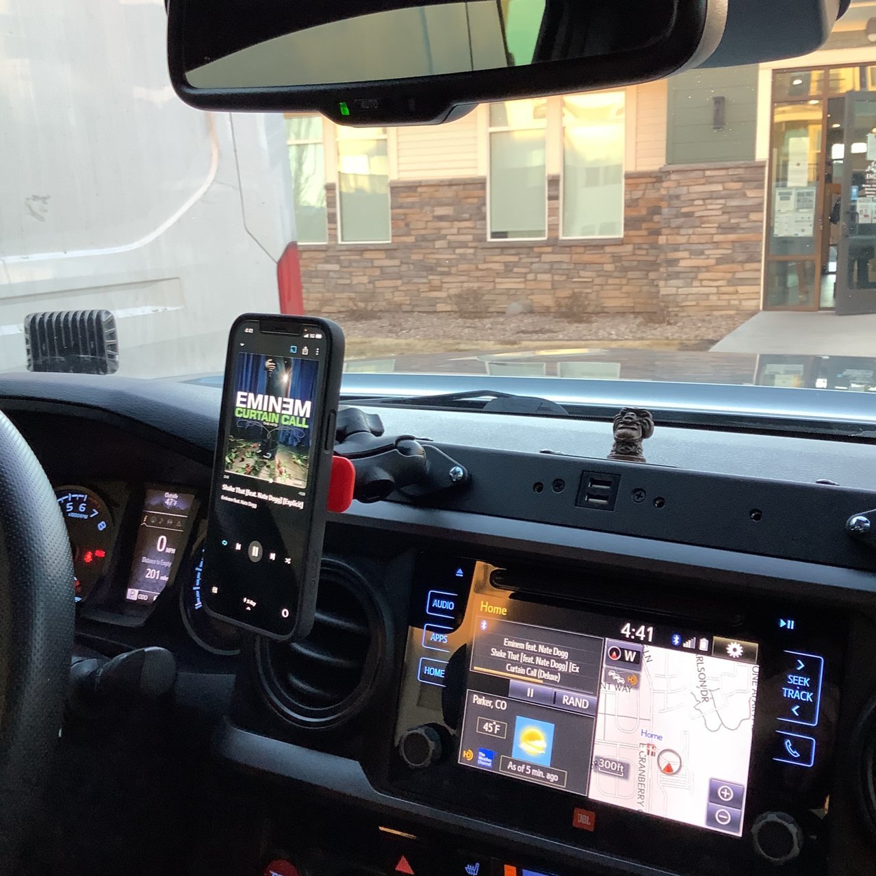

    damn i just bought a ram mount
    wish i would have seen this. that looks way better.

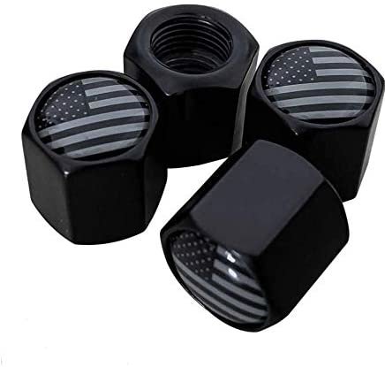

    Hard work, especially in the cold weather, but I managed to get these installed today.

    Those are fine looking nuts

    Some say to use some anti-seize when using metal caps to prevent dissimilar metal corrosion and basically welding themselves to the valve stem. They do look really good too!

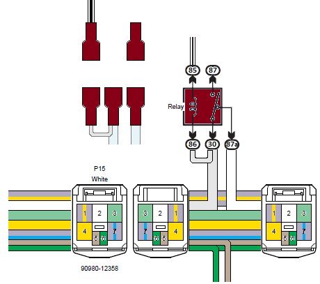

    OK, so, I'm going to mention this even though it's quite insignificant in the scheme of things.
    My kids are 3 and 5, both boys. I think some of you on here are also parents of small children. We usually drive the minivan but sometimes I take them to Jiu Jitsu or the bagel shop or Home Depot in the truck. They've gotten a bit more aggressive in how much they like to punk me, the 5 year old encourages the 3 year old who has no concept of right/wrong or boundaries and they both giggle as they find ways to annoy their oppressive dad.
    One of their favorite things to do in the truck is roll the windows down. Especially if I don't want them to.
    The way the Tacoma works, the window lock also locks out the driver's ability to adjust the windows. So it's a good enough lock if the windows are already up and the lock is on. But it doesn't help get the windows up when they are down and an obnoxious child is holding the switch. Hence yelling and general unhappiness. And it also blocks the front passenger who might have opinions about the driver deciding when she can or can't use her window. Just maybe.
    With significant help from the ever prescient @caribe makaira I planned out a switch and relay solution to cut power to the switch. Which would require running some wire (which I bought) and a switch (which I bought) and one or two relays (which I started to put together) when I got the feeling that, man, this is just too much work. I figured I'd double-check that simply disconnecting the switch wouldn't do what I want, it doesn't.
    But, since I have KTJO bowl lights, I then tried depinning terminal 2 and it works exactly how I want. That was the plan with the switch and relay, when activated it'd break pin 2 which is +12v to the switch. Driver controls rear windows up and down, rear passengers can press the switch but it doesn't do anything, illumination is all good. To fix I can replace the jumper in the T harness and it'd be back to original operation. I figure that won't happen for a few years with these two. Maybe never. Who really wants rear passengers to have any say in anything?
    If you're wondering which is pin 2, it's the solid white wire in the middle of the row which has 3 terminals. The connector is 7 pin with the other row's middle pair providing dimmed illumination. Diagram below courtesy of caribe.

    I have those exact ones! Guaranteed 15HP gain at the wheels!

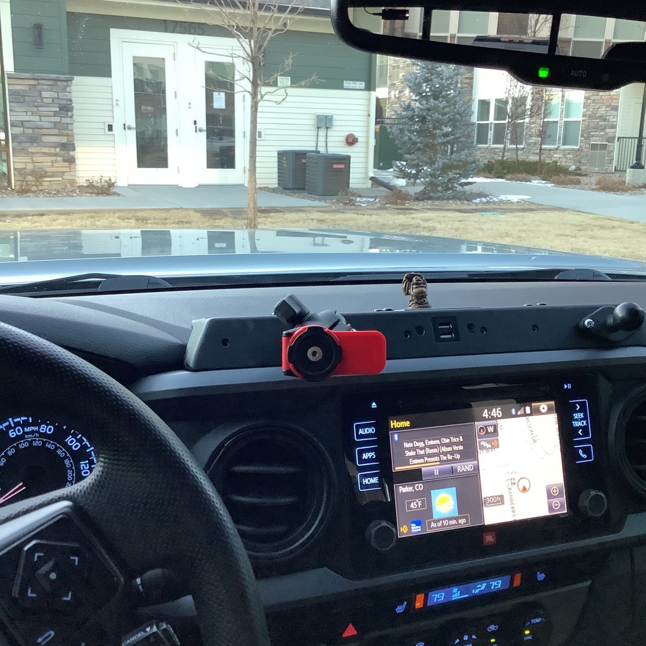

    the ram was a good mount. I just didn’t like the fact I had to use two hands to put the phone up there. Plus with the QuadLock, you have to have their case in order for it to mount. You can have almost any case you want with the Ram.
    There was actually a dude on here that was 3D printing them. It was a long time ago and can’t remember his call sign, unfortunately. :(
