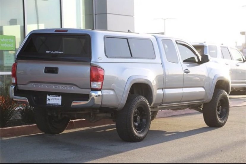

    Looks awesome! I ordered the same 3 leaf progressive pack along with OME 886 coils. Gonna order a set of Billstein 5100’s for front and rear as well as new UCA’s. Had 5100’s with 887’s and the 3leaf progressives on my ‘17 access cab. I left the overload leafs in because I had a shell and it gave it a slight rake back with the extra weight. :cheers:

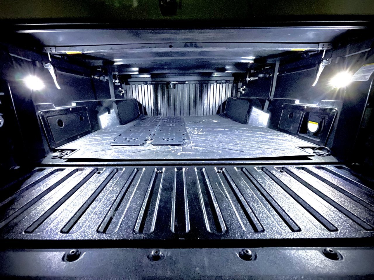

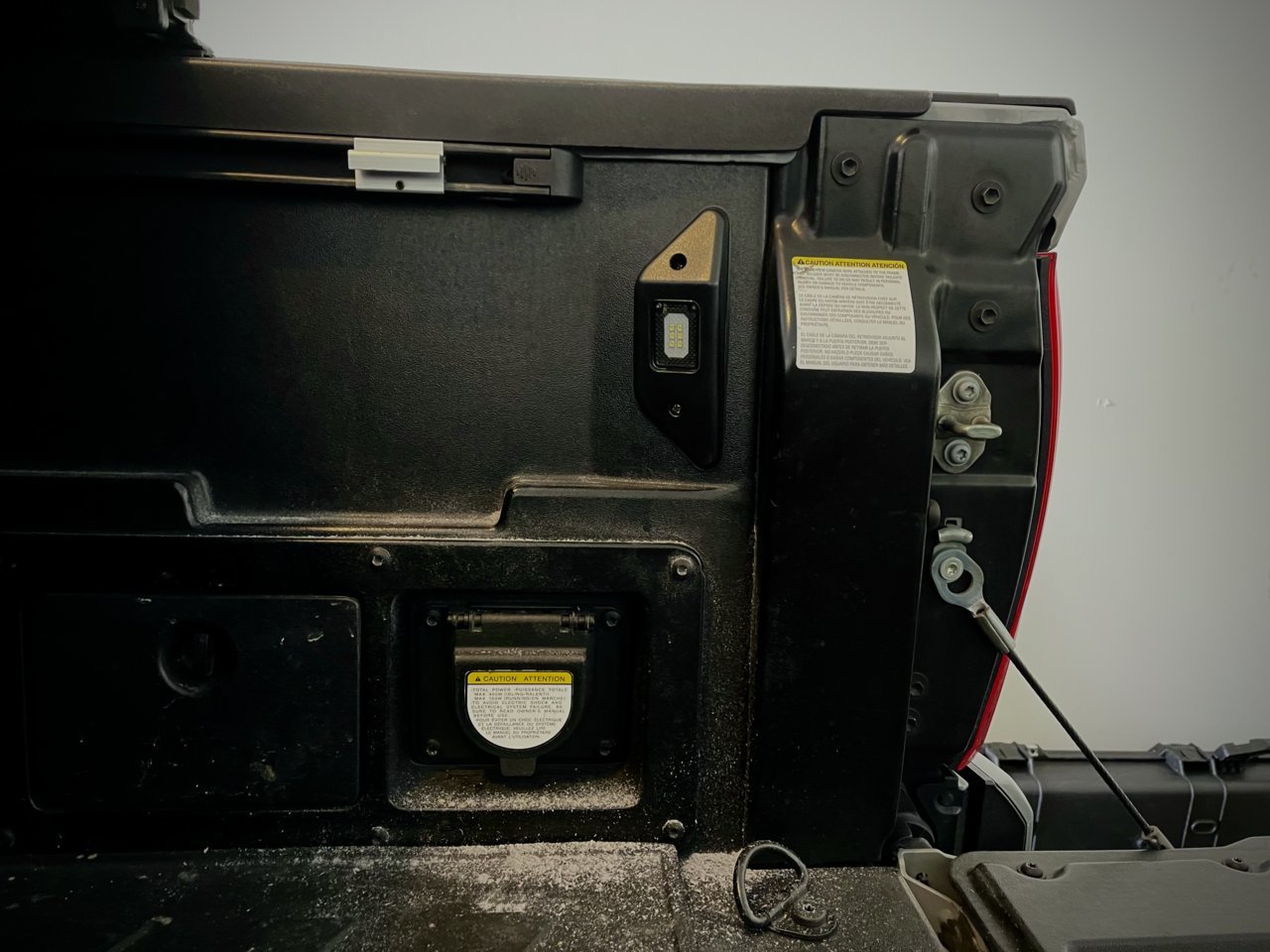

    Installed an OEM bed light kit.
    ...and hated every damn second of this install.
    reminded me of why I pay to have someone else suffer through installs.
    Other than that, the kit works great! Lol
    (pics before bed cleaning)

    Is that an OEM kit? Doesn’t look like the ones that come installed from the factory....?

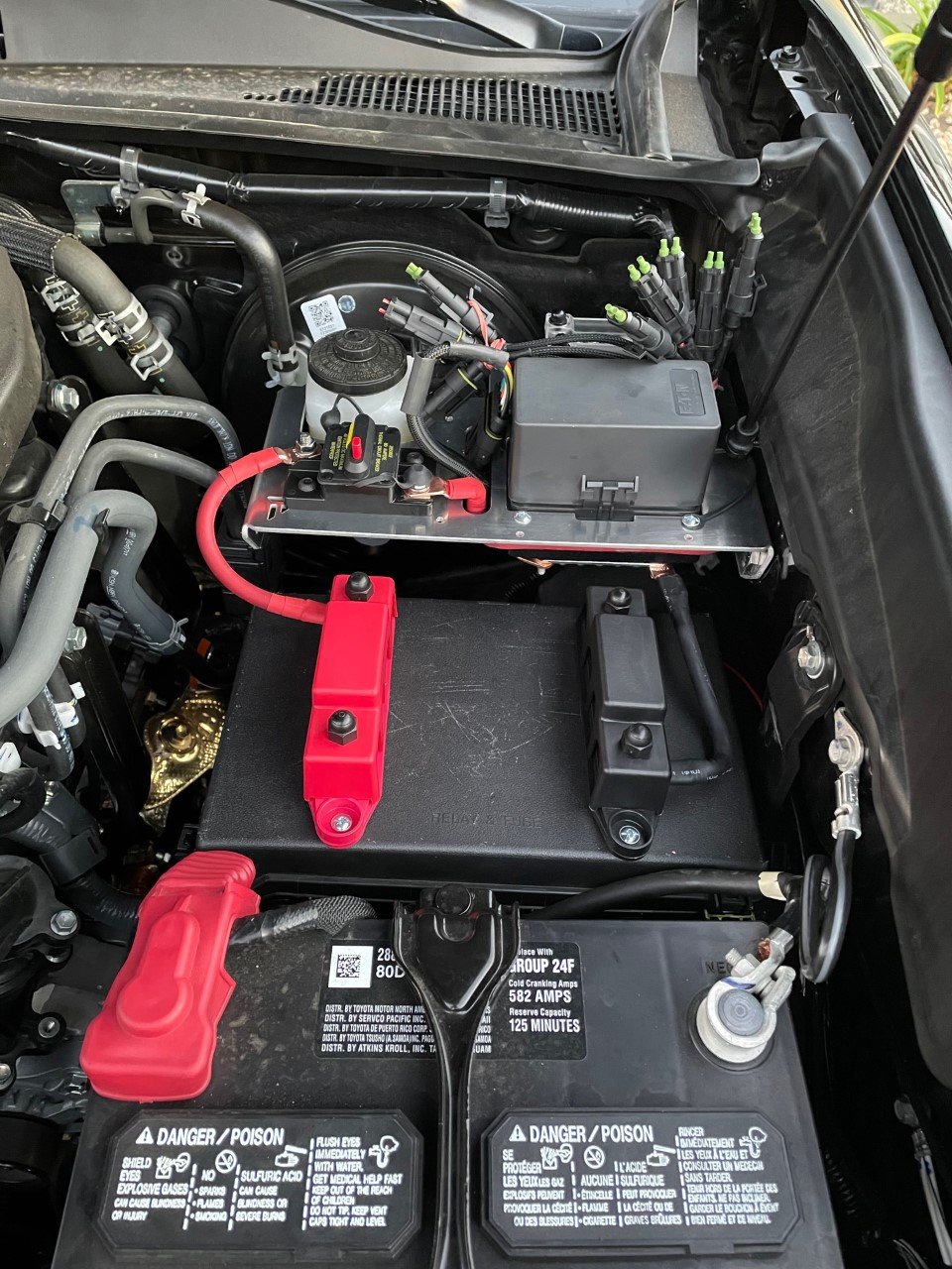

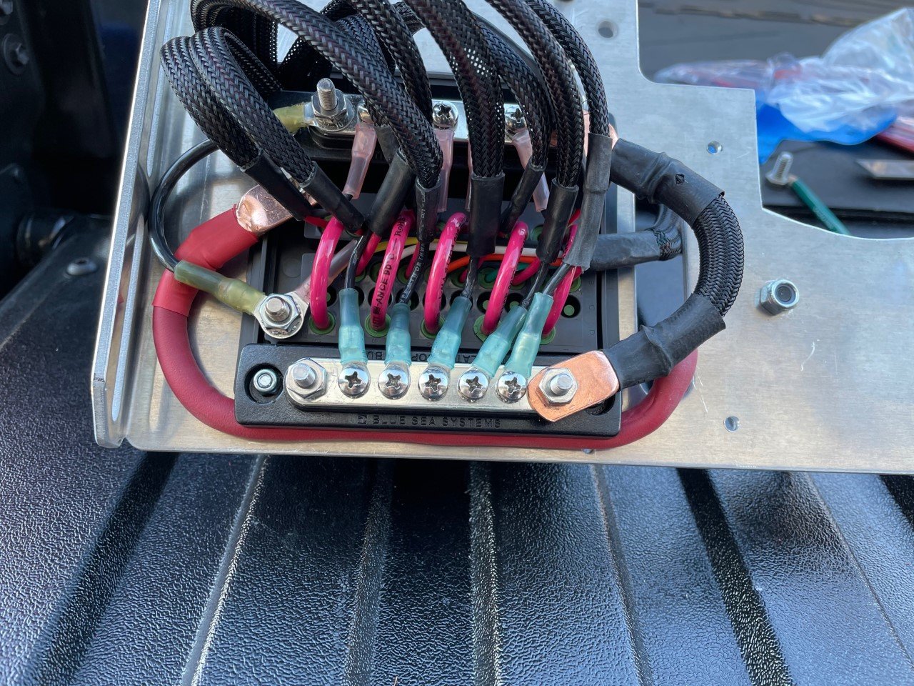

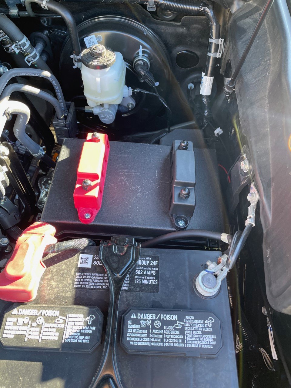

    Finished adding the Battery Terminal connectors (POS/NEG) installed them on top of the fuse box (made sure the bolt holes were watertight).
    Added in the Positive Power 4 AWG underneath, and on top.
    And... mounted the Powertray with a cutout for the brake fluid - and the Bussman RTMR is now setup and ready to wire things to it.

    IMO, I think they look 10x better than the OEM.

    I have a 2018. You have a 2020. They are different kits
