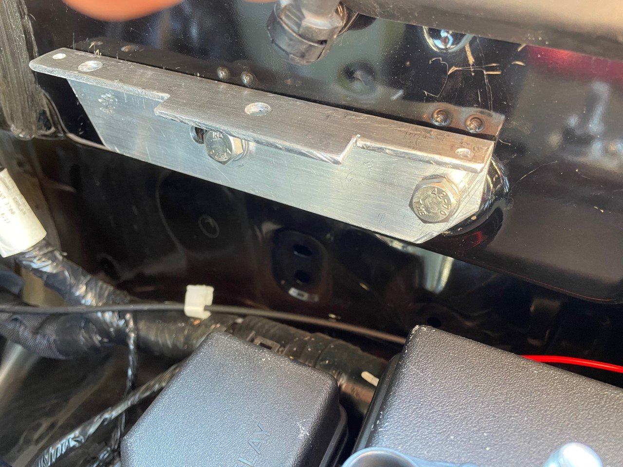

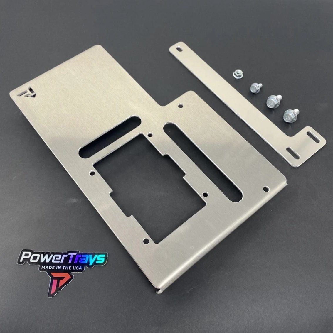

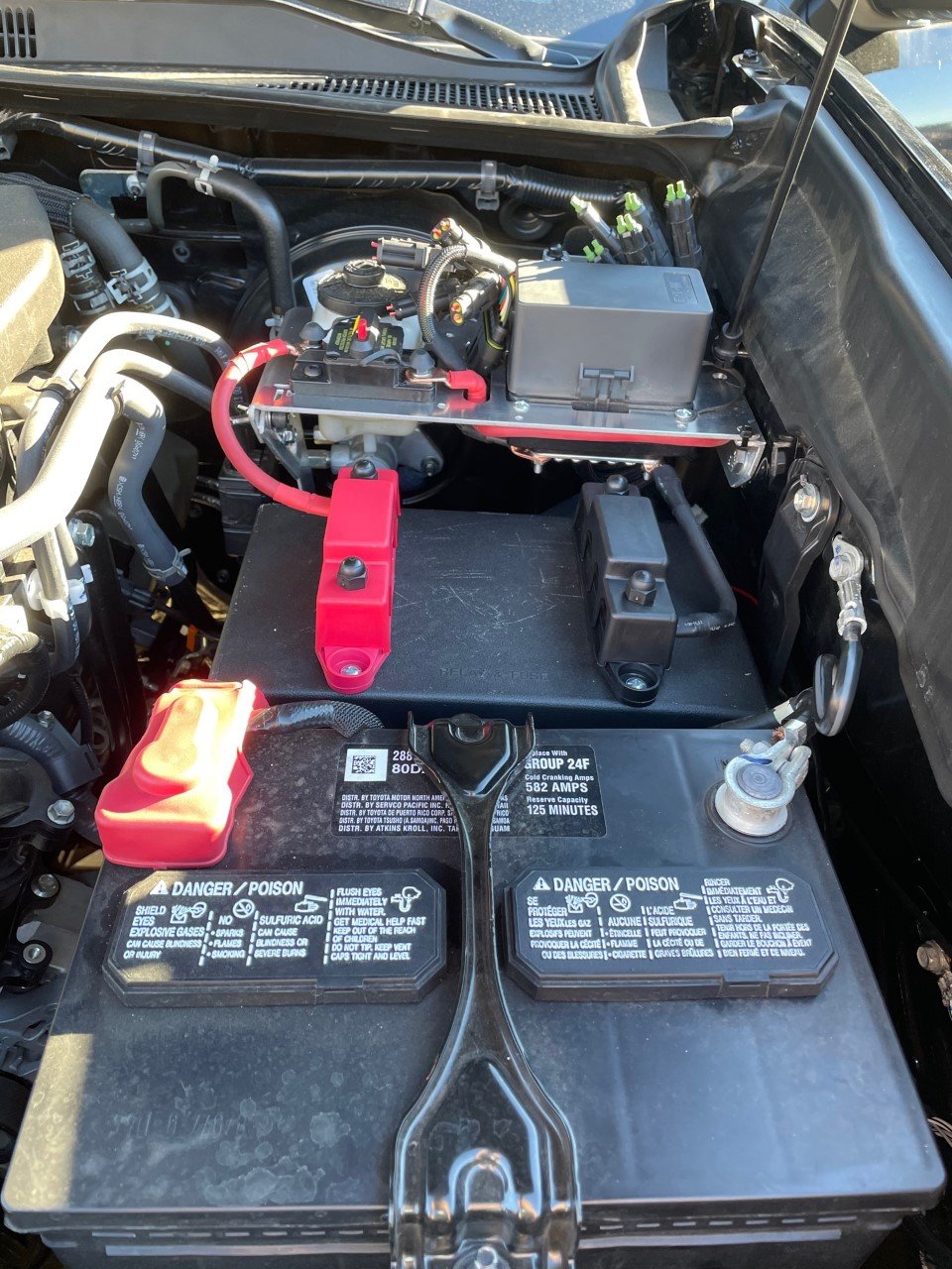

    So the original Powertray was nice - but - it wasn't quite the best fit for my 2020 Tacoma. It needed some... enhancements.
    First thing - getting those damned BOLTS in was a nightmare. Big hands, small area. NOT a good idea. So, I sheered off the right side of the Powertray and created a new bracket for the side, then it was *easy* to bolt it in and lock it down.

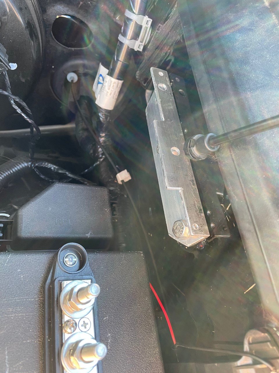

    Now - all I needed to do was put in that left side aluminum riser.
    But - that was kind of a bitch too. So, I loosened the bolt a bit - then see the slot at the bottom - well, I drilled that out and made it into a fork and stuck it against the frame and the clamp and then locked it down. I took the piece of the powertray I ground off and turned that into a small bracket to extend to hit the tray at the right angle and make it level - then locked in the bolt.
    Here's a closeup of the aluminum angle bracket I created. Not very pretty - but its same aluminum used in the Powertray.
    The two small holes in the ends are for zip ties, anmd there is a two 8mm bolt holes which I drop in a plastic plug and lock it in.

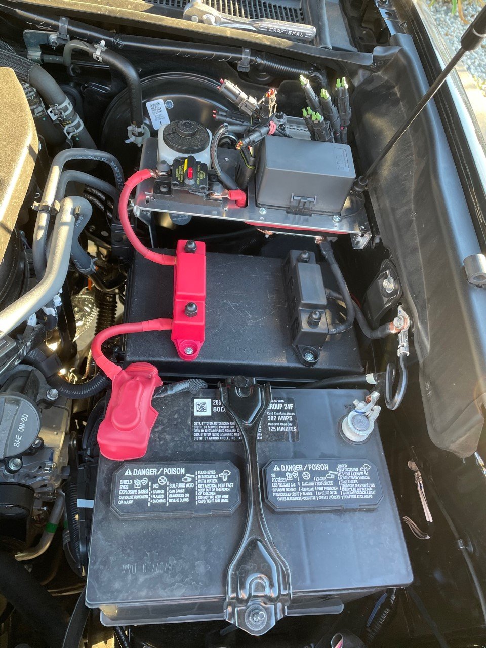

    Here is the Powertray RTMR fully populated and tray in place and locked down. Solid and doesn't move. Test drive over bumps and it didn't break loose.

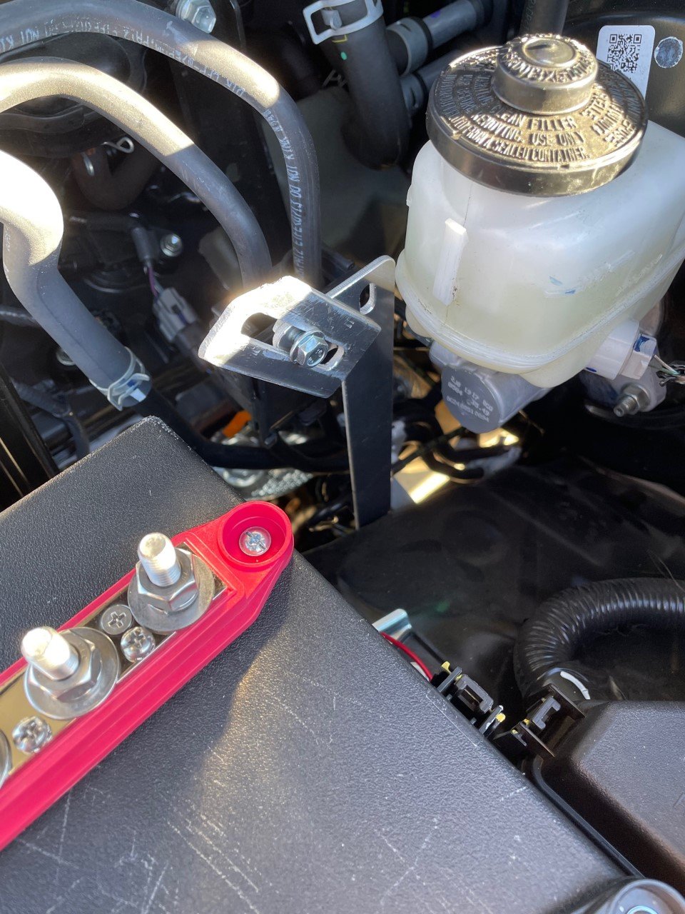

    Here's a better shot now that the battery cables are in. As you can see, there is a cutout for the brake fluid. A wing nut on the left side allows for easy removal - and then just clip the side nylon zip ties and it comes on out (after you remove the battery cables).
    I'm making a small plastic bar that mounts to the right of the RTMR which the cables will attach too so they look more organized. For now, they have a rubber band around them.
