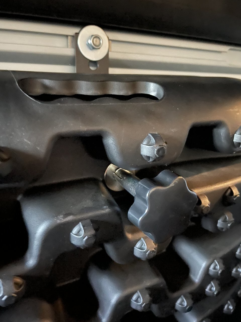

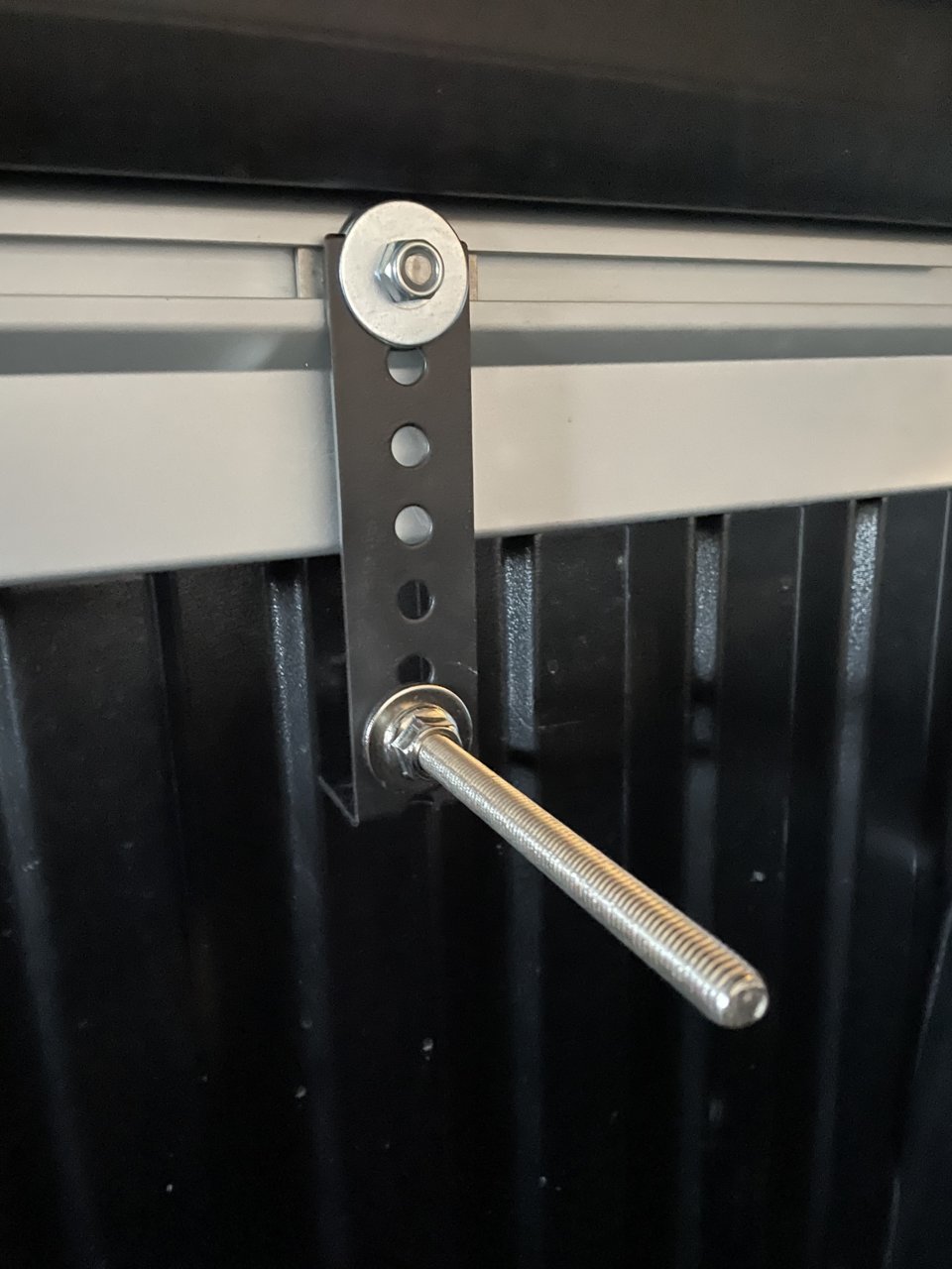

    Thanks. I just used some perforated steel flat that I cut, bent to shape, and painted to make mounting brackets. Used some miscellaneous hardware to attach those to the T-slots on my tonneau cover base, which cover the factory T-slot rails (which could also be used). Then I used some of the mounting hardware that came with the X-Bulls to hold the boards on the bracket. That hardware basically consists of some cheap threaded steel rod, nuts, washers, spacers and a nylon threaded knob to cap things off. Here’s a few more photos that might help.

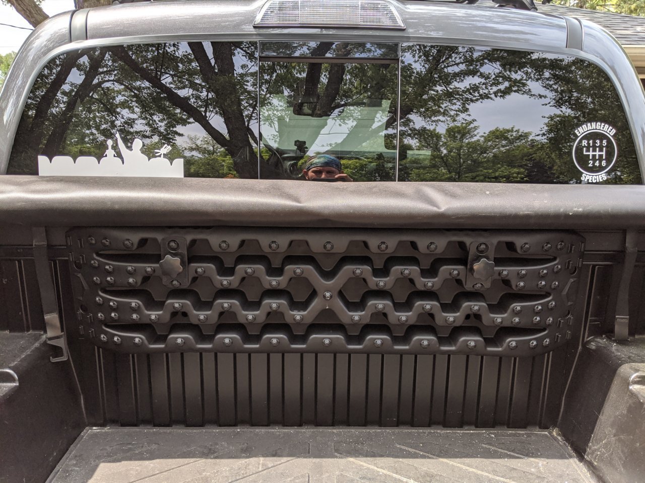

    I did the same with my boards too. They will fit under a regular roll up tonneau without needing the metal drop bracket, they sit right at the top of the bedrail..

    Did you buy special t-nuts or just find nuts that fit the t-slot?

    It's just a nut and washer that was included with the boards mounting hardware, I did have to file the edges of the washer for it to fit in the deck rail.
    The only thing I used that wasn't included with the boards was the electrical tape wrapped on the bolt to act as a spacer so the board doesn't rattle around. Everything else comes with the boards mounting hardware, you just need to get a little creative to make it all work.
