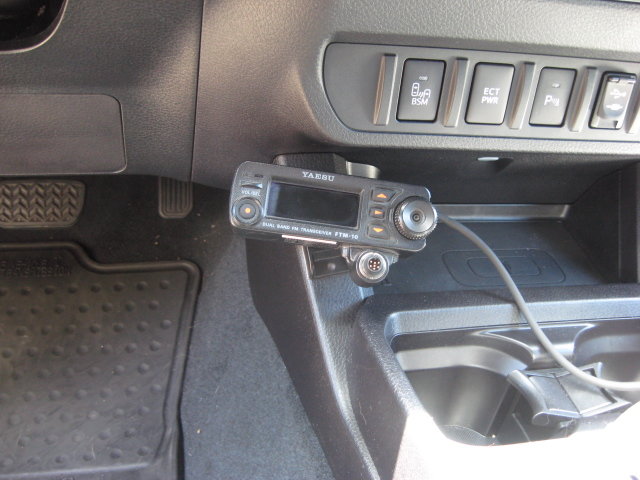

    Ham radio antenna,Firestone Ride-Rite air spring Snug Top topper, and a rifle rack y'all ..Moroso Catch Can, De-badged.

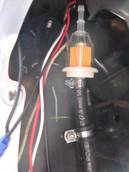

    Did the rear axle breather mod this morning, used 8' of 5/16" fuel line and ended with a fuel filter to insure clean air. Toyota part number 90404-51319 about 13.00. Hopefully there won't be any stinky axle fumes coming into the cap otherwise it goes high under the bed or up to the engine bay. UPDATE: I inserted a flexible 5/16" line on top of the filter making a U-turn right back down ending flush with the rear bumper. Any fumes are now out the rear for the enjoyment of pesky tail-gaiters.:brianr: Also mounted the Yaesu ham radio...
