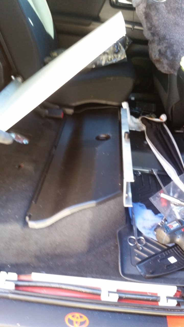

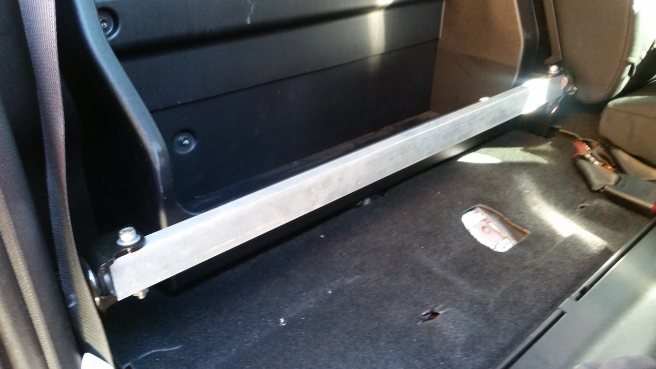

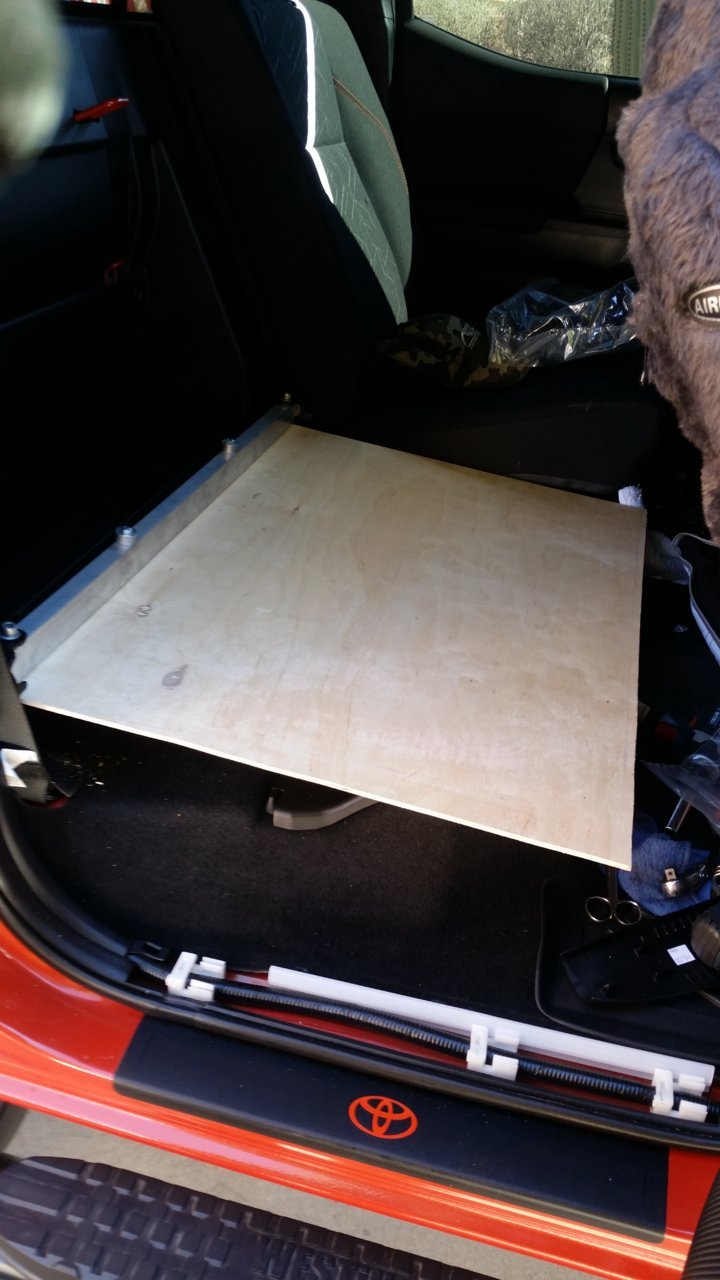

    I've been inspired by the rear seat delete posts to take a crack at it with a slightly different set of requirements:
    60% seat side only
    15 min swap back to stock
    utilize stock mounting options
    RETAIN 60% rear panel
    Pivot access to stock underseat storage
    REDUCE stock noise level
    I'm just mocking it up with hardware and aluminum I have to validate the design, then I'll go back and do it right...
    So far, considerable time spent with Noico sound deadening and insulation on the back and floor of the cab, but also on the back of the 60% panel, and retained the stock "hanging" pad. Drive testing with just the 60% panel in place seems to be slightly better than stock. That should improve with the design of my floor panel.
    Since I preferred to have the panel pivot from the rear, I'm utilizing stock seat REAR hinge mounts unmodified. The prototype (it will be 3/4" birch) 1/4"
    mounted to 1x1.5" aluminum back strut and thru bolted at the hinges and two mid points. This drops the deck to the right height for leveling as well. 1x4 aluminum channel provides the front deck support mounted with the stock front hinge bolts. The 3/4" deck will have 1x1.5" aluminum tubing thru bolted on the remaining 3 sides for "rails" which will obviously eliminate any flex, if there was gong to be any. I'll be using industrial floor comfort mat material (home depot, gray diamond plate pattern) on both sides of the deck for more noise reduction (bottom) and anti slip on the top. I'll line part of the back panel tray with it as well. More to come as it progresses...
    Rear 60 Seat delete prototype.jpg REar seat Delete Aluminum hinge.jpg panel is Rear 60 Seat delete prototype.jpg
