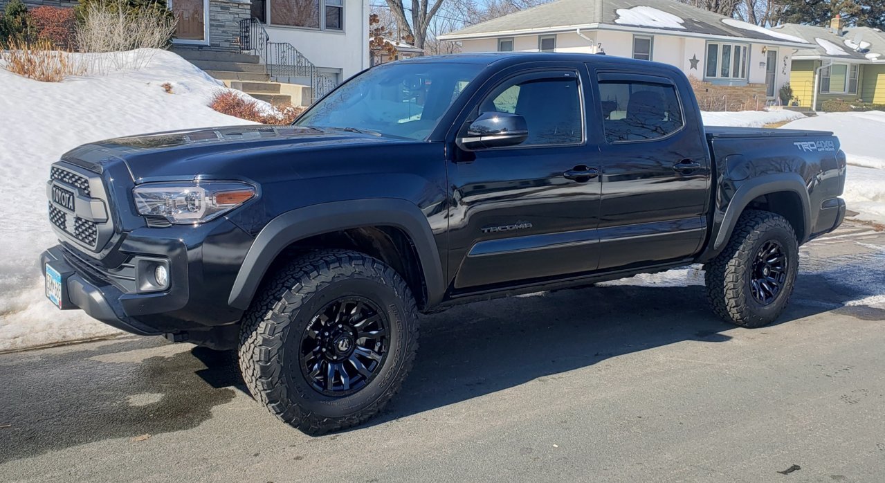

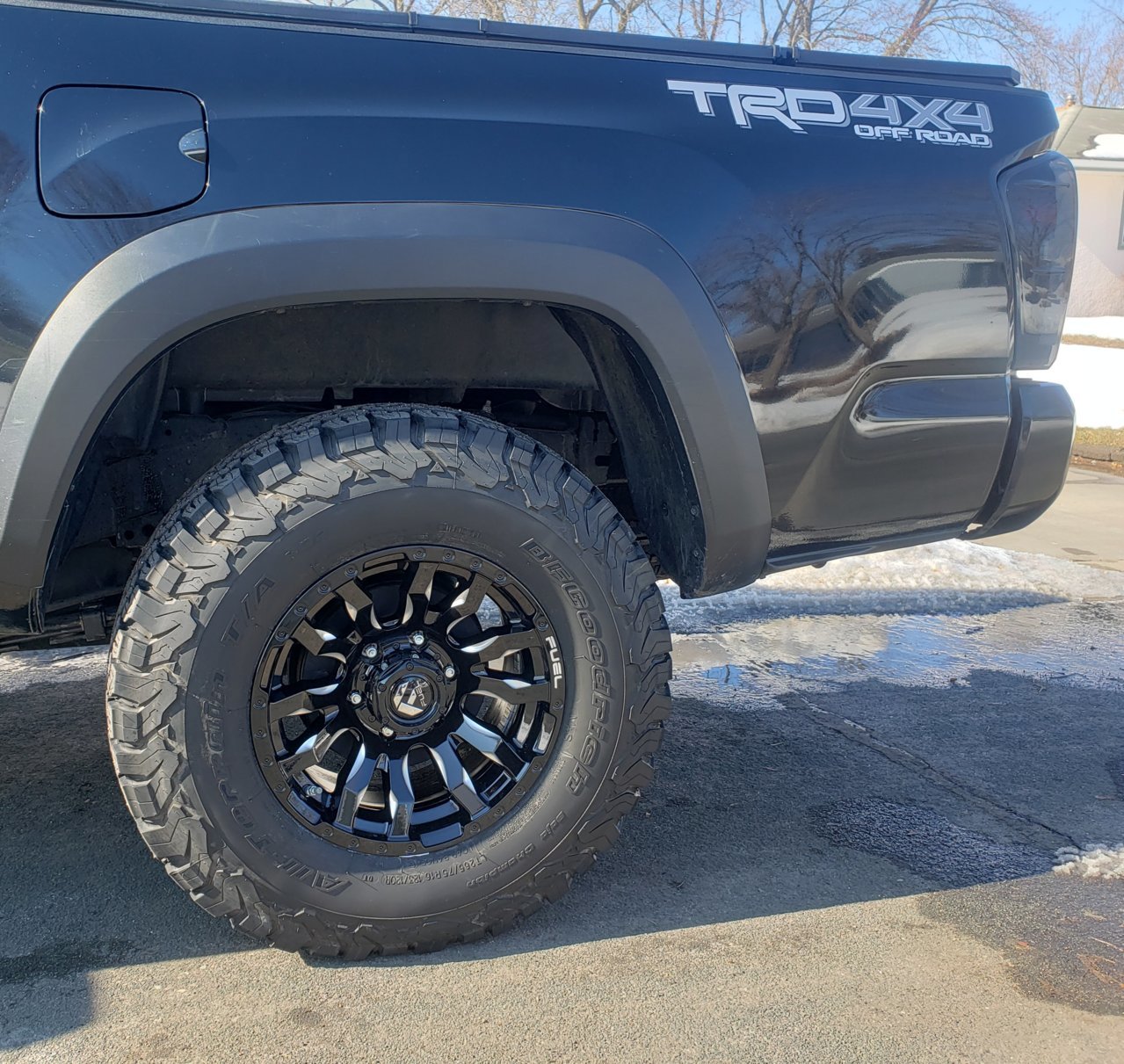

    Just got my Fuel BLITZ Wheels installed. I think they look way better then the Stock wheels. Stock OR wheels do look good too but I really like the look of the BLITZ wheels.20210225_121519.jpg 20210225_121329.jpg

    Looks a lot better than stock. What are the specs on your wheels aka size etc and on your tires....

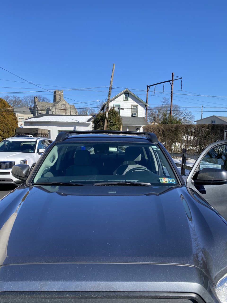

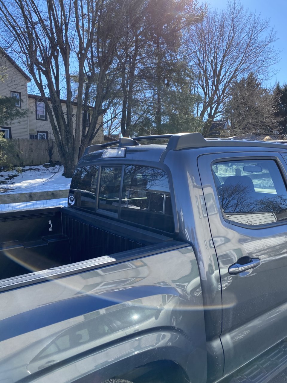

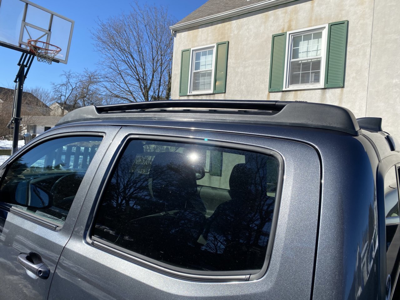

    Installed OEM Roof Rack....
    One suggestion, put the bolts through the foam washer and then start bolt before adhering washer to Taco. This helped me get better alignment on washer. On the first side I was off just a tad...

    how was the install on this? Was it easy to get the stock stripping off?

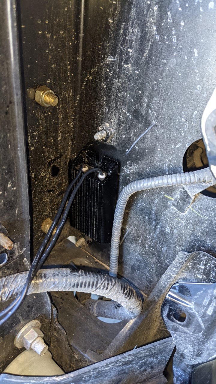

    Pretty productive day!
    Installed the MESO stage 1 tail lights, used Velcro to tuck away the little control box.

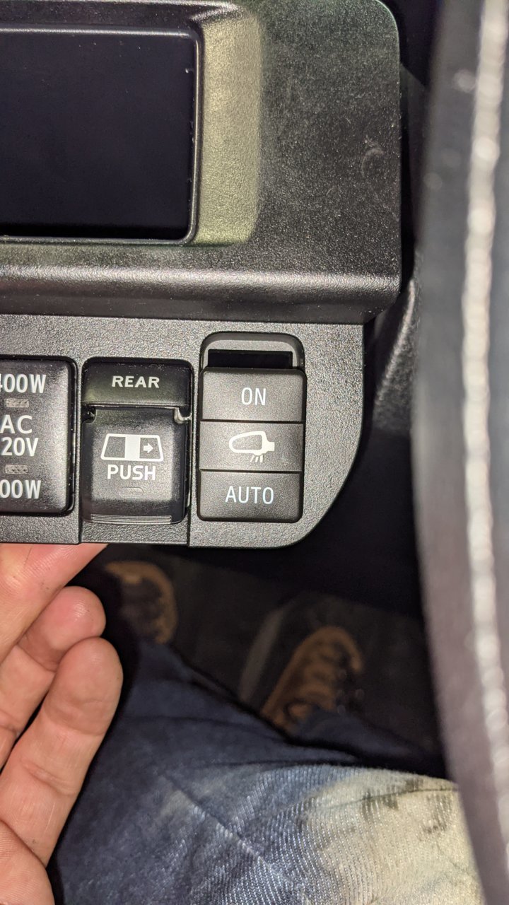

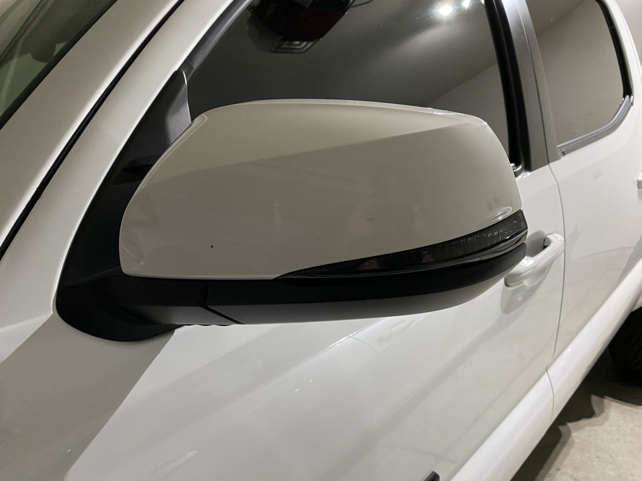

    Attempted install of MESO puddle light switch. But apparently it doesn't work for the 3rd gen. Bummer because it's a great idea, and let's you use them as ditch lights on the fly.

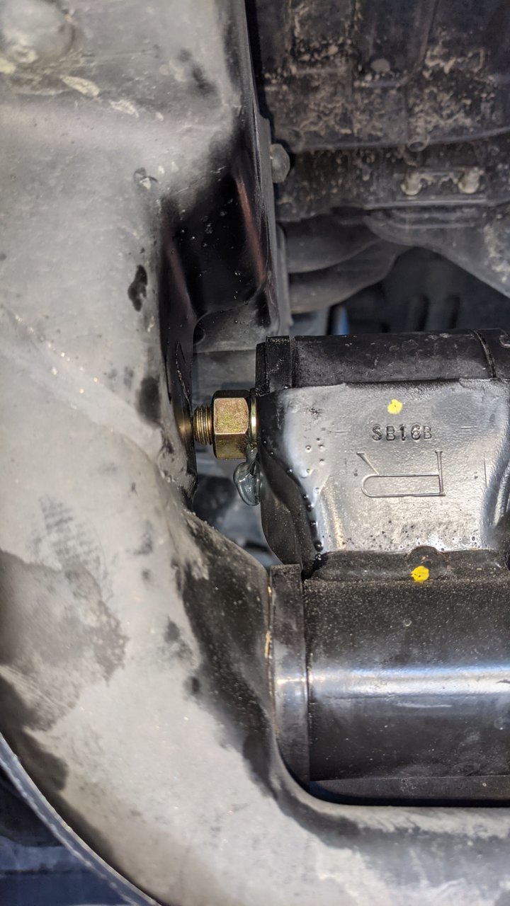

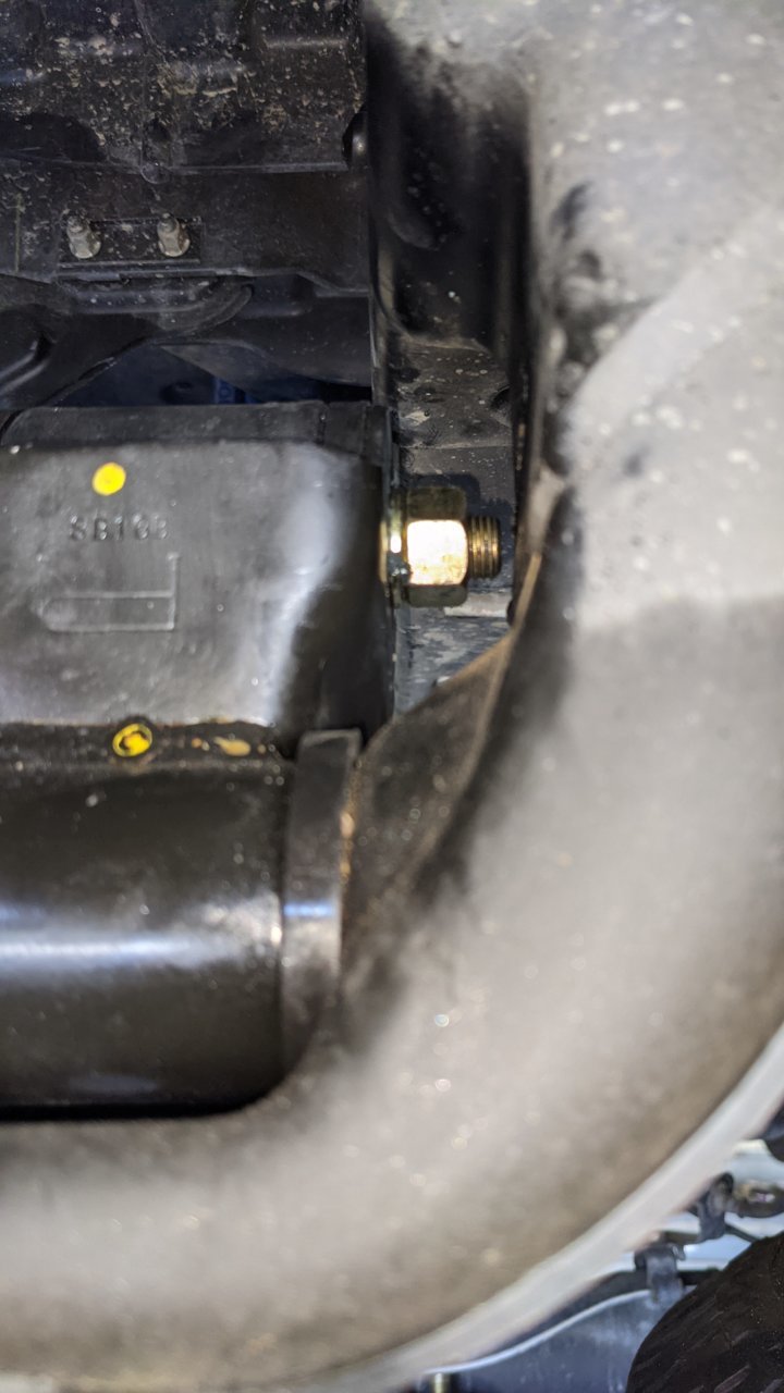

    Installed a set of greasable pins for my Dobinson leafs. They made these bolts shorter to prevent rubbing and still give you access to the zerk fitting. But for some reason it's still making contact on the passenger side...I didn't have time to file/cut off the tip of it or figure out why it's different. Strange to me that they wouldn't match...manufacturing variance maybe?

    The puddle switch is supposed to be installed in the small switch opening. It wasn't designed for the tall switch.

    I think the bolt should face AWAY from the hanger, btw. That will keep it clear.
    Also, the switch opening you are trying to use is the toyota "tall" ones and the MESO switch is a toyota "short" switch.

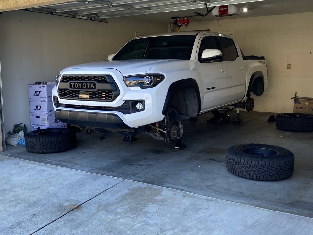

    Tire rotation and then meso ultimate turn signal install.

    You could move the ECT button as noted a few pages back. Then the mirror light switch could go there.
