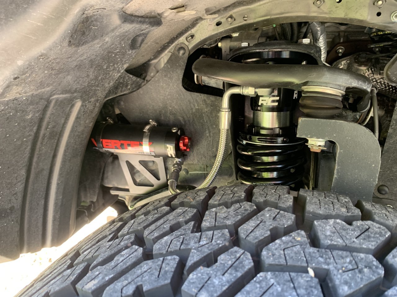

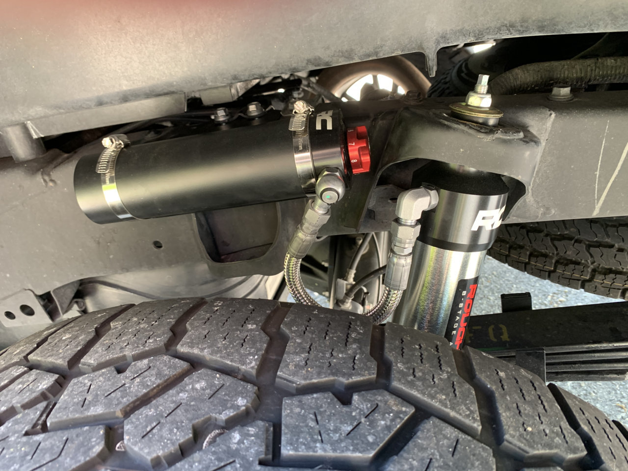

    Upgraded the spacer lift and basic rear shocks this weekend. What a difference on road so far. Can’t wait to get on some trails and dial in the performance!

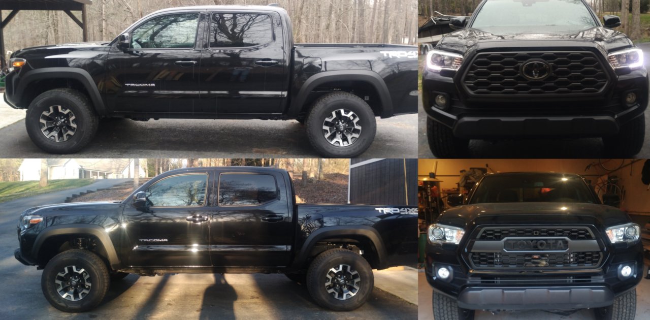

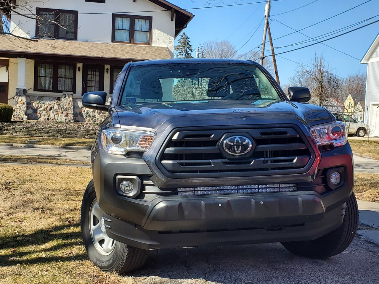

    Had kinda busy morning got my fogs and bumper bar installed
    Before:
    After:

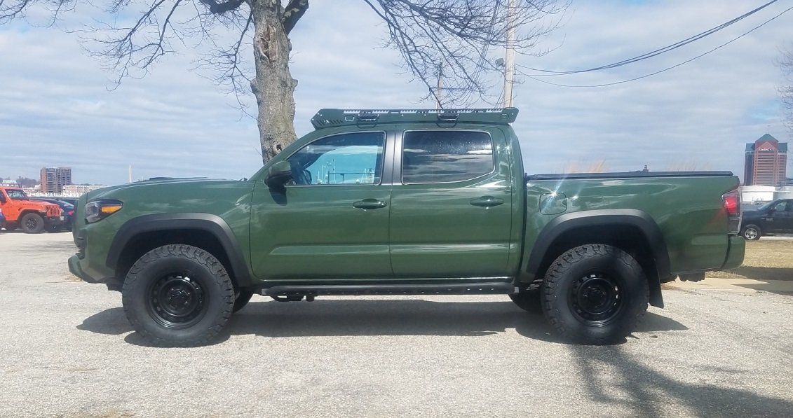

    Nice steelies :cool:

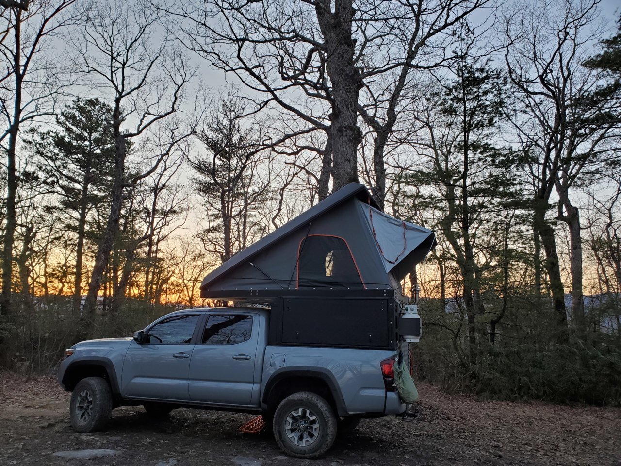

    My wife wanted it lol couldn't talk her out of it

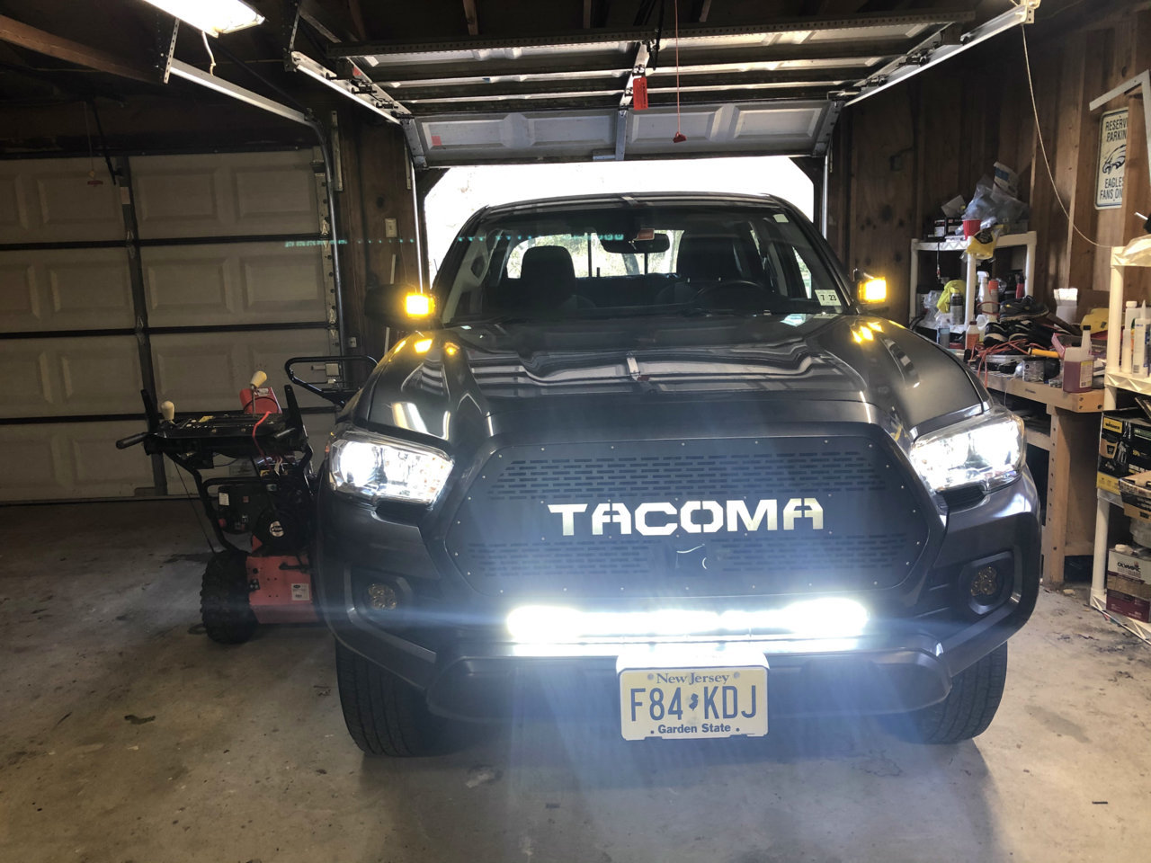

    Installed Seven Sparta Raptor marker lights from Amazon ($27). They solidly click in from the front and I zip-tie-ran it to the fuse box as it comes with an add-a-fuse. I tried some of the unused fuse holes but they all kept the lights on even when the truck was off so I ended up plugging it into the 10A INJ slot and adding its fuse to the add-a-fuse contraption.

    But I hope you got a carbon monoxide detector in there!?

    I was curious about the combustion too, it uses a direct vent like a some tankless water heaters or a toyo stove. Pretty cool design that's very safe, a CO detector would still be a good idea though.
