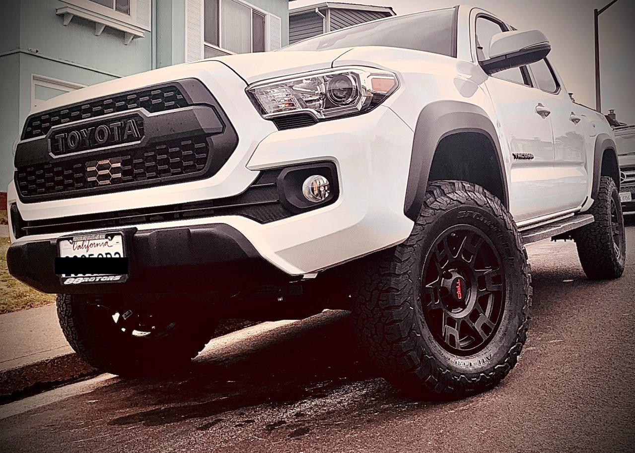

    And so it begins.....
    17x7 TRD Rims
    265/70/17 KO2
    Stock Suspension with 2” spacer and rear lift blocks.

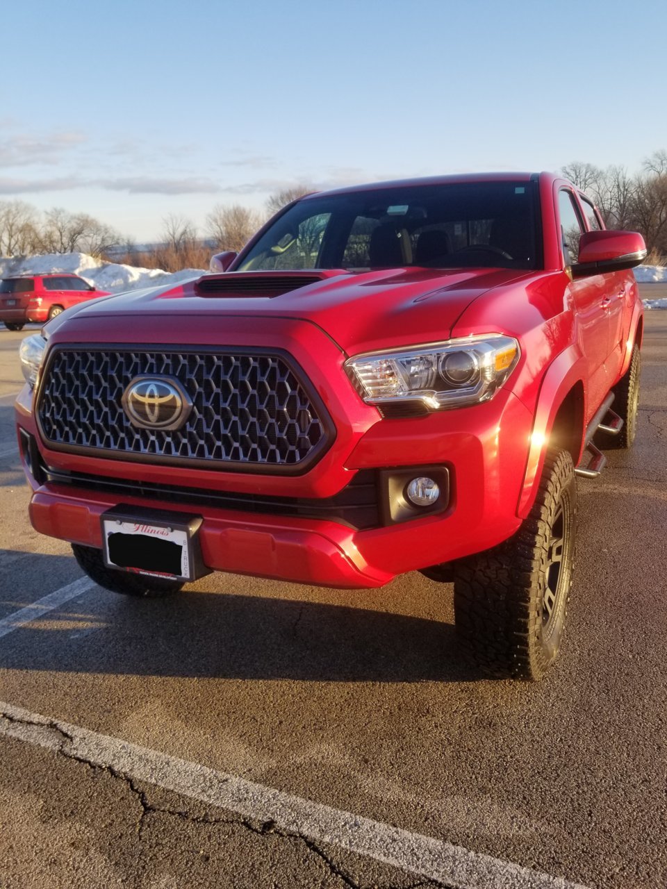

    Looks good man. I've got a pretty similar setup myself.:cheers:

    Is that 2” spacer up front or 2” lift up front? I read somewhere that a 1” spacer will give 2” lift on the front. What did the 2” spacer give you in the front? I may be mistaken on it. I’m just starting to did into the lift options. The truck looks great.

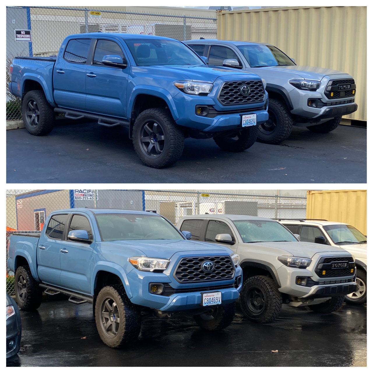

    Replaced the rear blocks with an Icon 3 leaf pack and removed the front lift spacers and adjusted the perch on the 5100’s. Went from a 3/2 lift to a 2.5/1.75. I removed the smallest leaf spring from the Icon pack and left the factory overload in. May end up putting the small leaf in. Before on top after on the bottom. New wheels get here Thursday:bananadance:

    It’s a 2” spacer for the front and 2” lift block for the rear. I wanted to keep the factory rake.

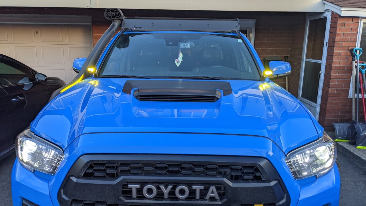

    CBI Ditch light brackets finally showed up today in the mail and it just so happened to be 12°c outside and sunny so I took the time to install my Baja Designs S2 Sport ditch lights. had to make some adjustments to the harness provided and ran along with the OE. Also got to wire my first thing to the aux fuse panel:cool:

    Sorry to keep asking dumb questions but how much did the 2” spacer lift the front? Your truck looks close to level in the pics. Also how does it ride? I have heard that a spacer lift will tend to make it ride a little stiffer than stock. I don’t go hard off-road like many of the guys on here but very mild trails or country roads.

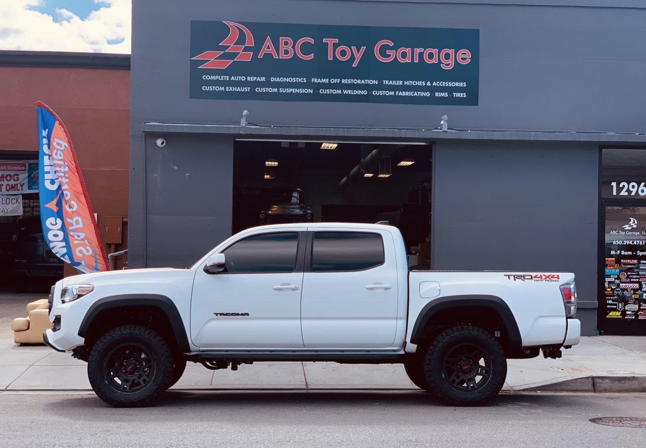

    Got the lift installed today. Fox 2.0 Performance Coilover Shocks. ~1.5 inches of lift in the front and 0 in rear.

    No worries, I’m new to this as well. It gave me a 2” in lift in the front. As for the ride, it rides a little stiffer than stock which I think is better.

    Where did you buy your coil overs?

    RimzOne. I went there in person and they ordered & installed them for me. Only $1600 for parts and labor which isn’t that bad
