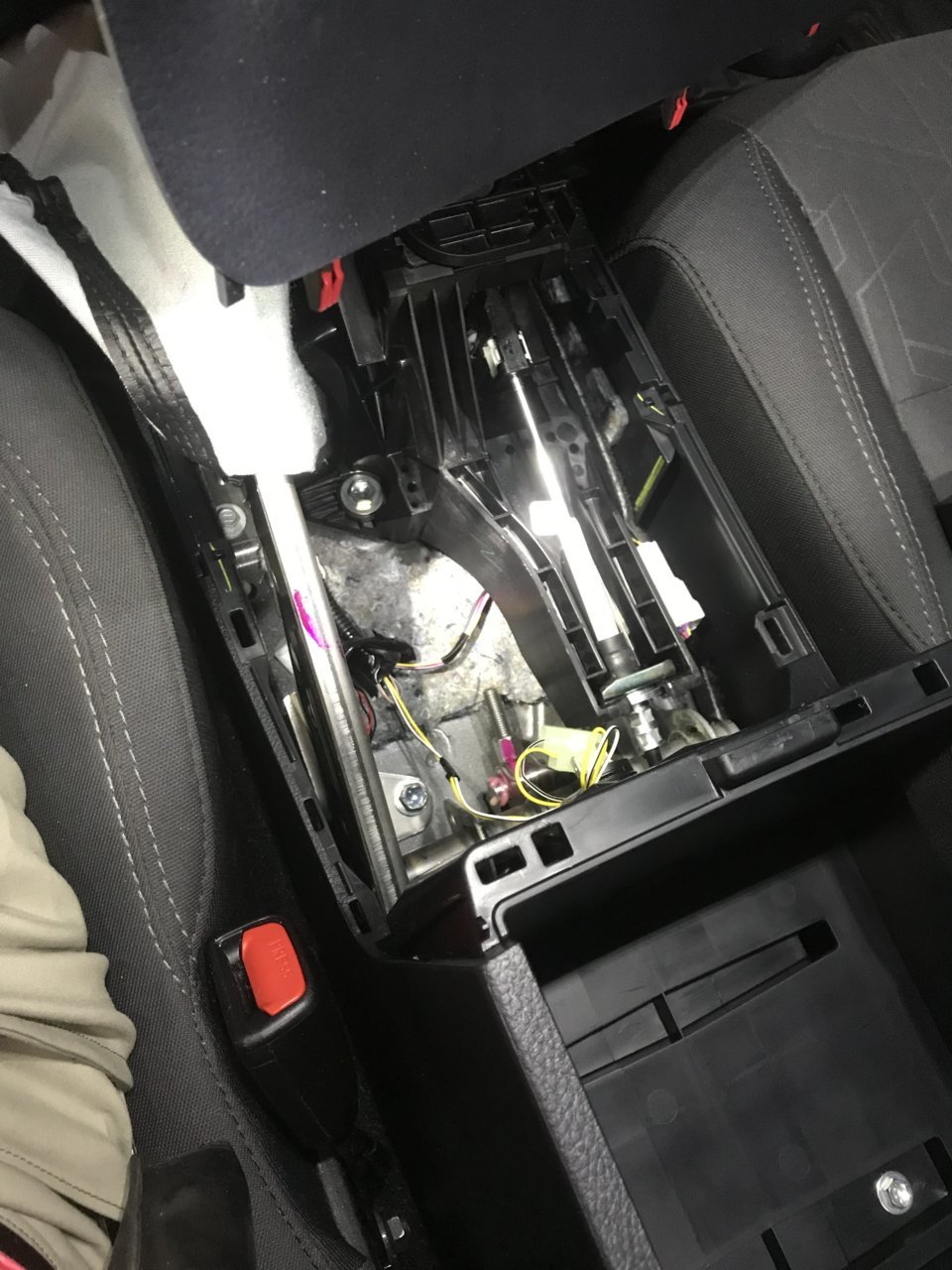

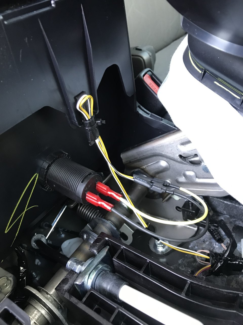

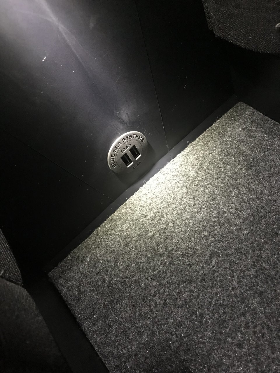

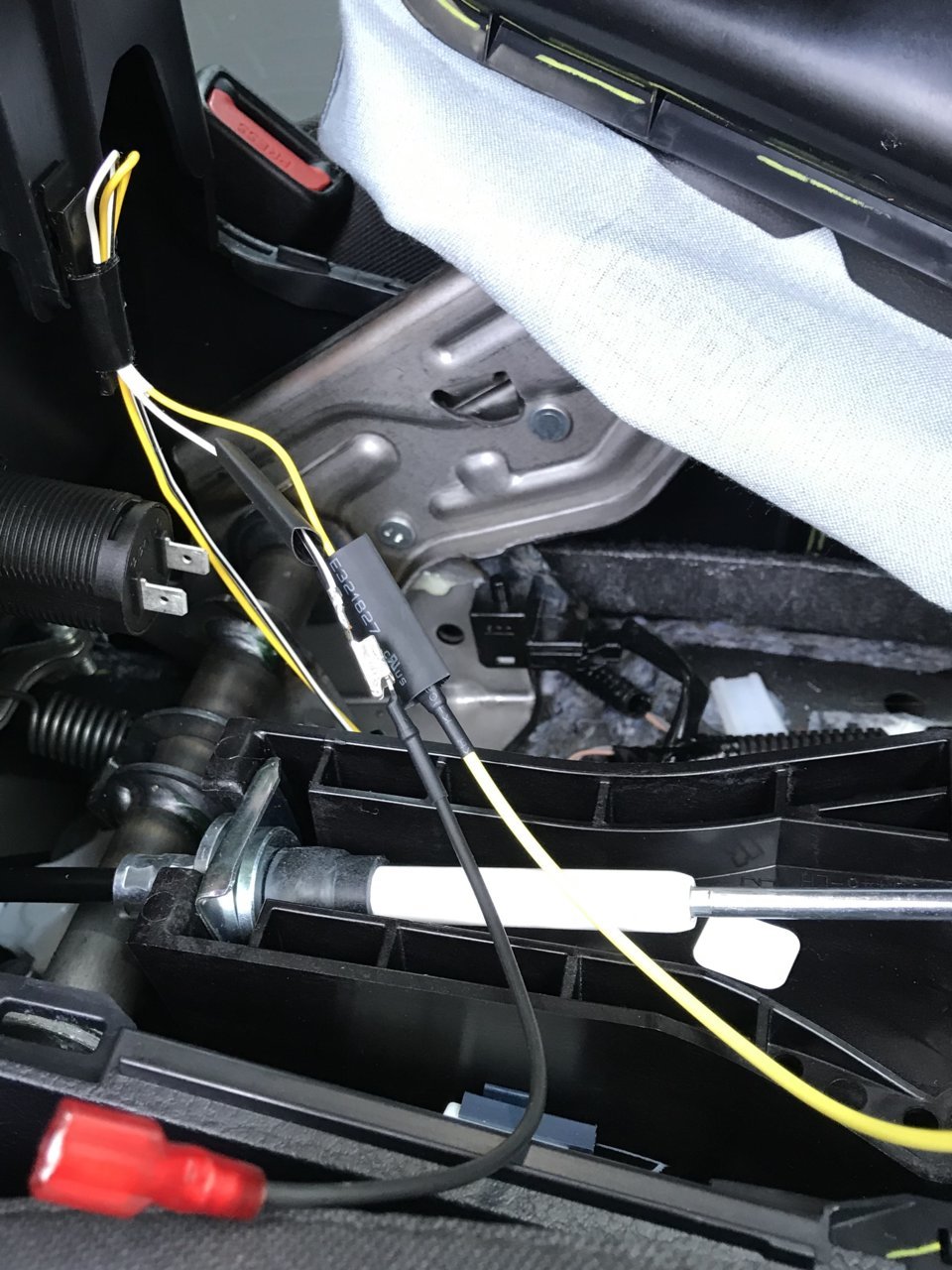

    Installed the rear USB ports this morning. Easy to do - pretty much followed @ClassyTacos install video. I went with placing the centered hold for the socket at 3.5" below the top of the rear trim piece and had plenty of clearance of the rear cup holders. It seems that the 202s/21s use 22 ga wires to power the USB ports in the center console. Luckily, the kit I bought had T-Taps and spades for use with 22 ga wire. Tapped the two wires, used a little electrical tape just to make sure they stay secure, tested to make sure I had power and then put everything back together.

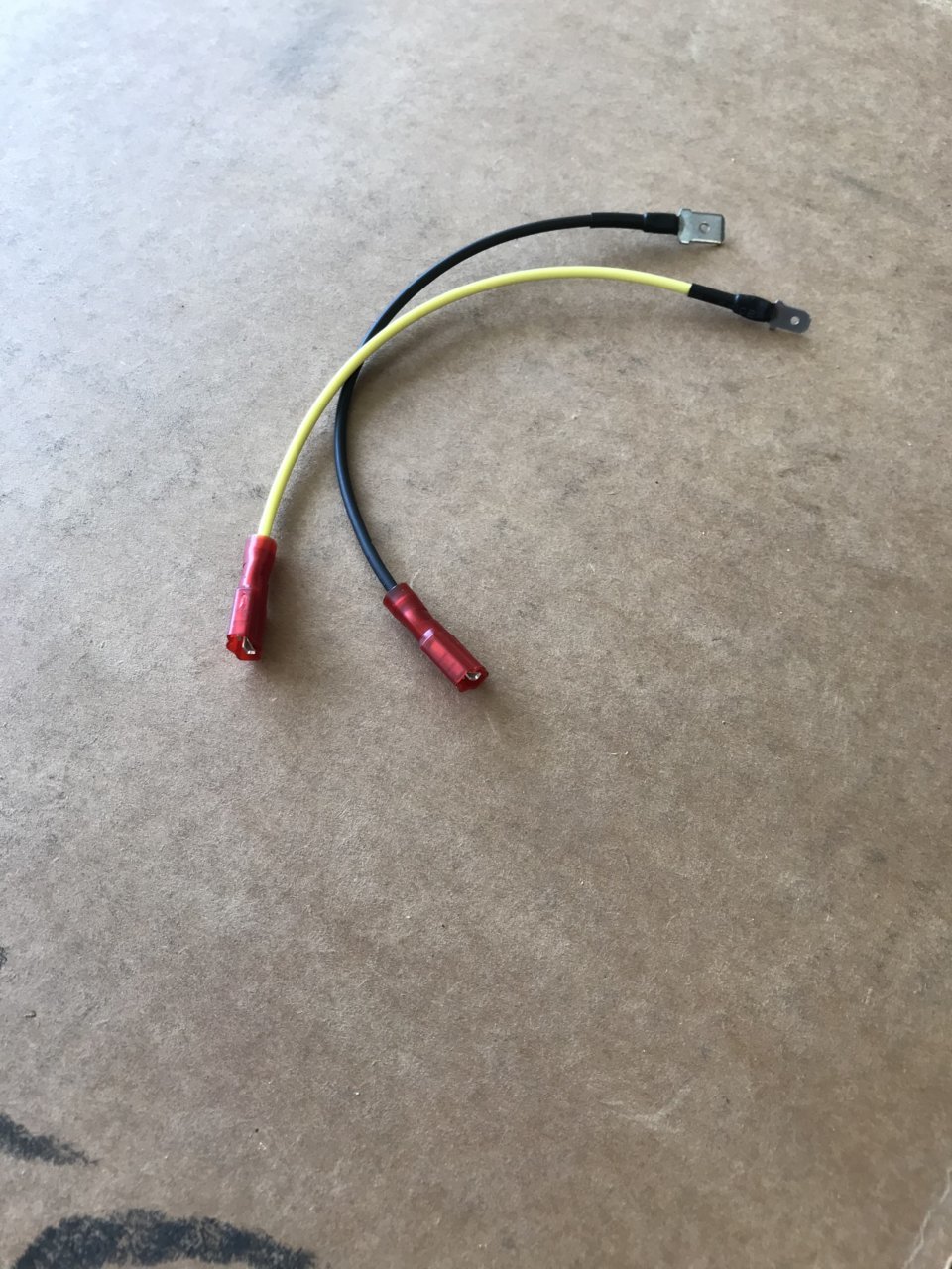

    Kind of hard to see but the connectors are definitely different on my 18 and it looks like the cig lighter is a different part (backside), your wires have sheathing too.
    I didn’t add a rear mounted usb but instead replaced the cig with the blue seas- depin the factory connector so my added wires with spades would fit (without tapping factory wire)
    I know why you guys added in the rear and this doesn’t change that but just showing the difference and also you could probably figure out how to not tap factory wires if you wanted by adding a jumper.

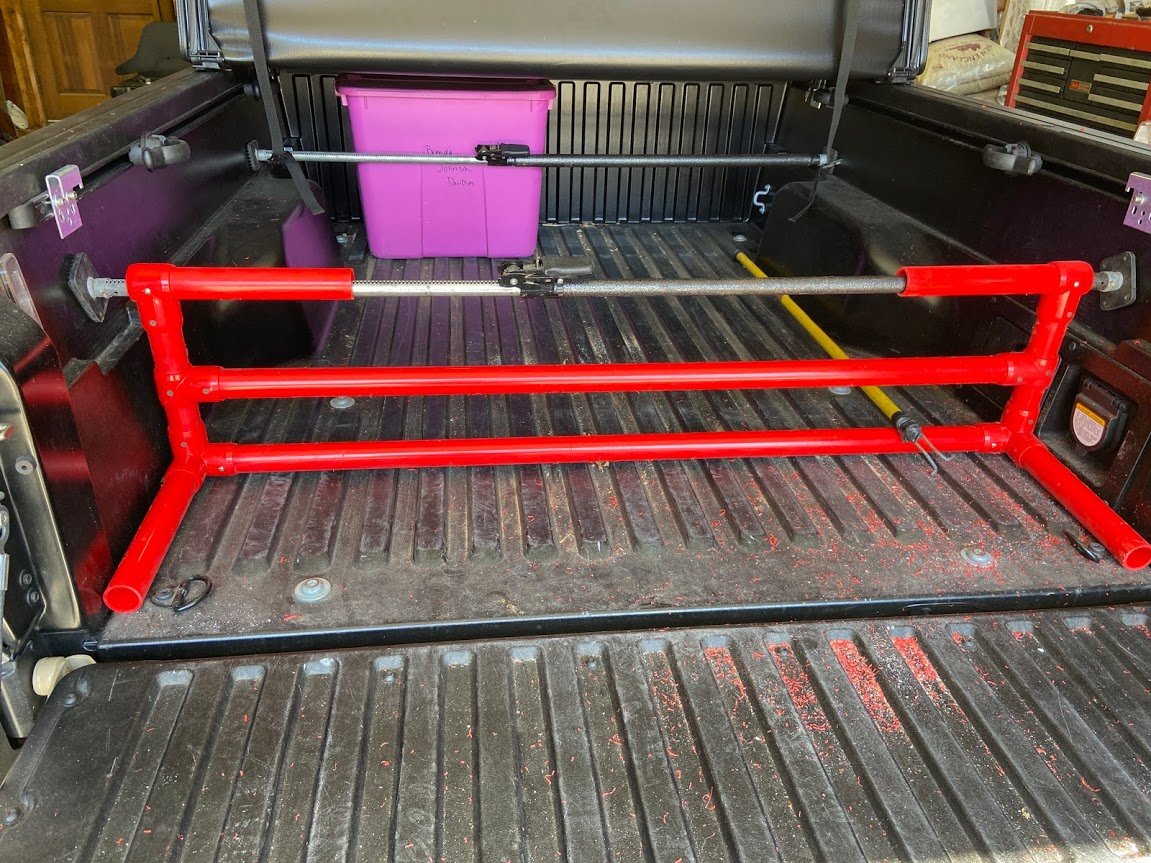

    My brother gave me a bunch of plastic pipe and fittings left from a job he did. I decided it would make a good project for the truck. Might modify it some after I use it a while. Still needs to be glued up. Here are the results:
