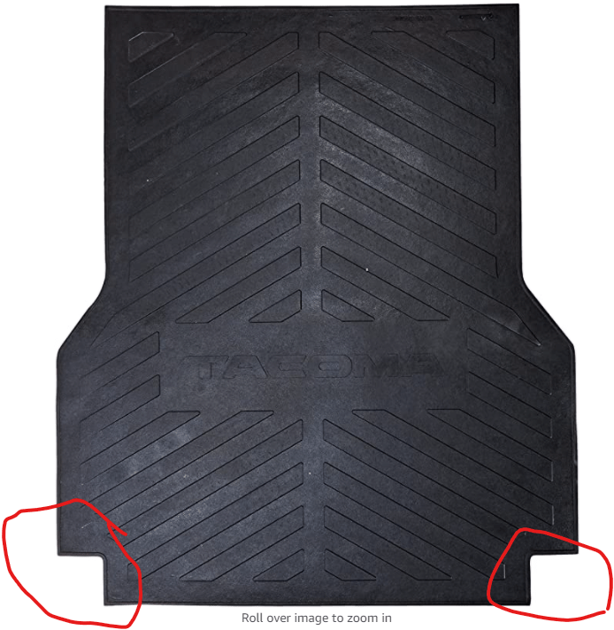

    It does. Those additional D-rings are mounted at the front of the bed in a longbed where the bedmat covers the existing T55 bed mounting bolts.

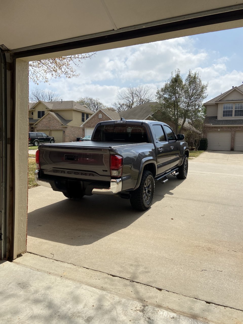

    Cleaned it up. Now I know it will rain.

    Take the bed bolts out (T55) - center the mat as best as you can and punch a [pilot] hole through where the bolt goes - I took the mat out of the truck and then used a 3” hole saw to make a nice cut - grind/file down the ridges around the top washer so it slides off [do not cut it off] - slide d-ring onto bolt then slide the washer back on - bolt back down to the bed.
    I don’t know the torque so I just tightened it down as much as I could, I’ll readjust later, maybe.

    The toqure spec for the bed bolts is 60ft/lbs FYI.

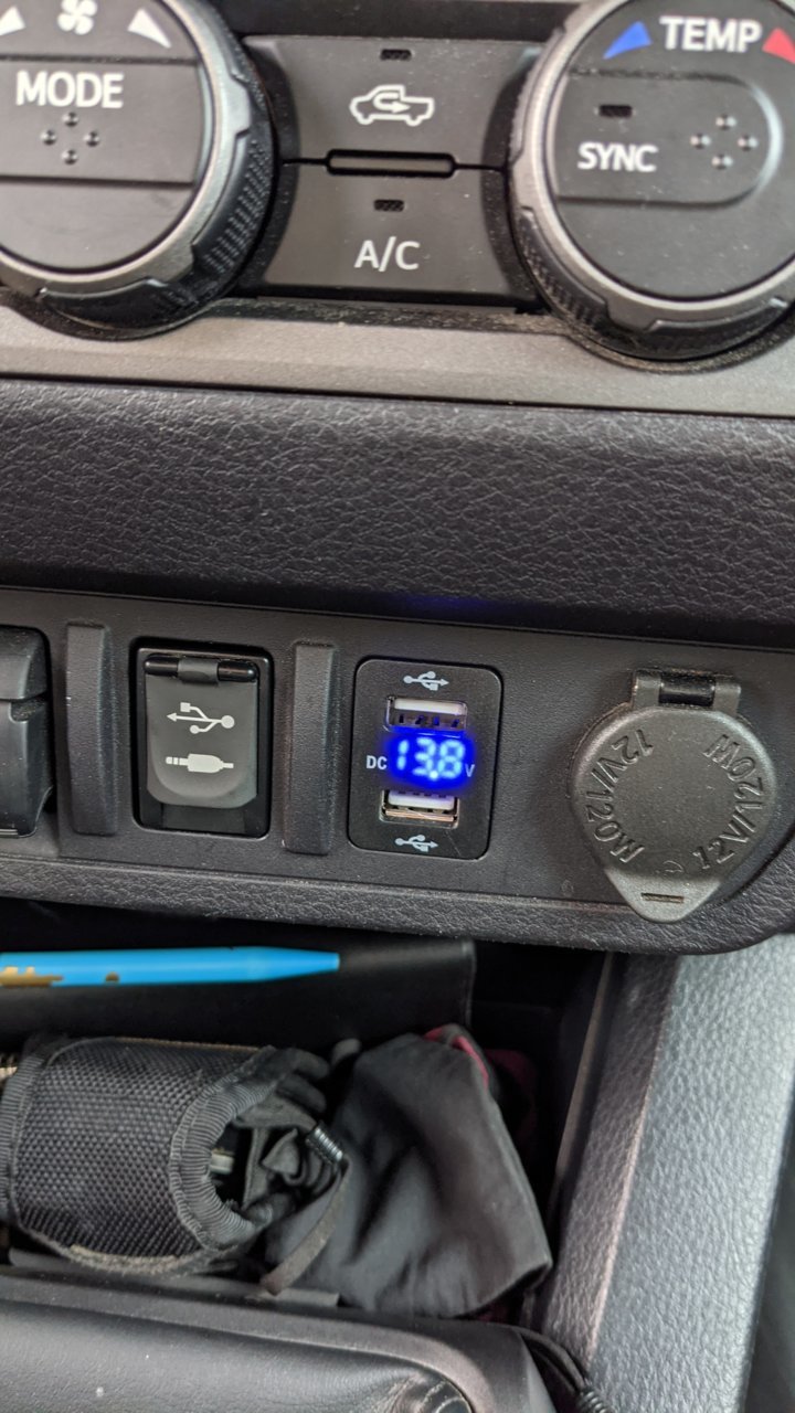

    Got around to installing USB charging that is easily accessible as opposed to the inside of the center console. Thinking back I should have swapped the data one with the one in the center console but to late now lol. fed it all through expandable loom as it just looks cleaner and zip ties it all to the OE wiring. PXL_20210326_215638857.jpg PXL_20210326_220720875.jpg
    Kind of stupid the display is frosted instead of clear but atleast it gives an accurate reading.

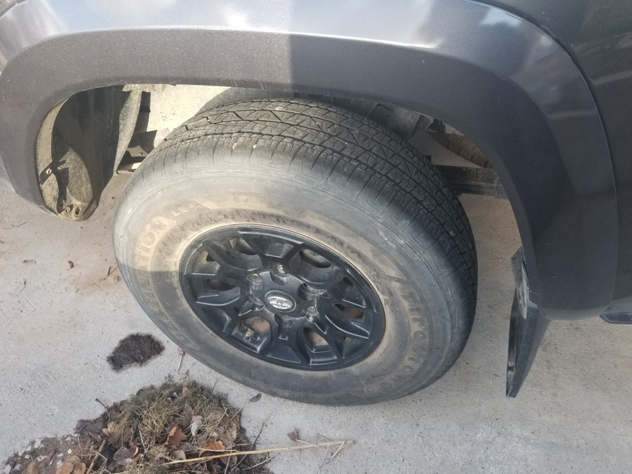

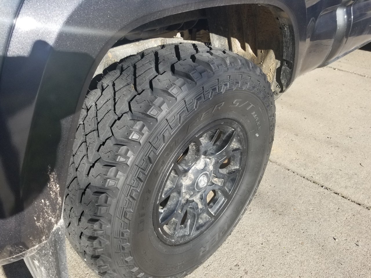

    We joined the world of Cooper Discoverer ST MAXX. Should be a nice upgrade from stock sr5 tires. 20210326_183148.jpg 20210327_093109.jpg

    Very nice! I did mine about two months ago and have been very pleased so far. Great inexpensive mod in my opinion

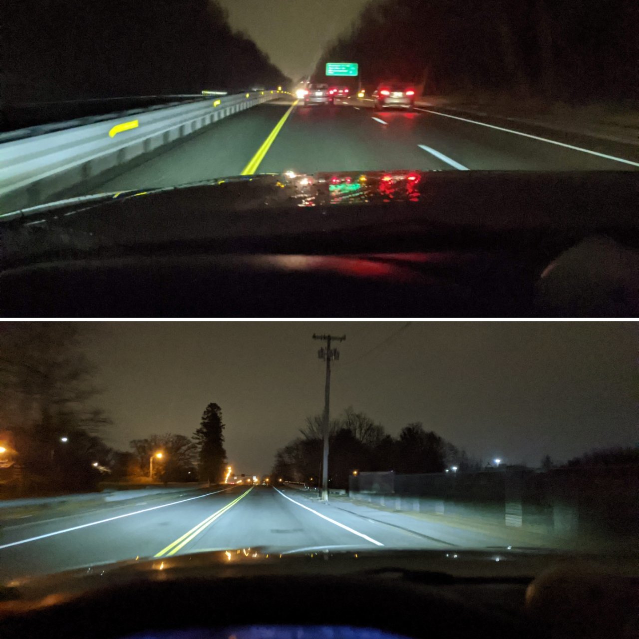

    Thank You!!!! I never understood why Toyota couldn't pony up for better factory lights considering the price of these trucks.
