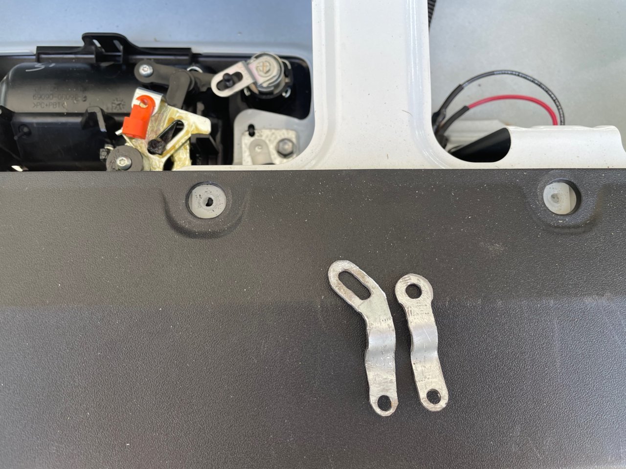

    I was able to rework the arm on the automatic tailgate lock mod that I did this weekend. It now allows the lock to fully lock/unlock.
    Here's the side-by-side comparison of the arms that come from the actuator and attaches to the locking mechanism. New on left, old on right.
    Functionality:
    Unfortunately the new design wouldn't fit under the metal part of the mechanism (which was holding it in place). The OEM auto lock uses a locking washer, so I used a washer and added an internal locking washer that I already had (used a dremel to fit).
    Final Product:
