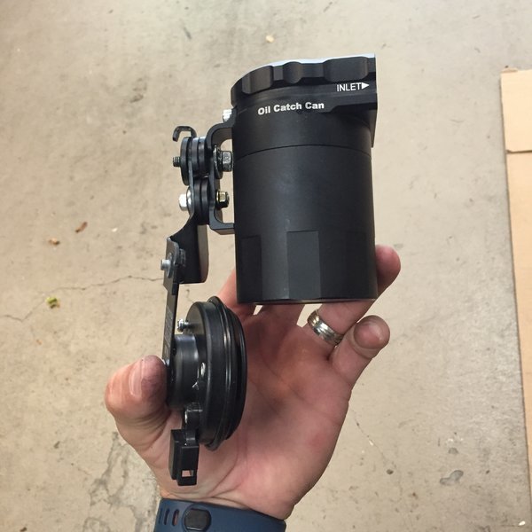

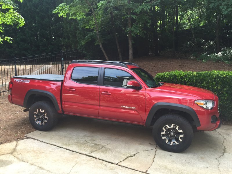

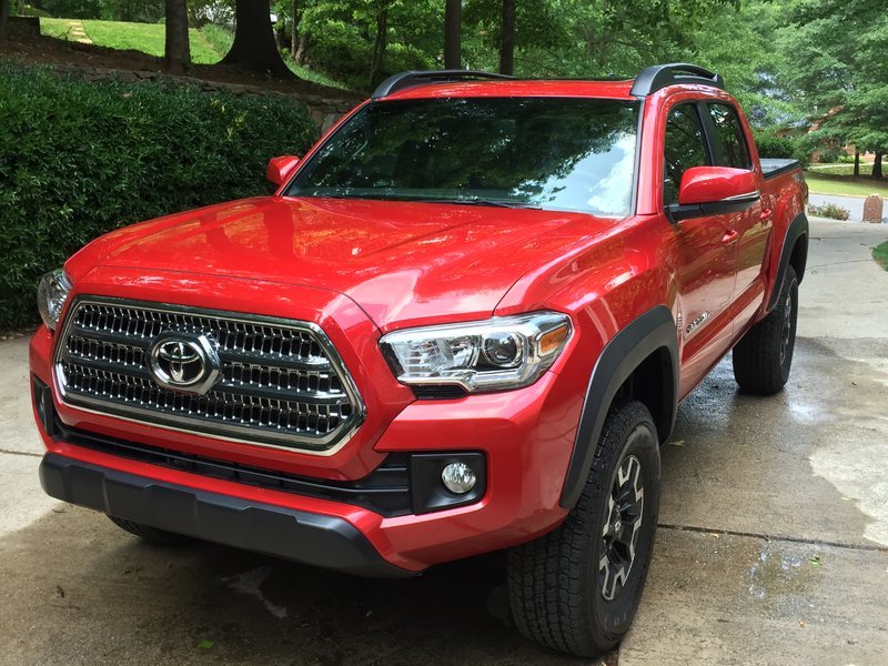

    It has been around a couple of weeks. 1500 miles and 19.7-21.5 mpg on all tanks. Both ATL city bumper to bumper and all highway tanks. About 3-4mpg better than my 14 6spd with same options unless all highway, then about 1-2 mpg better.

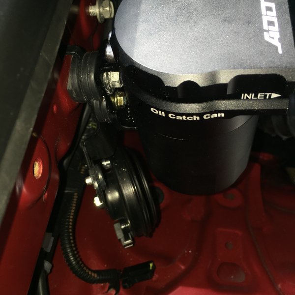

    Simply had Husky Xact Contours and a bed mat until I installed the ADD W1 oil catch can today. Door sill protectors, bed extender and the despised front air deflector have yet to be installed. Zero plans to lift it or replace tires until they're worn.

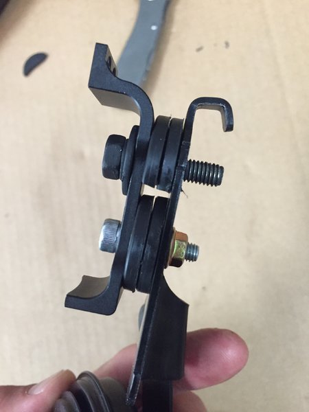

    Take the siren bracket in the left engine bay out and drill a second hole, replace the 10mm with a longer one and use some washers so the catch-can is serviceable without removal. That's about it. I used about 8 1/2 ft of 5/16 fuel line.

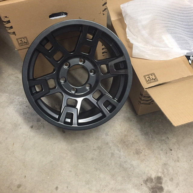

    FN f(x) Pros in dark gloss gunmetal came today. Going Saturday to have BFG 265/70/17 KO2s put on them. They really match the MGM and go from black to mgm in different light and angles.

    Looking forward to seeing these on your truck! I was looking at the black ones but if these look sweet it might sway my decision :cool:
