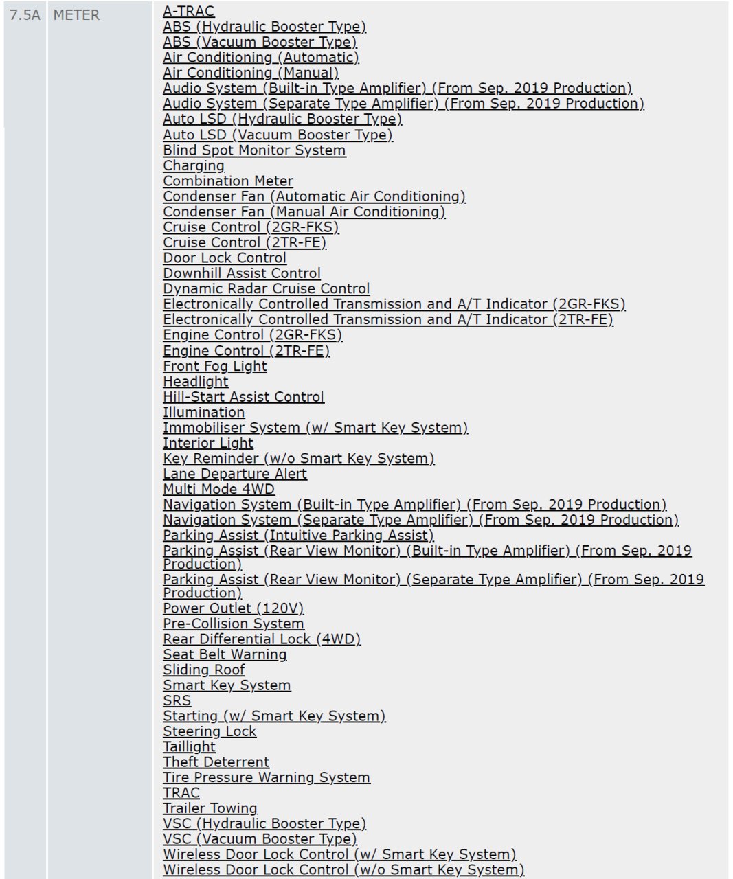

    I’d guess the dash is “METER”

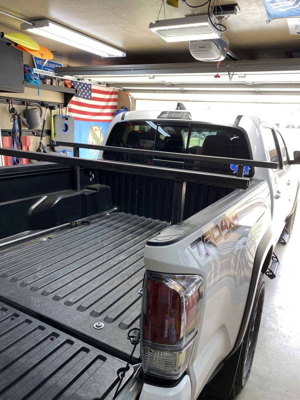

    I’ve started the construction of a kayak rack.

    Meter is Combination meter juice. gas, temp, rpm, etc.
