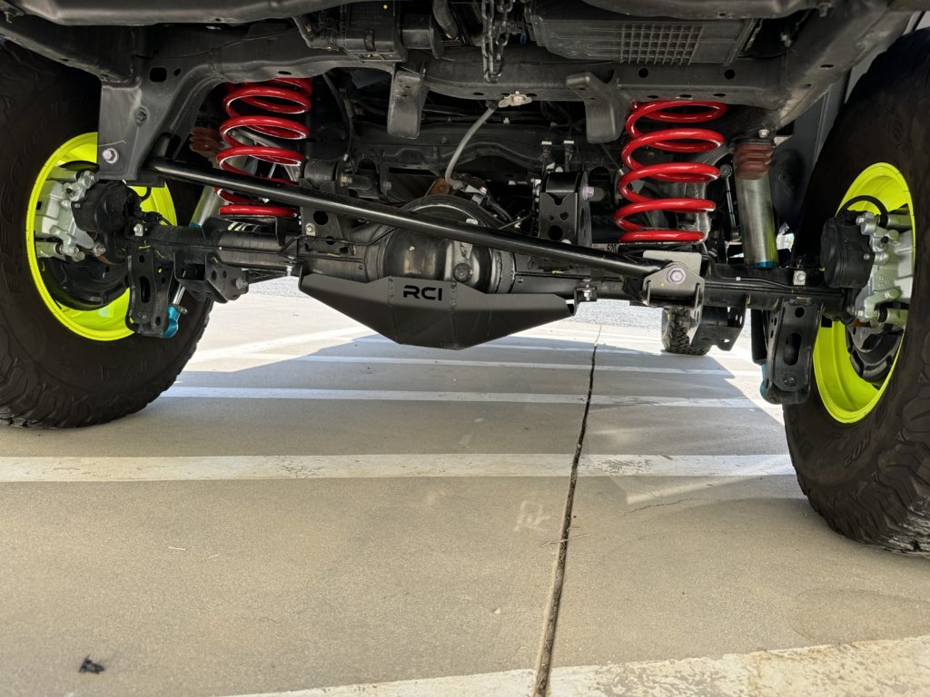

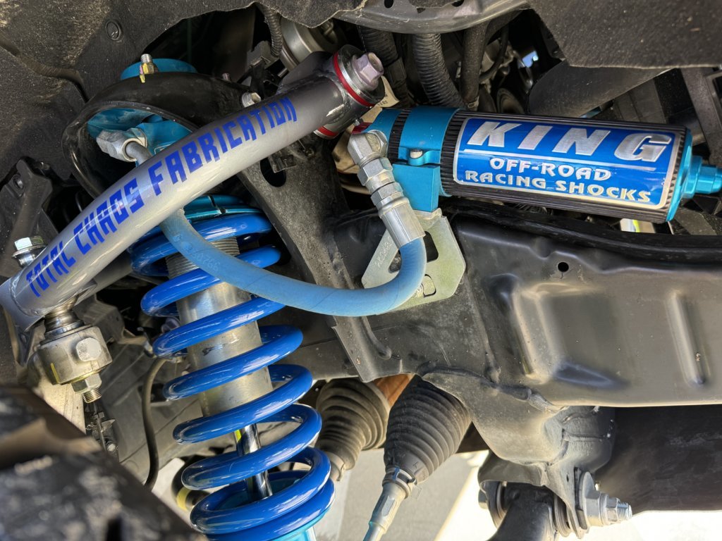

    Added some Total Chaos Upper control arms and some C59-819V springs in red.

    @Catfish21 You're gonna want the ChaosFab adjustable panhard bar, too, else your rear axle is no longer centered due to the lift.

    I would have done teal springs to match the kings. :wink:
    edit: maybe send them to powder coat to match the wheels. :notsure:

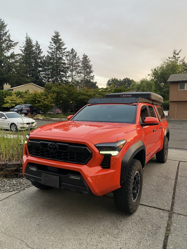

    Added the Prinsu Pro Top Rack and the regular Prinsu cab rack. Pretty pumped with the set up! The regular prinsu cab rack ended up being $350 cheaper than the Pro and made it much easier mounting to the roof with my tent and top rack already installed since it utilizes different feet. Highly recommend saving that dough!

    Holy lot of colors going on Batman.

    It’s broken up by the front and back

    From the looks of your panhard rod it looks like you got a ton of lift from the 819V's. I installed the 819V on mine and got no lift with the weight I carry. I upped to 821V+1/2" spacer, and my panhard is only slightly elevated.
    Here is another solution to the panhard rod. Instead of getting the adjustable from somebody, you can get a correction bracket. This is the direction I will go to flatten out the rod.
    https://drkdss.com/products/b-o-t-c-k-bolt-on-trackbar-correction-kit-gen3-tundra-copy

    Already got it coming.

    Thanks for sharing that, bookmarked it. Heck of a lot more affordable than replacing the panhard rod.
