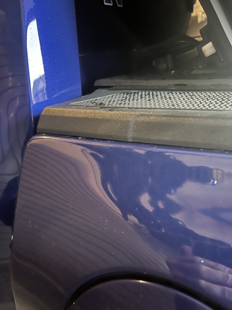

    Mine is doing it too. I had my bed cover installed the day I bought the truck. I've tried more two sided tape, with 25 pound weights and gorilla glue with weights to hold it in place. It's still pulling up. The truck is less than 3 weeks from purchasing.

    When I took mine to Toyota they told me it was installed wrong. Company that installed it came up with putting rubber wedges on inside of the caps. The cover was pushing down on the inside of the caps pulling up on the outside of them. The wedges give the inside support to keep that from happening. They documented the steps for further use. I’ll try to get that from them.

    Any time I cruise through my dealer all of the Tacoma's seem to have the caps lifting some are way worse then others

    Mine's only on the drivers side. I'm questioning if it's the backflip cover or just crappy two sided tape from Toyota. Or a combo of both. I may just put a big dab of some good silicone under the cap and weigh it down until it dries and call it good. I've had 50 pounds of dumbells siting on that side for over 24 hours now. Letting it sit under the sun a little more to see if it does anything.

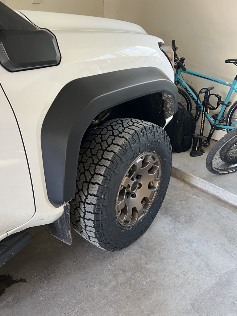

    Thick, juicy tires.

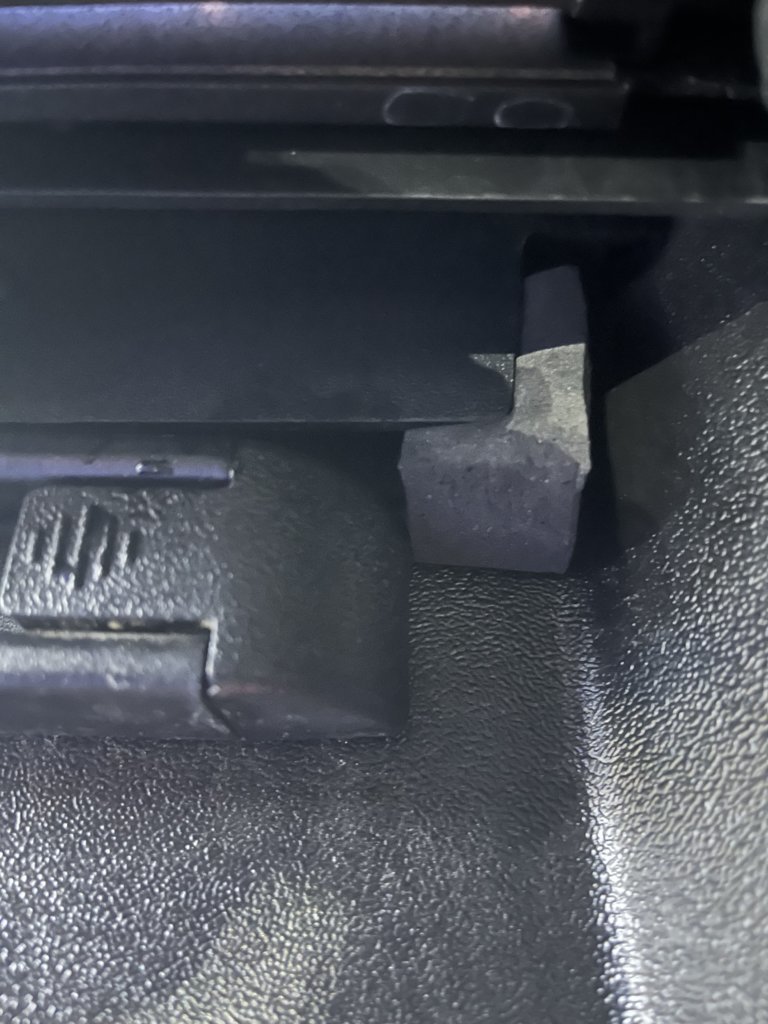

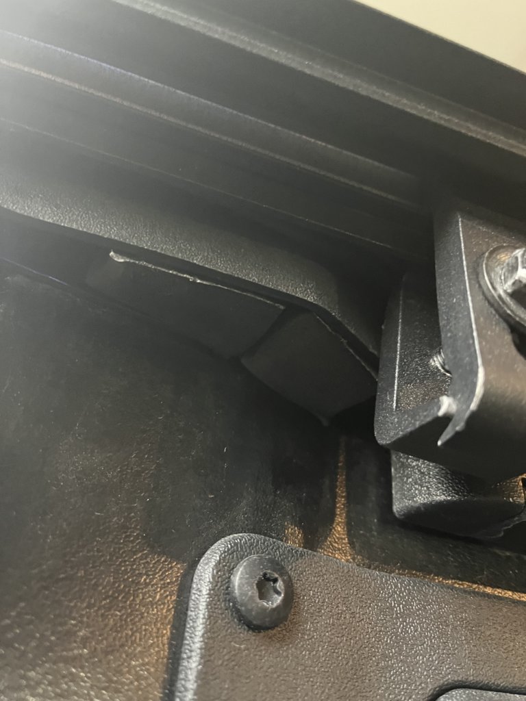

    I was able to take some pics of what they did to fix my bed caps
    You can see the firm foam blocks inserted on inside of the cap
    Before my caps were pulling up. Now:

    Are those glued? How are you going to remove the rail endcap and insert a t-nut if needed?

    What is this clamp holding? A bed cover?

    They are sticky on one side. Like double sided tape.

    Yes, a Bakflip.

    Thanks for the pics. Did they pull the cover off, install those and reinstall the cover? or did they just loosen it and stick those in from underneath?

    They had the cover off, including the rails for the cover. Not sure if that was part of figuring out how to solve or necessary for installing the wedges.
