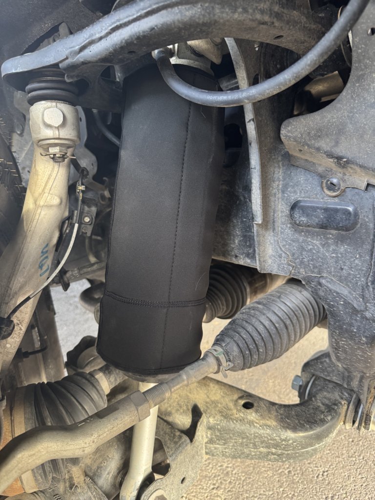

    SealSavers

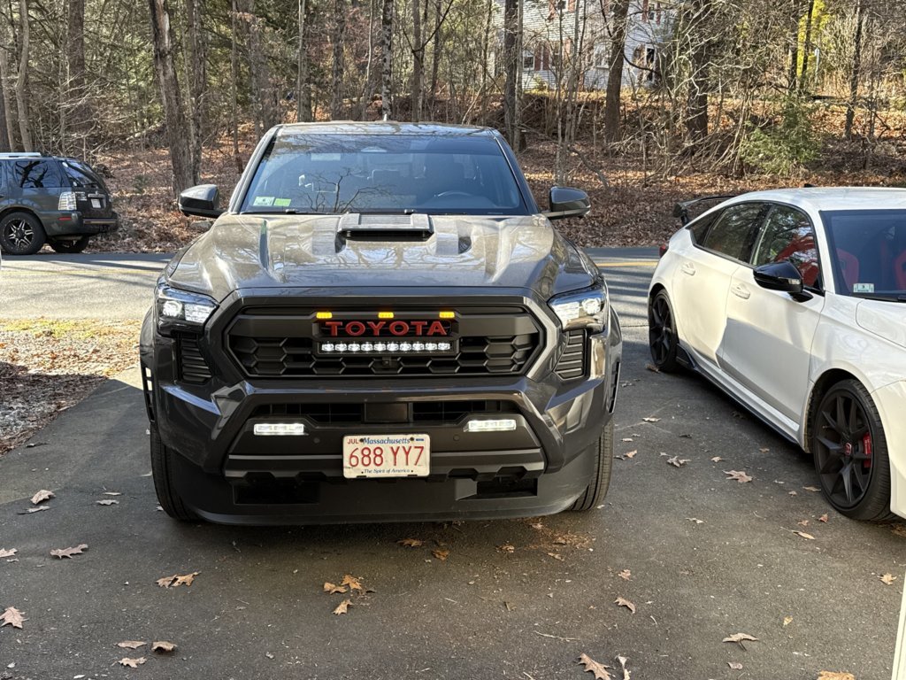

    Type R looks good

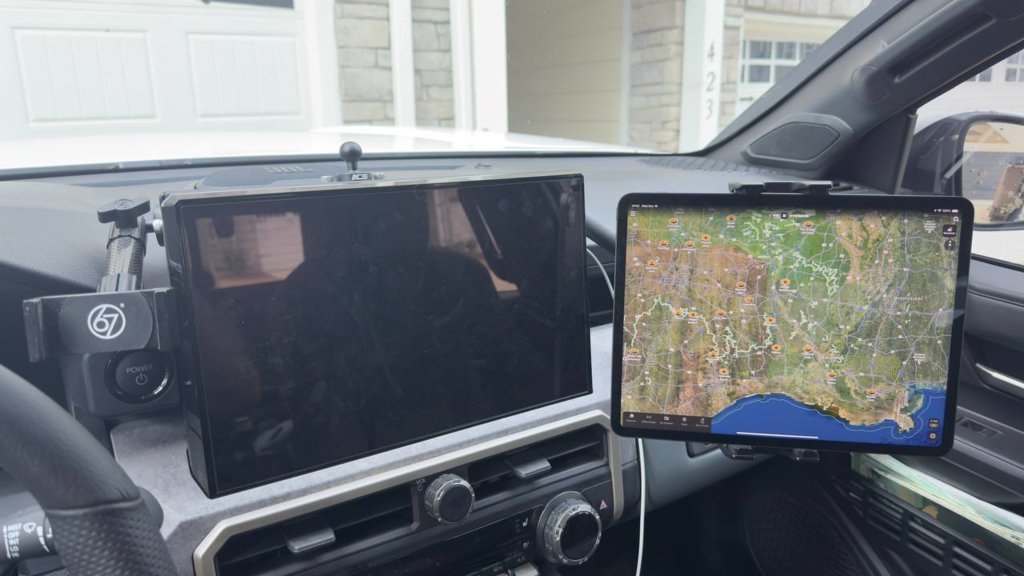

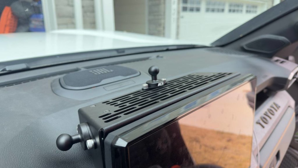

    Installed ics fab dash mount. Took them a month to get this to me...

    Glad it got to you. I have seen some upset Facebook posts about slow shipping and no communication

    yeah man and thanks, i posted that it took 30 days, some people posted that they are waiting over 36 days :/

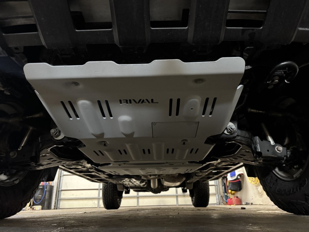

    Rival 4x4 skids stamped 6mm aluminum.

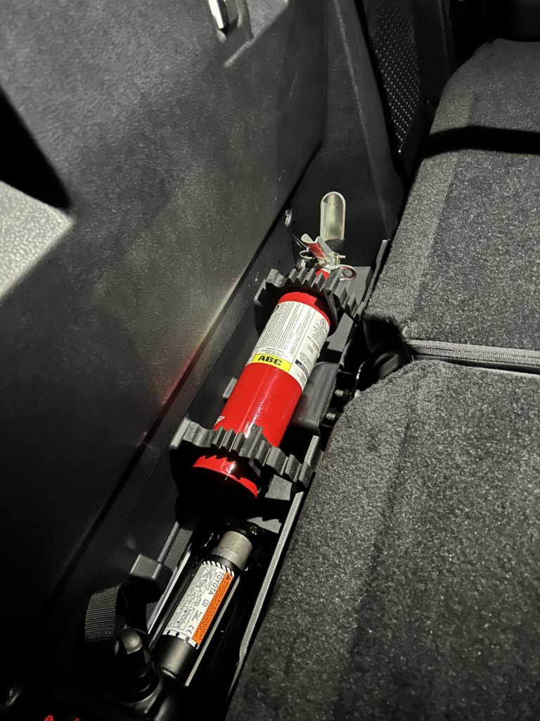

    please provide details! what extinguisher/mount?

    Go smaller and easier:
    https://elementfire.com/
    Many mount options, too.

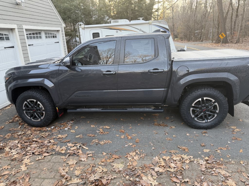

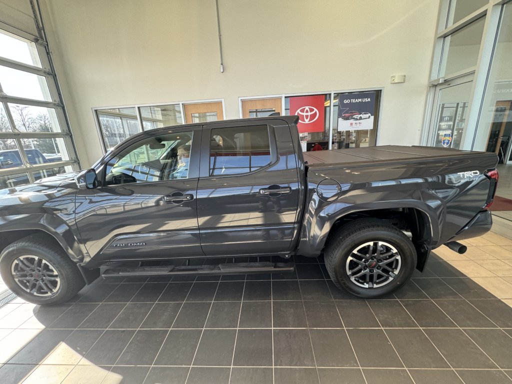

    New wheels and tires. Falken Rubitreks on Black Rhino (Bahari is the name of the wheel model I think). I also added a cheap Amazon soft bed cover and some also cheap Amazon side steps. The steps are actually really nice and look good for what they are. I’ll find a link if anyone cares.

    Extinguisher is am Amerex ABC 2.5lb.
    Mounts/straps are QuickFIST (large size), easy to find on Amazon.
    The QuickFISTs needed a bit of trimming of length (they allow for 2.5” to 8.5” diameter; just cut the long end off). To install, first remove the wrench roll strap (undo the screw; store the wrench roll under the seat). Reuse the screw and hole for one QuickFIST. For the other QuickFIST I self-tapped into the back wall.

    What kind of sliders?
