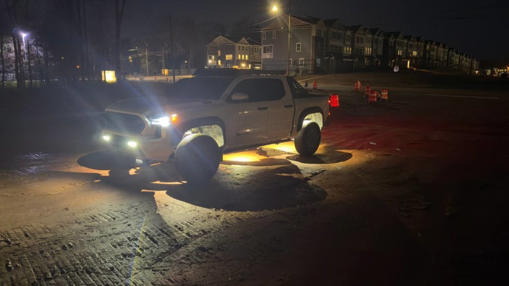

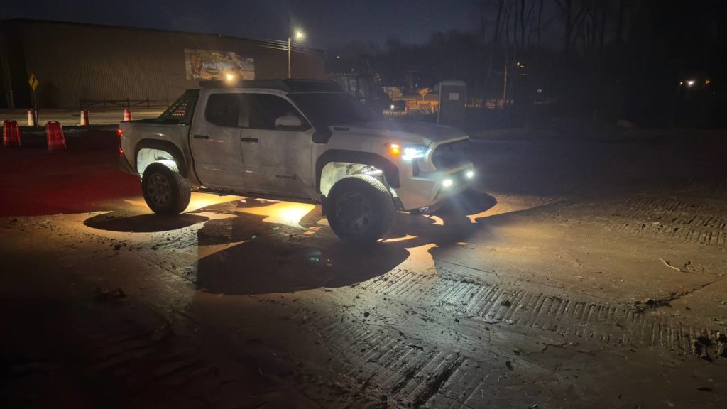

    installed 6 Baja designs rock lights. The front is that illuminated due trailhunter skids, but waiting for arb front bumper and hope to get some mount points :)

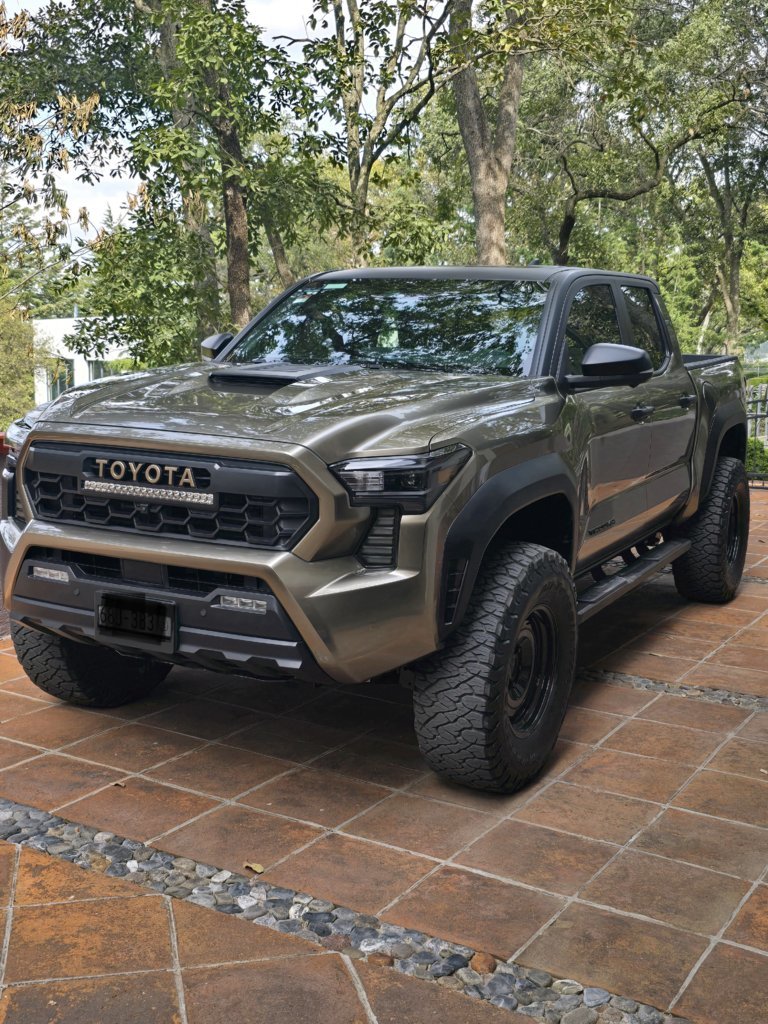

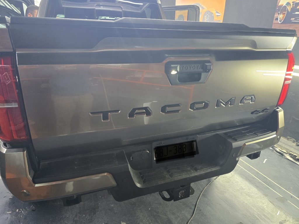

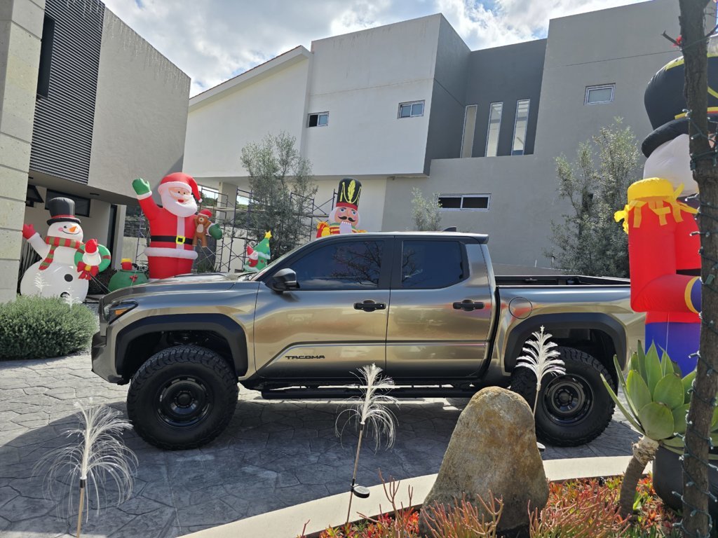

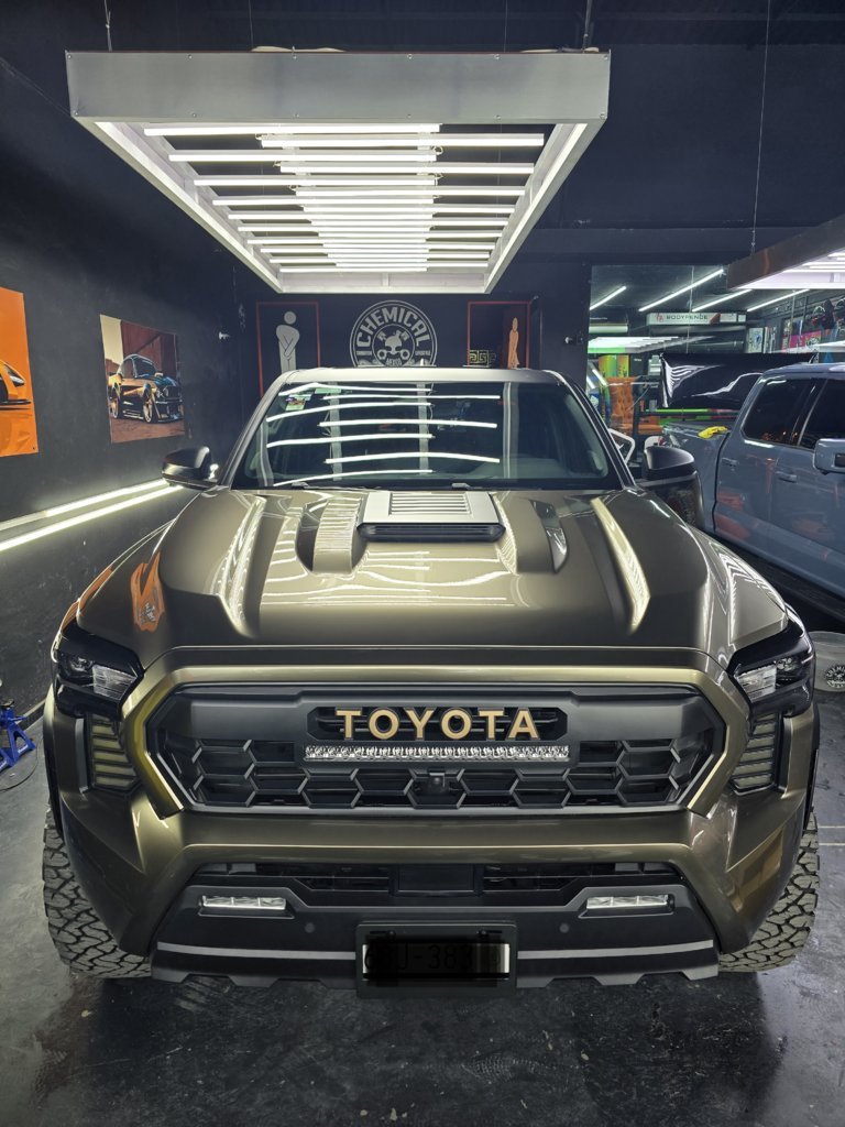

    Can't get the Trailhunter trim in Mexico so I decided to make my own, TRD sport hybrid, as close as possible.
    Mods so far:
    35" KO3's tires
    17" black rhinos wheels
    2.25" front lift, 1" rear lift
    Trailhunter skid plate
    NYTOP axle dump exhaust tip
    Bronze oxide PPF
    Trailhunter front grill with Heretic light bar
    Fang lights
    Thinking about upgrading stock suspension for next year.

    Would you please post a pic (in the dark) with the bed scene lights on as well? Are those the white only ones? If so, are they on maximum brightness in the pictures?
    Did you use the Aux switches and if so which one?
    Thanks.

    Ill try to find a darker place if i get a chance. Ill get the bed scene lights on as well. BD have quite few colors here is the link https://www.bajadesigns.com/products/led-rock-light-kit/?sku=447055&vid=171627. I purchased a kit and then additional 2 lights for undercarriage. They are maximum brightness. I used AUX3 since its 5A and 6x lights are 2.4A so well under :) so i guess you can add 12 lights in total haha :D

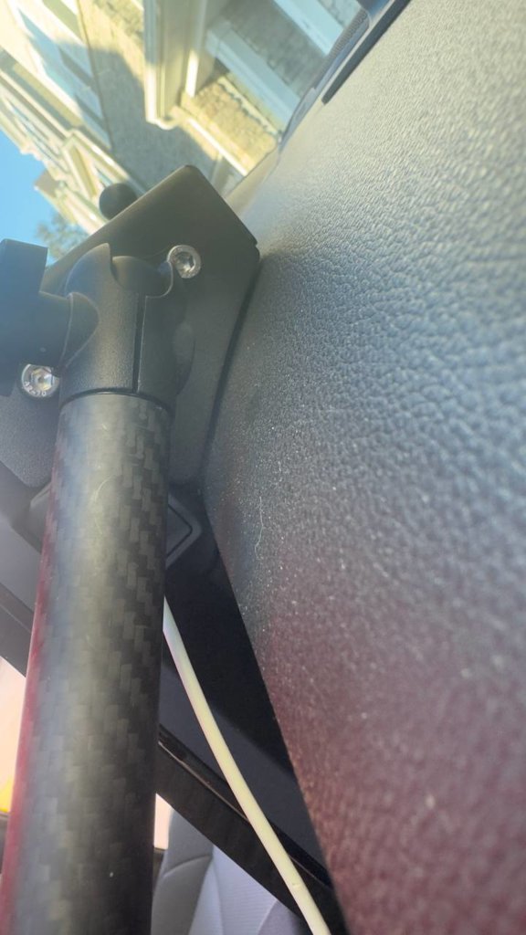

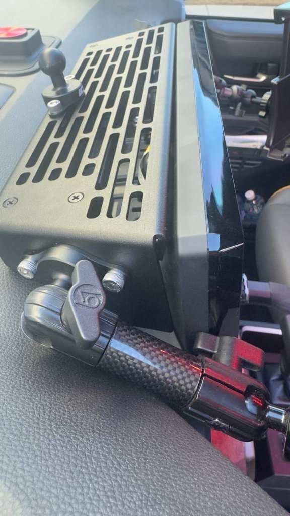

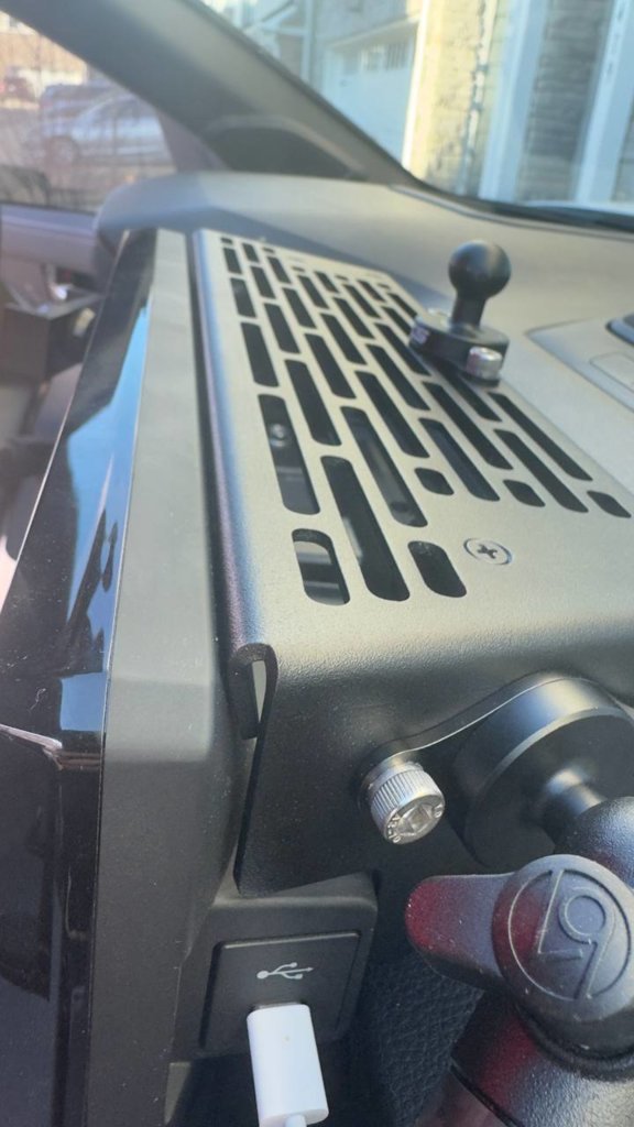

    @sogtr How do you like the setup so far? Any rattling? How is the build? Is the setup touching any interior plastic that can potentially scratch/marred up the interior plastic?

    Yes, the rgbw have considerably less lumen output than the white only. My early cataracts eyeballs are really interested in maximum lights.

    so far no issues and gaps are fine. If you worried though you can find some tape. It comes with 3 pieces. 2x legs which are getting mounted to 4x OEM bolts to the media console and a top mounting plate which secures with 4 small bolts. I havent got a chance to take this setup offroad yet though.

    What offset on those rims? Any rubbing/Trimming? What leveling kid did you use? Looks great.

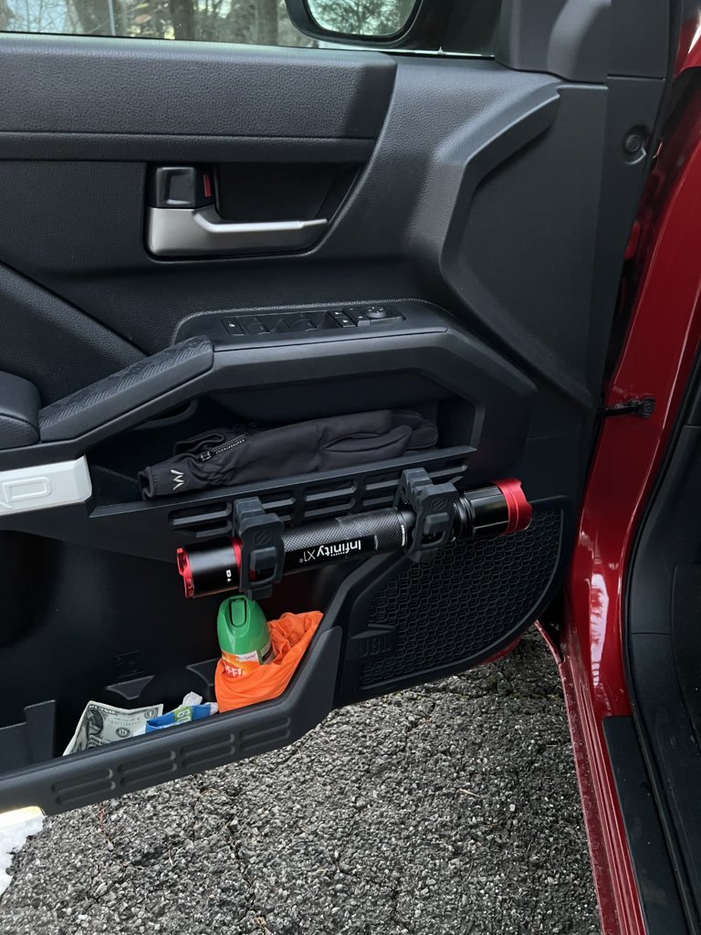

    Mounted a flashlight to the driver side door MOLLE panel. Plenty of room, does not interfere with anything, does not get near touching my leg when closed/driving. I'll probably never have need for this thing, its stupid how happy this makes me.
    Scosche PSMTGHD Off-Road TerraClamp (https://www.amazon.com/dp/B0DBBV83XV?ref=ppx_yo2ov_dt_b_fed_asin_title)
    Infinity X1 5000L Dual Power Focusing Flashlight (https://www.costco.com/infinity-x1-5000l-dual-power-focusing-flashlight.product.4000294999.html)

    Zero offset, I like the look of it, however it can get dirty.
    Minimal trimming at the front and had to remove the crash bars.
    I used Peak suspension lift kit.

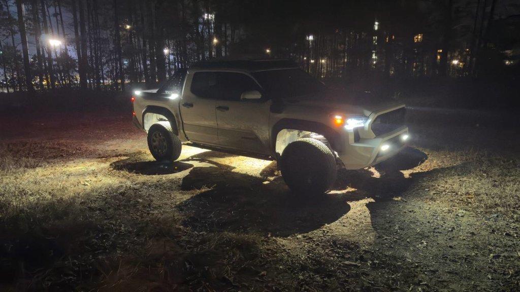

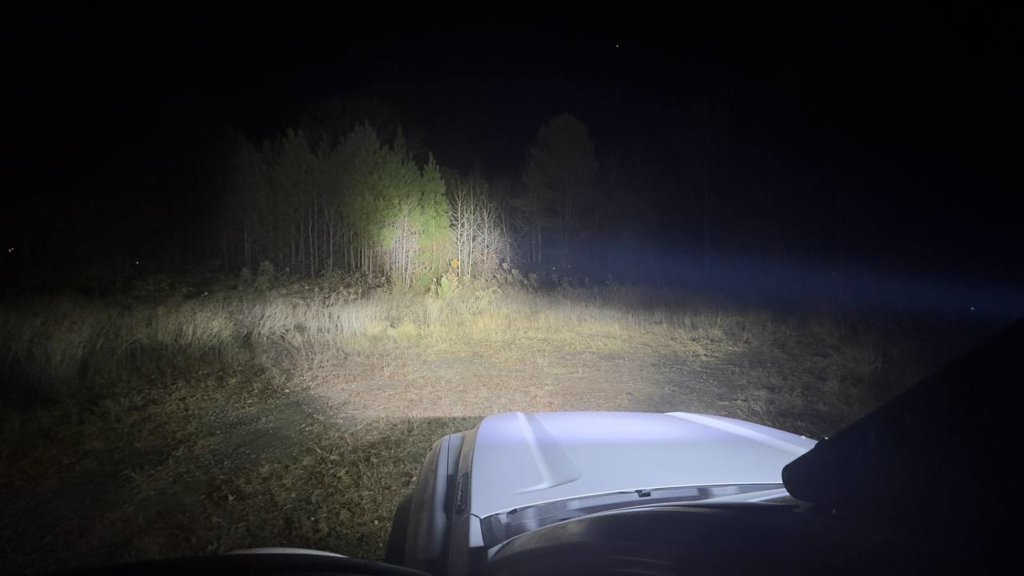

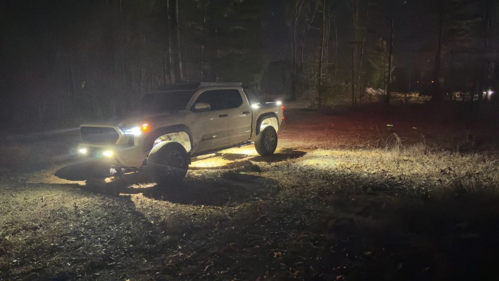

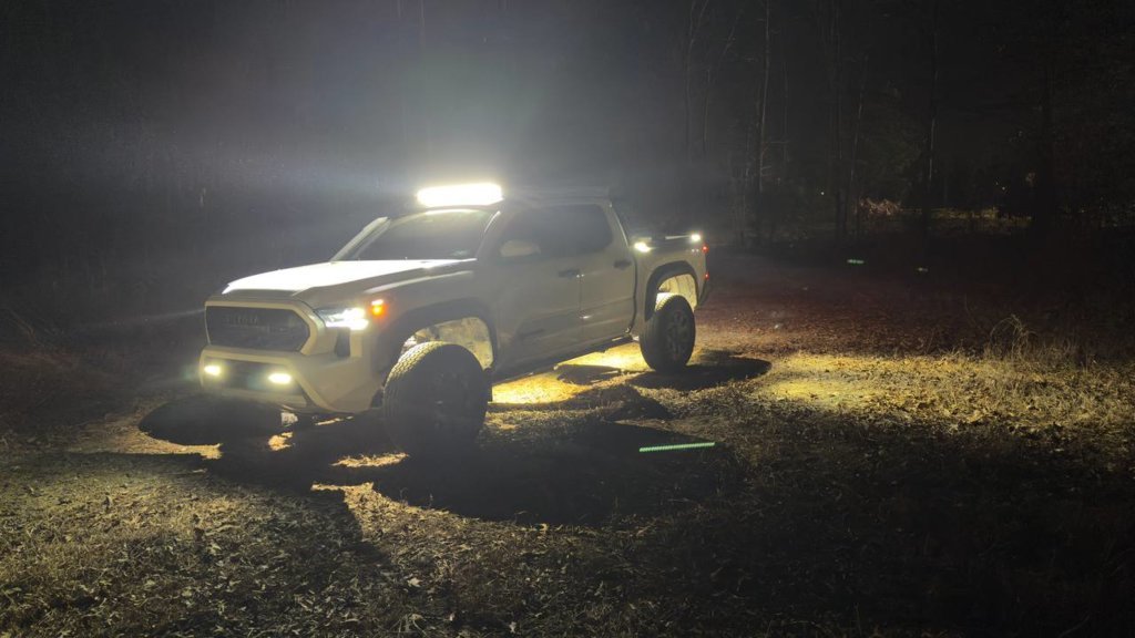

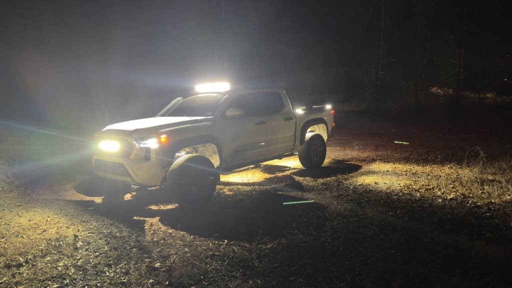

    Here, also adding my Rigid 40" led bar with fog lights and another one with rigid oem led bar :D

    Thanks! Those rock lights can help fill in the void.

    I need that for all of my neighbors that run auto high beams. Fight fire with fire!!! :D

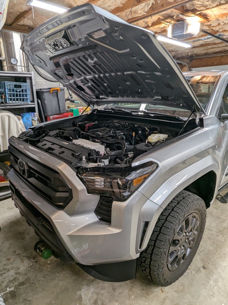

    DV8 OE Plus Side Steps MCX Skid Plate Bonobo Front Recovery Points Bonobo Hitch Recovery Point (2" Soft Shackle) Redline Hood Struts Volume Knob for 8" Infotainment Screen (TacoMods on Etsy)

    what brackets did you use to attach to the grille?

    I used custom drilled strong ties and #10 stainless 5/8” screws, and some of the screws that come with the lightbar. I might have an extra set of parts if you can’t find them.
