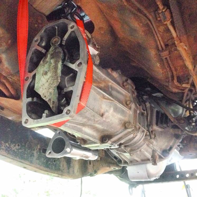

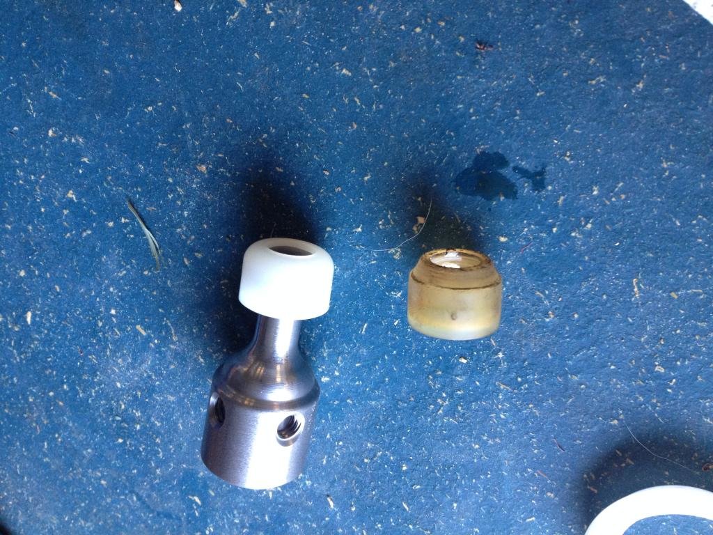

    68652116-E4F1-4E29-9AEE-1D2809586567_zps_f4baf2107c23501cdf96a2c0320e23bc8dd089b8.jpg
    5D94E155-0DB6-47DB-BF2B-6FF3F10C280D_zps_f673e6e33cfb733a779fd285452fe4d89b82dfa9.jpg
    You tell me:D
    Seats big time. 230,000 miles and there was barely anything left. After using the short shifter I highly recommend it (very fun and I can actually have a passenger in the middle without goosing them:rolleyes:), but I think just getting the LCE seats will help big time. I think the seats/sockets on Marlin are the same on LCE, but don't quote me....

    Both, more often than not I had to have the truck rolling a bit to even have a chance of getting it into gear (and it was grinding as it went in). Nothing now, goes right in.
    The front bolts on the top cover were a PITA to get out, mine sat just far enough forward that I could not get an u-joint extension in there. I ended up cutting the cab first just to make it easier (required for the short shift unless you drop your tranny).

    I should have got a pic of my shifter bushing in my '87. It was pretty worn, split and pushed up past the ball :eek:. I replaced it, the shifter seat, shifter boot, rear main seal, input seal, pilot and throw out bearings, flywheel, clutch, fork boot, slave cylinder, and installed my DT header with new studs.

    I just pulled out my shifters to check the seats and sockets before ordering new ones. The transmission shifter socket and seat actually look pretty good, but the t-case shifter seat is broken so that needs replacing for sure. I guess I'll replace them all at the same time? Haven't decided on that yet.
    I did find a lot of gunk inside...looks like old grease, but I'm not sure. It actually feels like hard rubber that's been broken up into bits, but I can't figure out where there might be a piece that disintegrated. The little rubber boots that cover just the top of the transmission and tcase are coming apart, but it looks like there's more material than what might be missing from those rubber boots. :notsure:
    For now I'm just gonna regrease or whatever (gonna look that up in the FSM) and put it all back together and then order stuff.

    Takes about 45minutes to get to that point, I've done it a few times to multiple trucks now. I'm making way for an upgrade in displacement, going to have a little more power than before.
    You should order the shifter seat and sockets for both the t-case shifter and the transmission. It will make a world of difference on a truck as old as yours. Get some shift handle boots while you're at it too. If you have trouble getting the shift handle boot on, just wrap the shifter in black Electrical tape then they should slide right on, same trick also works when changing out your CV boots. And the easiest way to change those parts is to pull your carpet out, you guys are nuts if you do it any other way. Unless you have like a 3" body lift then it might not be to bad.

    I just placed my order for the socket and seat for the transmission, the seat for the tcase, and the boots for both of them. The tcase definitely has to be replaced, so I might as well replace the others while I'm in there, even though they look okay.
    What do you mean with the electrical tape trick? Which part do you wrap, the top or the part that inserts into the transmission? I was trying to get the boots off so I could see what I was doing but the black part of the shifter was keeping it from sliding up. My shifters look basically the same as yours in your picture above, but with some slightly different bends just before inserting into the transmission. I tried twisting the black part to separate it from the rest of the shaft, but it wasn't budging. I don't know if they're welded on or what, but I just shoved everything up on the shaft and worked with that. Getting new ones on might be tricky, though...
