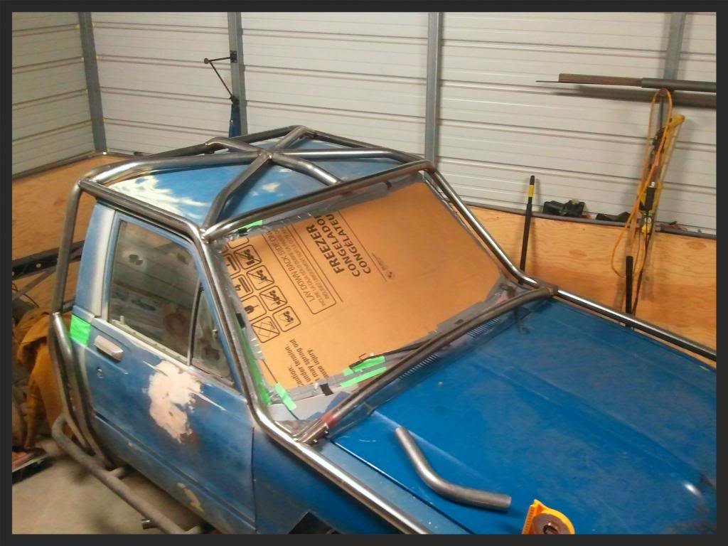

    2,372
    Dan
    Oregon
    Work in progress....
