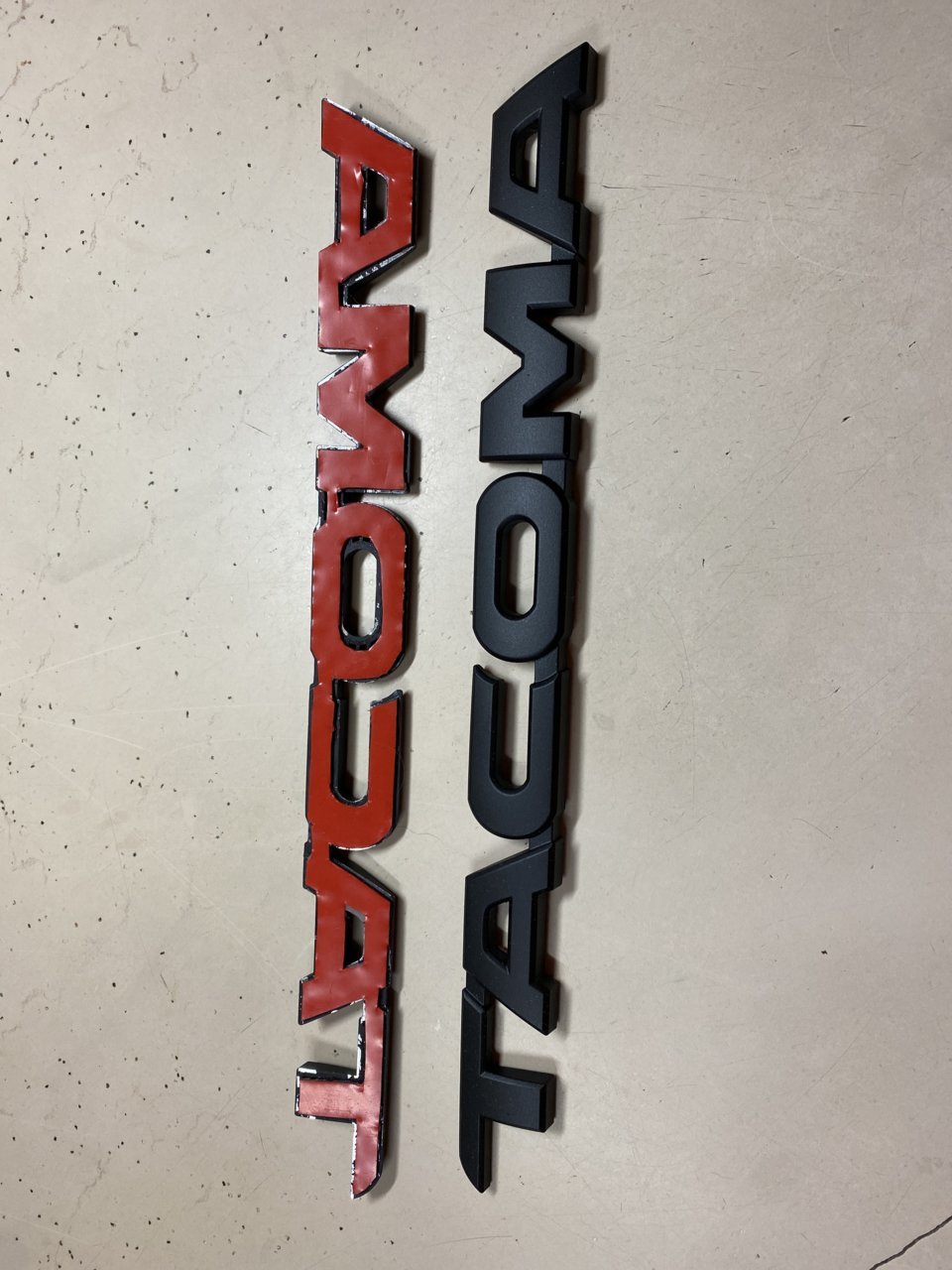

    I painted my old 2nd gen ones. I’m going to remove the original ones and only have them on the doors. The tailgate will be badgeless. Just did 3 layers of rustoleum matte black and then matte clear. Came out nice. Then I used wide 3m trim tape and an Xacto blade to trace around them.should be good to go.

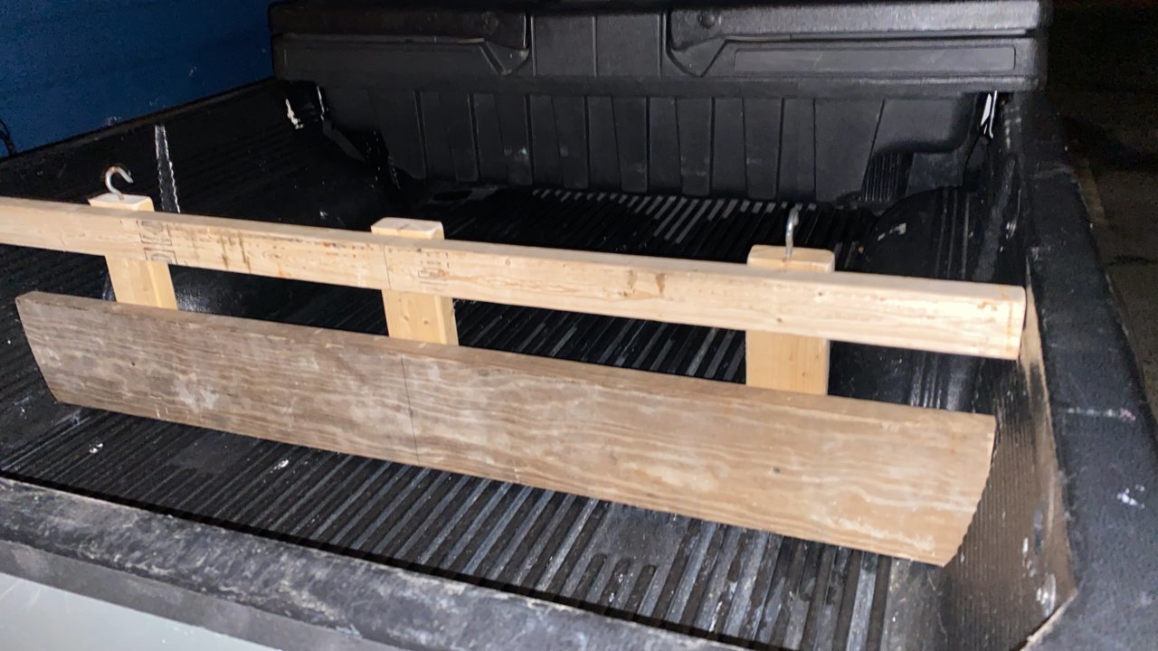

    I made a ghetto bed divider out of some free wood. Will be black this weekend now that it’s late and I know it fits SNUG. It’s not going anywhere.
    plenty of options to attach straps and bungee cords

    I like that! I plan to delete the rear also! I might go that route. Did you scuff them up or spray over?

    I hit them with a green heavy duty scuff pad and used this-

    Here’s how they look

    Good info bro ty
