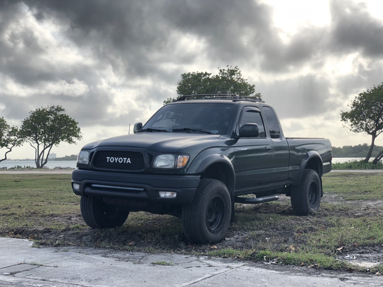

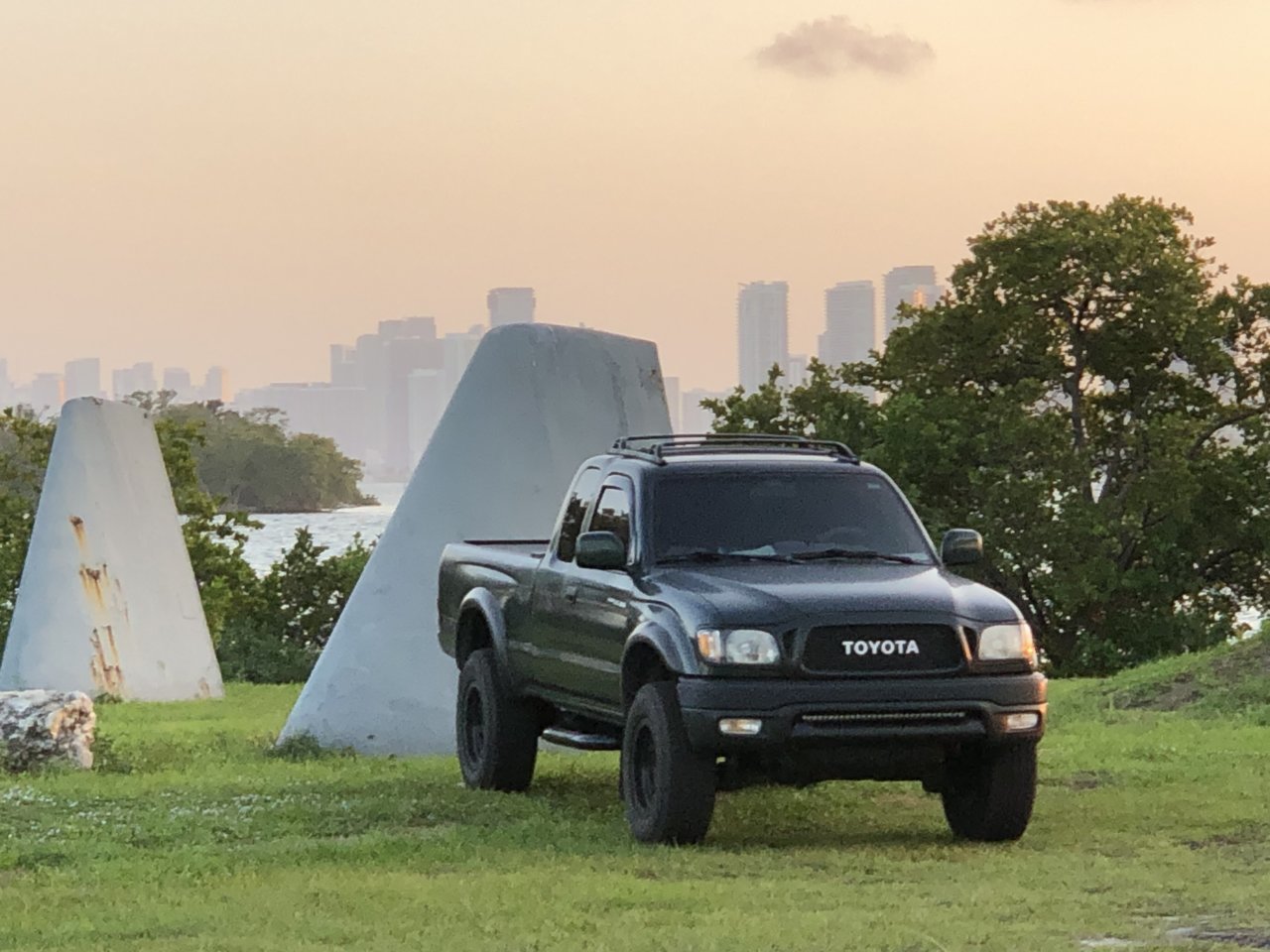

    Got some fresh ocean air for the taco!

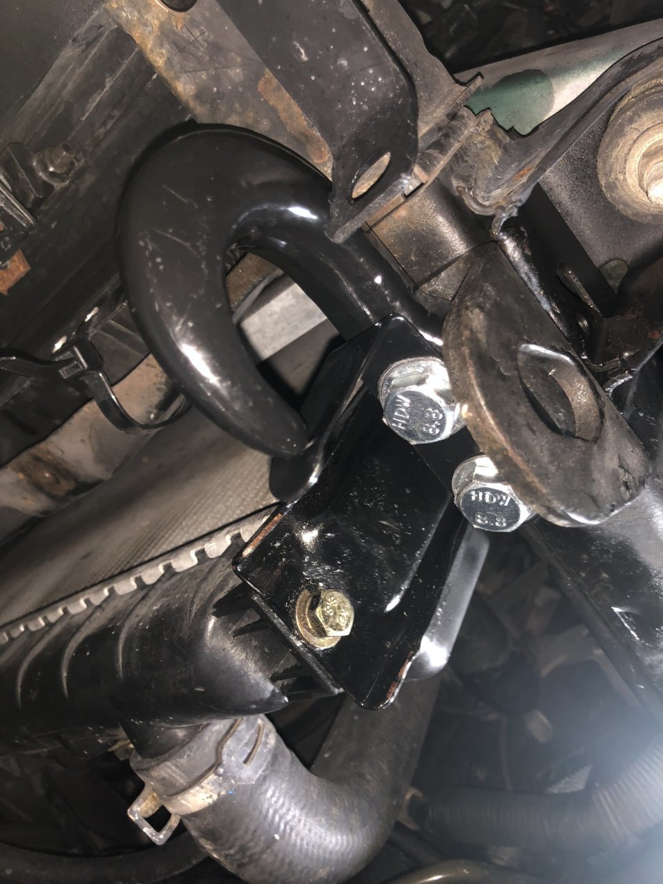

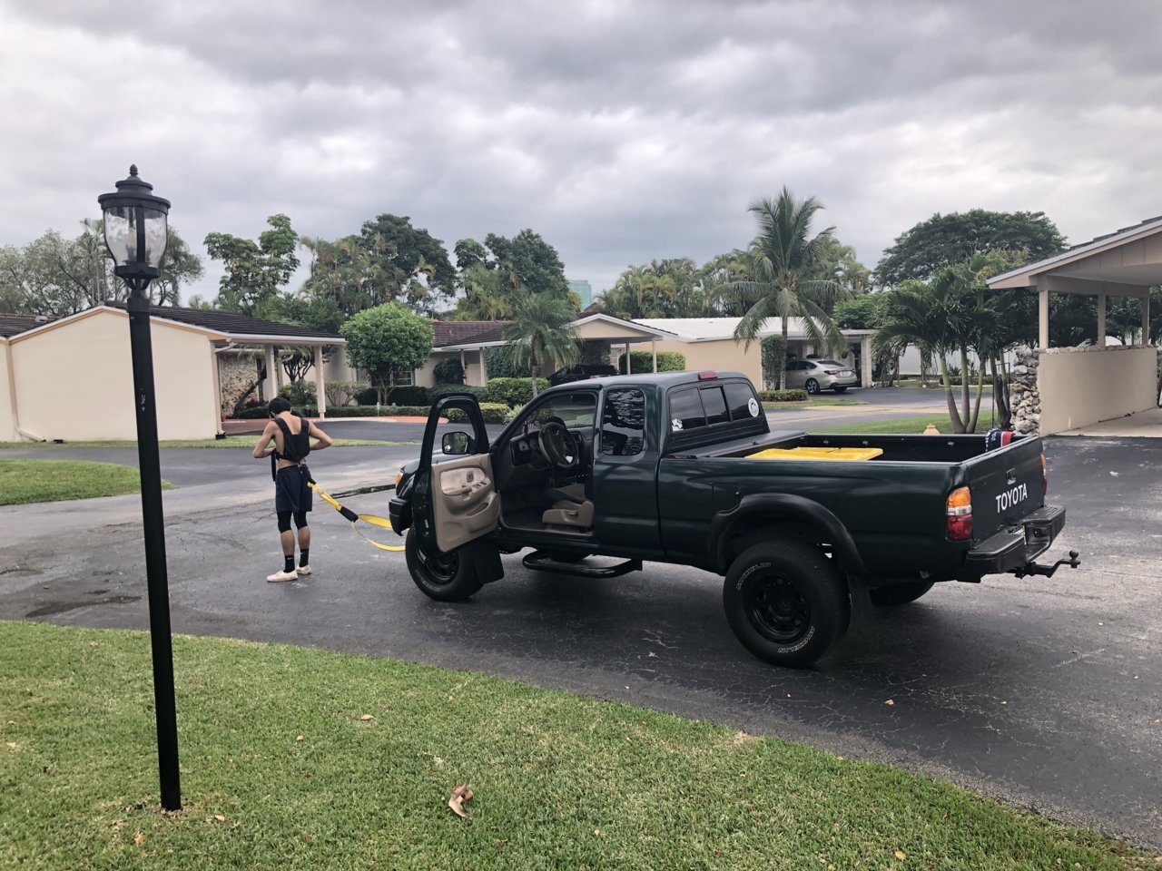

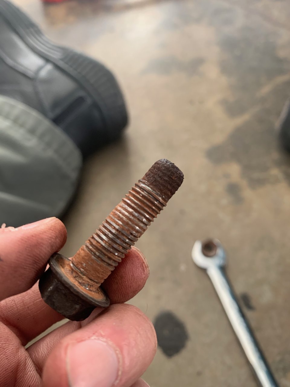

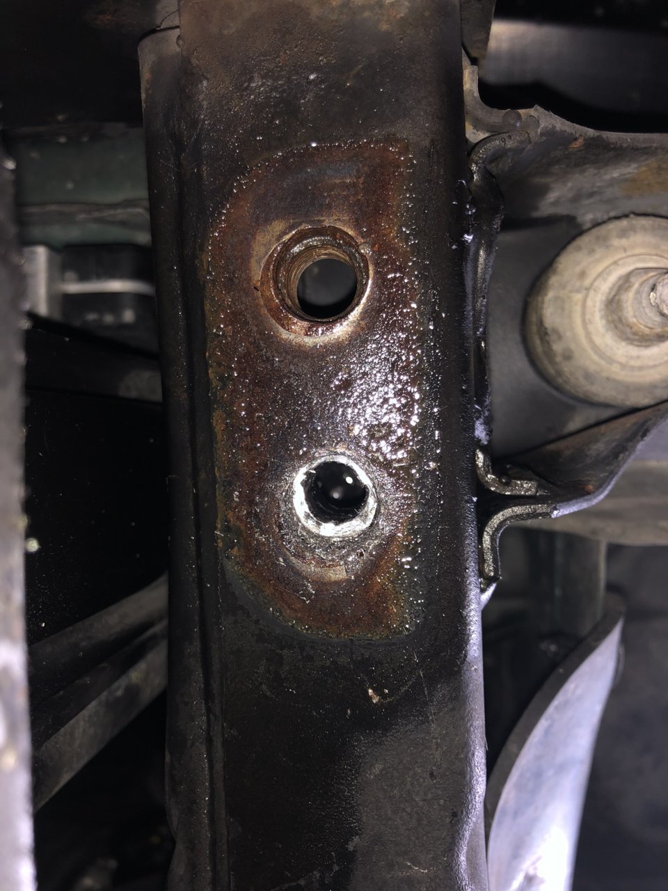

    Been using the truck for a workout ever since the pandemic ‍♂️ Had to tap out the old bolt to put in the new recovery hooks

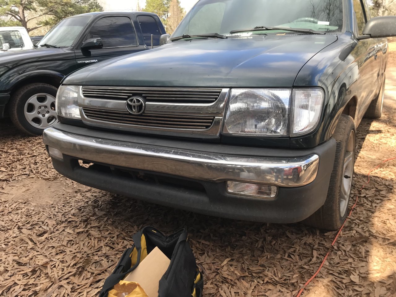

    Installed billet overlay. Looks awesome. Also had to replace the door handle. Usual 22 year old plastic. Mine were OEM so when it broke this week I was a little upset but not paying $120 for each OEM.

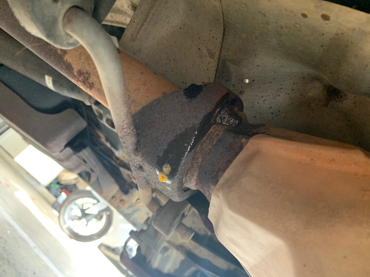

    Tried to get the old catalytic converter off but only got 2 of the 4 bolts out. Rounded off one bolt and one of the special star nuts on the front one. Gonna cut it off tomorrow.
    PB blast only helped a little, but it took using a breaker the entire time to even get the ones I could get off.
    Just save yourself the trouble and cut it form the get go!

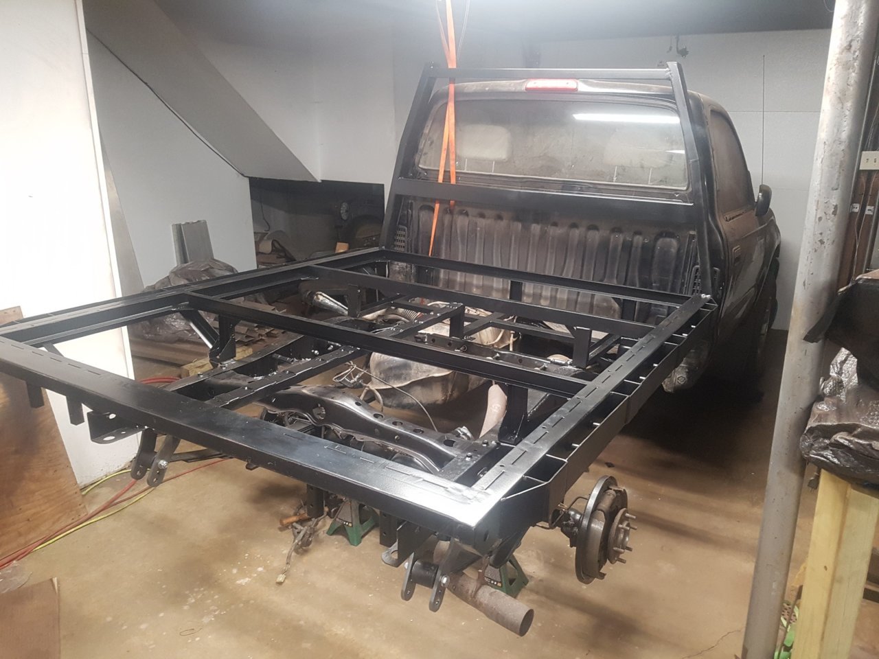

    New leafs installed,brakes mostly hooked back up,gas tank back in, new bed set in place. Suddenly I have space to move in the garage again. :laughing:

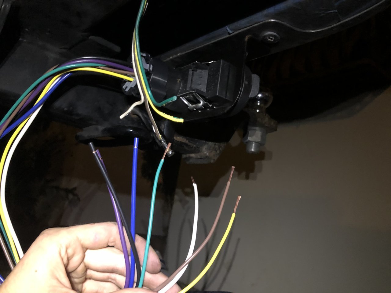

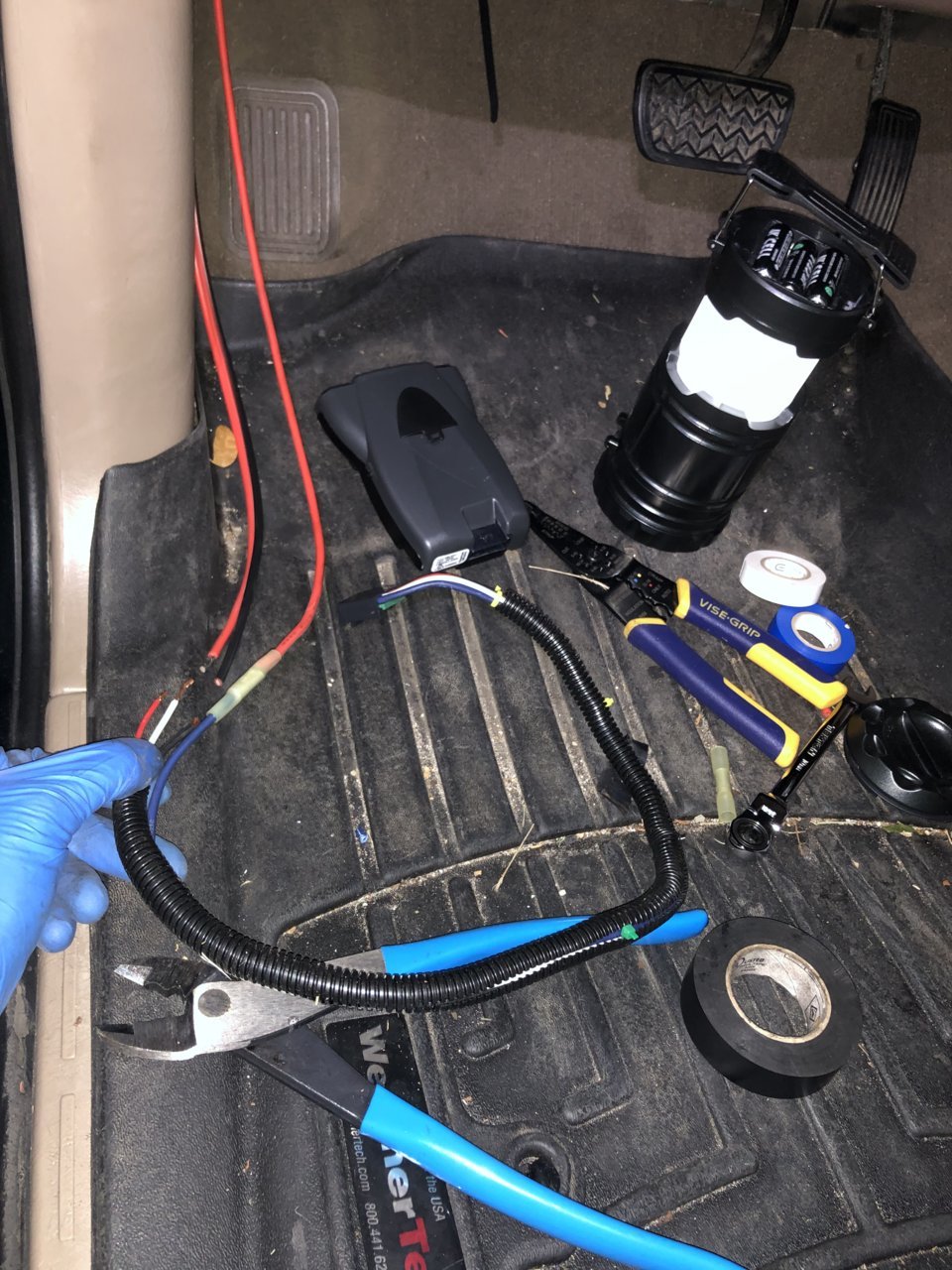

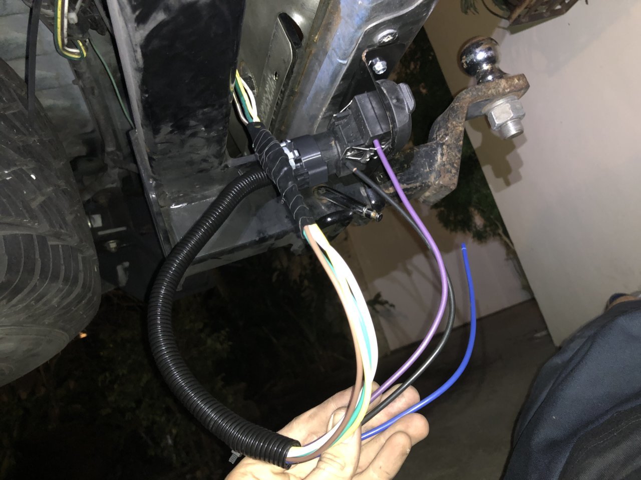

    Finally got the 7 pin installed! Ran the power line (black) and electric brakes (blue) line on top of the frame & into the cab via the driver side grommet

    I just installed the same socket and bracket. I too need to do my trailer brake controller install and power supply to my trailer battery.
