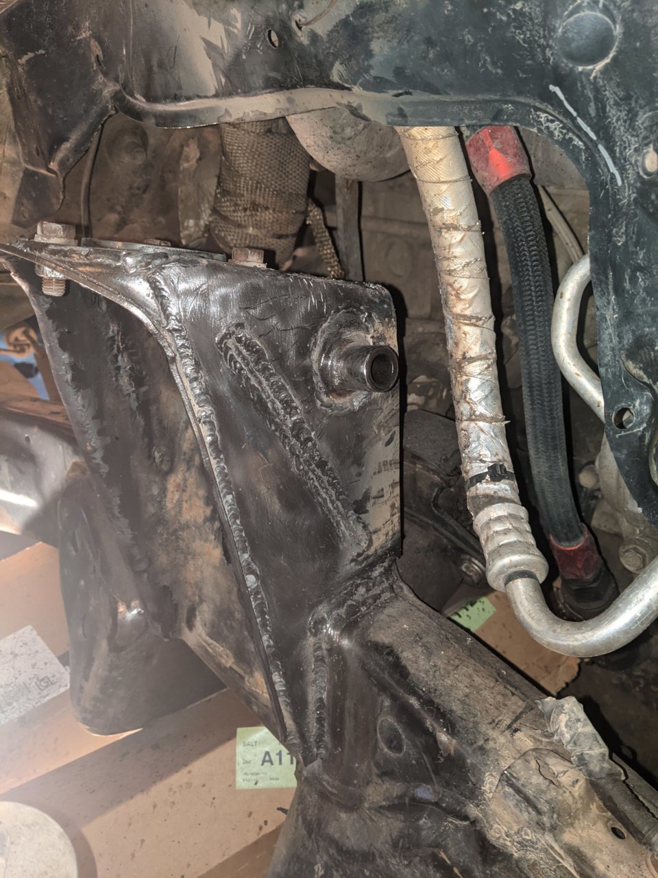

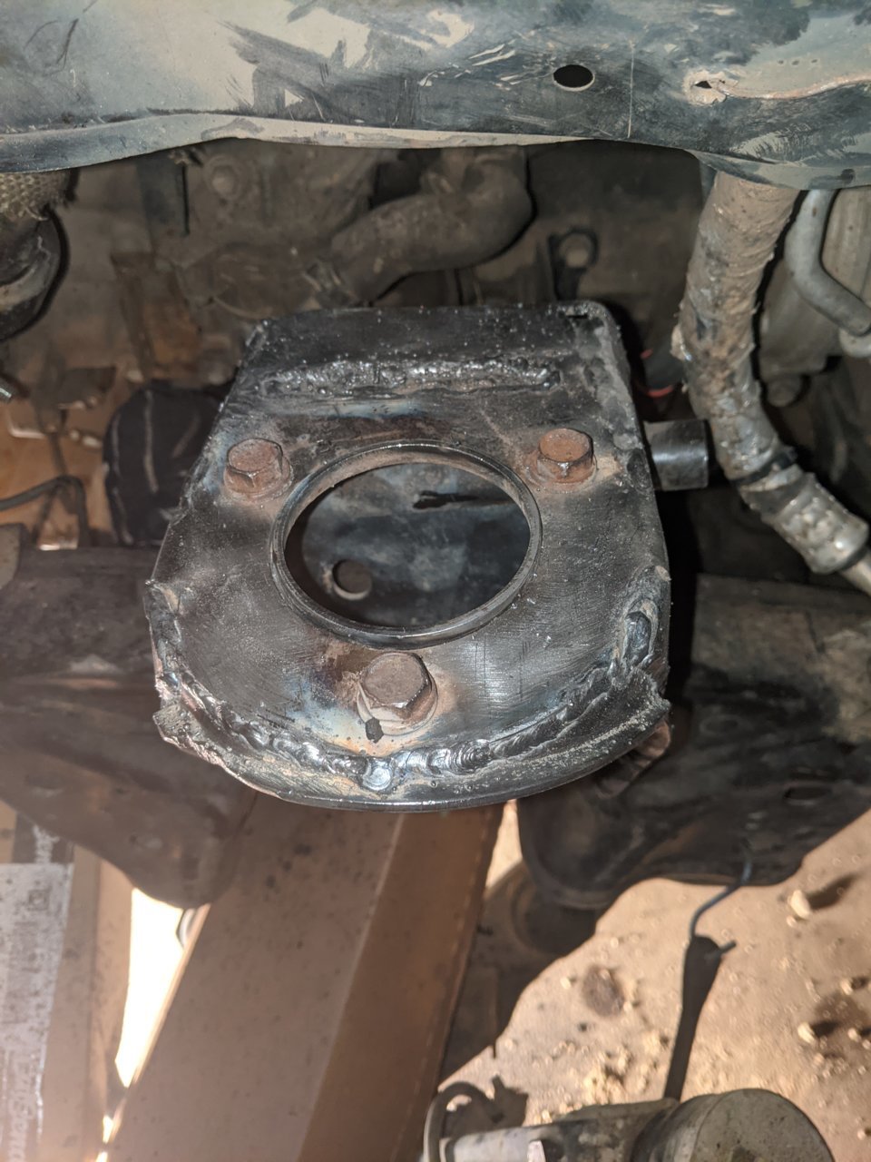

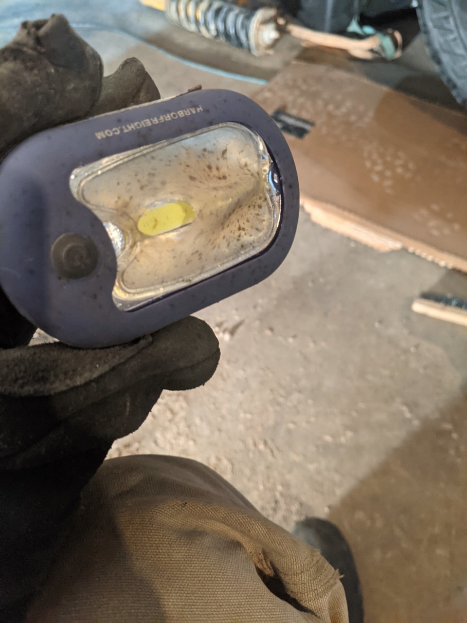

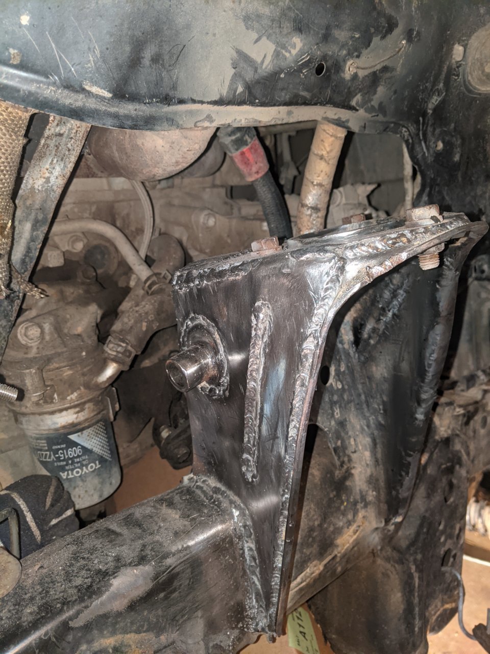

    What a pain in the ass place to weld something. Almost get comfortable and then you bump your hood and can't see anything.
    PXL_20210122_225347034.jpg PXL_20210122_225400315.jpg PXL_20210122_225355197.jpg
    Kind of wish I would have waited to get the anti spatter spray but o well.
    I'm honestly not sure I'd change anything. The legs could probably be a half inch shorter but other than that a hammer was able to close any gaps. I bent the legs the wrong way the first go around so I had to straighten and go back so that deformed it a little. Its a pita to get in place with the UCA tube sticking out like it does.

    yeah I bet haha luckily you can fit a 6" C clamp or two in there to hold it and help bend it in I'd think. I used two to hold mine up.
    And i said fuck it and jacked up the body far as I could on each side. Was easy to unbolt and only gives you like 1-2'' but it makes a HUGE difference haha
    Otherwise the best thing is to pull the engine.
    You going to weld up the inner circle on the top? I did just to keep water out.

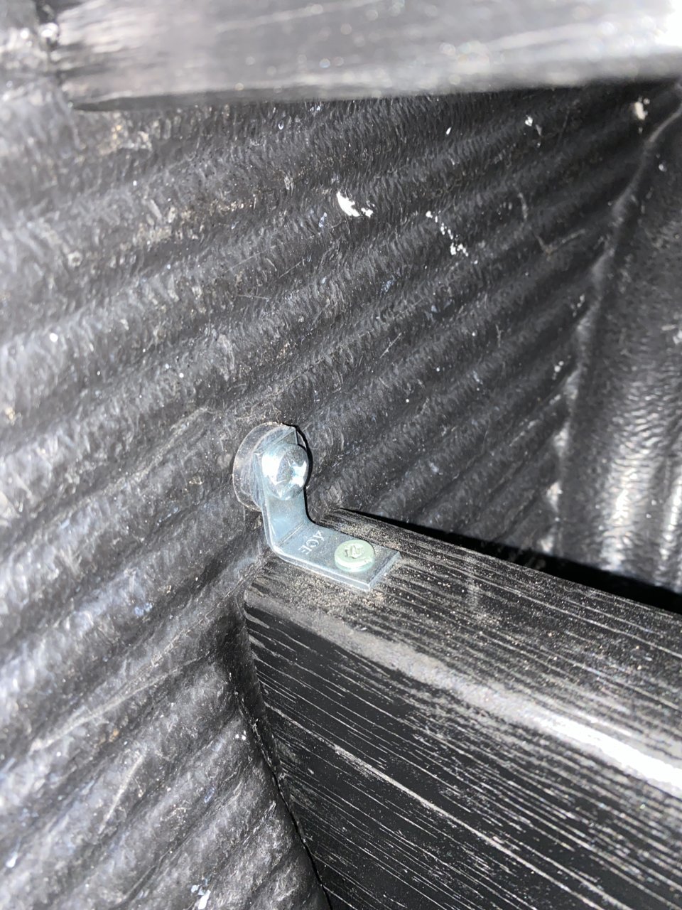

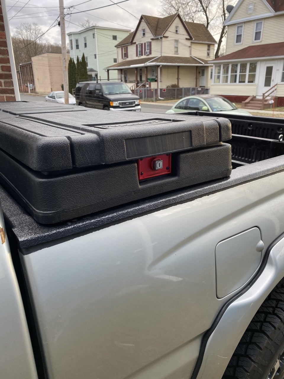

    Did something easy. Painted the lock surrounds red (painted the pins black) on my toolbox the other day and then added the center cap decals today. Then I installed some expansion nuts into the bedliner and small L brackets on my DIY bed divider just to make sure it doesn’t go anywhere. Simply undo two screws and the whole thing comes out. I think I’ll change them over to Allen bolts and keep the Allen wrench in the glovebox.

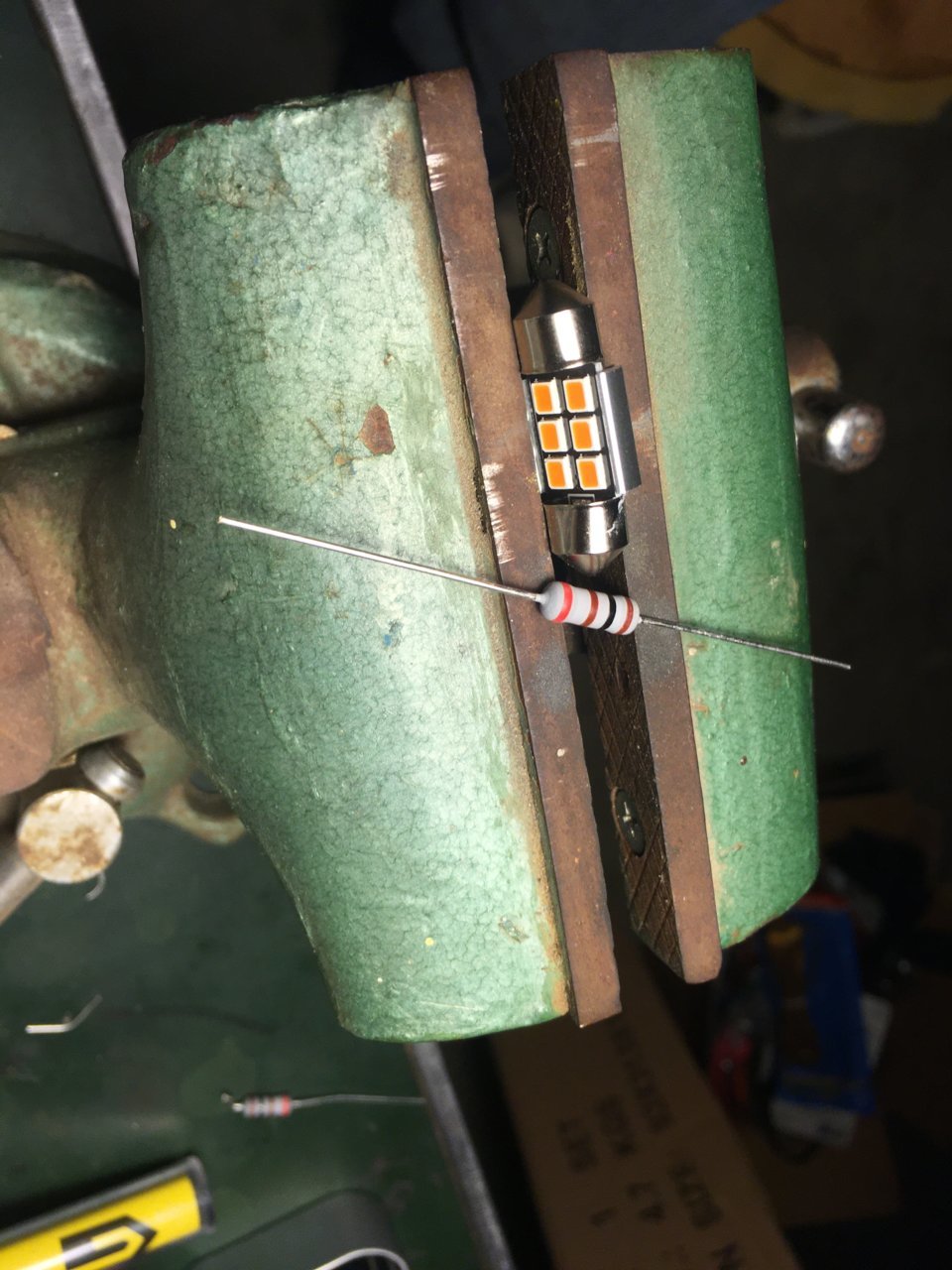

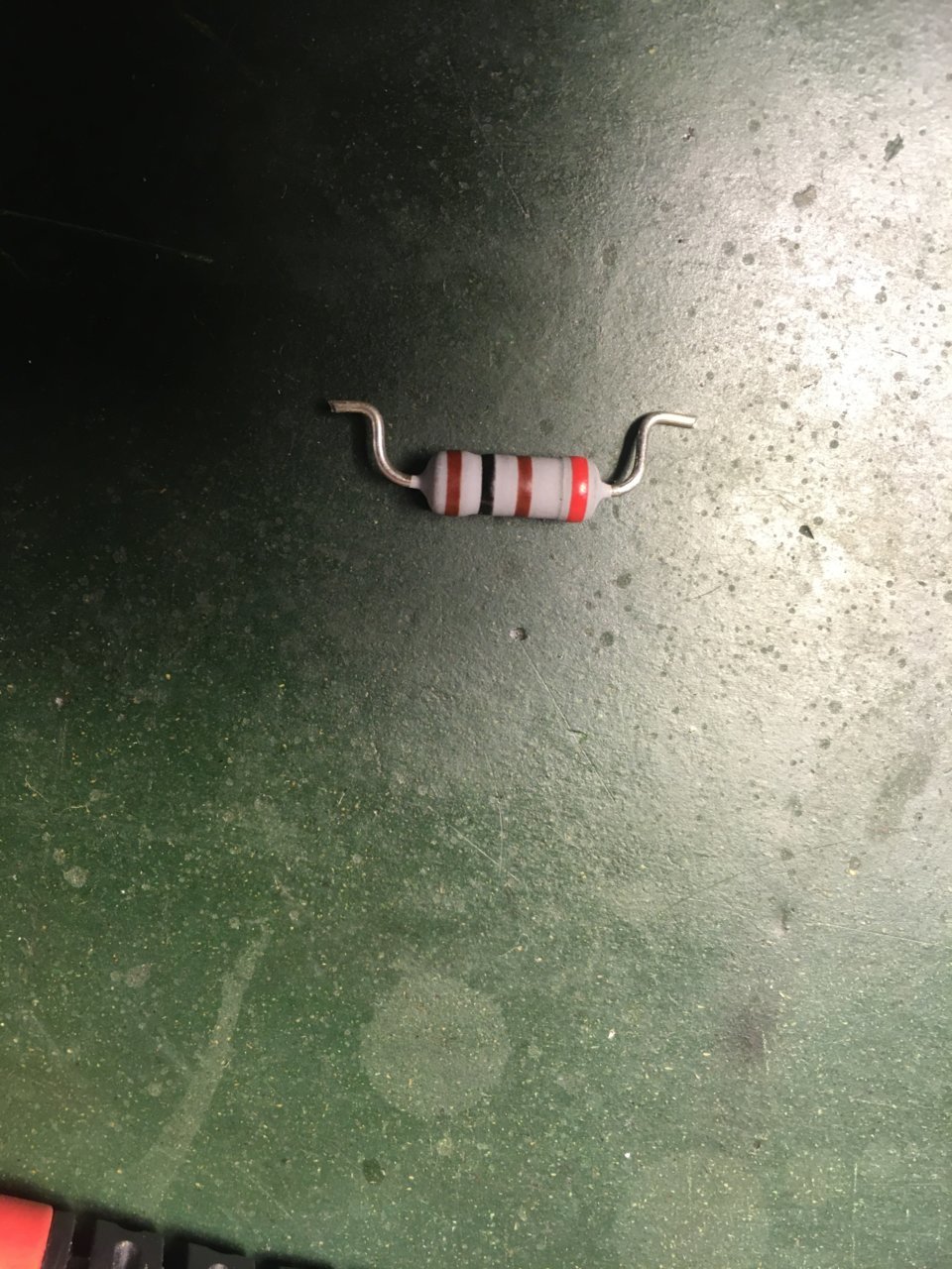

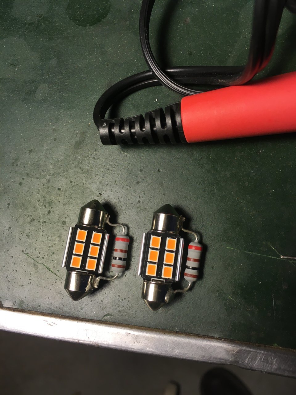

    Interior LEDs with resistors.

    Why?

    For some reason, LEDs are wonky in 2003 models. For example, without the resistors my map lights would turn on only if both were on. The dome didn’t work at all. I’ve heard other stories, like the lights flicker unless the ignition key is turned to Acc. With the resistors, everything works as designed.

    also true in my '02.
    Unfortunately, adding a resistor also reduced the light's brightness.

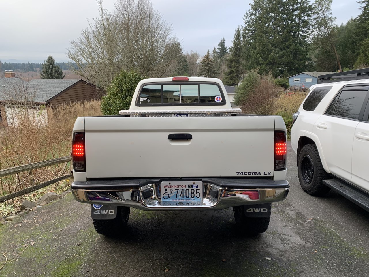

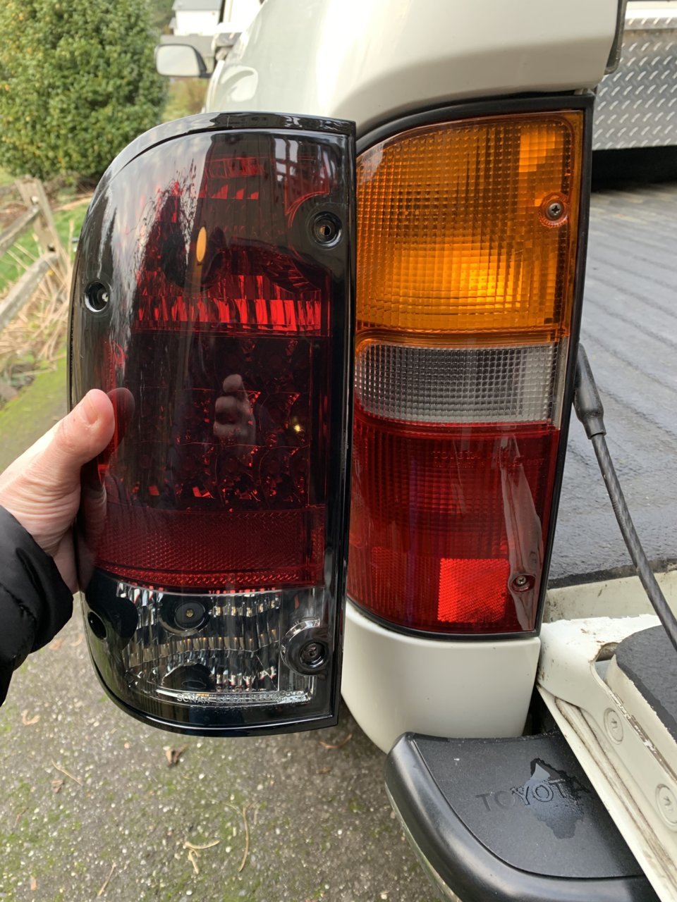

    I need to add resistors to my LED taillights. I’m not sure how bright they are with the brake applied but even without that they’ll burn your eyes out.
    I’d much prefer for them to be dimmer but bright as fuck with the brake applied. I just have no idea how to accomplish that.

    i tried mine with and without resistors and honestly didn’t notice a difference. Both were better than the stock bulbs. I used 1watt 100 ohm resistors and Auxlight bulbs. Def not “300% brighter” though.

    I only have 5" C clamps but was able to get a trigger clamp in for the short time I needed it.
    I did end up welding it up. Kind of worried about water getting into the back side also.
    Probably less than an hour of trigger time. Prep was annoying in the tight space. Cutting the brake line bracket off wasn't easy with the tools I have on hand either. It's just not a fun place to do anything in lol.

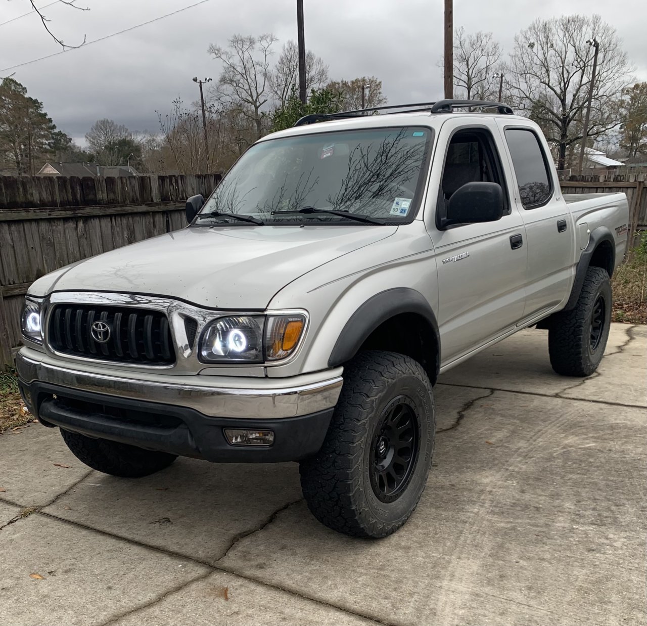

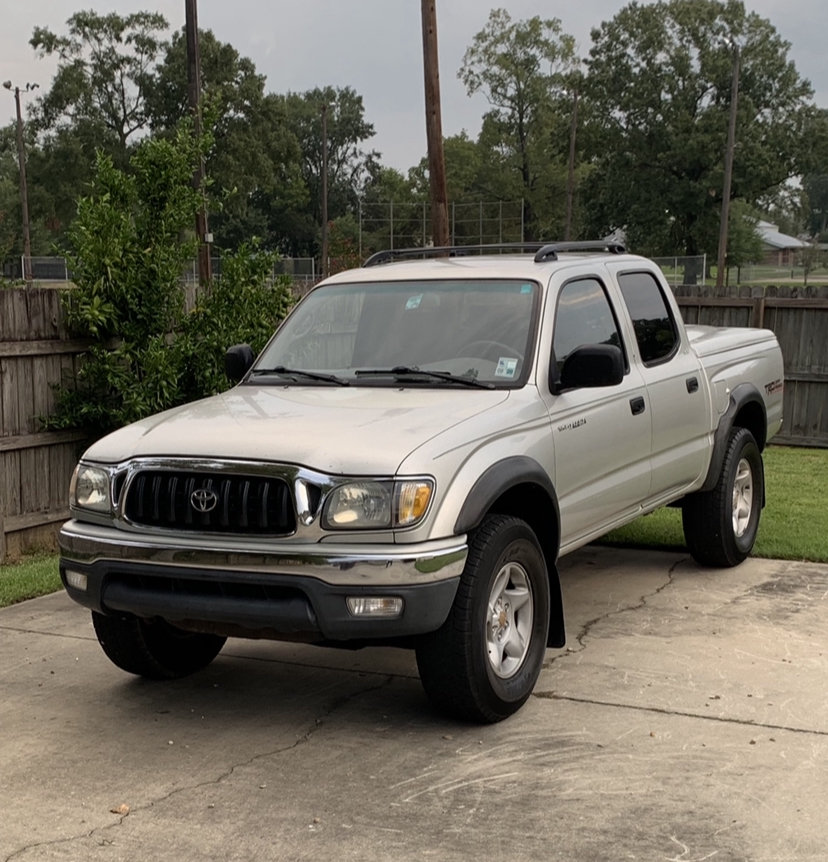

    Had to make a post:)
    The truck 2 years ago:
    Vs. how it sits now:

    I was actually gonna install the same thing today. Did you use a self tapping screw or bolt/nut? Clearance issues underneath?
