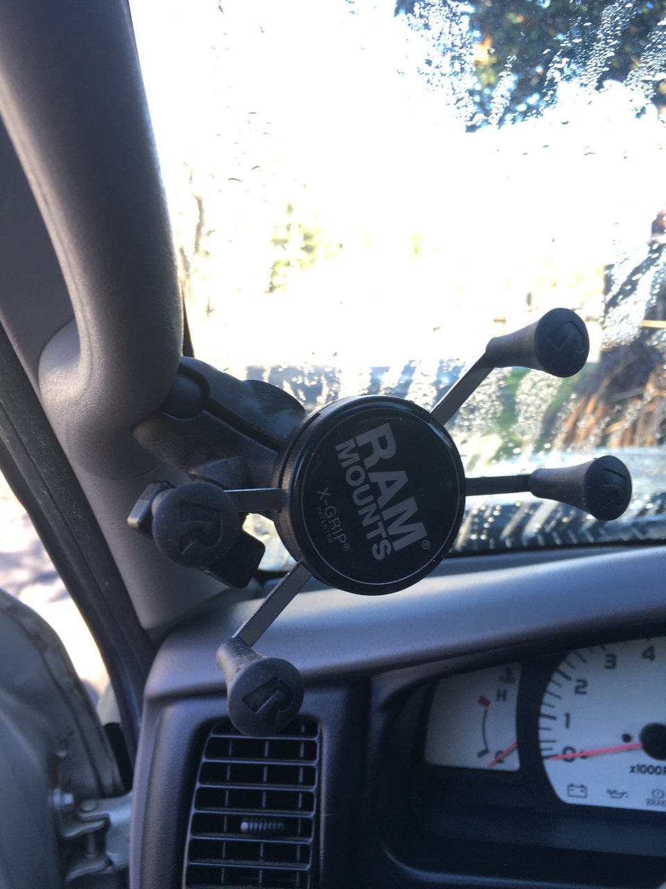

    RAM mount at the handle mount. Compared to the windshield mount to the right of the steering wheel, this setup brings the phone closer in, making it easier to see.

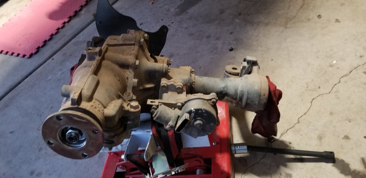

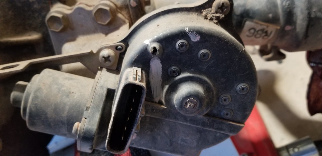

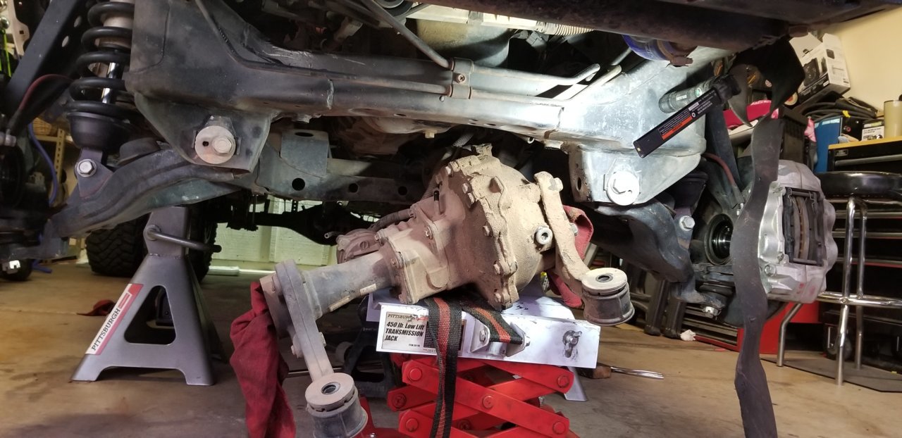

    So i had a productive day. I was feeling pretty proud of myself for pulling the front diff by myself..
    I did run into a small snag. I ended up breaking the vacuum line that runs into the add diaphragm. I'm thinking about tapping a small barbed fitting. I'd be open to suggestions on alternative ways to fix also.

    It's not a vacuum line, just a breather so the case doesn't rot inside from condensation. You can epoxy it back on or remove the cover and drill it for a bigger fitting or whatever, just make sure it's water tite

    Thanks!! Wasn't sure what it did.

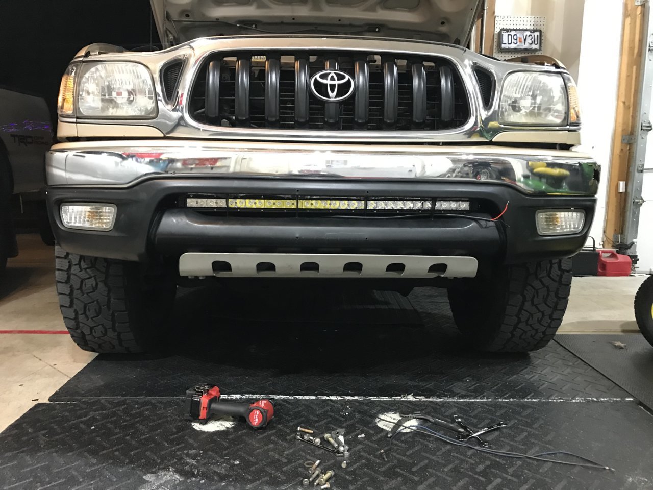

    Stock: Light bar!
    Added a hidden light bar to accompany my lights on top!

    I used some double sided tape and then 3/4” long self tapping screws.

    I drilled the hole out a little larger and put a vacuum line barb in it and rtv'd it in there. Epoxy would probably be better. I did have an early attempt at fixing this fail and had water get into the actuator and cook it.

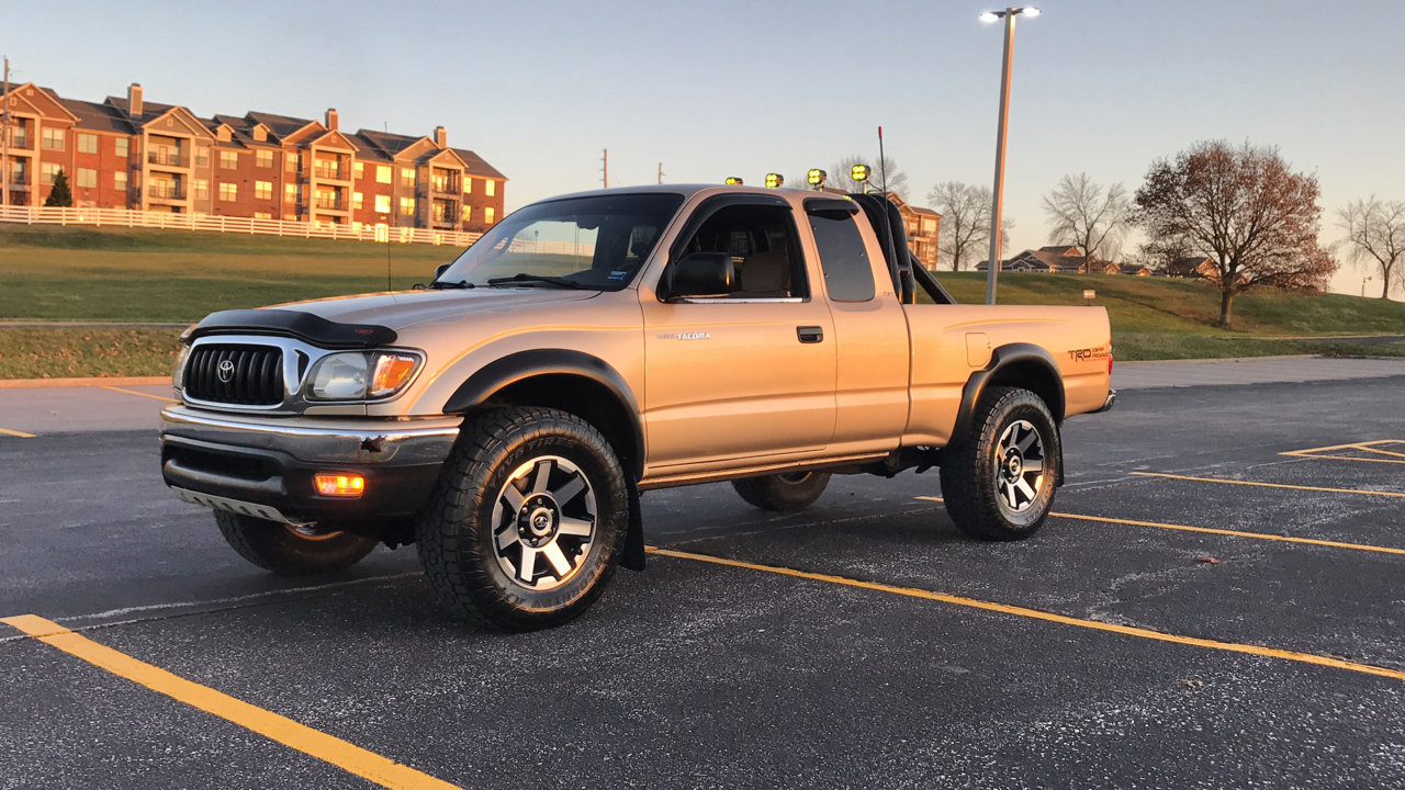

    More boost and less weight.

    That's what i was thinking about doing. Did you pull the cover off or just drill it in place?

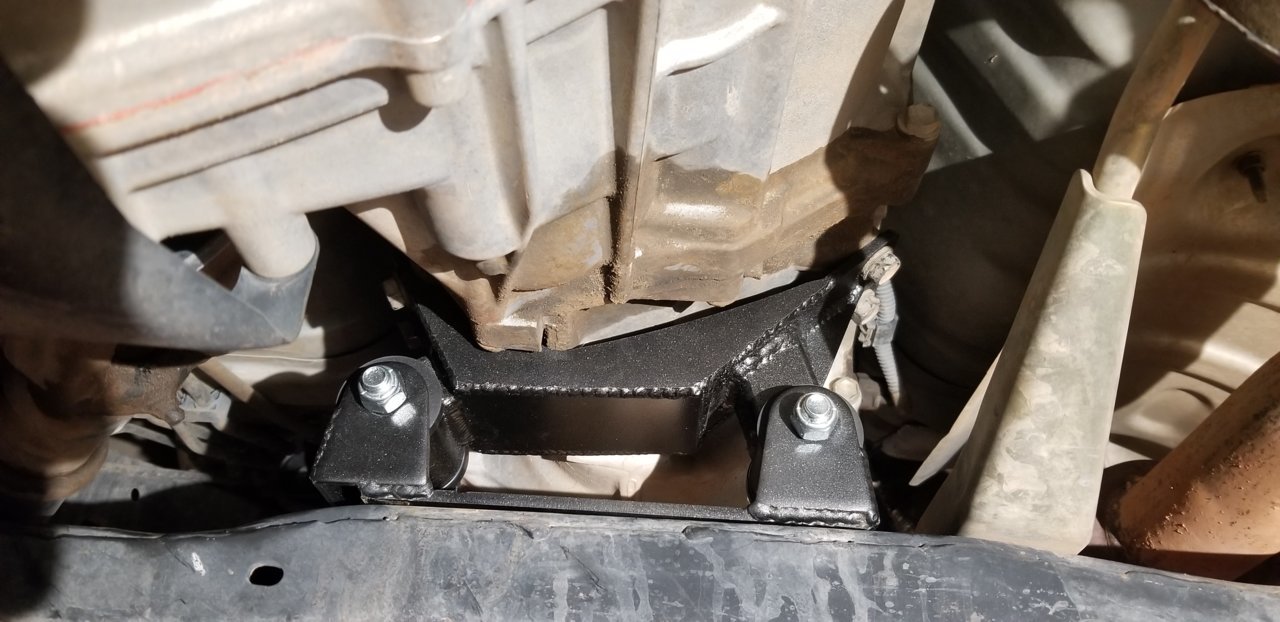

    Got my new trans mount in . Having to get a different ratchet so i can finish the motor mounts.

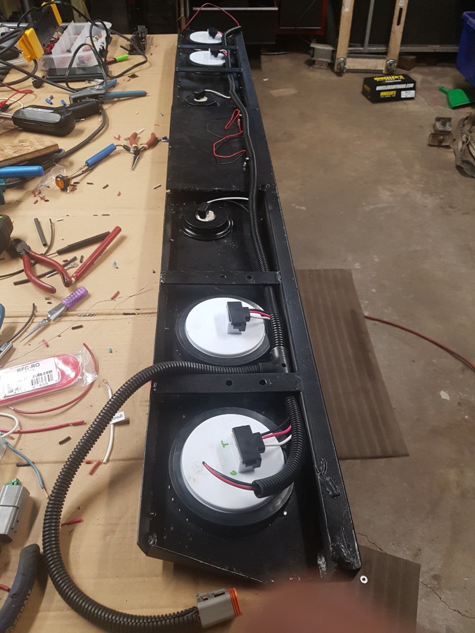

    Split loom is magic. Flatbed tail panel is coming together.

    Auto or manual? I need to find beefy trans mounts for an auto..

    Manual. Bozen doesn't make 4wd auto tranny mounts.
