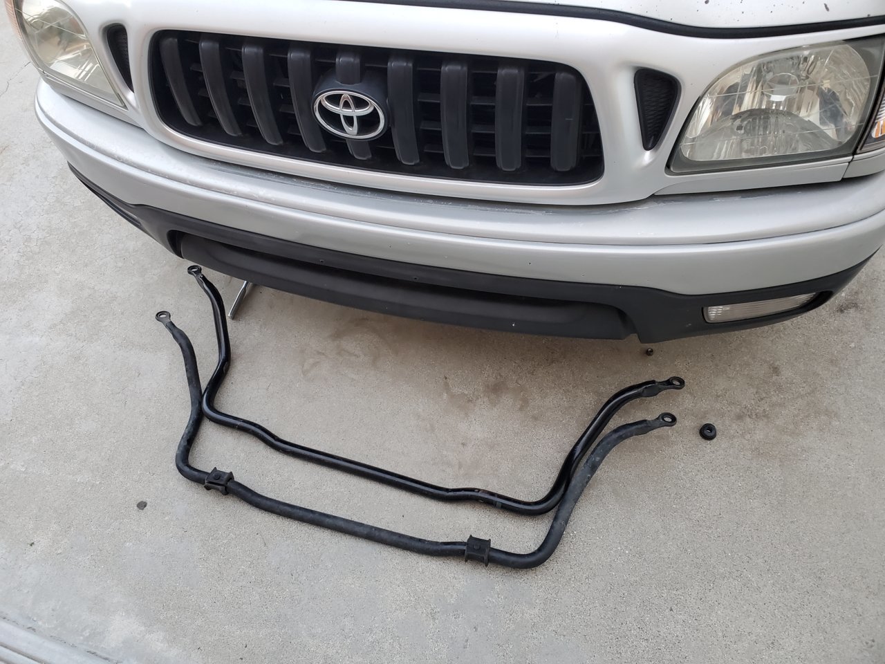

    Popped an SRunner front sway bar onto old Trudy today..
    2mm really makes a difference!!
