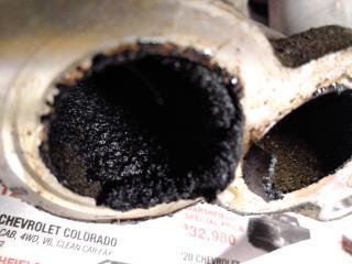

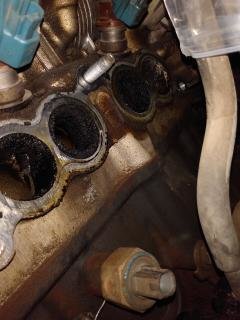

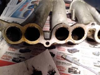

    I just finished a complete intake clean out on my 2.7l. It all started with a simple Throttle Position Switch replacement due to hesitation issues and turned into a much longer and bigger project. Don't they all! :facepalm:
    Here is what it looked like at the start:
    And
    I made a radius ended scraper tool to remove the heaviest of the deposits.
    Here are all the deposits I was able to scrape out:
    I then used a combination of brake cleaner (being sure to close intake valves first on each cylinder prior), purple power degreaser and a pressure washer (only on the manifold) to clean the rest. Cleaned the TB and replaced the EGR valve and TPS too.
    Sorry no after pics but everything was spotless and shiny after. :thumbsup: I took some after pics but somehow lost them (might have something to due with all the brake cleaner fumes I inhaled). :eek:
    I installed a catchcan to help prevent future build up.

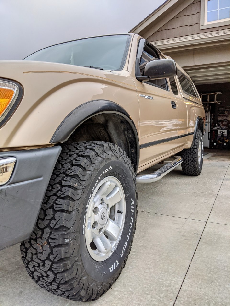

    If you don’t mind me asking, what lift set up are you running? I’m getting those exact tires put on tomorrow. Had 2 sets of these Yokohama m/T’s on my 5th gen 4Runner.

    Dropped the truck off for ome full setup with 882 coils, and some new shoes... can’t wait.

    Lol they’re not too bad, I did sound deaden the 4Runner though.. Actually found them incredible in winter conditions too. I took my winters off to run these year round
