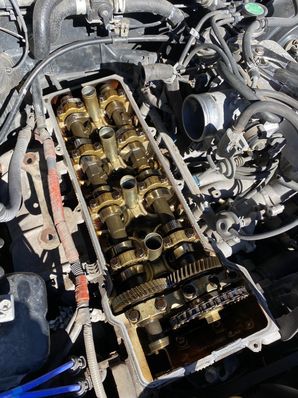

    Replaced my valve cover gasket & tube seals (those 3/4 seals had oil leaking into the plug tube and I was annoyed by that.) and while I was at it replaced spark plugs. :)

    Check valve lash if you still have it open.

    I thought about it but there’s no ticking or shaking going on. Nothing up with idle, no odd sounds or feels. Decided I’d not touch anything. :taco:

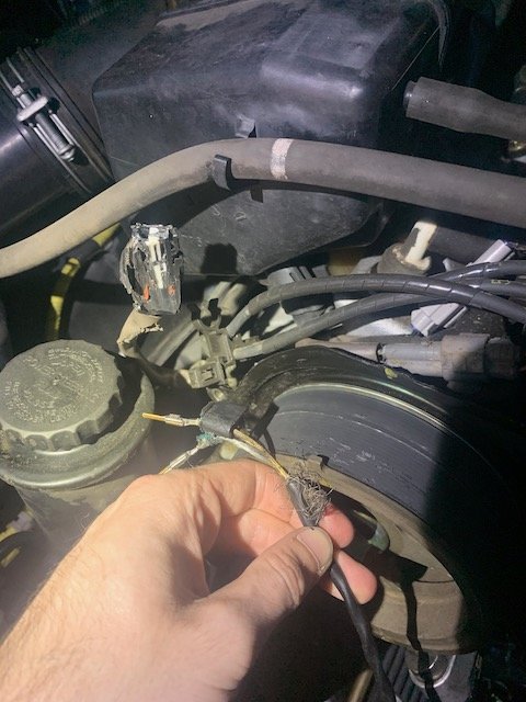

    I just did this on my 2003. Couple notes for anyone doing it:
    Make sure your cam position sensor is SECURE. Otherwise this happens and you gotta buy another belt, a sensor, and do the job again:
    Also make sure not to pinch the thermostat gasket in the housing, had a leak from that requiring a new gasket.
    My crank bolt was very tight and it took both me and my buddies strength to get it off and also torque it down. I'm not the strongest but it's 217 ft-lbs torqued down and more to get it off. So have a torque wrench higher than that to put it back on.

    I've not had any symptoms the 3 times I've checked and found at least one out of spec each time. Once was a 5vz and the other two the 3rz. It's just so simple to check I do it anytime the cover comes off.

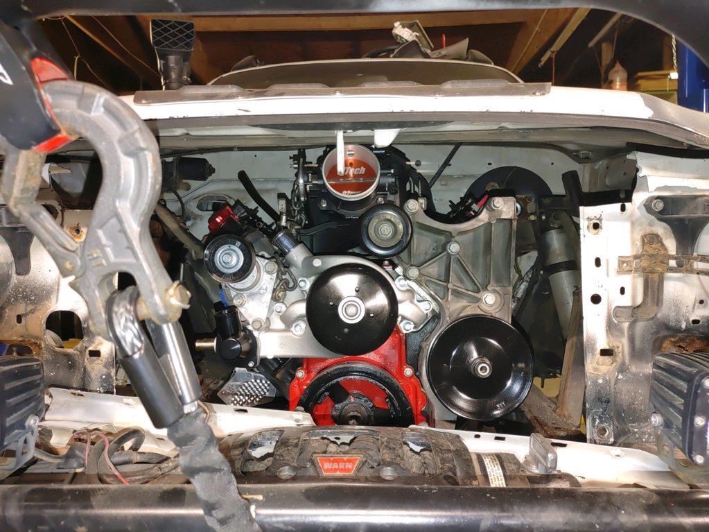

    yeah I pulled a perfectly good supercharged V6 out and loaded in this 6.0. I got bored

    I needa drive up north and see this thing

    Give it another month so I can finnish up the enterior

    So uh...
    you going to be selling a blower? LOL
