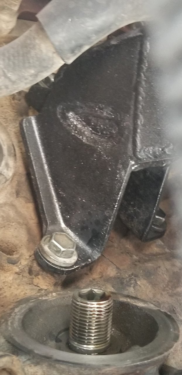

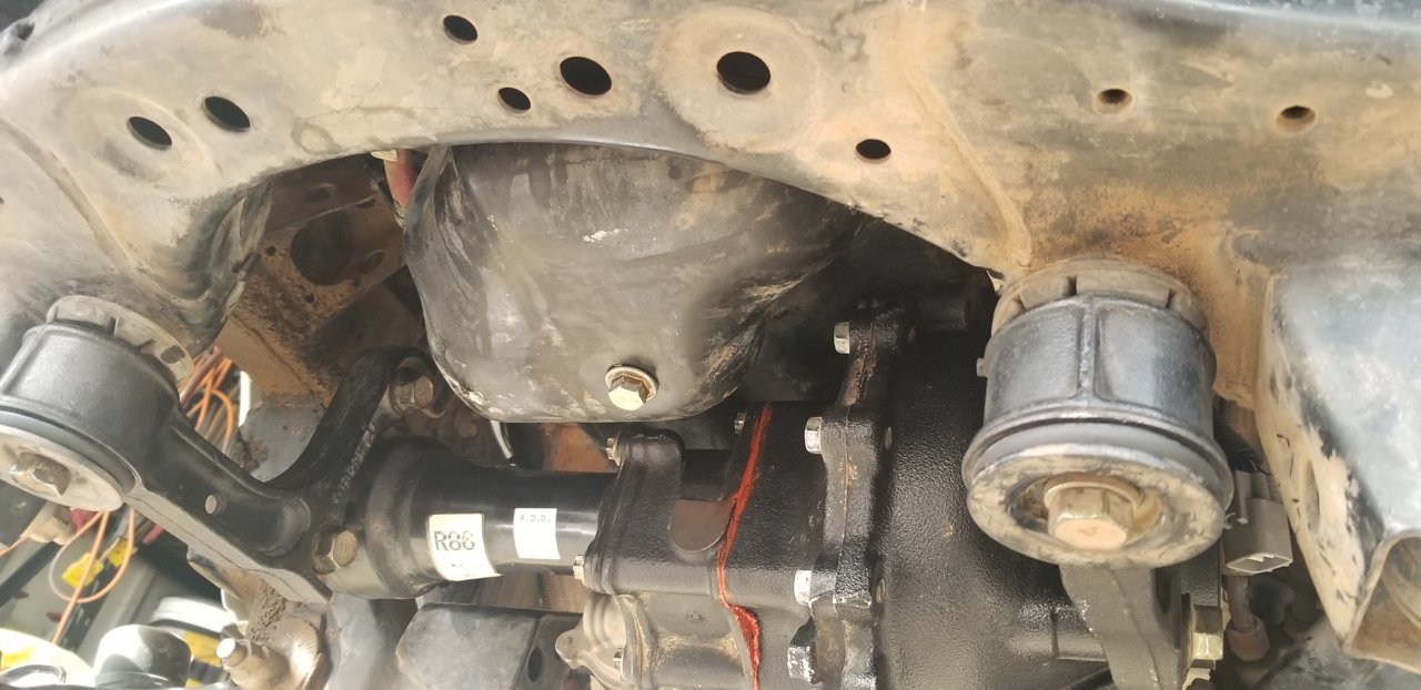

    Pulled the oil pan and cleaned it and reinstalled it and the front diff. Trying to get the motor mounts to line up now. Almost done. 20210209_151141.jpg
    And the area that required the oil pan clean out.
    Hindsight i could have just drained the oil. But i feel better now knowing that i got most of the crap out. It was super easy to do with the diff removed.
