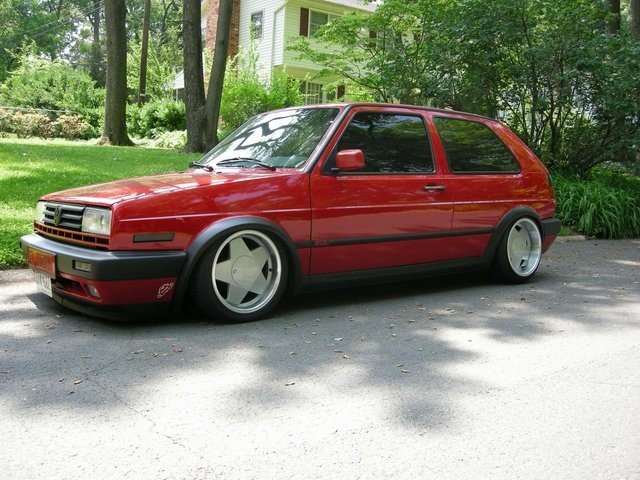

    [QUOTE="An3, post: [/QUOTE]
    that mk2, with a 07k swap...

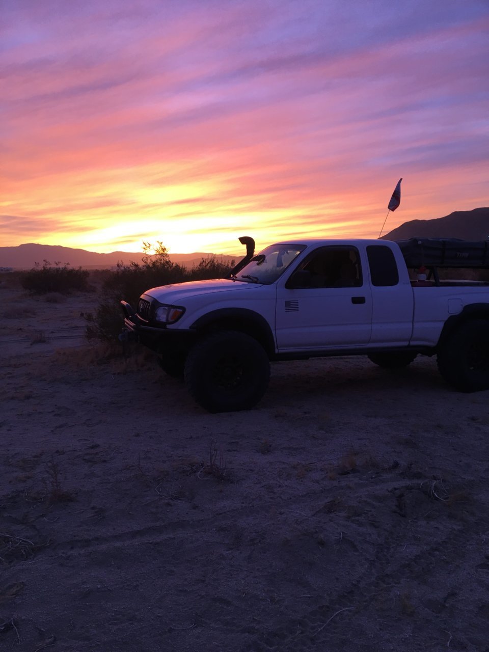

    Truck parts
    Got back from KoH. Immediately started looking at trailer builds and long travel :anonymous: The desert is epic fun
