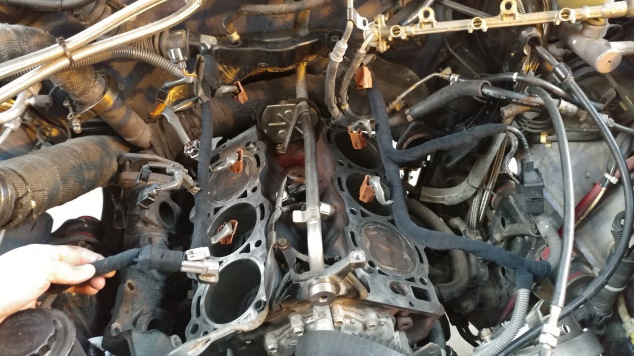

    Applied Tesa Tape to the main (injector) harness since the black plastic disintegrated.

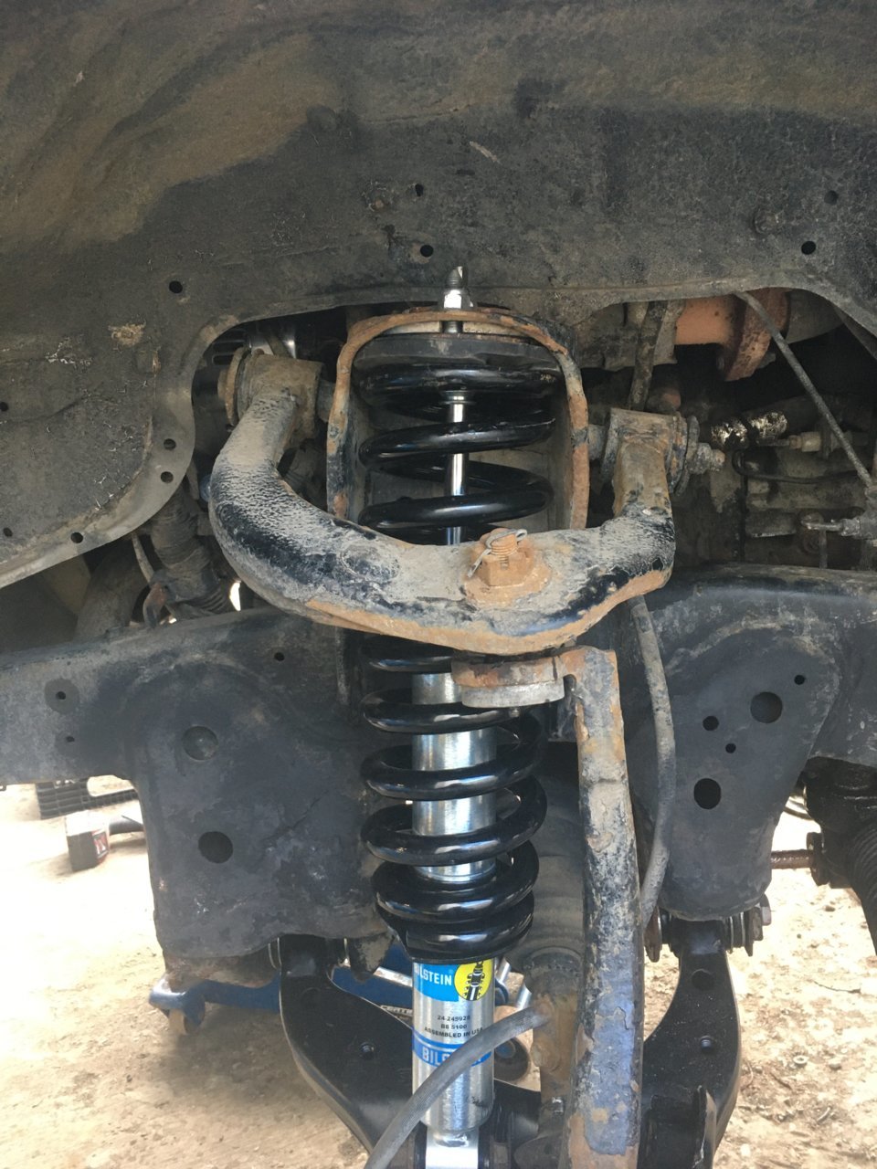

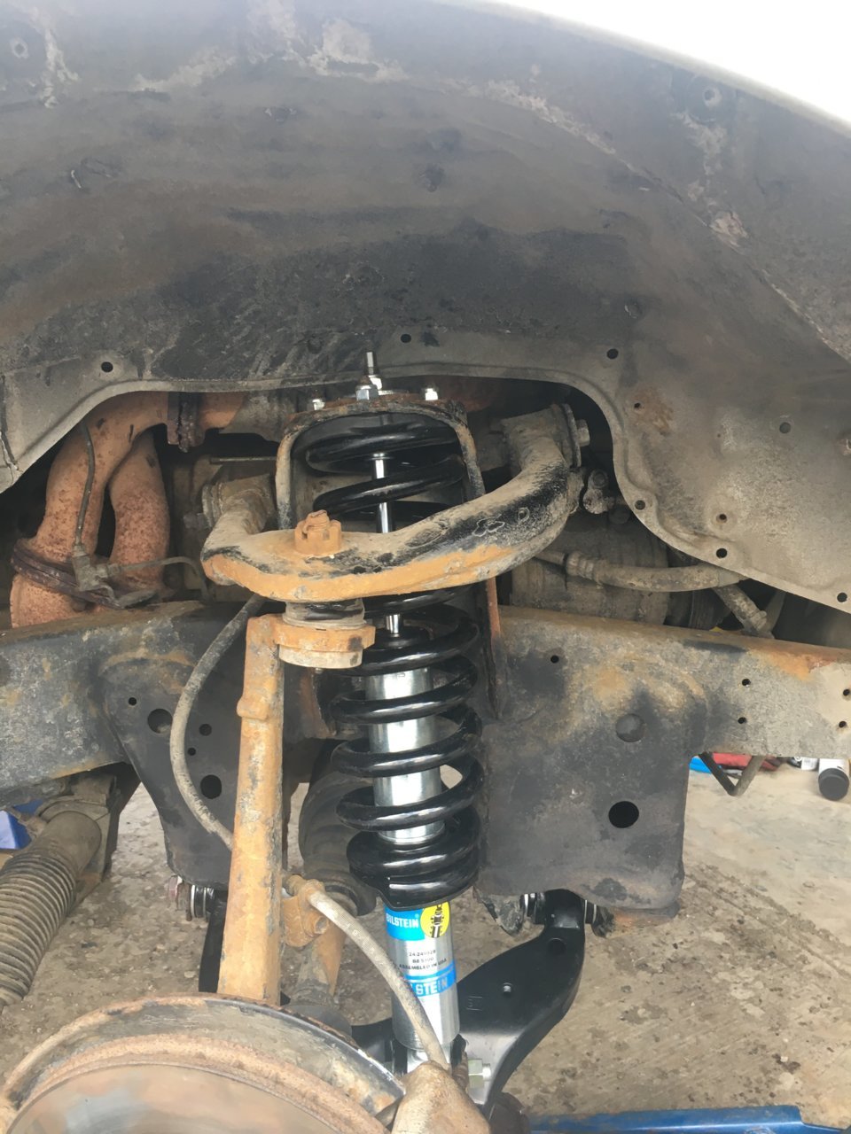

    How do these look? OME 2883, Bilstein 5100. The coils don't look like they're sitting on the rubber under the top hat correctly. How about the collar on the bottom? They're facing out, but unsure what I should clock them at.

    I may be wrong but the rubber gaskets on top of the coils look upside down

    good catch! I'm working on the passenger side right now, flipped it around and it looks a lot nicer

    the cutouts on the rubber gasket go over the bottom ends of the studs right?
