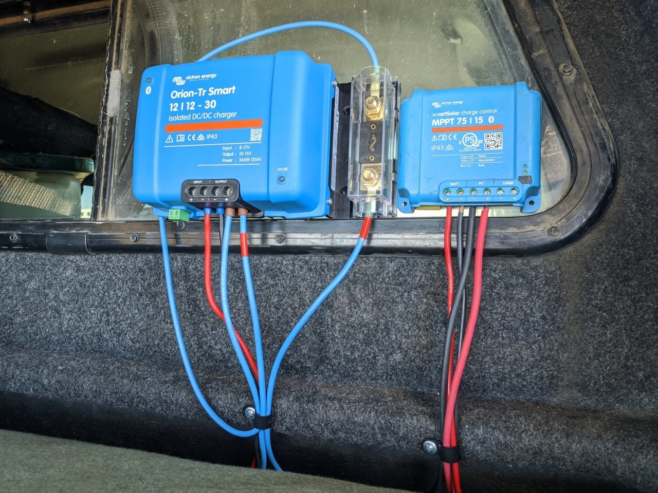

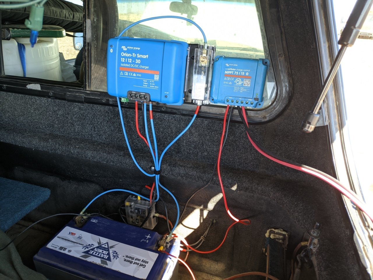

    Have had a manual Painless solenoid (flip switch, send power to secondary battery) for several years now. It worked fine but just sent whatever the alternator decided it had to give which is not necessarily what the 2nd battery wants at any given time. Now that I have an expensive Battleborn LiFePo battery as my 2nd I decided I want to treat it well and so got a Victron DC-to-DC converter (big blue box on the left - small blue box on the right is my solar controller).
    Now when I am driving between adventures it massages the power coming from the alternator to give the battleborn exactly the volts and amps it wants to keep it in tip top shape. I even see it getting the battery into absorption and float modes on longer drives.
    And, Yes, I will clean up the wiring, just wanted to get it working before figuring out routing.

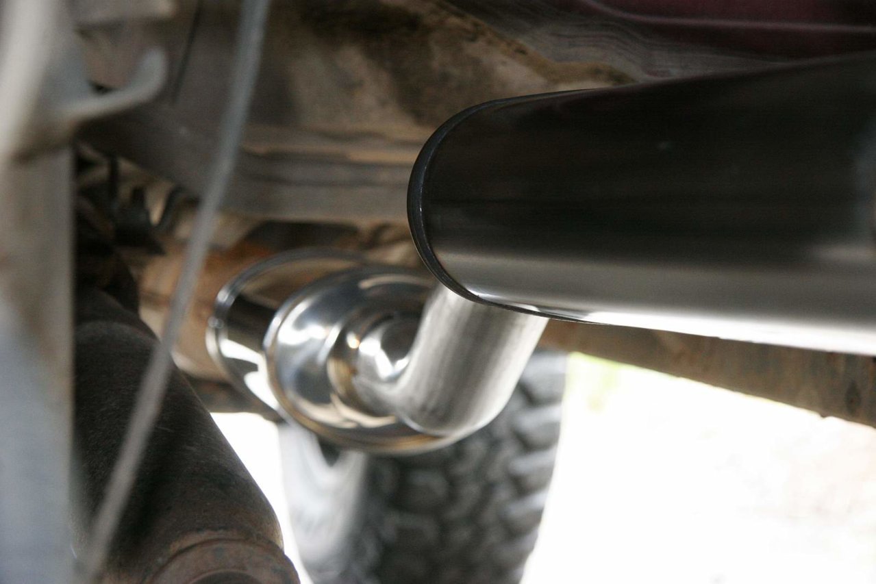

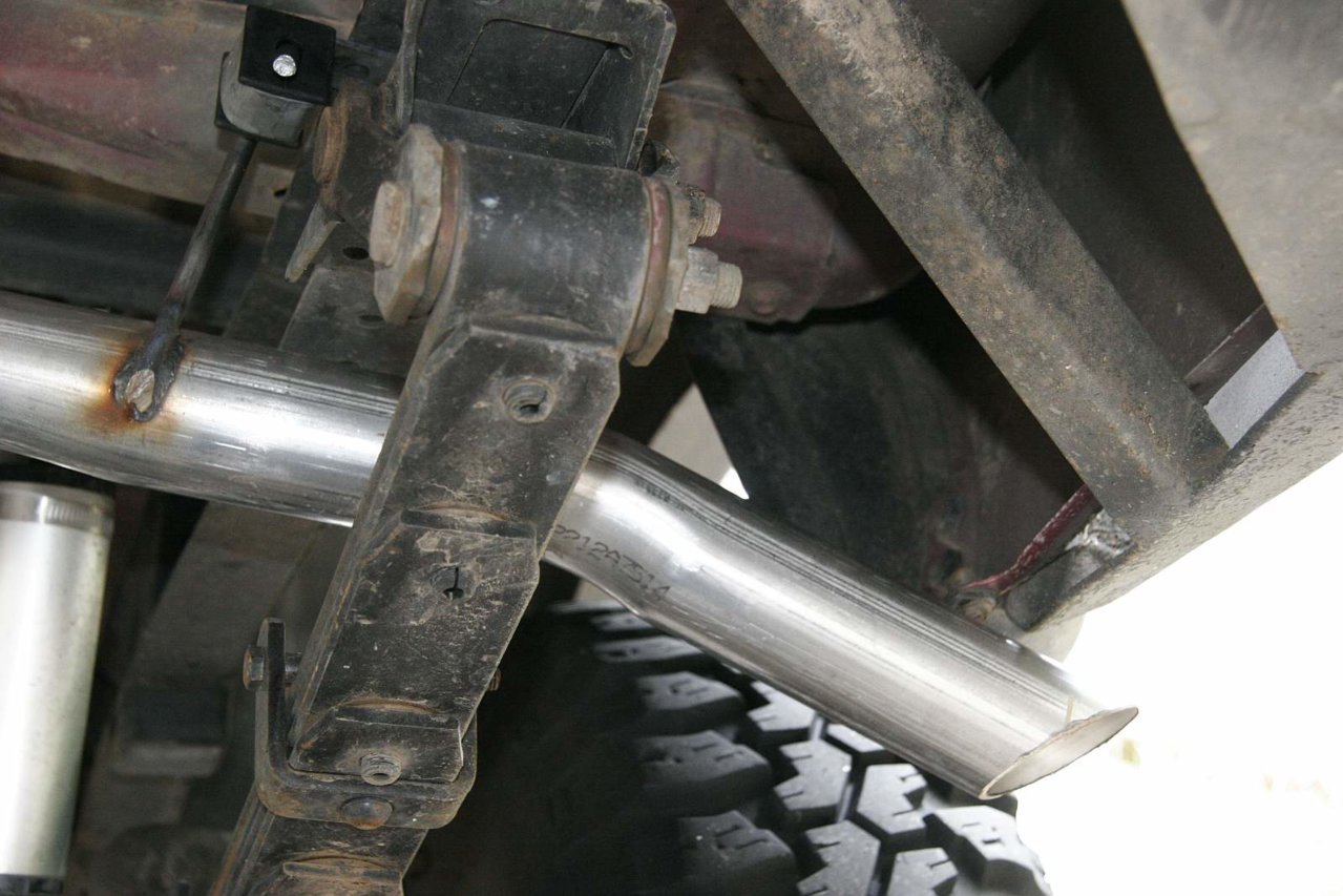

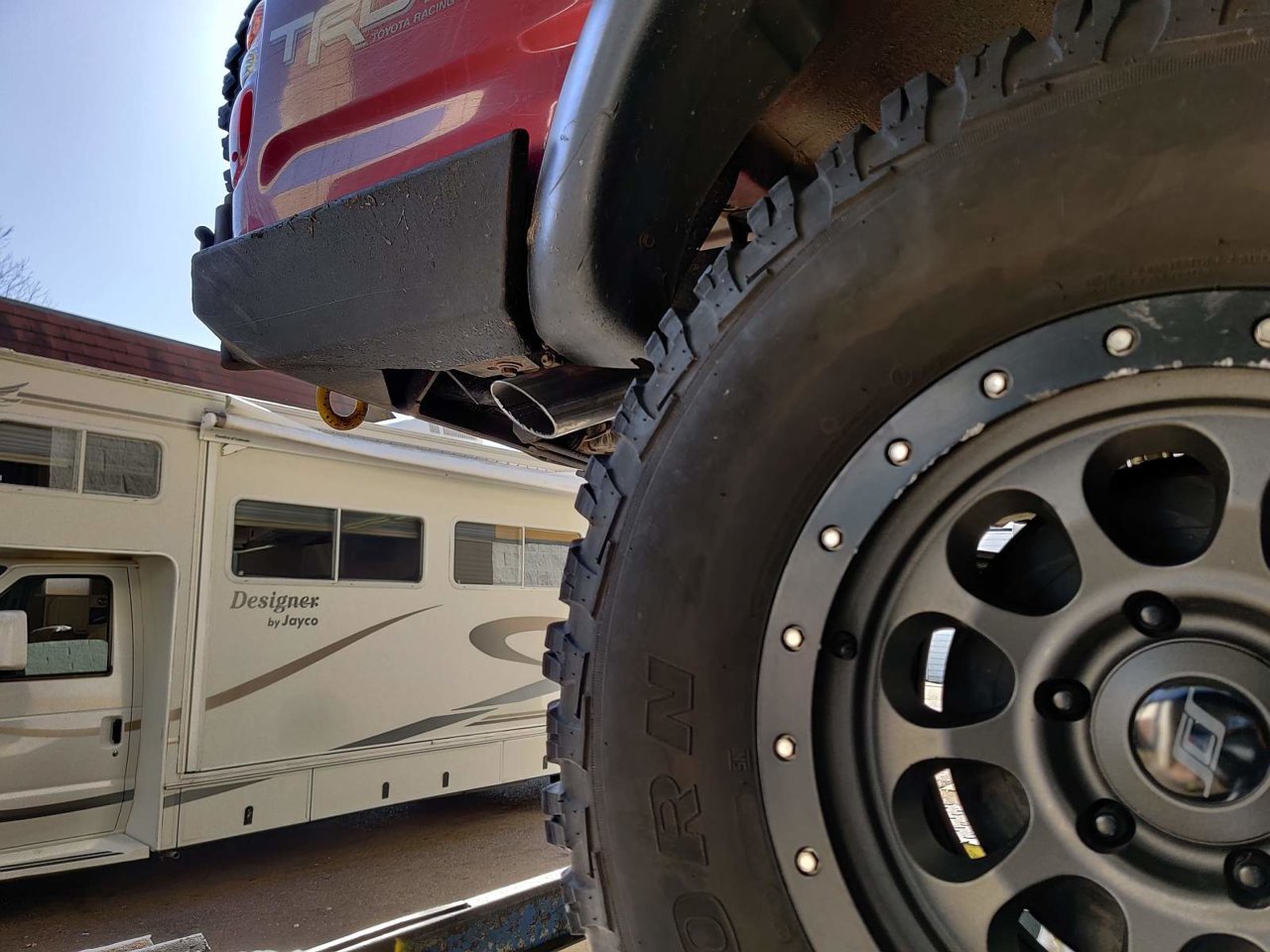

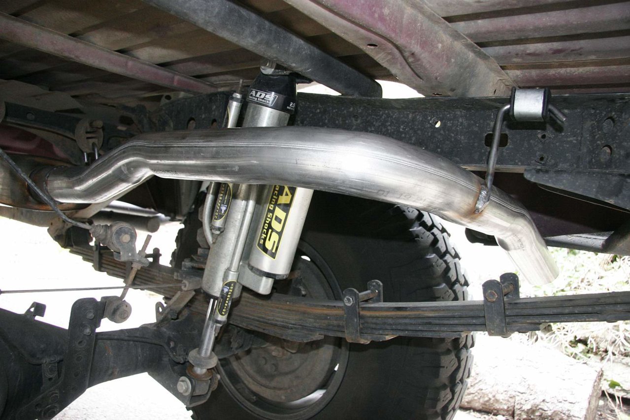

    Replaced the old Magnaflow with a new one and added a Vibrant resonator. With 120K and 10.5 years of service, the old muffler was very blown out.

    It's less Tacoma and more mod
    hows it sound?

    Compared to before? It is very, very quiet now. Almost too quiet. :oops:
    But overall, much better. You'll have to judge for yourself on whether it sounds good or not.

    Well it looks very nicely done, something satisfying about the bump out around the shock haha. Glad you like it still, your MF will wear in again and get louder.

    It'll be way better though because you piped it out the back. So won't be nearly as freaking resonant in the cab. You'll get to enjoy the tunes a lot better because of that.
