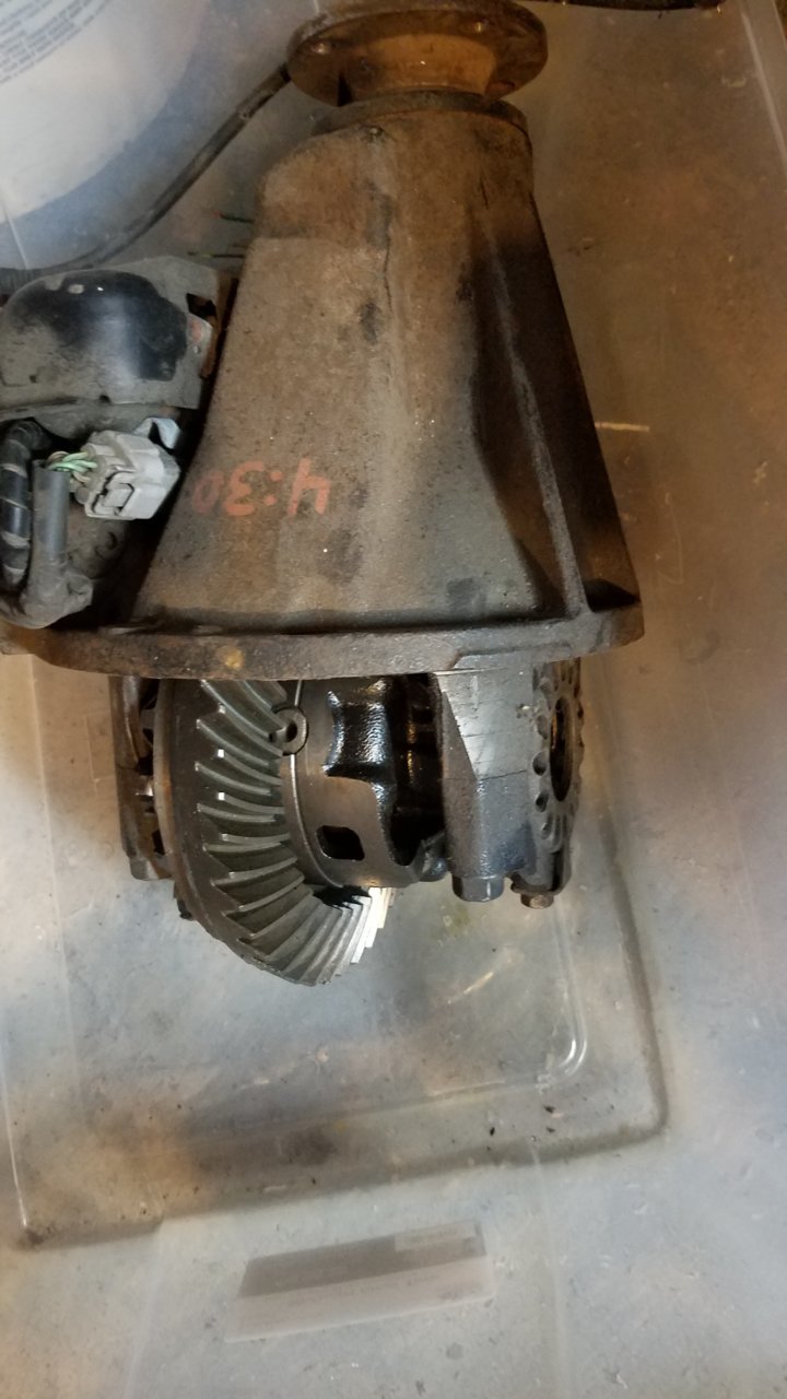

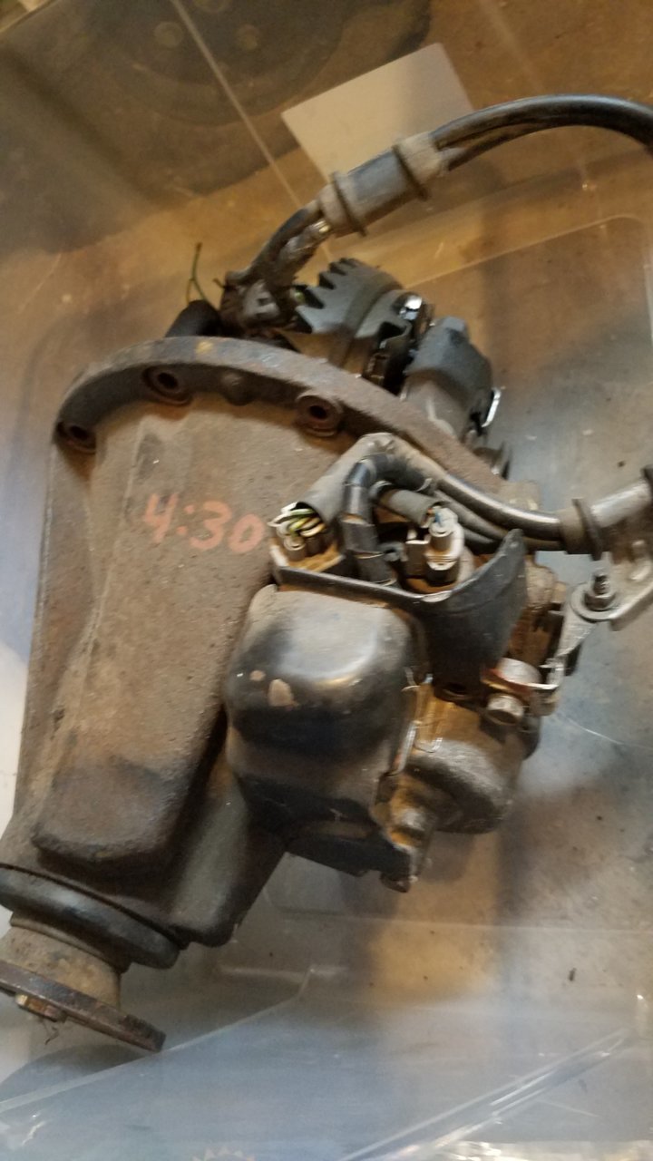

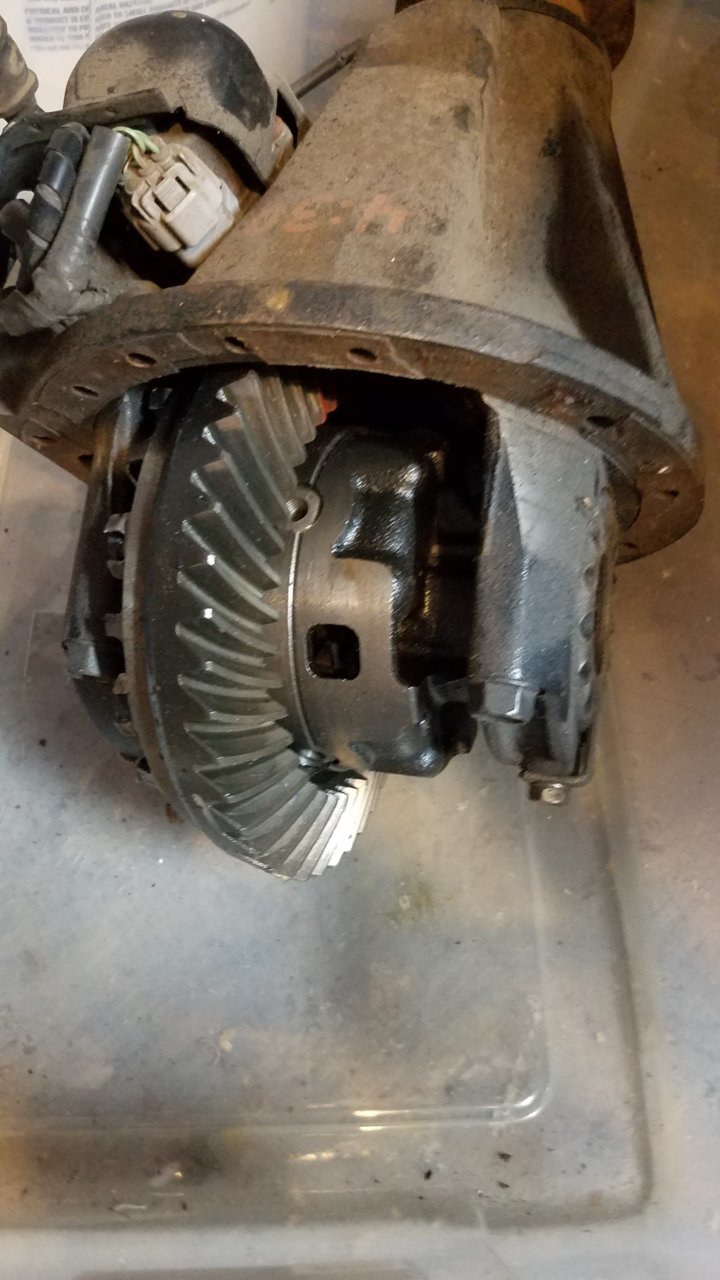

    Toyota 1st Gen Tacoma or 3rd Gen 4Runner rear e-locker diff 4.30 gears, $500 plus shipping from 35055 zip code to you.

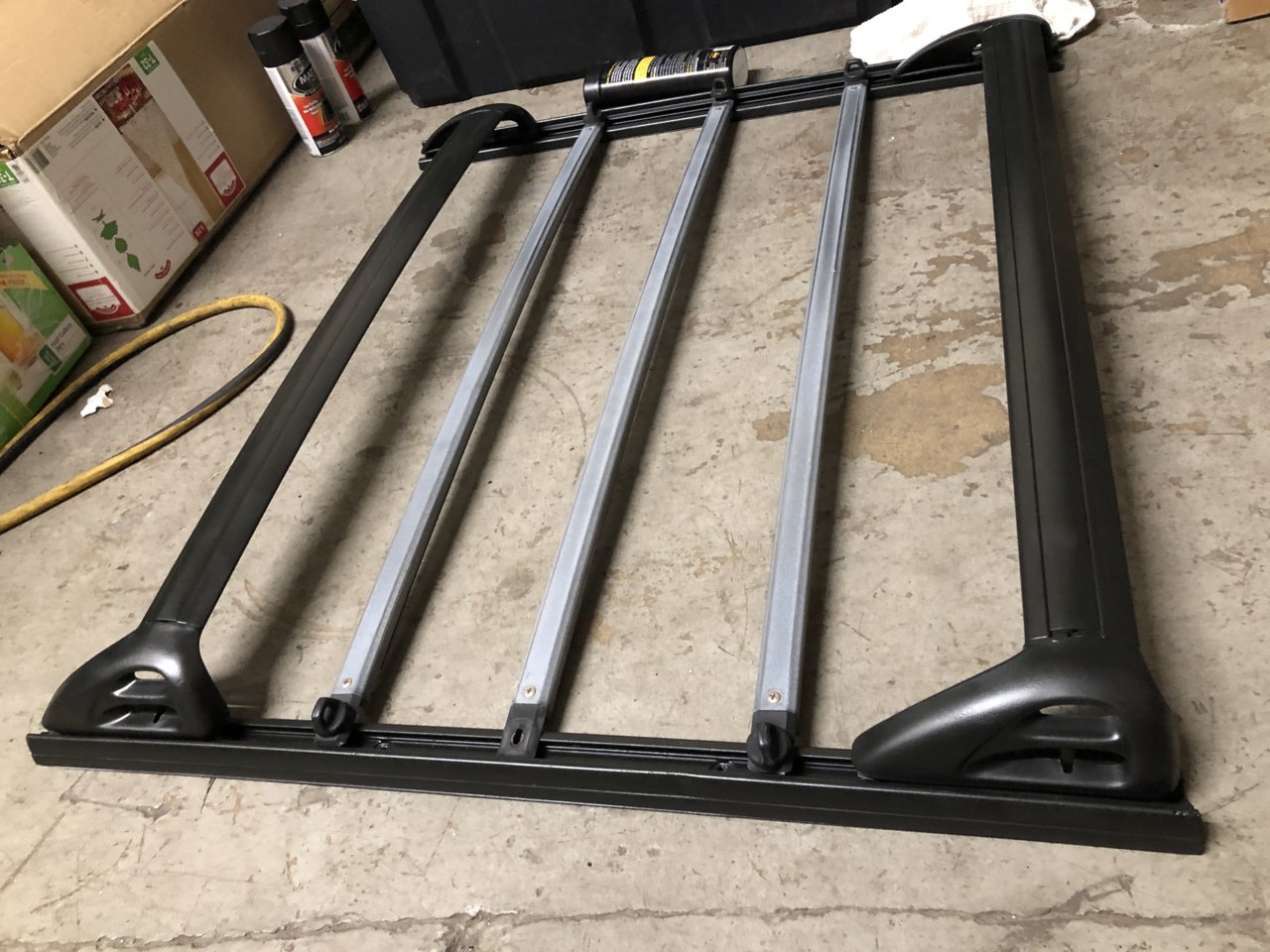

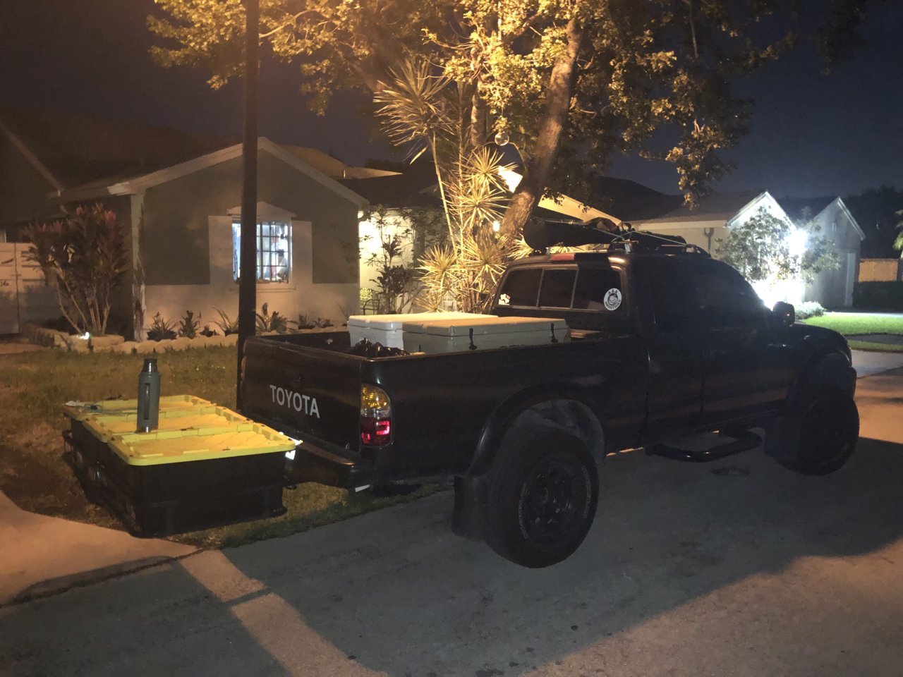

    Third gen 4runner roof rack on! Thinking of getting a custom rack made instead..

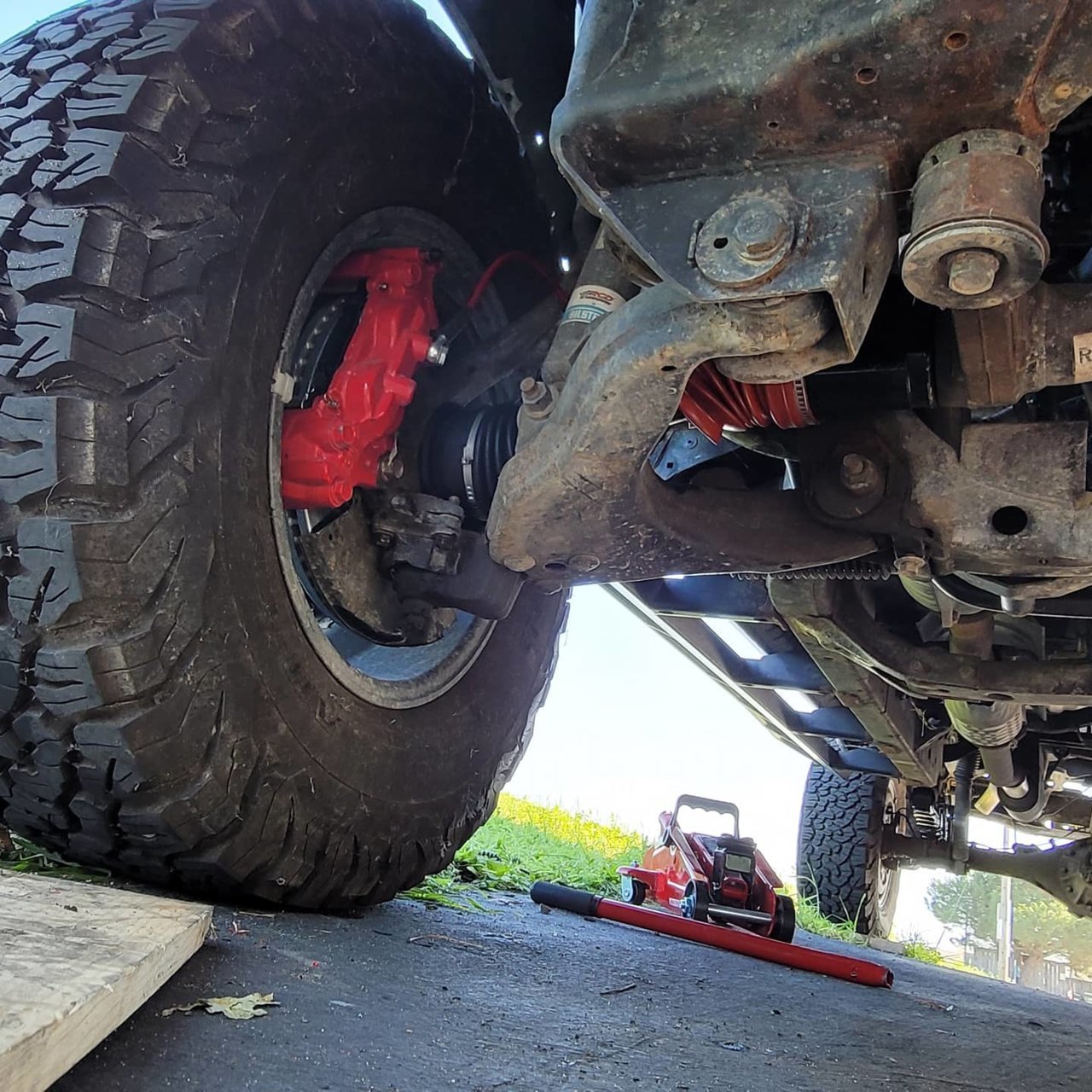

    k&n air filter, throttle body spacer, all pro UCA, 07 gun metal TRD FJ rims, blacked out interior trim
    Tundra big brake upgrade and replaced cv boots and wheelers extended brake lines

    ngl, those inner boots looking kinda wonky

    Yup. I ran those and they looked exactly like that. Those might be the long travel version. They ripped within a few days due to the fins rubbing. Had to tear it all apart again. My buddy @FirstTimeFirstGen helped me

    Ive never understood the point of those silicone boots they sell, if they rub they're still gonna tear apart except now the torn ones were more expensive than regular boots

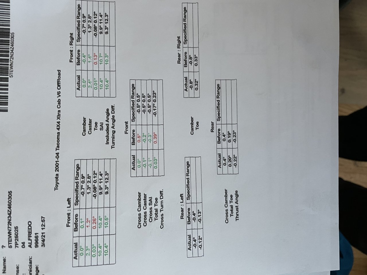

    Took lots of your advice and took my truck to a different shop to get another alignment. They flipped my cam tab back the right way and hit the numbers no problem. Wondering if I should bring this over to the old alignment shop and be like wtf!9B3223B4-D0D1-403B-91E7-A7989106654E.jpg

    Was the first one a Firestone or similar? Because they probably won't care or will say they don't normally work on trucks with lifts or something. A good alignment shop is worth every penny in my experience. Or finding one with good techs I should say.

    It was a locally owned big o tire. I’ve had good success with them in the past. But they have a new alignment tech

    Were they the offroad solutions high angle boots? Yea, that pick was right off the jack so the truck stance is not set. I am going to look at the boots after the first drive to see if there is rubbing or anything.

    Throw a couple hundred pounds in the back if you want to break them in faster
